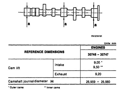

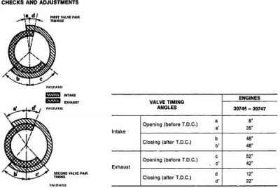

I did find that but i don't know what to do with that information. What I'm looking for is how much they lift the valves eg 10 mm and the duration on the cam eg 282* @ 0,1 ,mm lift

from the pics the diagram can be followed to calculate the cam duration.
so for example,
inlet cam lobe "a" starts at 8 degs before top dead centre (tdc), continues through 180 degs and finished at point "b" 48 degs after bottom dead centre (bdc) although there is a mis-print in the diagram spec as it lists it being after tdc which is wrong.
so the specs are
inlets
236degs & 263degs (both lobe pairs are timed differently, start/close & duration)
exhausts are both 244degs although they open & close at different points
valve lift is also different per lobe on inlet side, one is 9mm & the other 9.5mm
exhaust lift is 9.2mm on both lobes
so for example,
so the specs are
inlets
