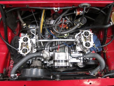

Sure is a fun thing to drive. The Sud was my wife's when we met, and was our daily drive for a long time as well as occasional track days. It went away for a while when we lived in the UK for a few years, and then was resurrected and has been dedicated track car ever since. Slowly we've developed the car although never gone after horsepower, that's about due.
A summary of it's current state:
- balanced and lightened 1500cc
- upped compression (I can't remember, but nothing silly)
- standard 105hp cams
- 36 weber IDFs, but with slightly enlarged chokes
- heads ported roughly
- same engine was built in 1999 as a road car, has had the heads off only once, has done dozens of sprint days and endurance relays, a couple of proper race meetings, and spins to 7500rpm all day long without missing a beat. Admittedly it's under-stressed, but these engines are TOUGH.
- gearbox is standard 1300 (I think), mostly stuffed and no synchros left luckily I don't use them much on the way down.
- full six point cage, braced forward to the strut tops
- braces from the 33 16v added to stop the front end falling off
- koni yellows in the front, and an old tired set of reds in the back (must replace those)
- custom wound springs front and rear - can't remember but I think something like 600lbs rear / 400 front
- no front swaybar, an old 33 front swaybar mounted in the rear
- outboard front ventilated discs/calipers from 33 16V
- perspex side and rear windows
- fibreglass bonnet and boot
Very predictable and fun to drive, and mostly bulletproof.

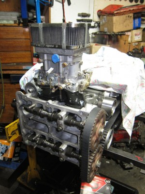

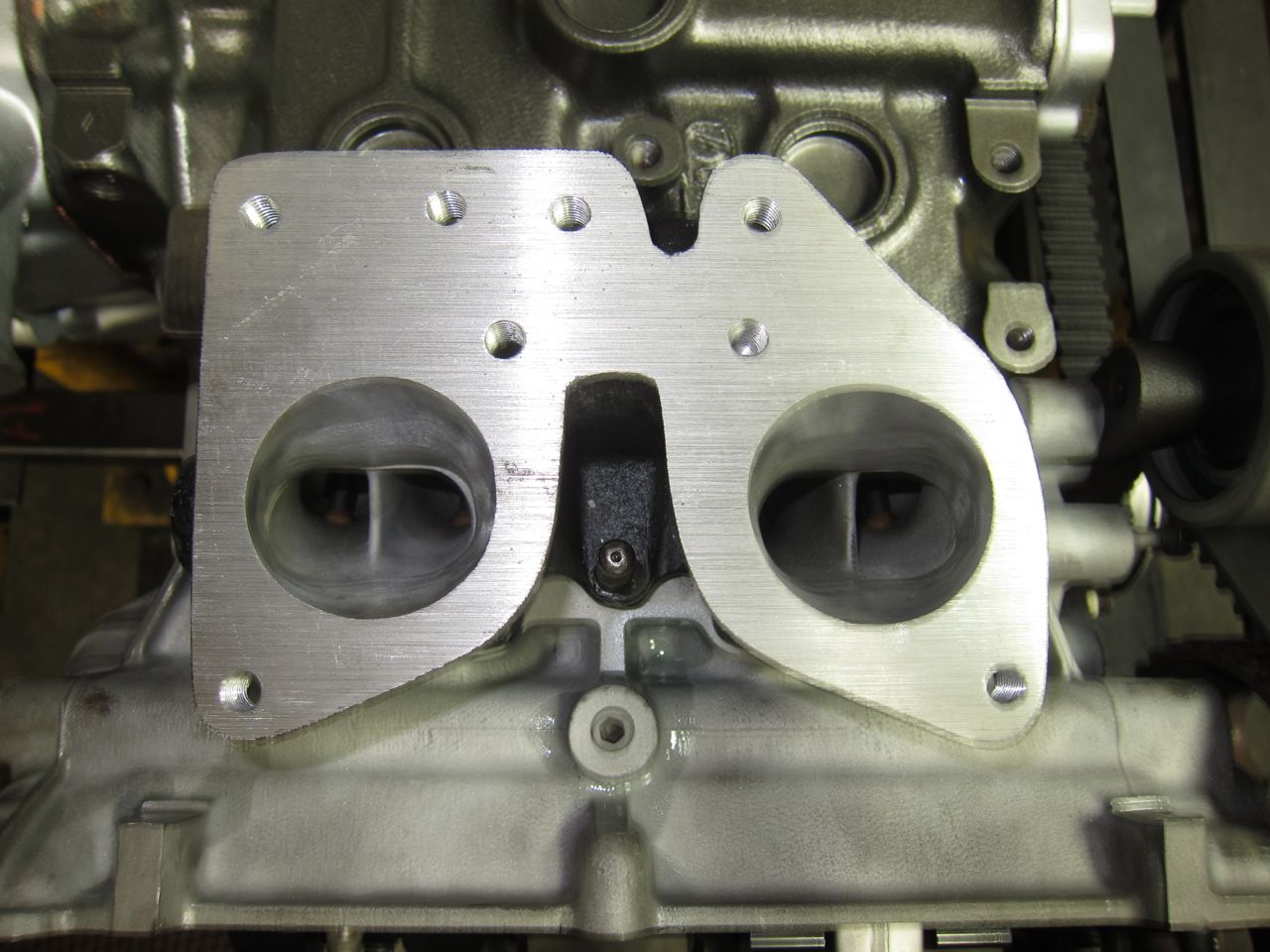

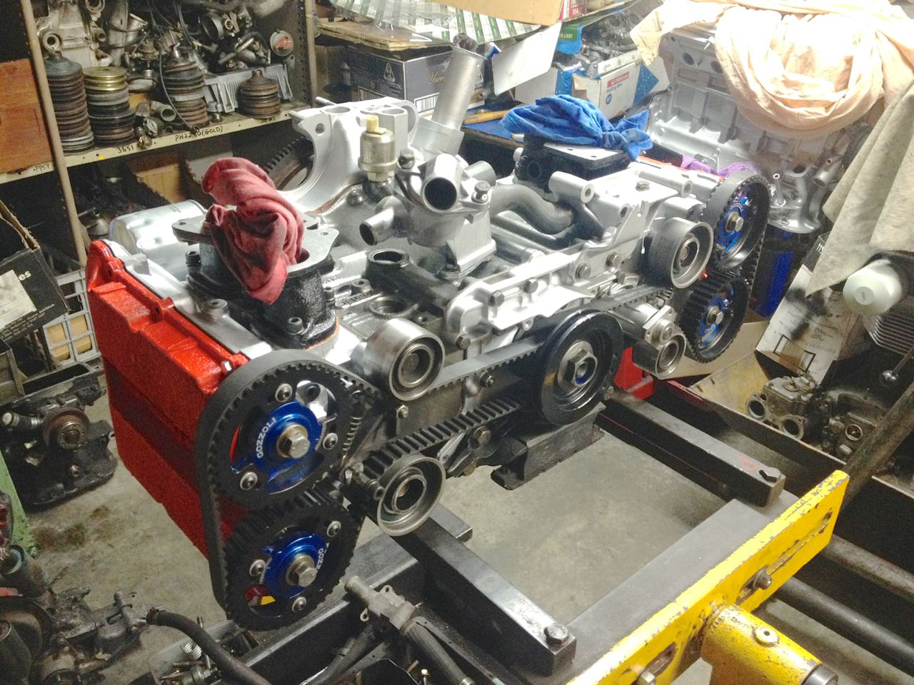

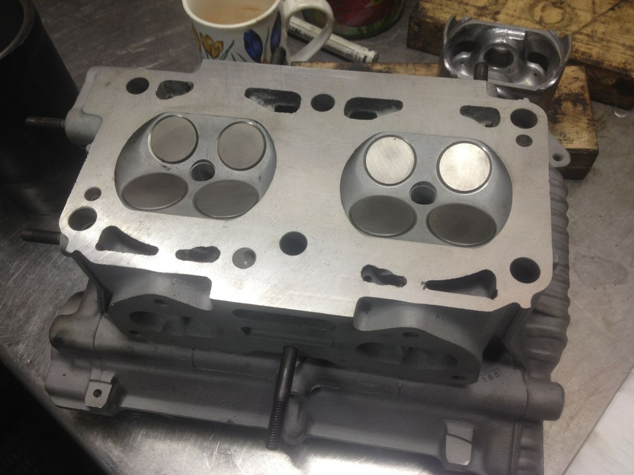

I should bring this up to date... The old 1.5 8v engine was quite sick after a sprint day in March, so we started to build the 16v in earnest. It came together last month, just in time to run in our all-Alfa challenge at Wakefield Park in NSW.
Specs:
1.7 block with a 1.5 cranks (makes 1.6, to keep me in class)
Cat cams 288deg/12.1mm lift + valve springs, retainers, buckets
Everything lightened and balanced.
10.2:1 compression
Standard valve sizes etc.
Dellorto 45 carbs.
No rocketship, but a good power upgrade. Surprisingly wide flat torque curve, really easy to drive. Not angry and peaky at all, with a nice idle and everything.

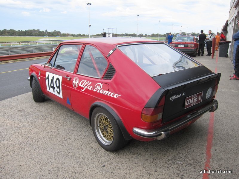

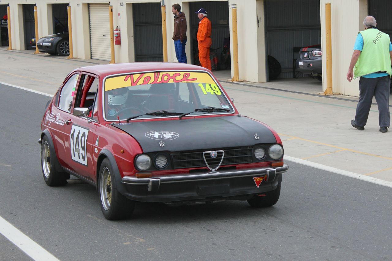

Re: The 'Madame' Sud

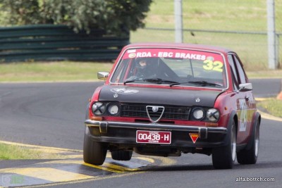

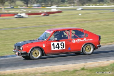

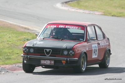

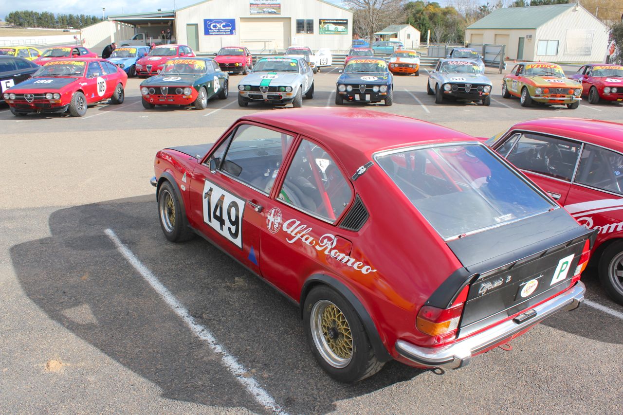

Here we are at Wakefield Park last weekend. This is an all-Alfa category, and we managed a new record of 38 Alfas on the starting grid for the first race. My first time at this circuit and I qualified 26th/38 but struggled in the races to get off the line and use the superior handling of the Sud to make up many places. The 1600 16v was easily able to keep up with some of the modified 2-litre cars which was great.
