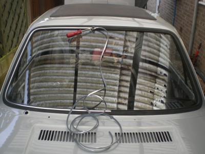

anyway, spent best part of 2 hours cleaning the windscreen seal in the week, years of people stuffing sealant into it to try and cure leaks took an age to clean off :(
so with that ready i cleaned the 'screen itself and with robs' help we fitted it in. fits just nice, so another confirmation that rubber seals will fit an S1 sud :D
still got to get the chrome (plastic) insert for the seal, woolies don't open weekends so will have to pay a little extra and get postie to do his job.

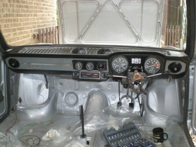

the wiring loom is in place and most stuff is connected so thought i'd fit the dash in place that rob cleaned the other day. will need to come out again once i've had the engine running so i know what mods or repairs the wiring loom will need, and to tidy it all up a bit.
just couldn't help seeing how well it looks.
took the clocks apart too to clean them up and put the rev counter needle back on.

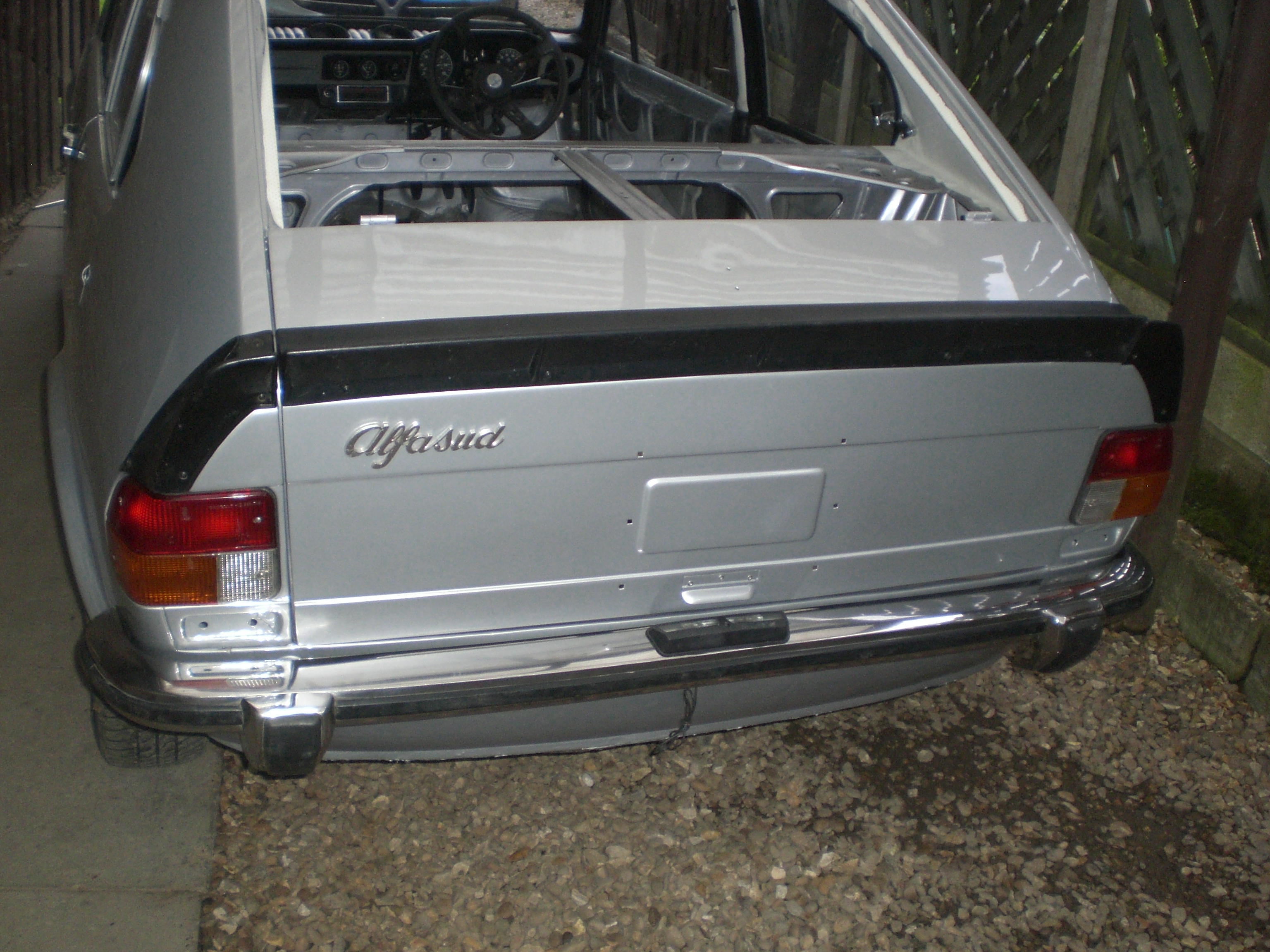

Re: My S1 Sud Ti

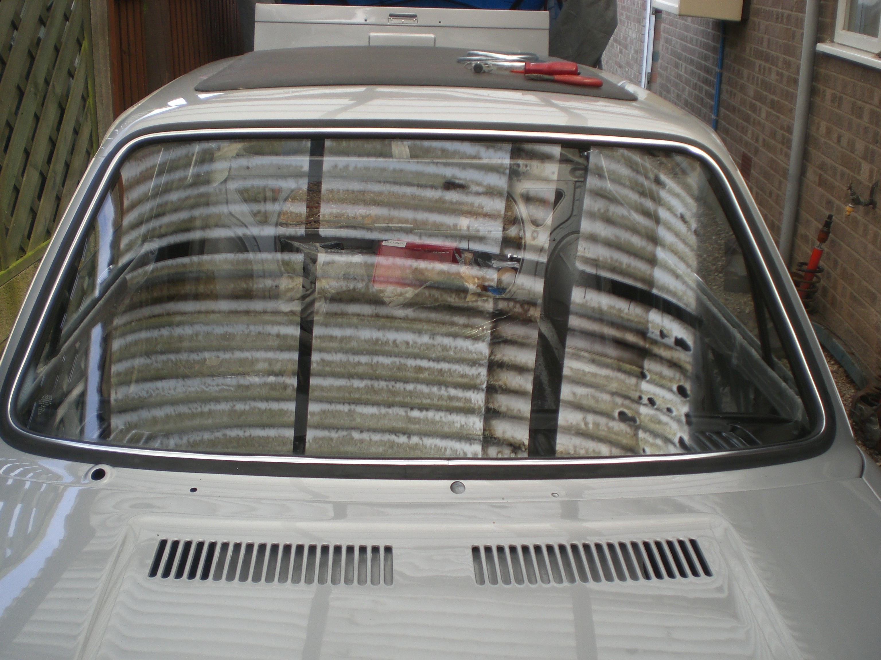

with all the activity in the week cleaning parts and getting them ready i hoped this afternoon would produce some results 8-)
first job was to fit the windcsreen "chrome" (plastic) insert into the screen surround. went in really nicely with the little tool. corners went nice and smooth despite me wondering if they'd be easy or not.
really happy with the result of that little job, gave a bit of bling to the seal 8-)
next job was the fitting of the rear bumper with it's new rear number plate lamp that came with the car.
added an earth wire too so it doesn't rely on the bumper making an earth.
put a piece of neoprene between the body mounts too to stop any chafing, don't want the fresh paint chipping off!
next task was the rear spolier set. n/s corner piece freshly repaired, doesn't look too bad but will keep my eye out for a mint one.
used rubber O ring washers under each fitting to try and stop any water getting in.....
front bumper fitted with new indicator units, earth wire added like the rear number plate unit.
rear light units i'd already cleaned up, so they were fitted to add a bit of colour.
alfasud badge finished the afternoon off just nicely.
great when you can put a load of parts on in one go, really makes it feel like you've done something!! :D
a warm afternoon which got a visitor to watch over me and cool down a little :)

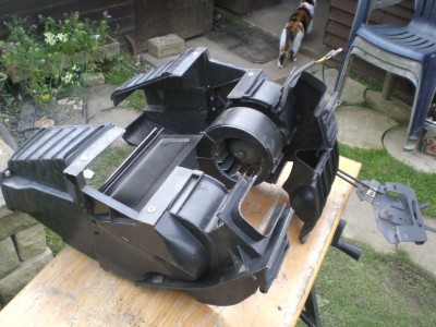

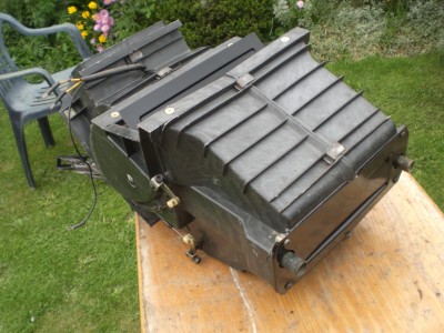

stripped the heater box apart yesterday too and cleaned a LOT of crud from the casing, years of use followed by even more years in storage had built up quite a layer of dust and debris.
if you've ever wondered what the inside of the heater box looks like here's some exploded views. my cat keeping an ever watchful eye on things :D
