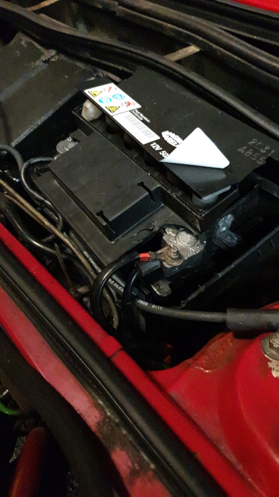

Sprints31988
Posts: 38
Joined: Tue Jan 28, 2014 10:27 am
Re: 89 Sprint - Battery removal
Post by Sprints31988 »
Don't you just love this forum !
needed to remove my battery and had forgotten the location of the bolt for the clamp, quick search and hey presto.
As you may see the battery was less battery and more IED. baking soda and soapy water seem to have dealt with the worst of it.
A bit lucky but can't understand why it exploded, was on charge in garage when it went after about a week after a run out. :?

Ouch !!
That happened to me once, but while driving. A loud bang under the bonnet but didn't see anything obvious. Drove car home, used it the next day, but the second day turned over slowly , but started. Day three it was flat and when I went to jump it found the battery had physically blown in two halves. That turned out to be a voltage regulator fault and the alternator boiled the battery.
