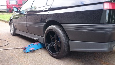

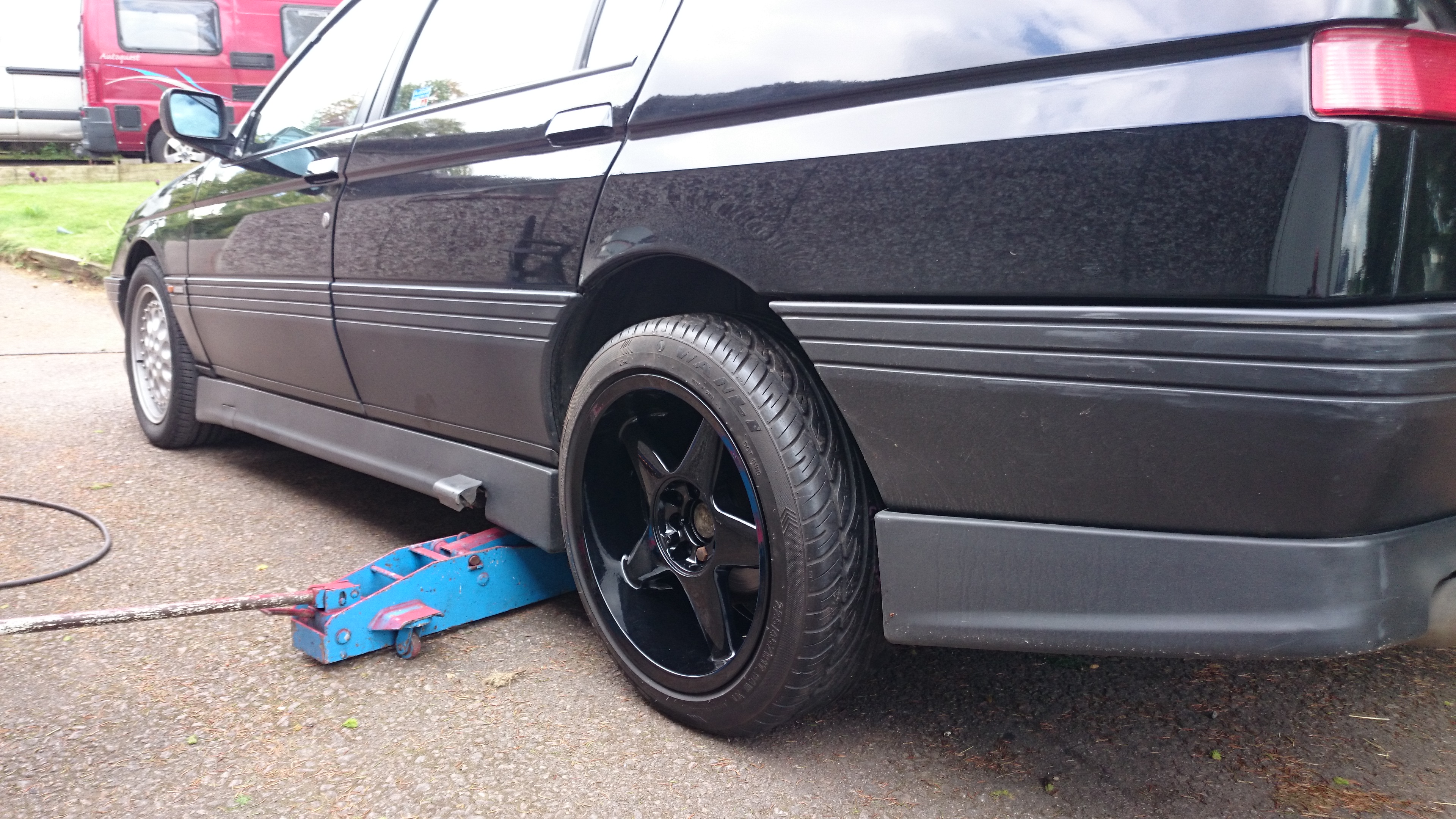

Did you use a heat gun on your arches Ricky? it helps preserve the paint no end.
I kept plenty of general heat in the 33 arches and wings, and got quite a subtle flare from them aswell as a complete fold in of the lip.
and this is the wee beasties, offered up for size on my 164 as thats the next thing to get some wheel surgery, possibly with the same design wheel again, Brock B1.

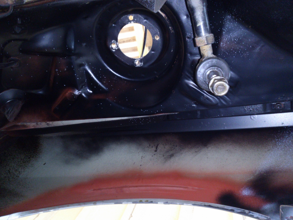

Hi shrew thanks for the reply. The pic should show what's the problem.
It's the bush below the fire wall. 2 of the inner bushes should be 53mm in length. When you go to bolt the suspension arm with poly bush to the car it deforms the body mount to hold the bush tight.
So what some people have done is make two 53x3mm washers to go on each side of the bush.
What I don't know is if this has anything to do with making the car twitchy to drive, it gets pulled off line by wear ruts in the road and hard to control but I really have found the car a delight to drive with rubber bushes and no handling probs.
