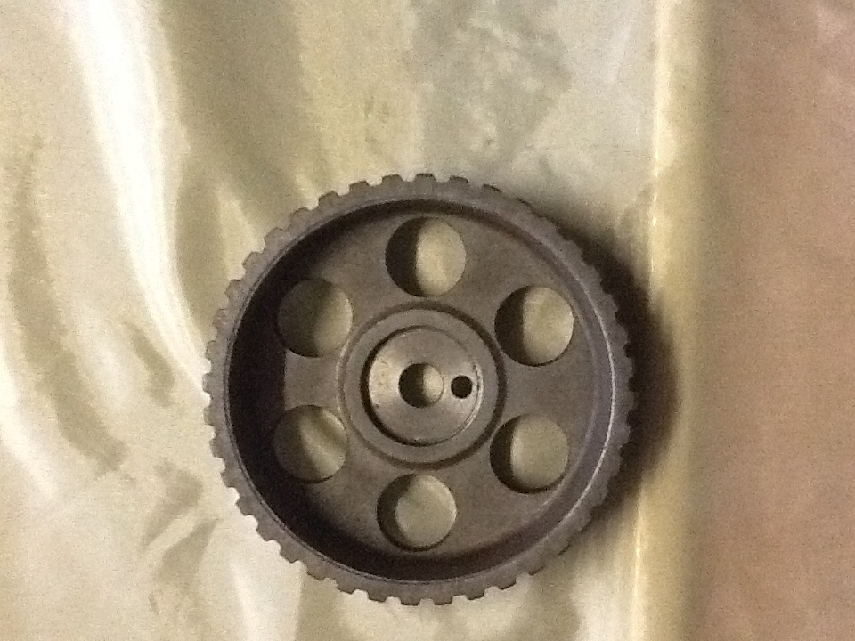

Would anyone have one of the nice cam wheels with the holes in it?
I have one and I want to replace the ugly pressed ones.
Are they the same from one side to the other, they look like they just turn over.

So who has one of these they don't need?
And are they the same left and right?

I cant remember on the 8v but on the 16v there are markings.
They are different by the way, you can read
AS
DS
AD
DD
Which stands for Destra Sinistra (right left) and a,d is up and down or intake, exhaust

Fetta GTV
Posts: 56
Joined: Mon Feb 03, 2014 11:18 am
Location: New South Wales, Australia
Re: With or without cam belt covers?
Post by Fetta GTV »
thanks
this one is marked with an S, so i need a D right?

D = Destra - Right
S = Sinistra - Left
A = Aspirato - Intake
S = Scarico - Exhaust
You should have:
SD - Scarico Destra - Right Exhaust
AD - Aspirato Destra - Right Intake
SS - Scarico Sinistra - Left Exhaust
AS - Aspirato Sinistra - Left Intake
