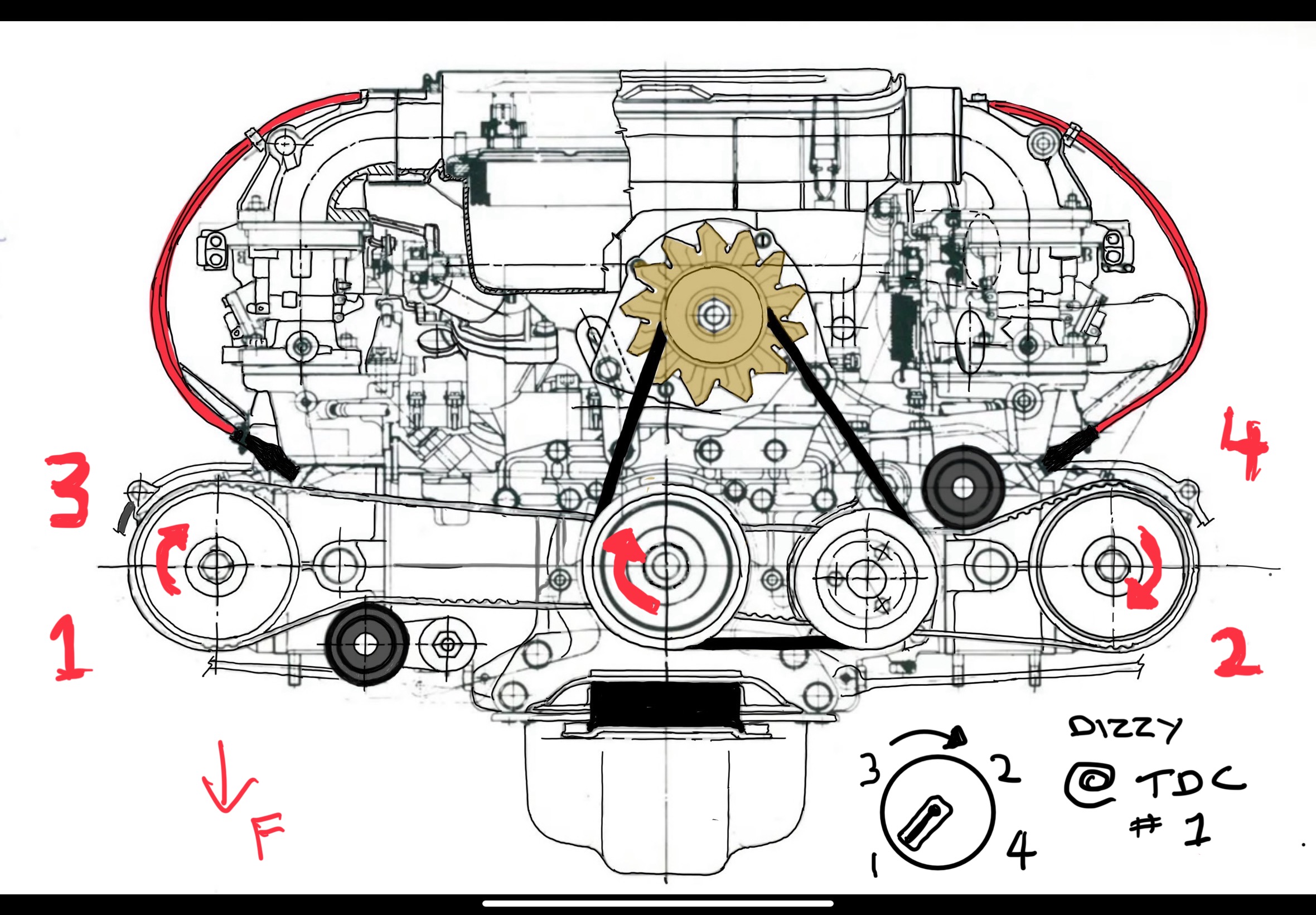

The boxer engine normal direction of rotation is the usual clockwise looking from the radiator side and counter-clockwise looking from the flywheel side, right?

Hi. That’s Correct. fYi. The Firing Order is 1324 with 1 being the furthest forward cylinder, 3 behind it, and 2 the other front
Hope the picture helps

Thanks Lou, glad I’m not losing my mind. Great picture btw, will keep that!

I’ve just revised the pic. My brain farted and I got the 4 and 2 the wrong way round on the dizzy graphic.
