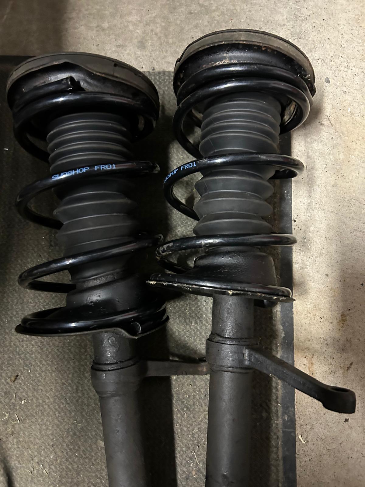

A couple of weeks back I fitted them to my Sud BUT the front shocks/dampers are not retaining when jacking car up, so it's sliding up the strut. As it's the opposite to the original upside down design I think I've left out the brass cup but would I fit it below the spring pan? I do have other front struts that have been adapted to use Koni shocks so I might disassemble them to use that bit. I've new gaiters on the way from Alfisti.net so they'll (the fronts) be coming back off the car soon.

It feels nice and tight (the old lowering springs had become very crashy and sat quite a bit lower).
My only issue is the shock sliding up. I do think I have the solution. I'll keep you posted.

Took the spring pans of the struts that I had on the car, they have a narrower centre and should stop the insert sliding up. Got to fit the new gaiters I bought too. Hope to refit tonight or tomorrow night and then book NCT (MOT equivalent)

OK quick update. I had forgotten to refit the brass cup washer below the top mnount and the retaining washer at the bottom of the strut. I got help from a retired but very well known and loved Alfa mechanic here in ROI. It's driving like a dream now!
