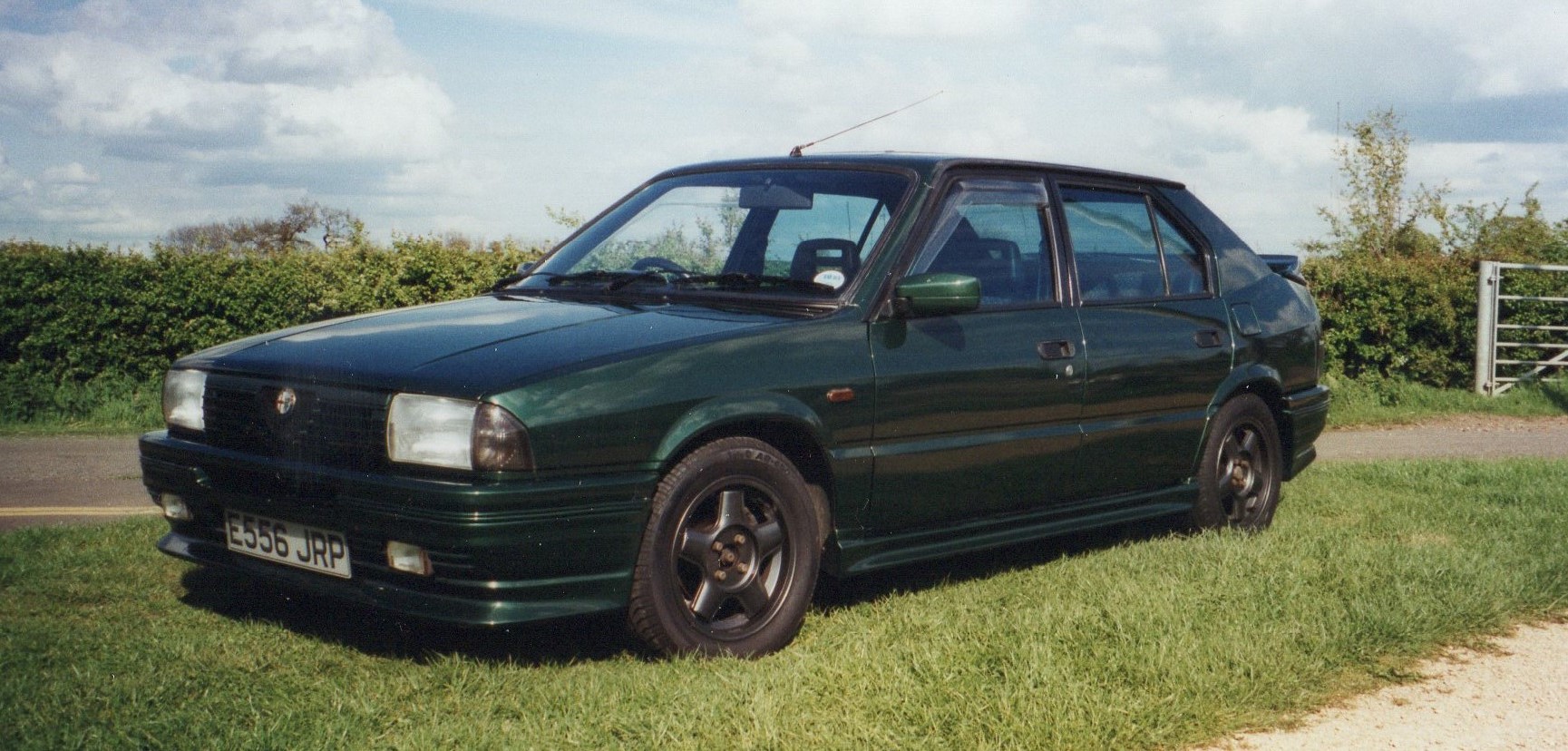

I loved my S2, it was just like yours with the early Zender kit . 1.7 with the five spoke alloys and lowering springs.

Kegsti66 wrote: Mon Dec 20, 2021 11:17 pm Spot on. Well done.

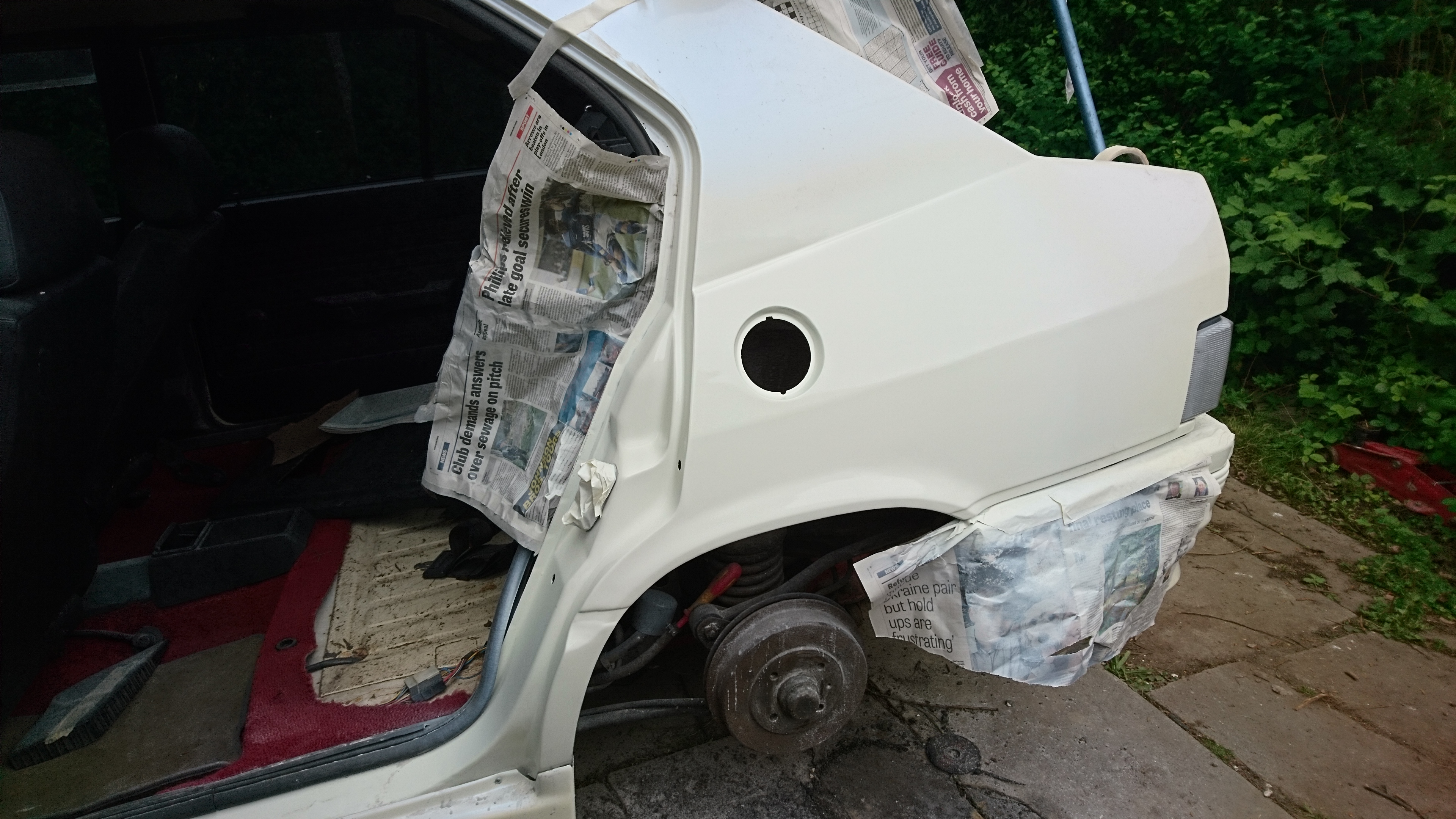

Nice looking car . Nice colour. What's with the square petrol flap?
Posts: 2894
Re: 33 sills
Like your car, filler cap area had rotted out , so when I replaced the sills, wheel arches, tailgate and back panel I grafted in the filler flap and box from an Alfasud Sprint that was scraped. I also used the plastic filler pipe to connect it to the fuel tank.

Kegsti66 wrote: Mon Dec 27, 2021 8:10 pm Like your car, filler cap area had rotted out , so when I replaced the sills, wheel arches, tailgate and back panel I grafted in the filler flap and box from an Alfasud Sprint that was scraped. I also used the plastic filler pipe to connect it to the fuel tank.
I've got a repair panel to go in . I've also been looking at a quarter panel . I do like your idea though!

The filler cap was picked up on the mot as an advisory so thought I better sort it. Still some work to do but not bad for a days work.
Re: 33 sills
Neatly done, nice work indeed 8-)
