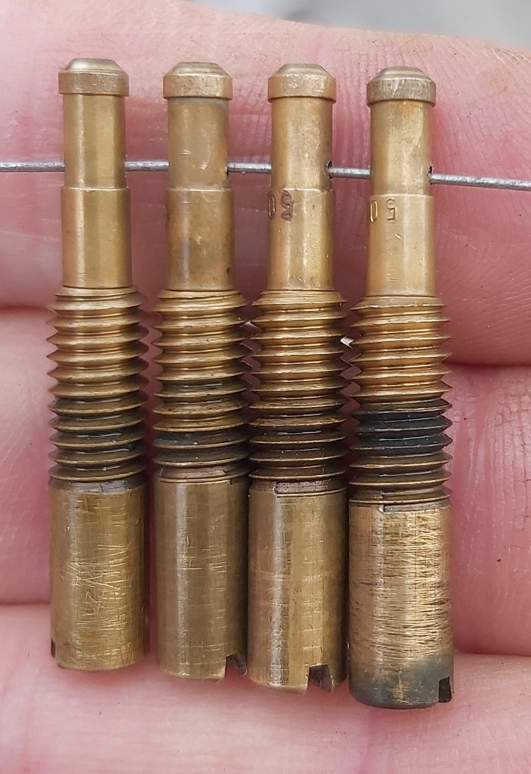

Would be really interested to know how you get on with those 55 idle jets. I’ve always read that the 52s run a little lean and to be honest I think everyone I’ve checked (both original dellorto and new replacements) has been undersized. So i ream them to exactly 52. Seems to run well but would love to hear if your 55s make a great difference. Cheers.Alfastrut wrote: ↑Sat Jul 29, 2023 10:45 pm I'm having similar problem to you. How ever I try to set the carbs I'm getting a stumble when at low revs. it goes away at 2800 revs so it's on the idle circuit. It will idle lovely. The problem only shows up when driving. The engine is a 1.7 on 40 dellorto's. It's running 52 idles at the moment. I've ordered some 55 idle jets to see if it runs any better.

I am just doing a visual on the spark plugs to get an idea. One bank (Cylinders 2 and 4) the plugs are a perfect light brown colour. Bank 1 and 3 are a silvery grey colour so obviously lean. Air correctors are all closed, I turned the mixtures out another half turn before driving back 80 miles and just cannot get this bank to run any richer than is....... I took jets out and cleaned them last week , however I ran out of fuel the other night so could it have perhaps ingested more crud into the jets?? I really am stumped here......

How does this jetting compare to others?
I am thinking of lifting idle to 55 as am 5 turns out on mixture and still have this pulsing at around 3000rpm
Have not driven the car again since I cleaned them all out with paraffin and my compressor, so maybe its solved.
Also had a slightly sticking needle valve which has been changed too (175)

I tried 55s and it totally bogged down. Didn't have time to play so put the 52s back in.
