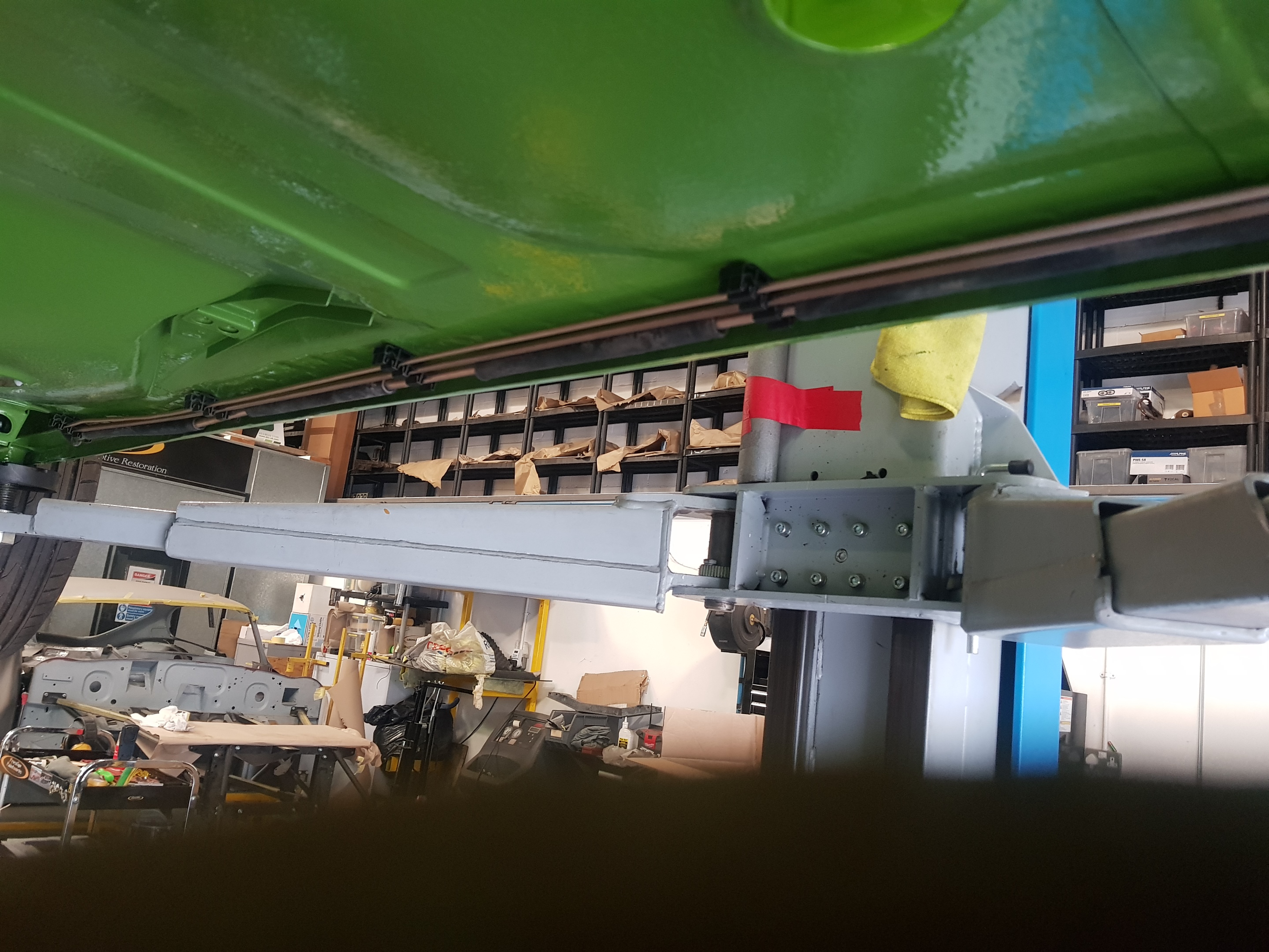

Some more pictures showing the underfloor fuel & brake lines. I couldn't find the original 3 position pipe clips anywhere, but obtained 4 position clips with the correct sizing from an ebay seller in Lithuania. At the front, the pipes have been rerouted to the most favourable position. The old pipes were so far gone and the clips had fallen out of the floor so there was no reliable indication of where they originally ran. The tank is back in too. Next milestone is installation of Dynamat Superlight (didn't want to use Extreme with only 95 bhp to play with). Meanwhile I have the brake master cylinder rebuild to look forward to ( an :evil: looking object plastered in rust, black underseal & crud ditto the clutch master) and the windscreen wiper mechanism which is seized solid on the nearside.
