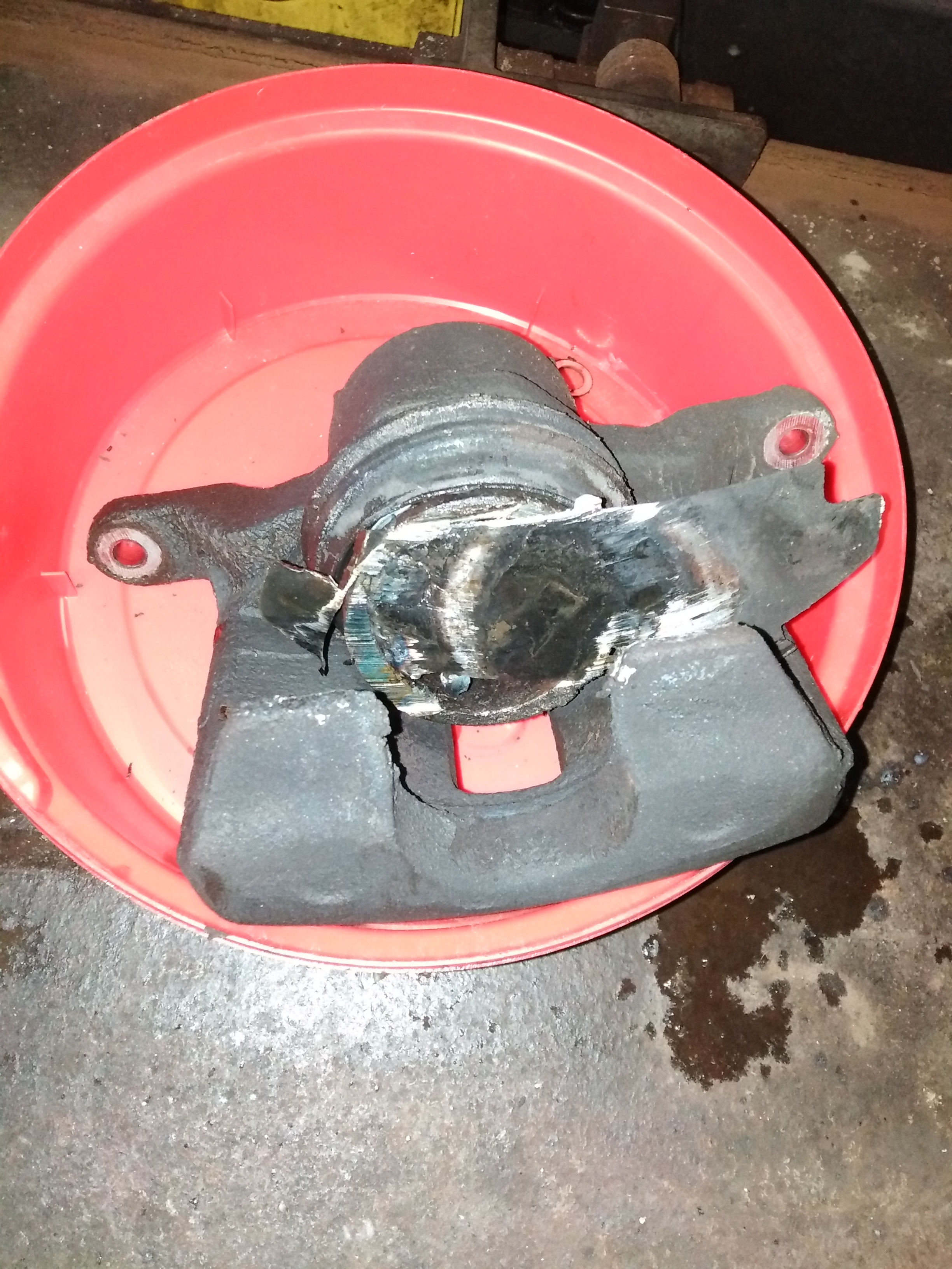

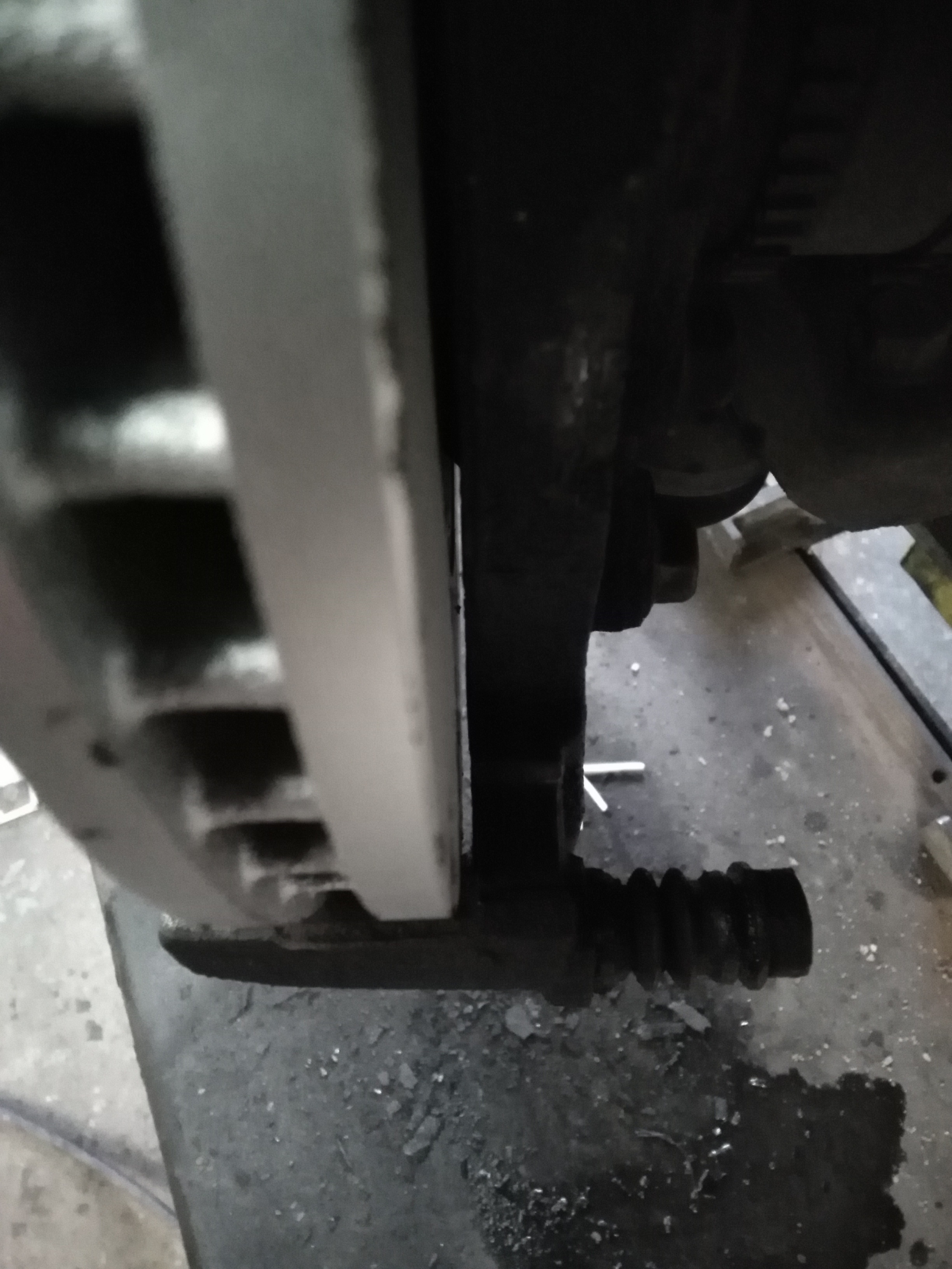

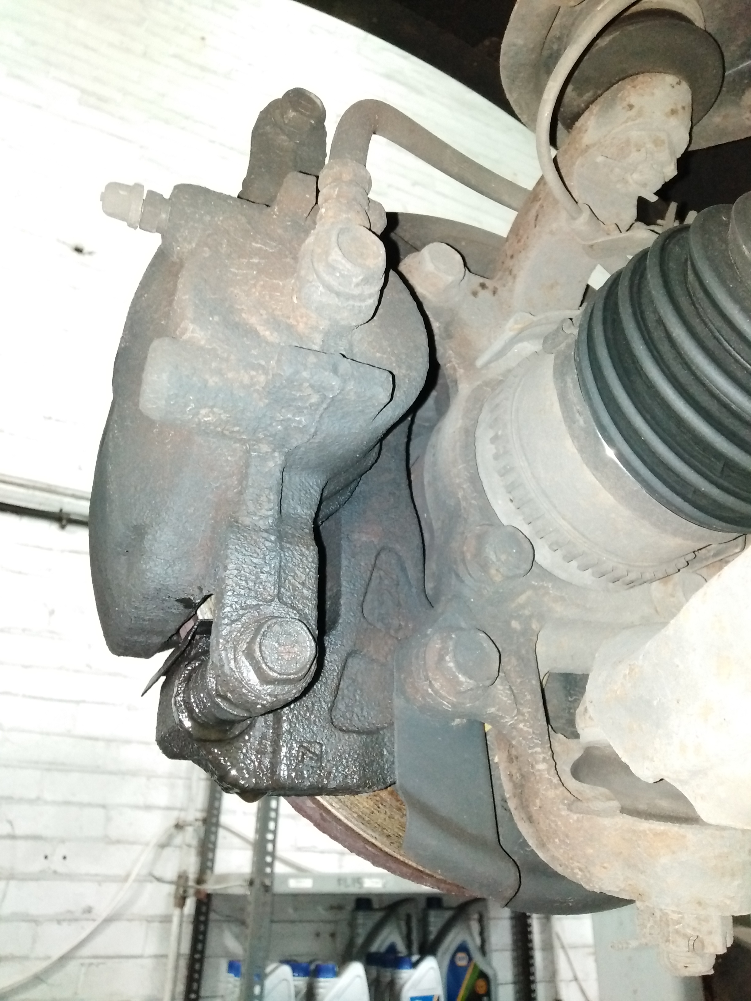

Today's brake job was a 2019 Mitsubishi L200 that was brought in with a lack of brakes, pedal just goes to the floor... Repeat, driven in...
Fluid empty, pedal indeed goes to the floor. Carefully put in on the lift as was an Automatic but thankfully had a normal handbrake to slow it down.
Soon became obvious where the problem lies, NSF caliper wet and wheel soaked in brake fluid. On looking closer it appeared there was no pad left at all on the inside face...
All that was left was the thin cover that used to be on the back of the pad, which must have been long gone.
The piston had been grinding away on the brake disc until it got so far out that it went beyond the seal which finally convinced the driver that maybe he ought to get it checked out!
Re: general chat thread

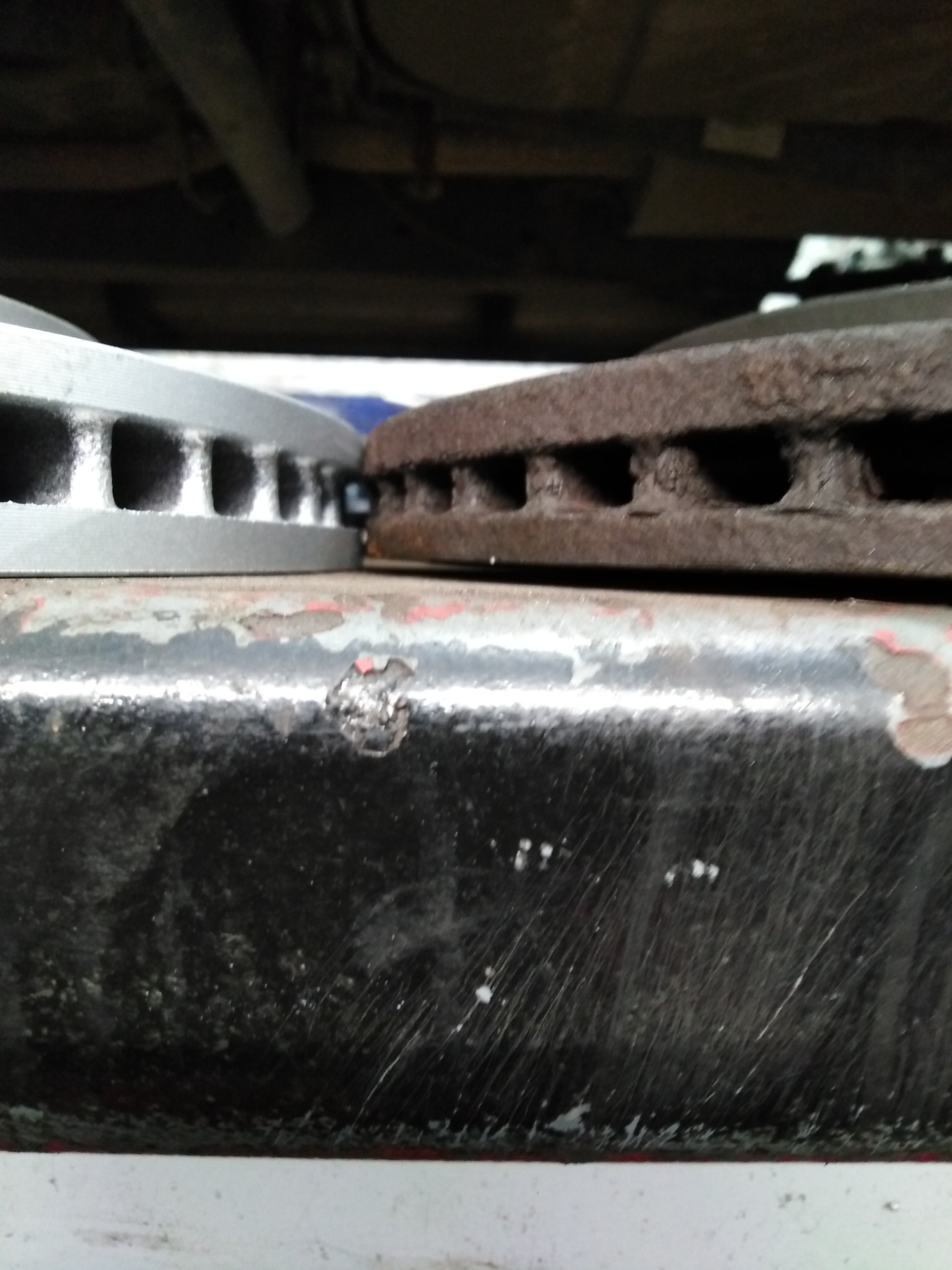

He'd taken about 3mm of material off the disc face by carrying on driving with the pads metal to metal which made enough clearance at the mount for the pad to slip through the much wider gap.
New disc shows where the gap should be
The amount of wear is clear..

Gulp!
What mileage?
Had it had its first MoT?

Scary thought is that the owner could have been riding someone's rear bumper with a trailer of kit and something ahead happened and all hell would have broken loose.
:shock:
I’m sure that in such an event if it lead to fatalities they’d be facing Jail time (deservedly so imo) For knowingly operating an unsafe vehicle. And let’s be honest how could they not know something wasn’t right !!!
Yep, scary to think what's driving around. It is a big thing too, back seats full of gear and the pick up section full of heavy tools. I'd imagine it in excess 2,500 kg, and that's before the trailer is added..
A construction gang truck of some sort judging by the tools in it. Company supplied vehicle so nobody gives a damn, apart from the lease hire company who were far from impressed and will be charging the customer despite being on a maintenance contract, seems stupidity isn't covered!
Scary thing though is it being an automatic so short of trying to ram it into first or park there's little engine braking. If it had one of my pet hates too, an electric handbrake that would have been worse still. At least you could moderate the speed slightly.
But the fact he saw fit to actually drive it in without much concern, well it just says a lot about the state of some drivers idea on what is safe to do.

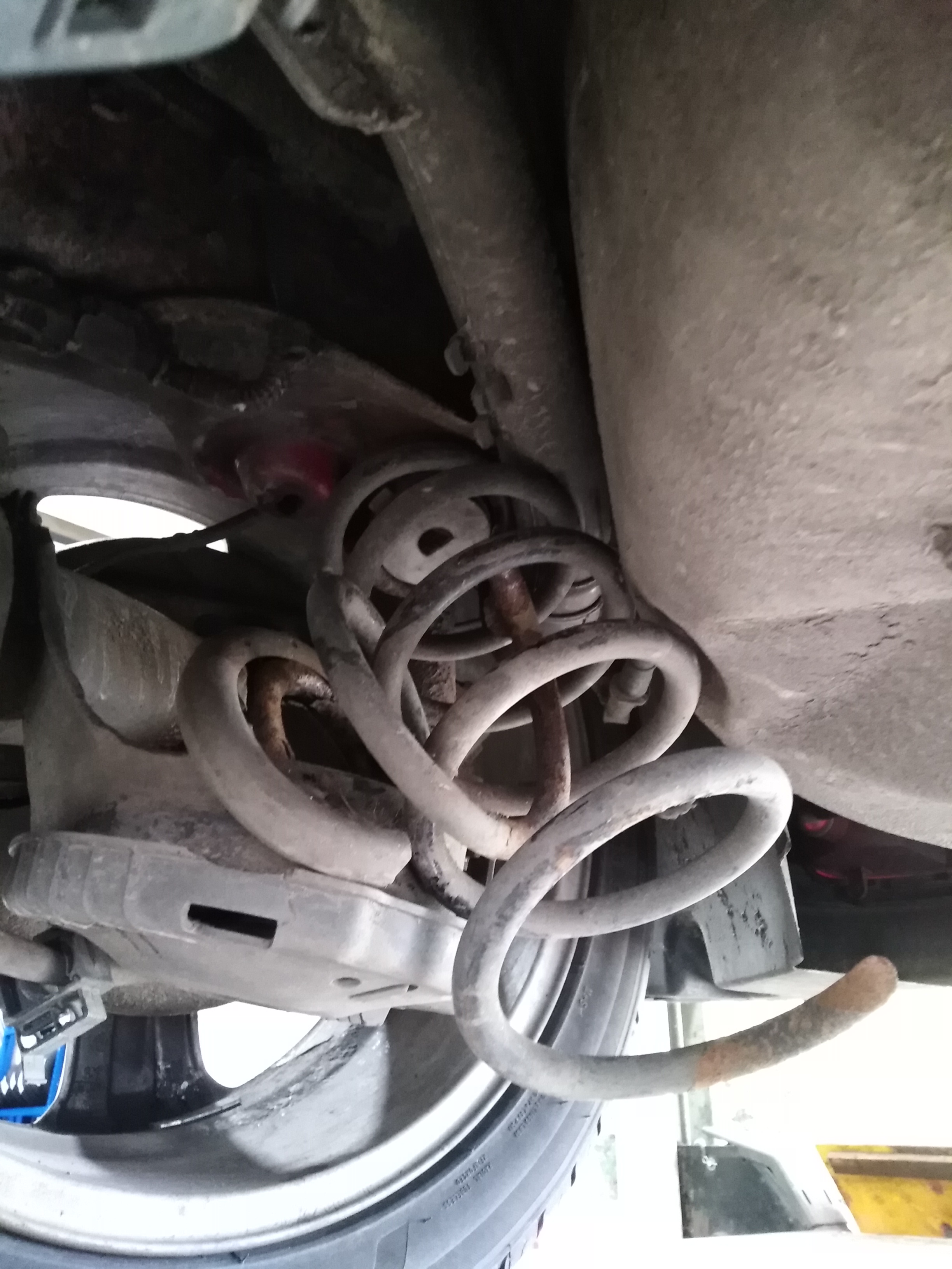

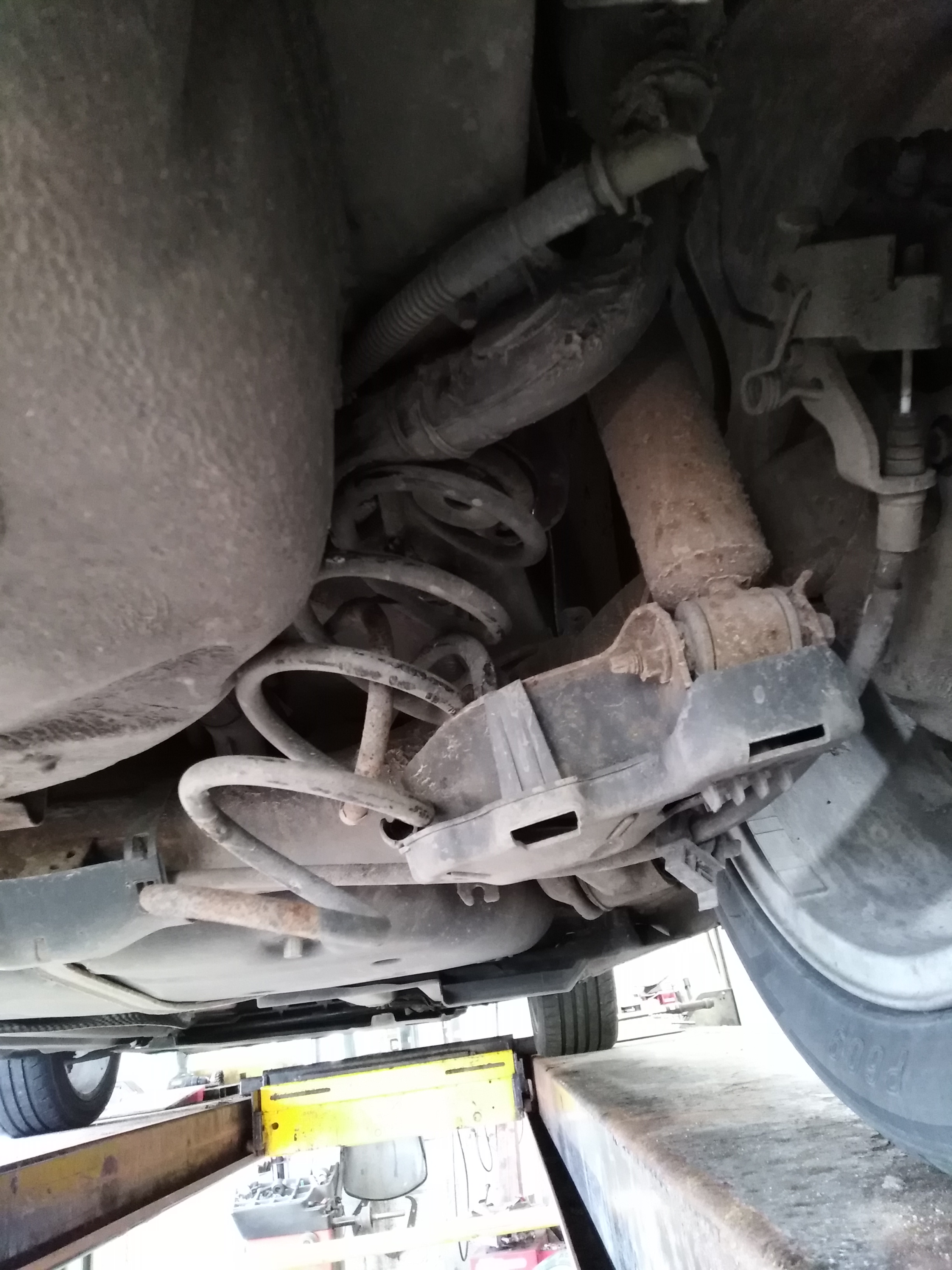

I've seen a good few cars with broken front springs, Fiesta and Citroen cars mostly, often the sharp broken end goes through the inner sidewall of the tyre for added effect!
But this Peugeot 3008 this week was brought in as the Lady owner thought the car looked a bit lop sided and didn't seem to be riding as well as normal....
I've never seen one jump out of both top and bottom mounts though! This was the drivers side rear spring which had snapped, jumped sideways and got stuck between the axle and the spare wheel well, denting the floor and crushing the plastic fuel filler pipe.

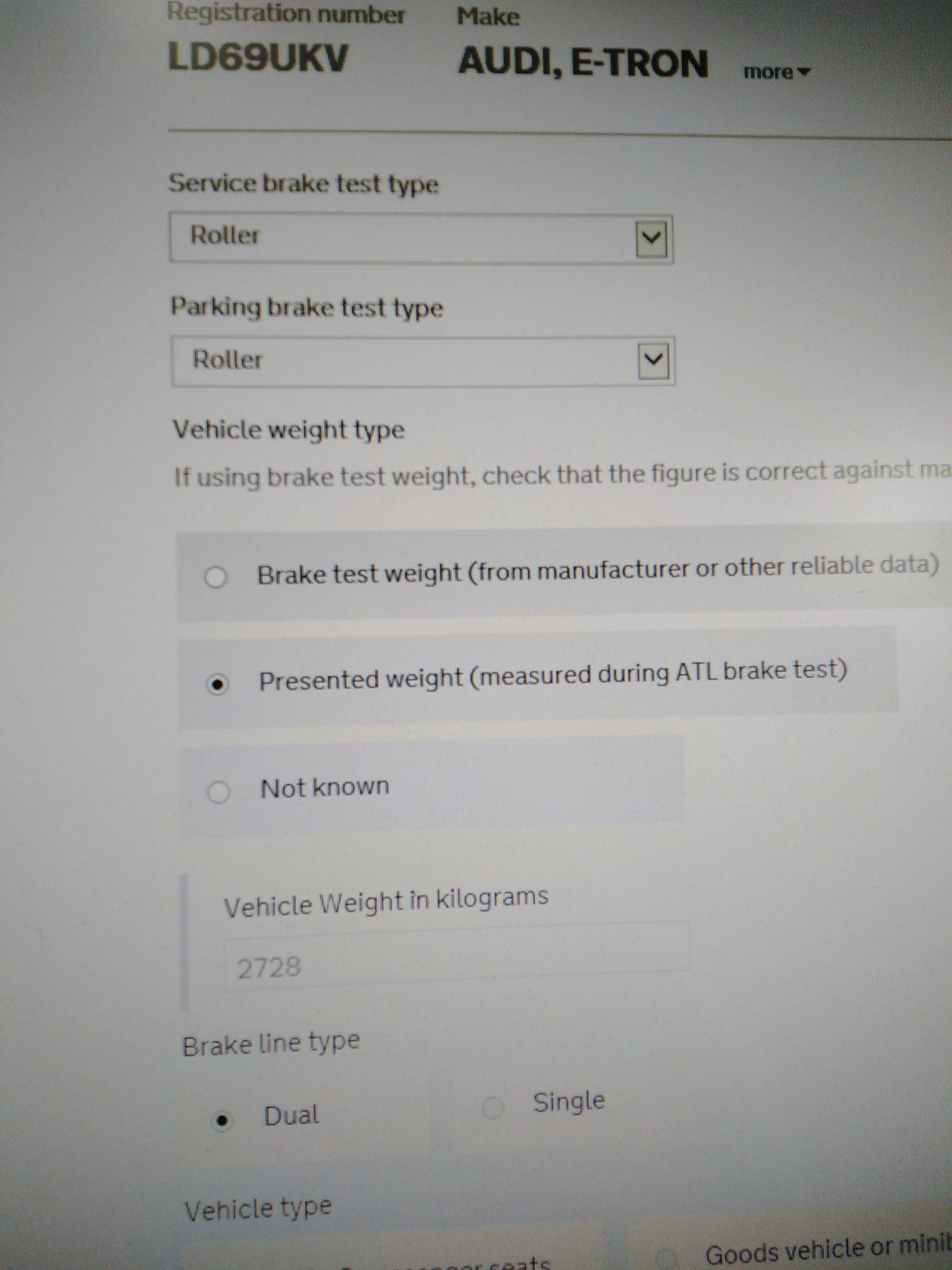

Audi e-tron huge electric powered behemoth of a thing. 2020 year model and must have cost a fortune a couple of years ago, but if you said I could have it for free as long as I had to use it for the next 5 years.... :roll: no thanks, I'll pass on that thanks.
Damn thing must have been over 2000kgs, never did look it up but you could tell on jacking it up it was heavy, stupid wide 265 tyres on 21" mostly as more normal sizes wouldn't be able to cope.

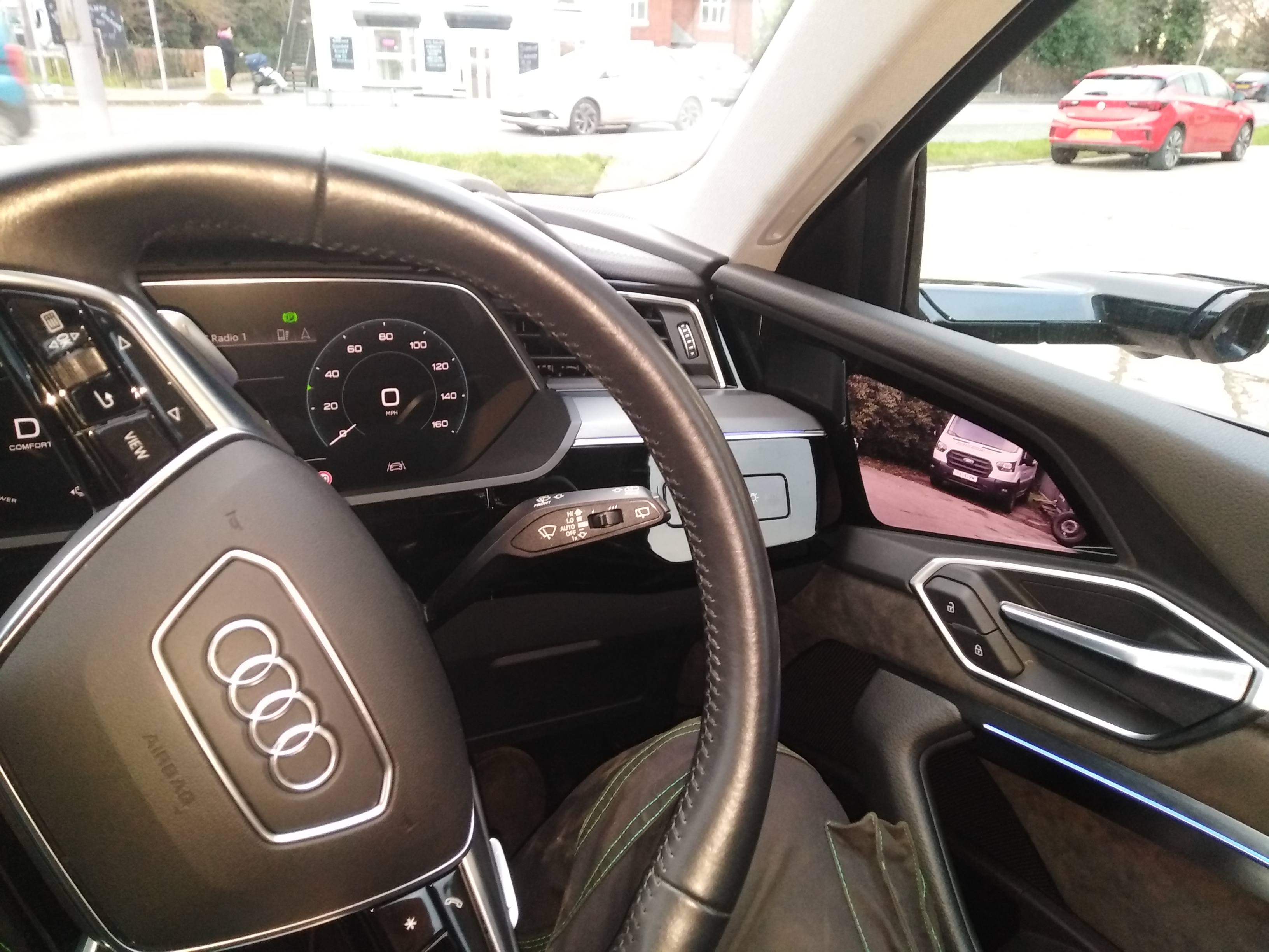

Anyone ever thought that door mirrors are too difficult to use? :?:
Well Audi in their wisdom have created a much more expensive way of doing that, God knows what it would cost to fix when it inevitably goes wrong, but worse still is they have removed the mirror from being in view...
Instead of being able to glance at the reflection in a mirror you get a TV screen built into each door card, passenger side too. :?
Just the job for removing your line of sight from the road ahead!

I've just looked up the car on Parkers, seems it is indeed a portly thing, 2,520kg! Same as a decent sized Vivaro sized van, or to put it into perspective that's more than 3 AlfaSuds! 3 of them!!! FFS, where's the sense in that.
And the list price when new? Over £83k!!! That free road tax is really reaping the benefits isn't it!

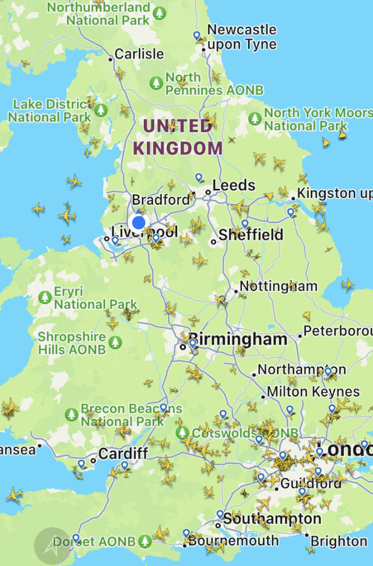

As we’re back in the climate change topic. Can some one please explain why we have to ditch our classics in the name of “saving the planet” when air travel and global commerce get free pass to do what they want
Just look at these two snapshots from Ship tracker and Flightradar24. Every marker is an airliner or a great big ship. This is going on all day everyday.
