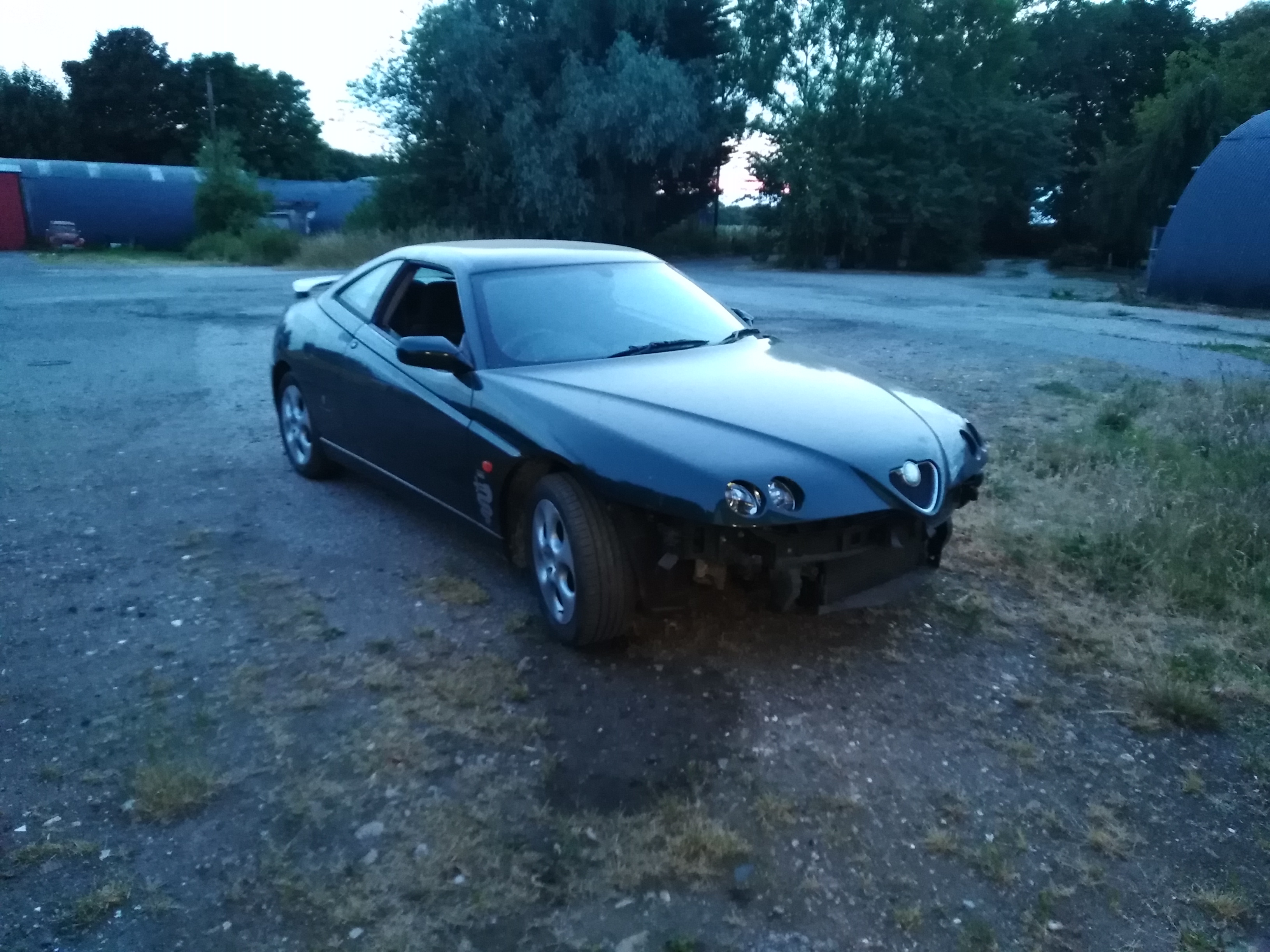

I bought this green twin spark earlier this year off Rich, originally I was going to fit an engine to it for him but as time went on and things got delayed I bought the car from him rather than delay the job any longer as my time was (and still is...) being taken up with the Dedra turbo rebuild.
It's a low miles (46k) car in great condition but had the dreaded "hammer in a cement mixer" soundtrack rather than the raspy ts engine note.
As I had an engine sat there from the bulk bought from Lou a while back then we figured that to be the easiest route..

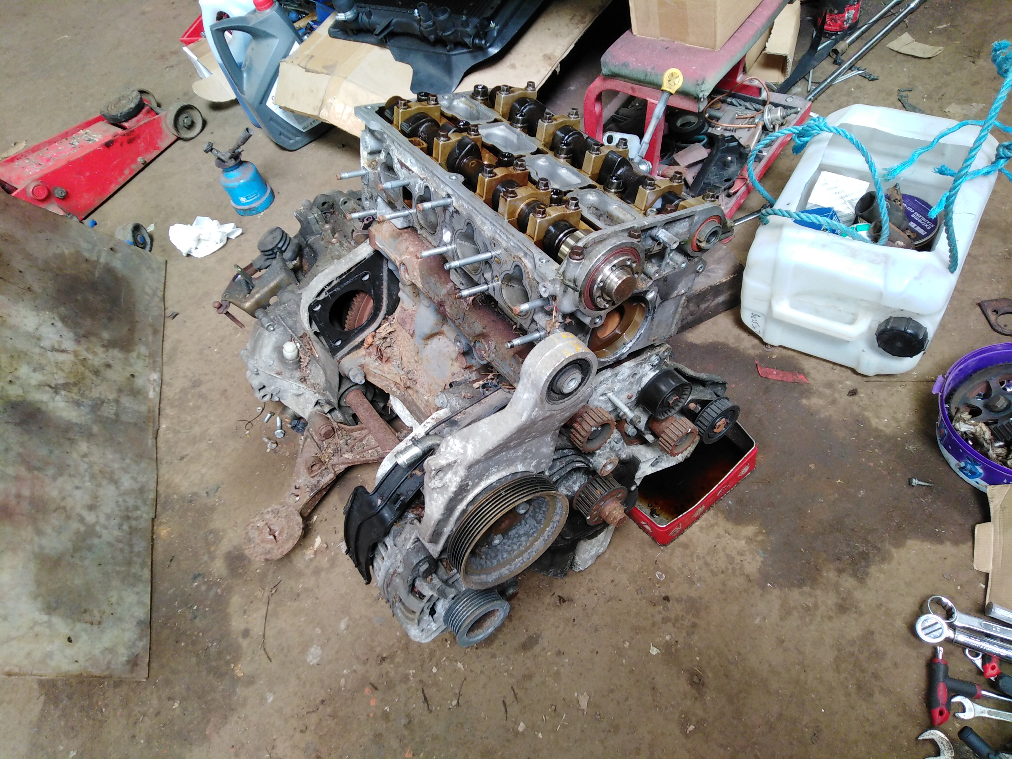

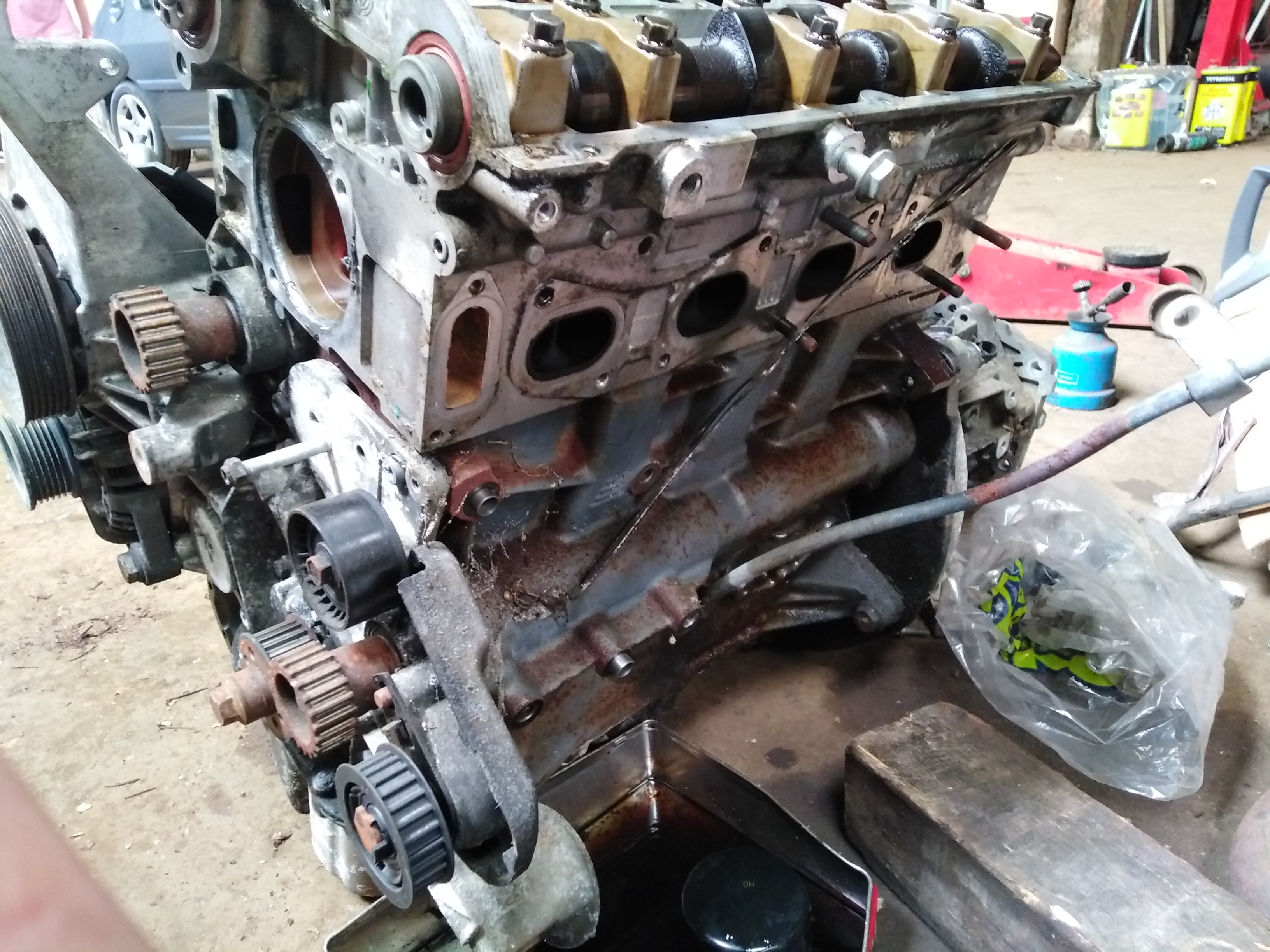

Anyway, the engine swap which had been waiting for the last few months finally began last Saturday as I am waiting for parts on the Dedra.
The plan is to rebuild the original engine and refit it so it keeps "numbers matching" even if that doesn't mean a lot to a car like this.
The engine I had available though is a CF1 motor which has the alloy top and inlet manifold, not the plastic parts as per my CF2 car.
Fitting the early type isn't as straightforward as it may seem as every system and connection is different.
Not only are the manifolds different (exhaust manifold too..) but every sensor has a different connection and all the water pipes are connected in a different place.
The simplest solution was to swap everything over from my engine to the donor, so that's crank sensor, knock sensor, cam sensor (meaning cam pulleys removed..) and leaving everything on the plastic manifold so the whole control system swaps over.
The front water rail is different, the thermostat too so both swapped. Even the power steering bottle is different although thankfully the pump itself is the same.
So with everything removed from the old engine that needs swapping you end up with this!

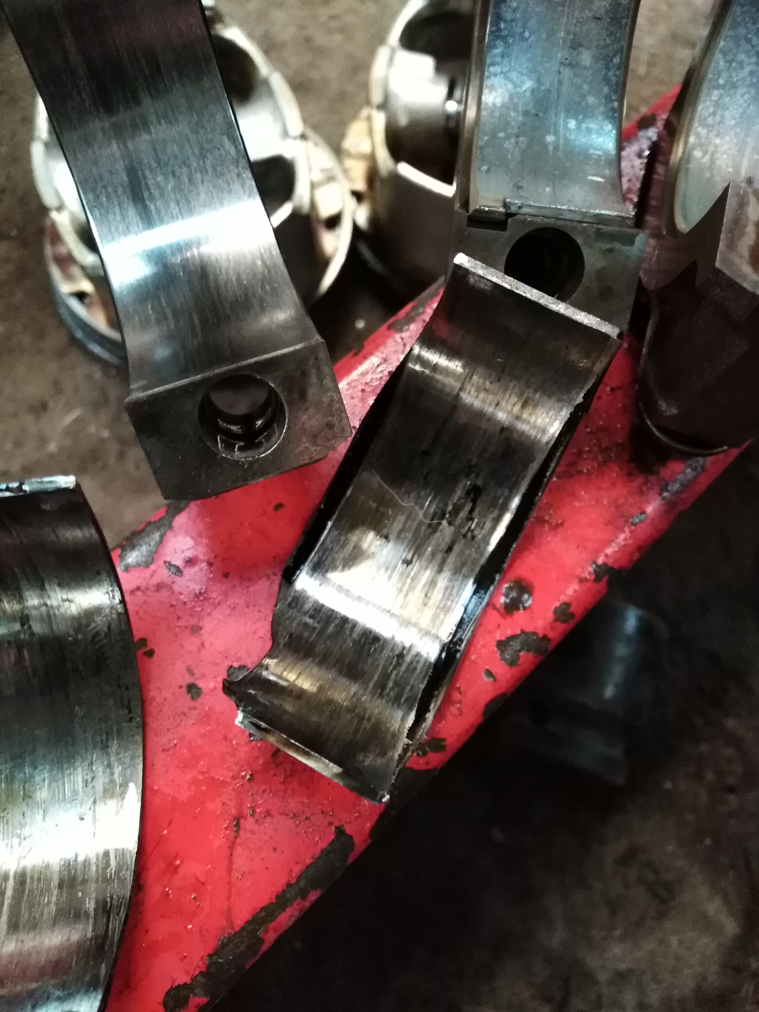

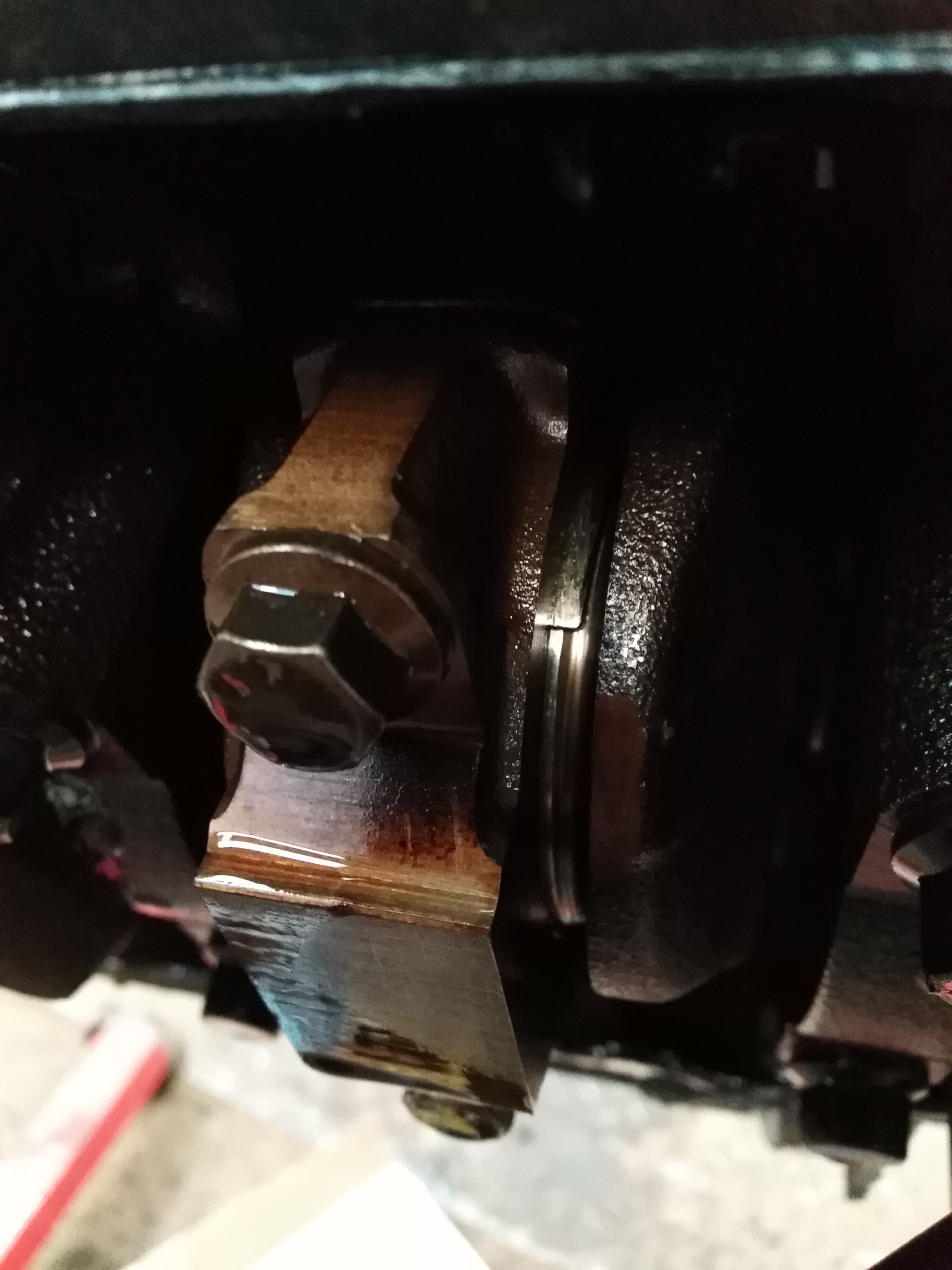

With winter around the corner and the plan to rebuild the original engine so it can go back in whilst laid up so it's ready for the spring I have stripped it down to have a look and see what was making all the racket.
The phrase "hammer in a cement mixer" was about right!
Numer 1 big end was very loose, not the bolts being loose, more that the shells had been worn away and turned in the con rod itself. One ended up on top of the other!
Re: GTV ts
Re: GTV ts
The shells mounting each other meant they had also gripped the crank at some point and have ground the con rod journal itself so not only is the crank knackered but the con rod is also done for.
Luckily I have a bottom end which I hope will have salvageable parts within.
Off work next week so should get a chance to access the situation.
Although I have a perfectly working engine in the car now I would like to rebuild the original motor so it should then last a long time..... Fingers crossed!
The other shells had also all but lost their bearing material, just a flaky surface left behind so was really in the death throws it seems despite, (or maybe because of?) the low mileage. Sometimes cars being stood does them no good.
Re: GTV ts
Btw Kev. Mine was number 1 aswell. the brg had spun and squashed out the side of the rod I think I posted a pic on my thread
									Alfasud Ti  1984
Re: GTV ts
and only 46k miles on the clock!
Maybe it had been run low on oil?
Re: GTV ts
That is the most likely cause Dave.
									Alfasud Ti  1984
