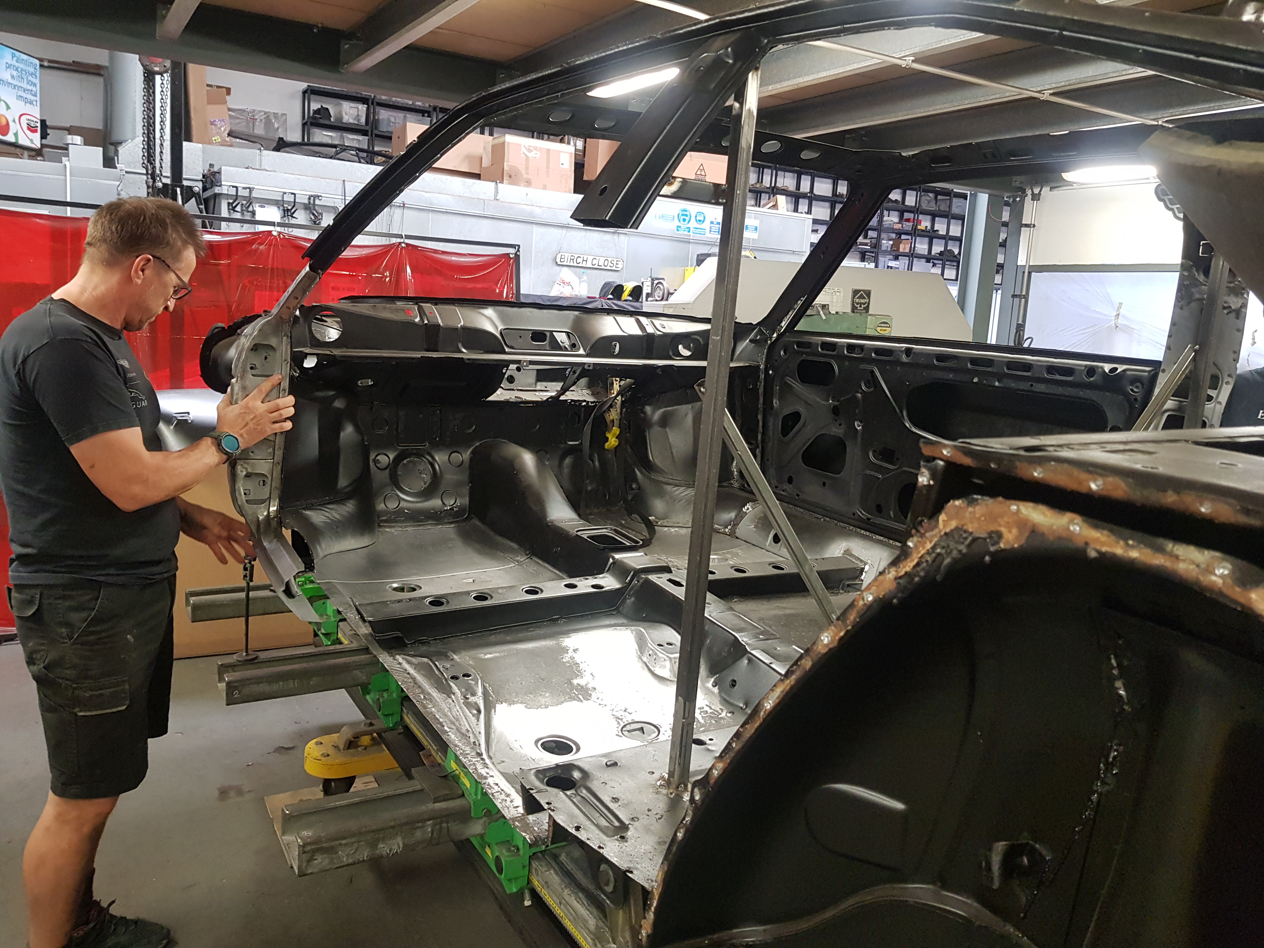

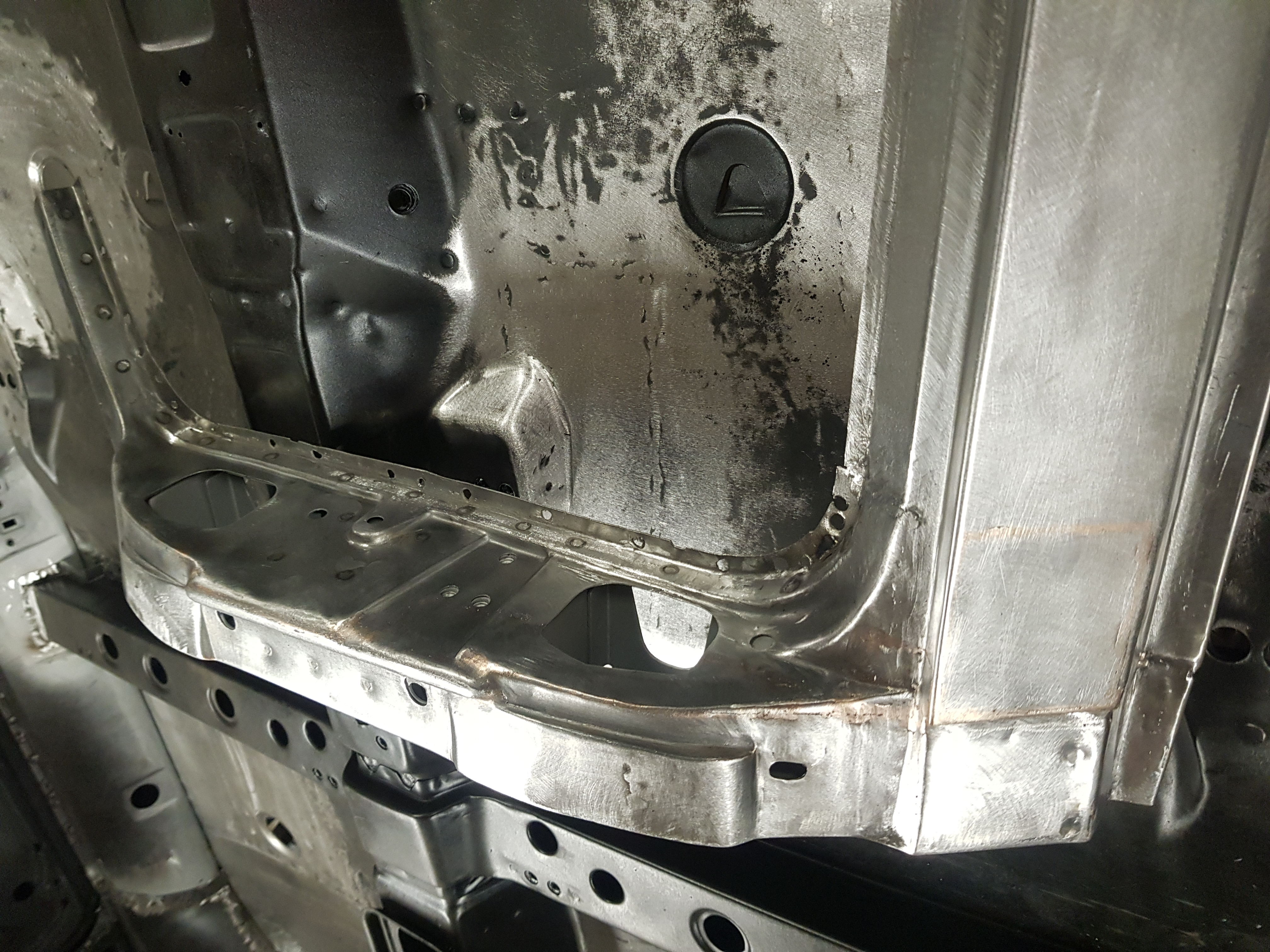

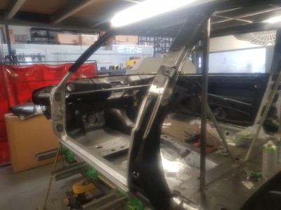

Here's another installment of "The Romance of Rust".
This picture shows the near complete nearside A post fabrication. You can't see it, but the main A post pressing is inside the shroud. If only I could have got a nearside frame as I did for the offside. The new shroud gobbled up another man day, I'll leave you to work out the cost of this single item............
The nearside floors have been repaired in the foot well areas but as you can see the outer edges of the floors are gone. The inner sills have been removed for repair in much the same manner as the offside were. Chris can be seen offering up the A post. The pattern outer sills sourced from Germany are going to need some fettling as their profile isn't quite right, but hey ho, better than nothing. Interesting to note that even with a dunking in aggressive chemicals adjacent faces of spot welded panels defy treatment.

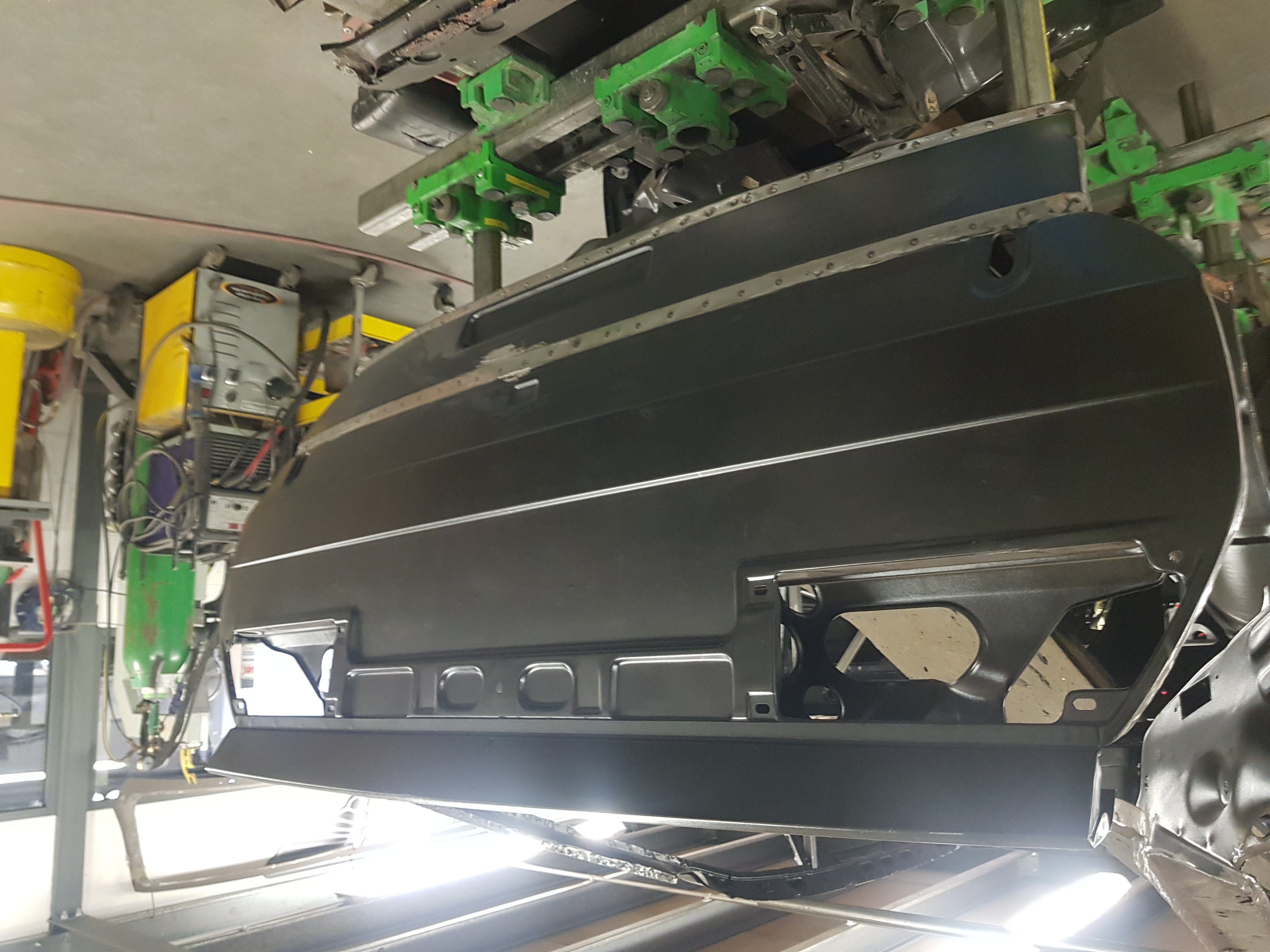

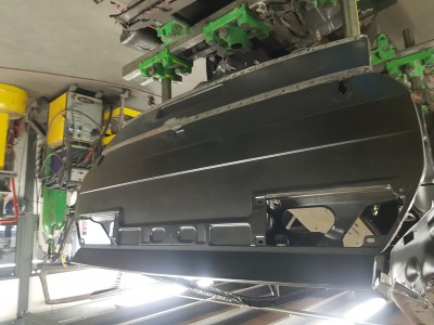

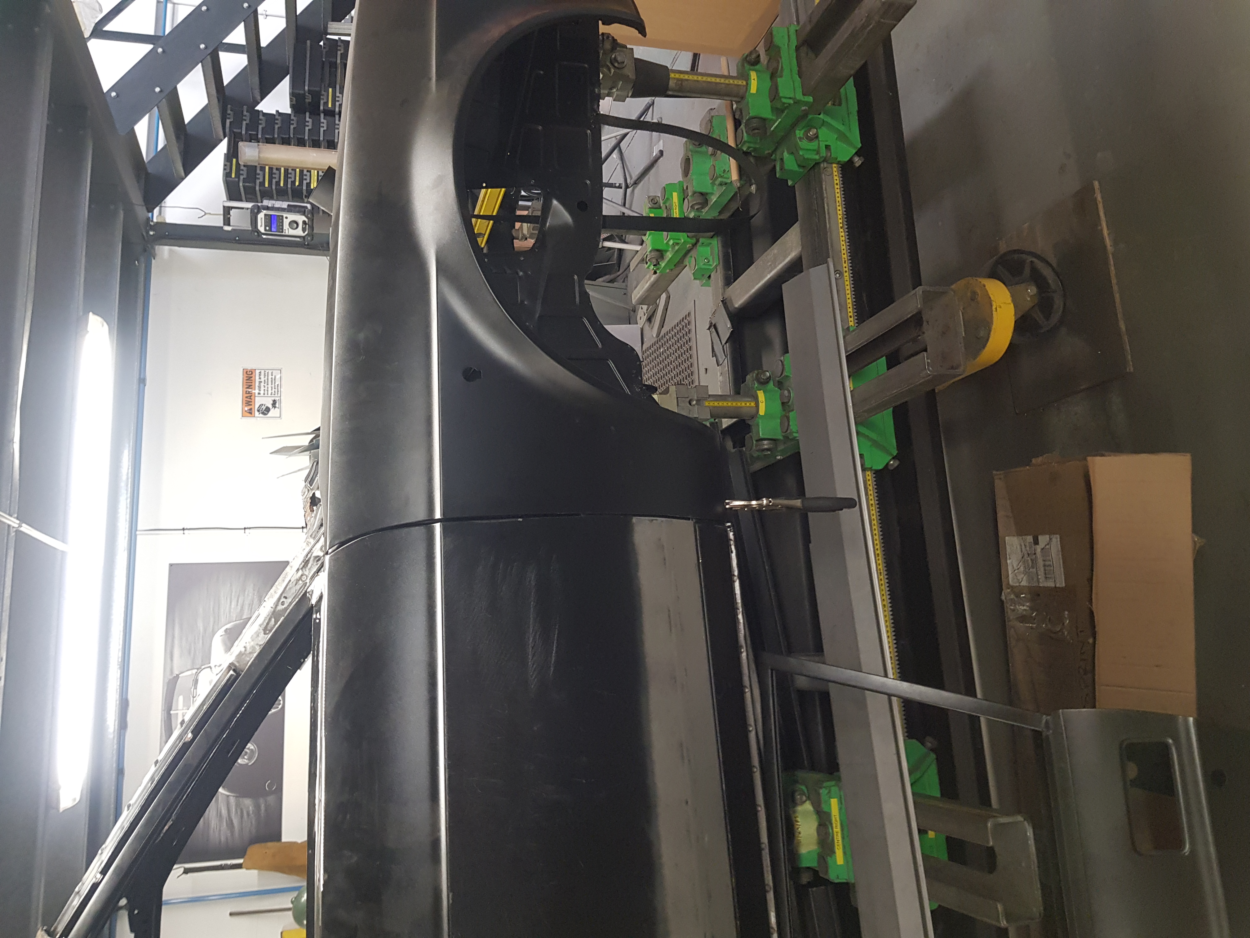

For some reason the next two pictures are wrongly oriented. Does anyone know why? If you click on them they open the right way up.
The offside front wing has been temporary installed for a profile check against the door, pretty good I think.
Not a particularly interesting picture, but here you seen the new rear panel & valance installed. The old inner valance had a cut out for the exhaust which caused a bit of head scratching as the new one didn't. Seems a saloon inner valance had been fitted in the past. And for the eagle eyed, it has been noticed that the rectangular recesses in the rear panel need to be made into apertures for the light bar!

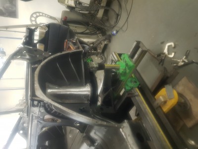

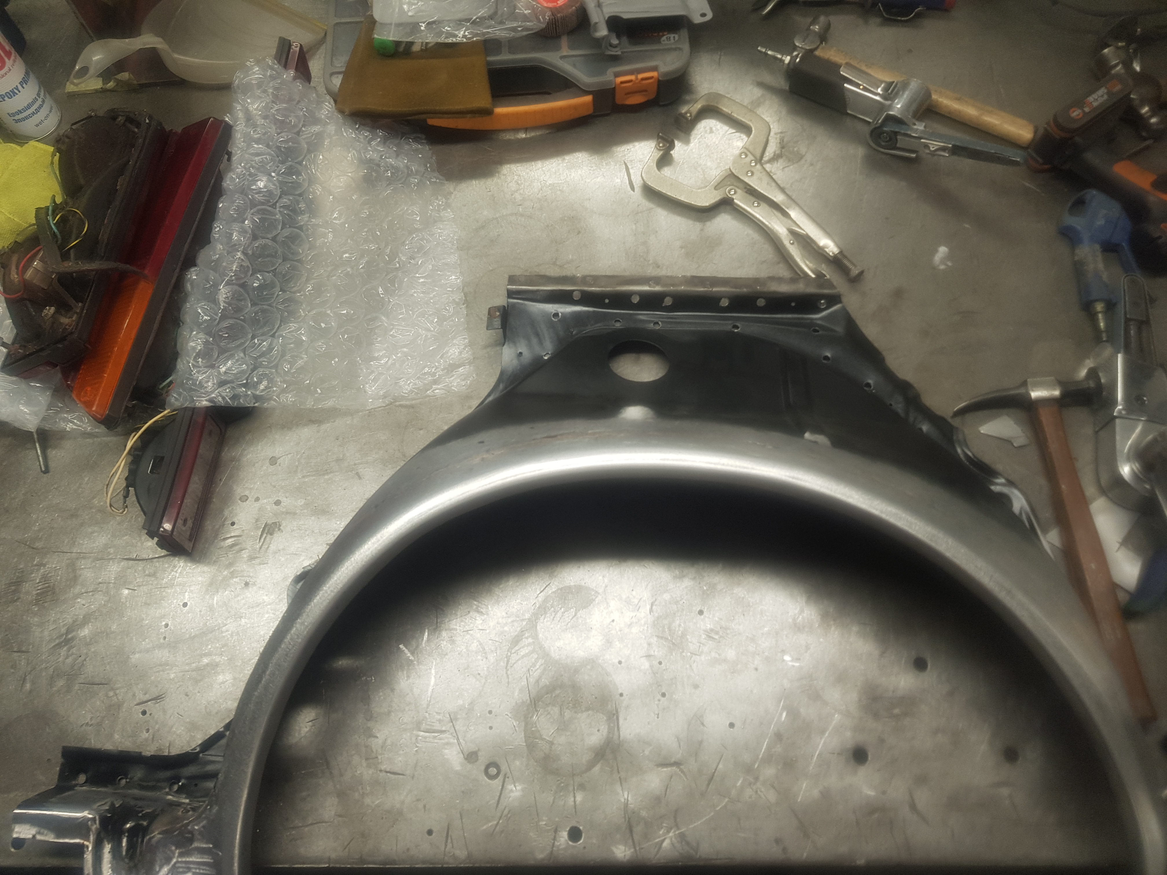

Latest update from the romance of rust. These pics were taken on Monday 27th June. As before , click and they will show correctly oriented.
The NS rear suspension turret wasn't as sound as first thought, so a new one has been fabricated from scratch.
Here a general view of the inner half of the inner NS wing

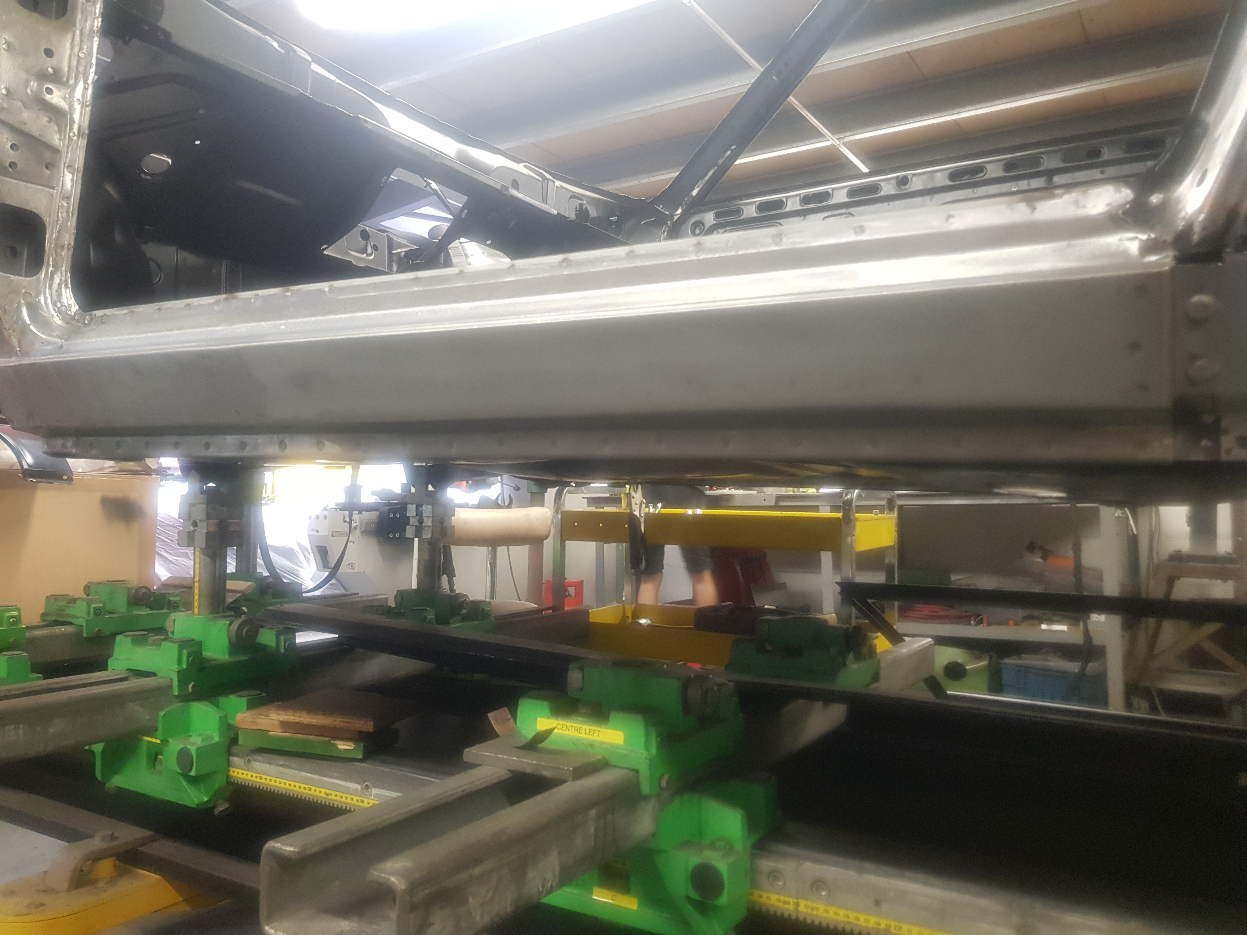

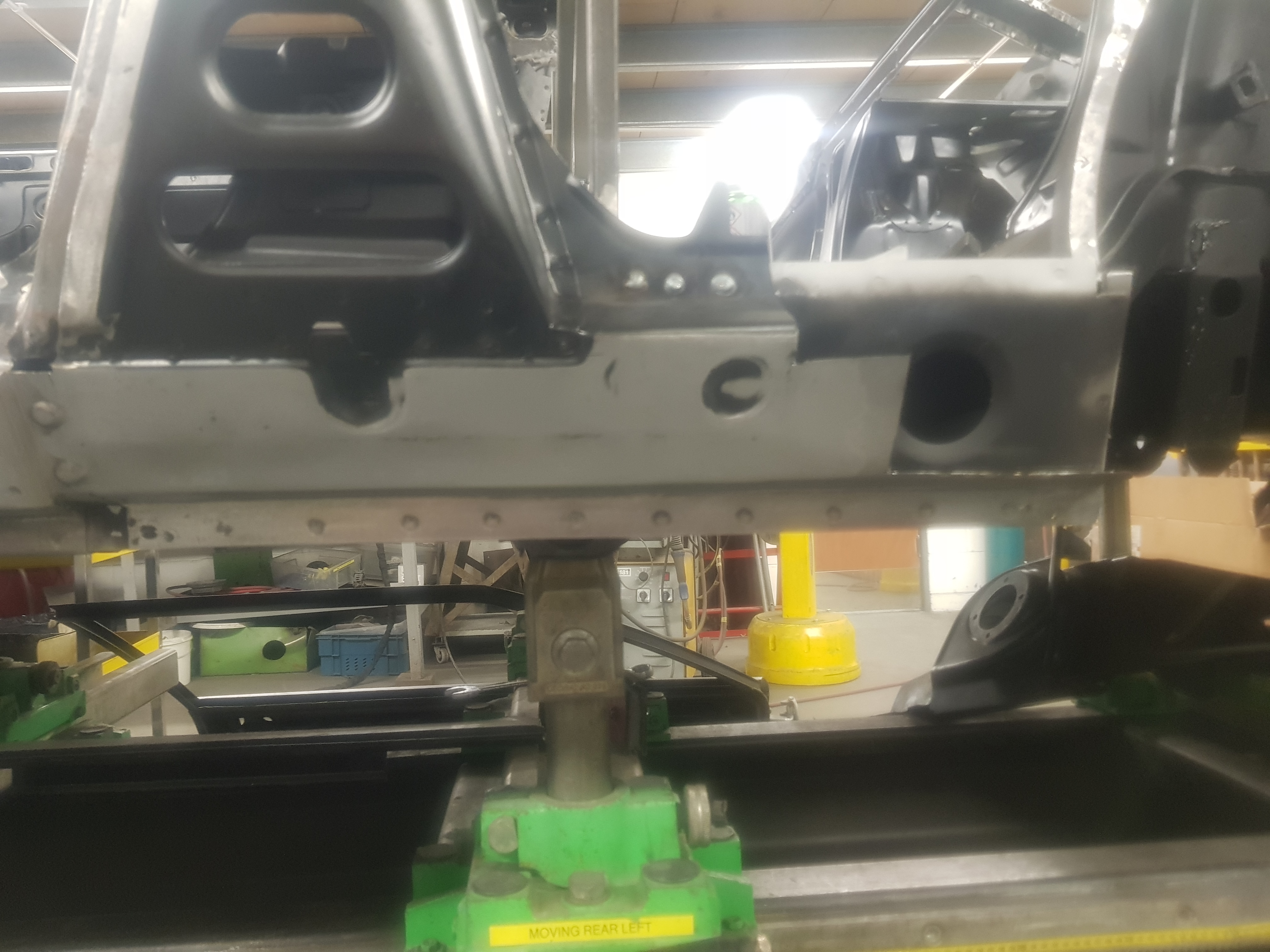

Here we see the NS front floor neatly repaired
The A post is now installed, together with the repaired inner sill, floor outer edge, the newly manufactured sill chord and reprofiled outer sills.
