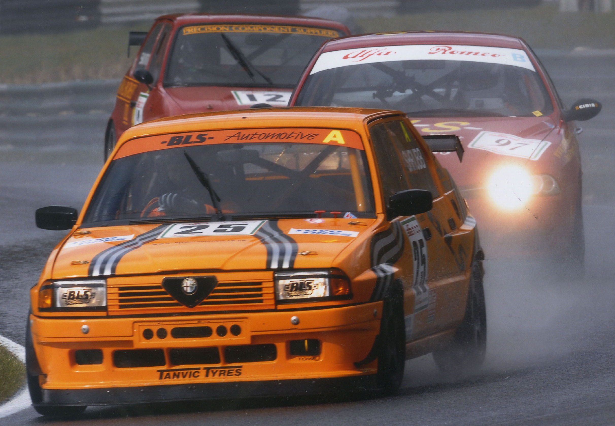

Hi All,
I'm really glad to see this forum prospering (well done to Kev and Shrew!) so thought I'd add a little contribution to it with some words and pictures of my 33 race car. I've got loads of photos - most of the action are purchased from the race day snappers so are 10" x 8" but as the car was originally built before the digital camera age I'll have to get busy with the scanner for some of the early build shots! So, build photos to follow at some stage!
My father (Tom at BLS) and I built the car in the winter of 1997 to replace our successful Sud Ti that we ran in Class C of what was then the Alfa Romeo Owners Club Championship. We were able to transfer pretty much all of the running gear at the time - especially as we were already running a 33 rear beam on our Sud (converted to run 2 1/4" coil overs and lightweight discs). The main challenge therefore was the body - getting as much weight out as was allowed and sensible, packaging the main components with weight distribution in mind, accommodating a wider front and rear track (wider arches required). The donor car was a Mk3 car of 1990 vintage - its main fall from grace was to have turned from Alfa red to Salmon Pink in colour. This essentially rendered it a £400 bargain at 7 years old bought from Cubleys of Ainsdale (a previous well established Alfa dealer)!
I'll post up a few pics of the car as it has been in the last few years, then if there is sufficient interest in hearing specification stories I'll talk in more detail about each area of the car in subsequent posts - covering engine, transmission, suspension, bodyshell/bodywork, etc.

Here's an overview of the car's specification as it ran until the beginning of the 2012 season - where we converted to 16v (I'll cover that later). I had lots of success with the car - winning Class B overall (now A2) on several occasions and lots of class wins. On the right day (right circuit, right conditions - but not always in the wet) I've won overall but whilst 8v that got more and more difficult against 16v engined cars - not to mention the super/turbocharged, Supertourers and large capacity V6 engined cars.
With regards to power, we've always used known conservative rolling roads so whilst others have claimed more from 8v engines its not shown on the track where it matters. A friend of ours worked at Cosworth F1 when we were upgrading the 8v engine in 2001 and he 'designed' the head modifications - these included offsetting the exhaust valve to allow for 44.5mm diameter intakes plus larger than standard exhaust valves. The cams were also analysed (profiles based on a Judd profile) and deemed well suited to the valve sizes. He also specified the exhaust diameters and lengths using Cosworth software. It all worked rather well together and only really the march of time (and opposition) meant that 16 valves became required - way earlier than I went 16v but that was due to depth of pockets!
Anyway, here's the specification:-
