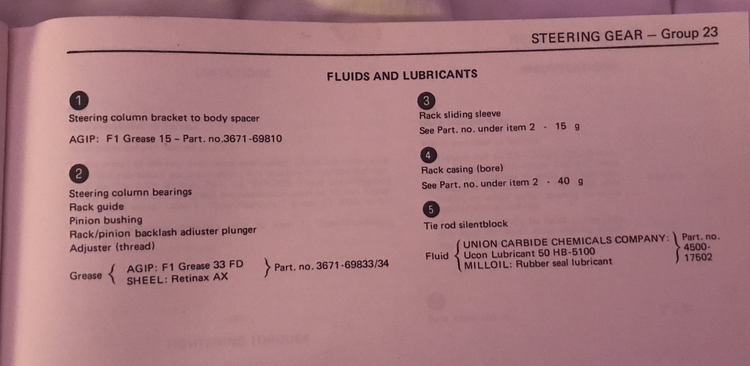

I don't want to hijack this thread, but it's a more or less related question. What kind of grease do you guys put on the rack? I'm planning to renew the torn boots/gaiters as well, but since the grease has been exposed to the elements for almost 2 decennia without protection it seemed beneficial to me to replace the grease as well.
Re: Help Please..
Hi A-J. Any good quality grease should do. But If you give me 10mins I’ll see if can dig out the actual spec.

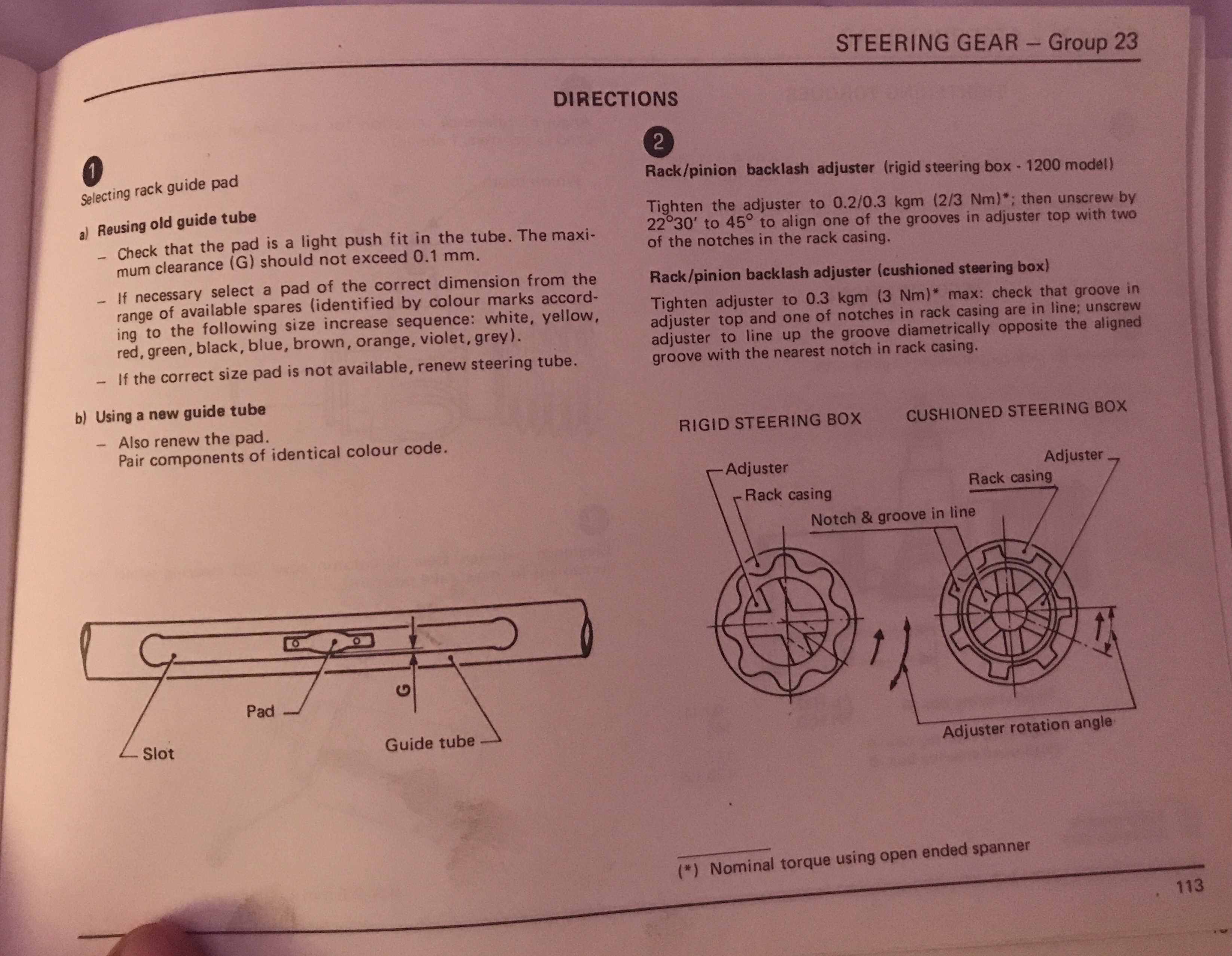

Re: Help Please..
Please find attached the tech details of rack inspection including the recommended grease spec.

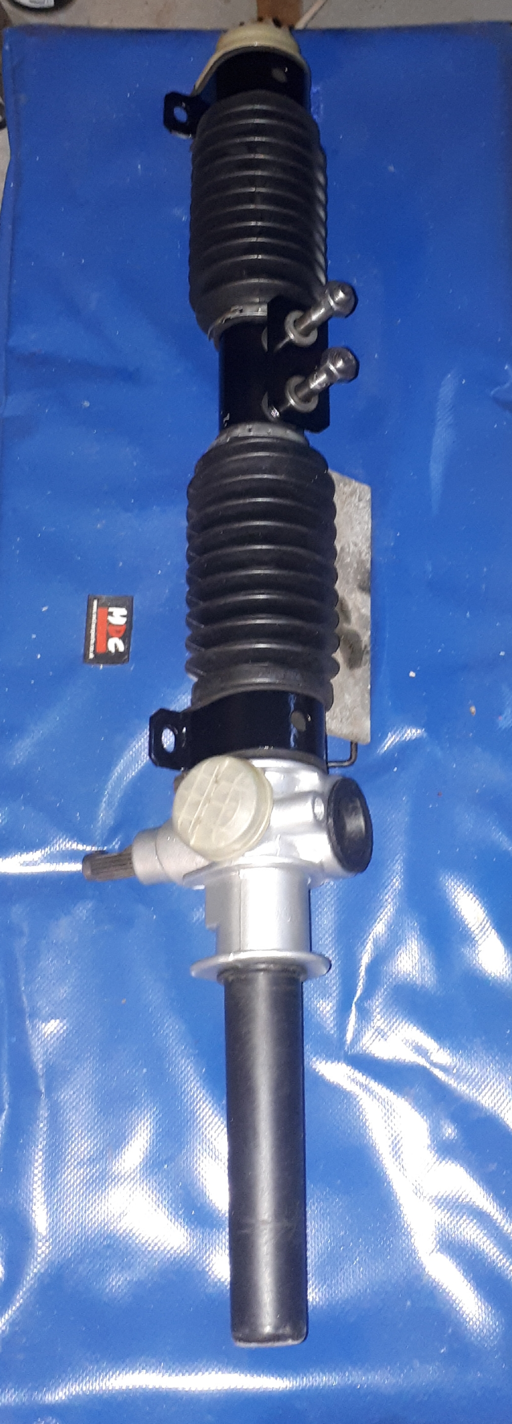

Just like to tank all who replied to my post and enclose picture of my refurbished steering rack.
Thanks.
Cathal. :)

Looking very tidy, nice job! Not sure what year car you are working on, but to my knowledge the clamps to assemble the steering rack to the bulkboard, used to be coloured gold-ish (Cr6). In order to reproduce a similar appearance and at the same time have an acceptable rust resistance you could have those clamps treated with Cadmium plating. The current gold coulored Cr3 replacement for the no longer allowed Cr6 has a significantly shorter corrosion resistance.
Sprint67
Posts: 31
Joined: Thu Mar 08, 2018 4:48 am
Location: Ireland.
Re: Help Please..
Post by Sprint67 »
Hi A_J. Thanks for your post. I have an 88 Sprint and yes your right the holding clamps were originally a goldish kind of colour, but as I could not replicate this I decided to go for the black. They were rusty enough too before tidying up, but I though the black look reasonable good anyway so I settled for this.
