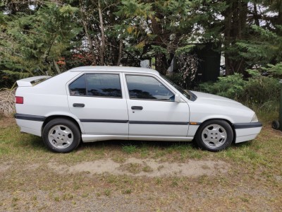

I've been talking with my son (and co-owner) over the weekend and now we're not sure whether someone has been monkeying around with the suspension - and whether that means the correct specs will be wrong. It looks lowered at the front and raised at the back. Could be someone has put a standard 33 lowering kit on it. I'll take a photo and upload.
Re: P4 Wheel Alignment Spec?
That’s the std stance for P4s they always looked looked high at the back and low at the front. And they drove like nothing in the drive train lined up properly .

Here's the photo. So this is standard?
I'm loving the way it feels with the 4wd - yes there's all the juddering on tight maneouvering, braking, ... but I punted it around a tight corner and it just pulled out of the corner obviously pushing with all 4 wheels!
That stance looks correct For a P4

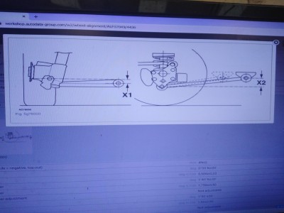

Here you go
Other things before checking are filling the fuel tank & also check what load is needed in the car - it’s stated in the spec with weight bags in the seats and foot wells
