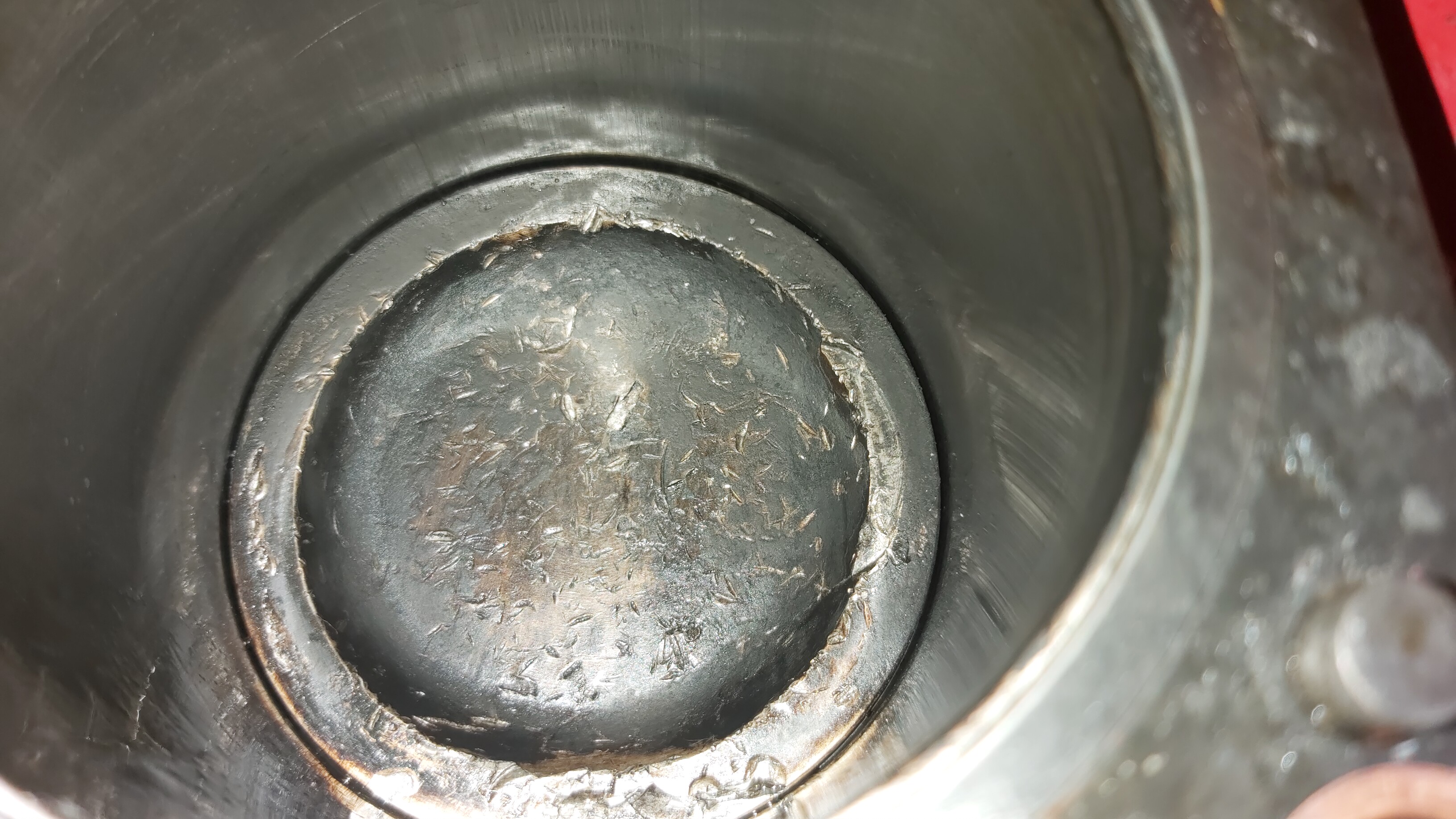

Sorry guys, another appeal for help. After a bit of cam belt misfortune (long story) got the engine rebuilt, and it was ticking over like a wee sweetie. Blipped the throttle, it coughed then sharted fuel and started ticking like a lolly stick in bike spokes. Bugger!!!
Basically a washer somehow got into the inlet manifold on cylinder 1 and was ingested. 😭😭😭😭😭😭😭😭
Head is snagged, but have spares can rebuild that. Need to double check the block, but may need at the very least a piston, possibly a short engine. I used to have a spare but gave it away ages ago as needed the space. Sods law in action......
Does anybody have either an 87mm piston or a short engine available?
I feel an utter tool. 😩😩😩😩

TBH. I’ve seen a hell of a lot worse. I’d remove the piston and give it a gentle fettling on the crown Just to remove all sharp edges on the damaged areas as Long as the lands of the piston haven’t collapsed. I’d Consider using that piston again. it’s called “Patina”

LooLooSud33Spider wrote: Tue Sep 29, 2020 9:03 am TBH. I’ve seen a hell of a lot worse. I’d remove the piston and give it a gentle fettling on the crown Just to remove all sharp edges on the damaged areas as Long as the lands of the piston haven’t collapsed. I’d Consider using that piston again. it’s called “Patina”
Kind of what I am hoping, however if the bore is scored (and I don't think it is........) then happy days.....
Si puo diventare Alfista
Re: Engine/piston help
If the block Does have a few small marks. Before writing it off give it a good hone to see if you can clean it up
On the piston don’t remove too much metal your not looking to make all the damage disappear just clean Any rough edges on the crown. You only need to use a small needle file And make sure all the rings still spin freely in the grooves .

LooLooSud33Spider wrote: Tue Sep 29, 2020 8:02 pm If the block Does have a few small marks. Before writing it off give it a good hone to see if you can clean it up
Cleaned up piston and all seems to spin freely ok. Going to get a cylinder head re done fit up then see what transpires. I will then have two good refurbed heads (the other side was done just before this happened - in fact I had only just finished re-assembling the engine........)
Now if I then need a short engine, at least I will have two known good heads to transplant over......

Well, it’s fucked. Crankcase back pressure evident yet compressions are reading 180-190 so can’t work out what has happened.
New block needed methinks
