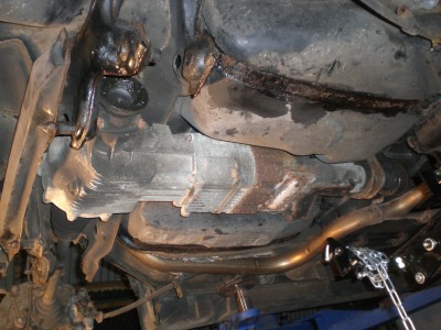

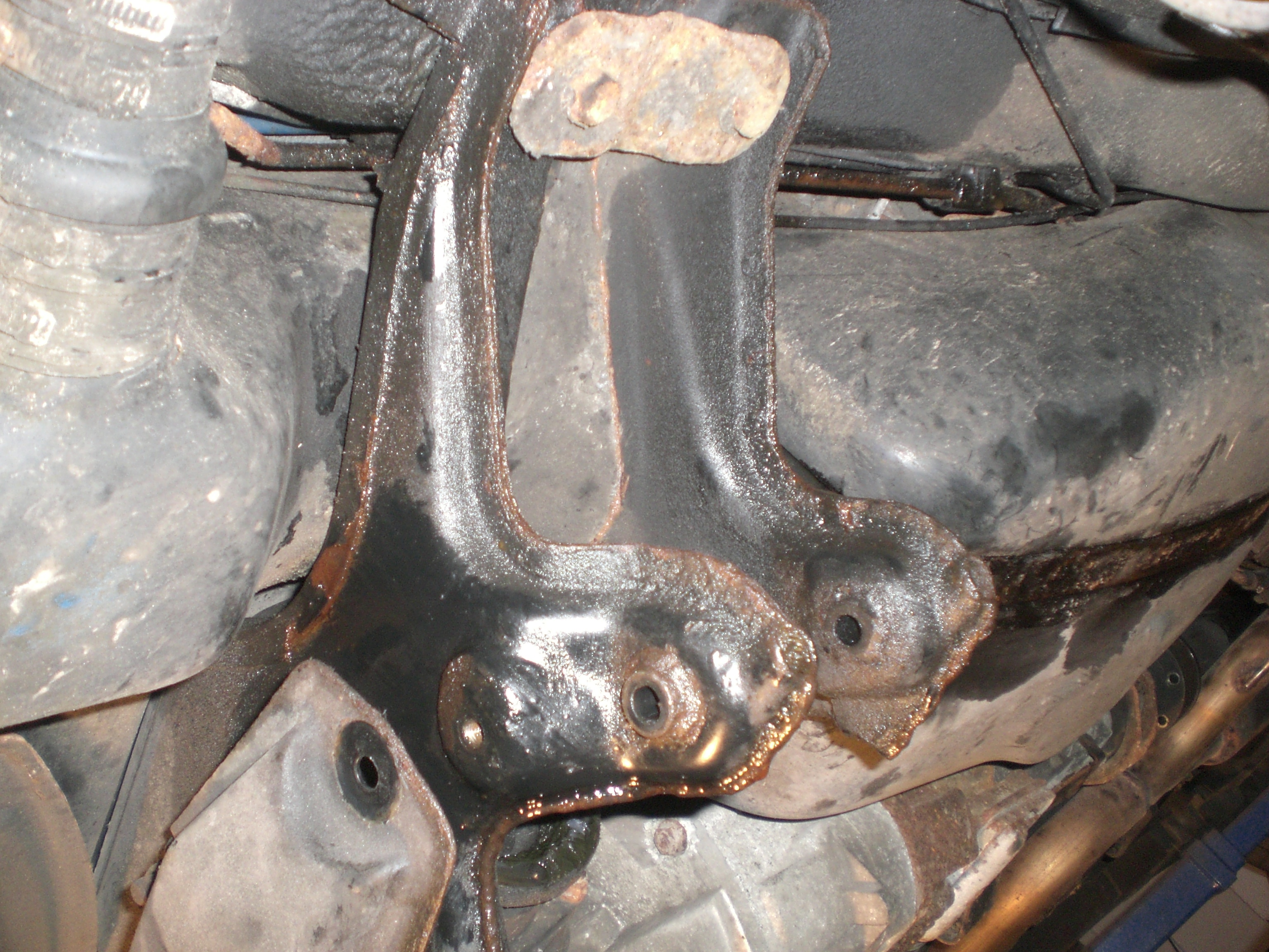

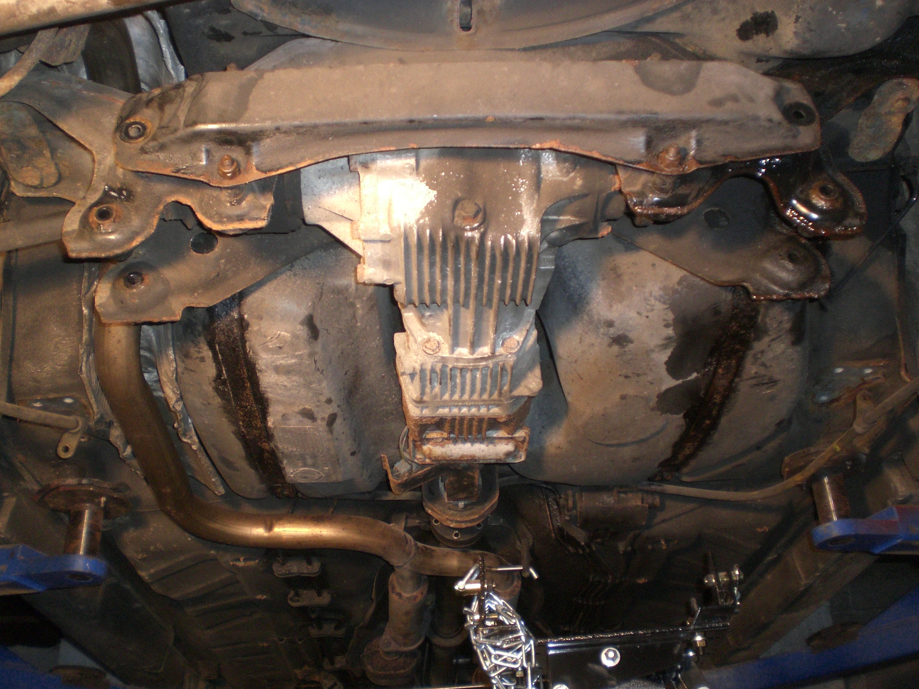

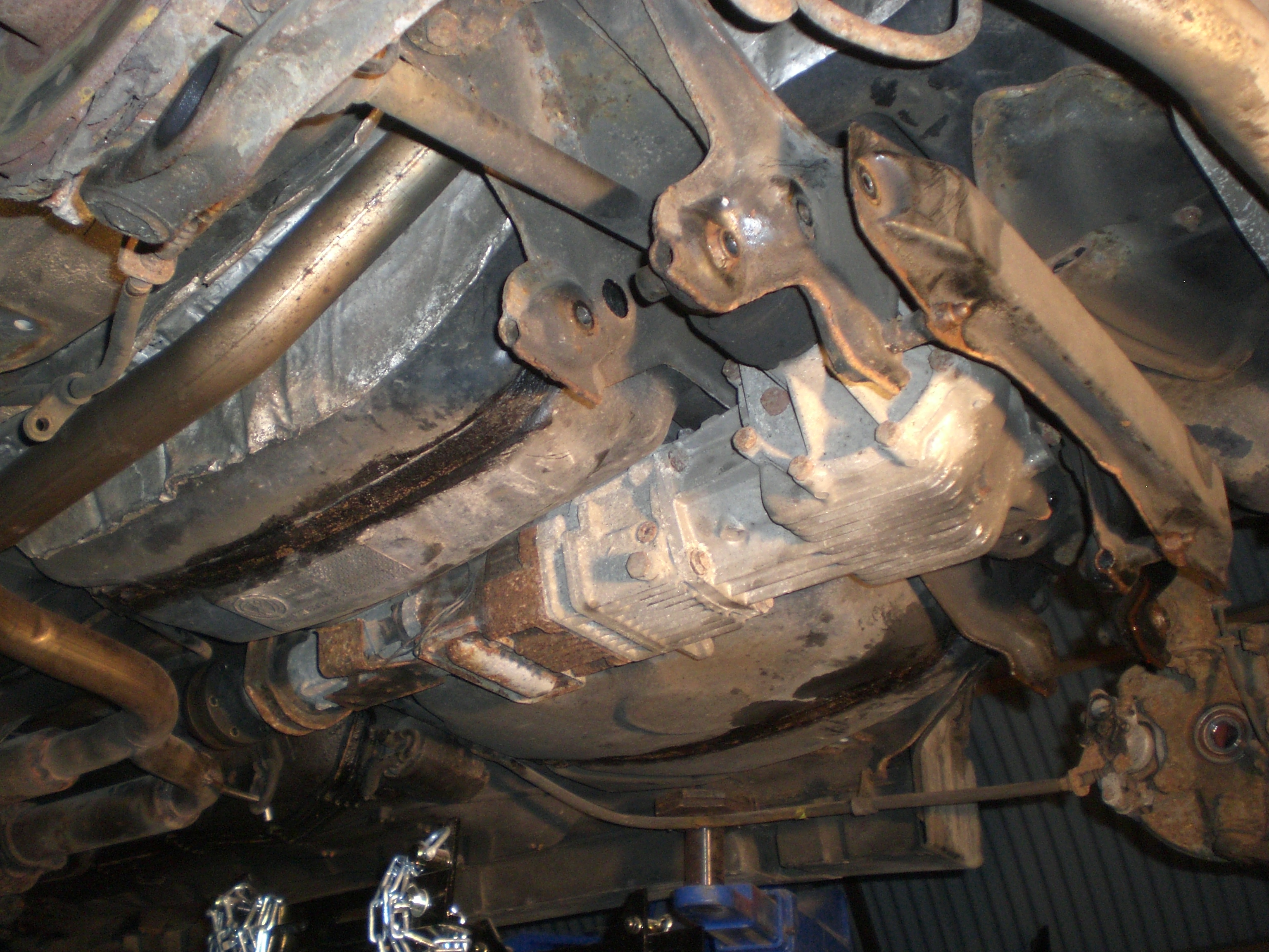

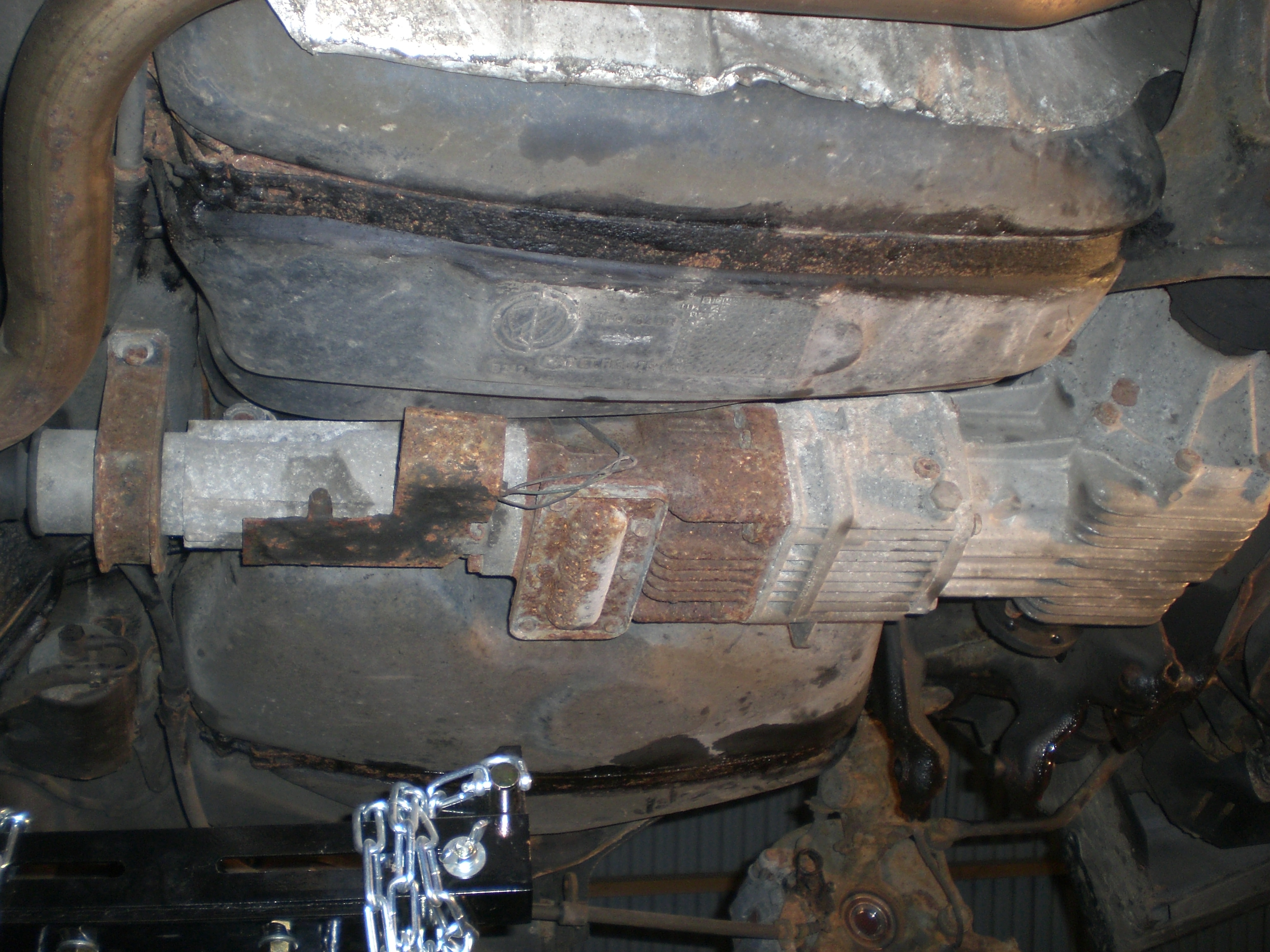

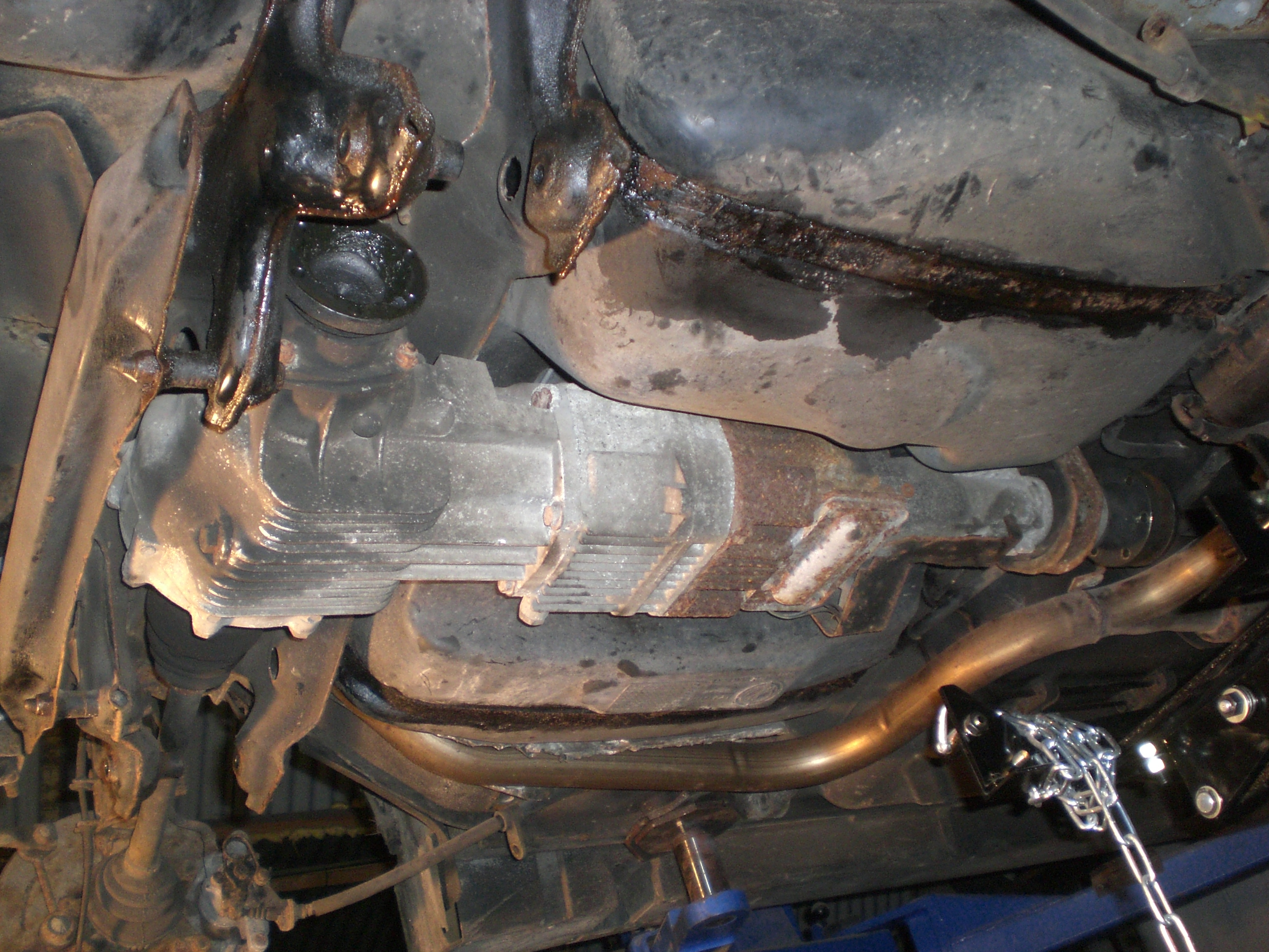

here's some of the pics from when it was coming down J, the rest of them were taken on your camera so a chance to test your new photo editing skills :D
must say i'm impressed with the attention to detail given by andy and bob to the job, not like anyone is going to see it. they did a great job in cleaning and painting all the parts 8-)
