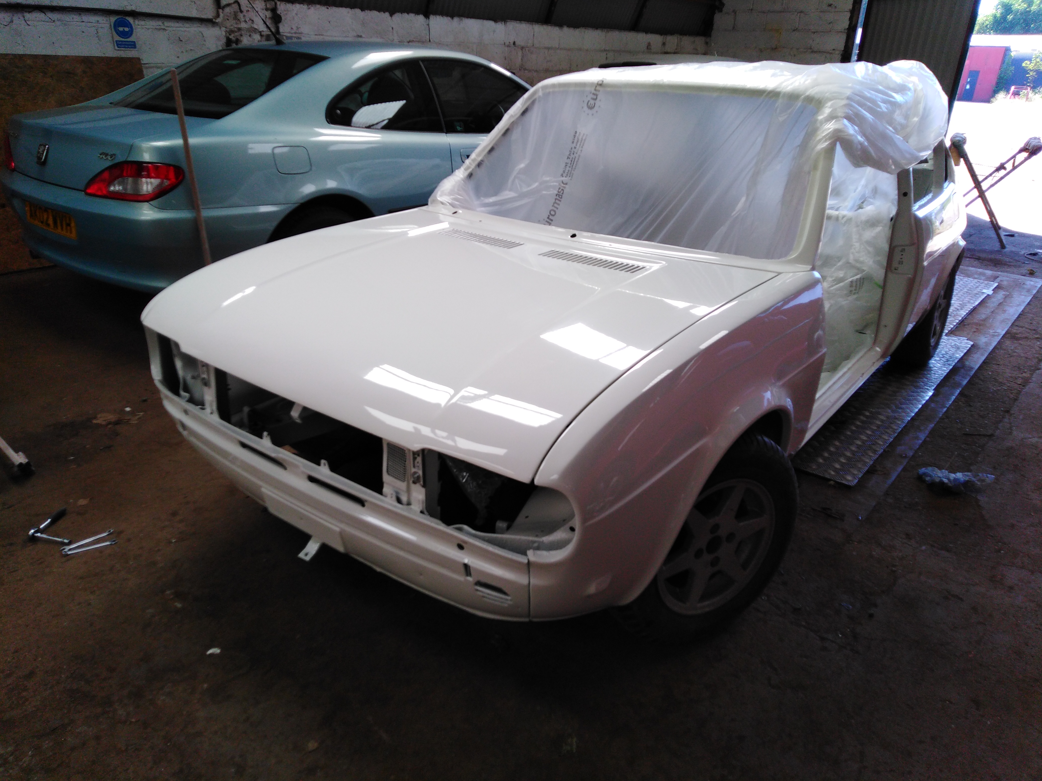

Today the task was to flat and polish up the front wings and rera hatch, the last panels needing the laborious not to say torturous process in this heat, then to fit the wings and bonnet. In this heat I'd be happy to call that day done.
Polishing process went well, no dramas. Nothing fell on the floor! :lol:
With everything ready an issue reared up, can you spot it!
The front shocks had been built up as a means to move the car around but the washer that should sit on the shock tube underneath the top rubber mount wasn't fitted so although the shock couldn't pull through and collapse it did allow the tube to come up into the engine bay, that would certainly make a mess of the bonnet! :o
A root around in my parts stash/junk pile/rare parts bin :roll: came across a pair of suitably sized washers, quite a big diameter needed to slip over the shock tube but sit on the shoulder. No big drama, ni e and easy access with the wings off :lol:
Rest of the day went OK, wings and bonnet lined up nicely still and makes another step closer to being a car again.
Just leaves front doors to fit and build back up, cage to fit the rear half in for safely transportation and we're about done.
Might be Saturday or Monday next week, nearly there...

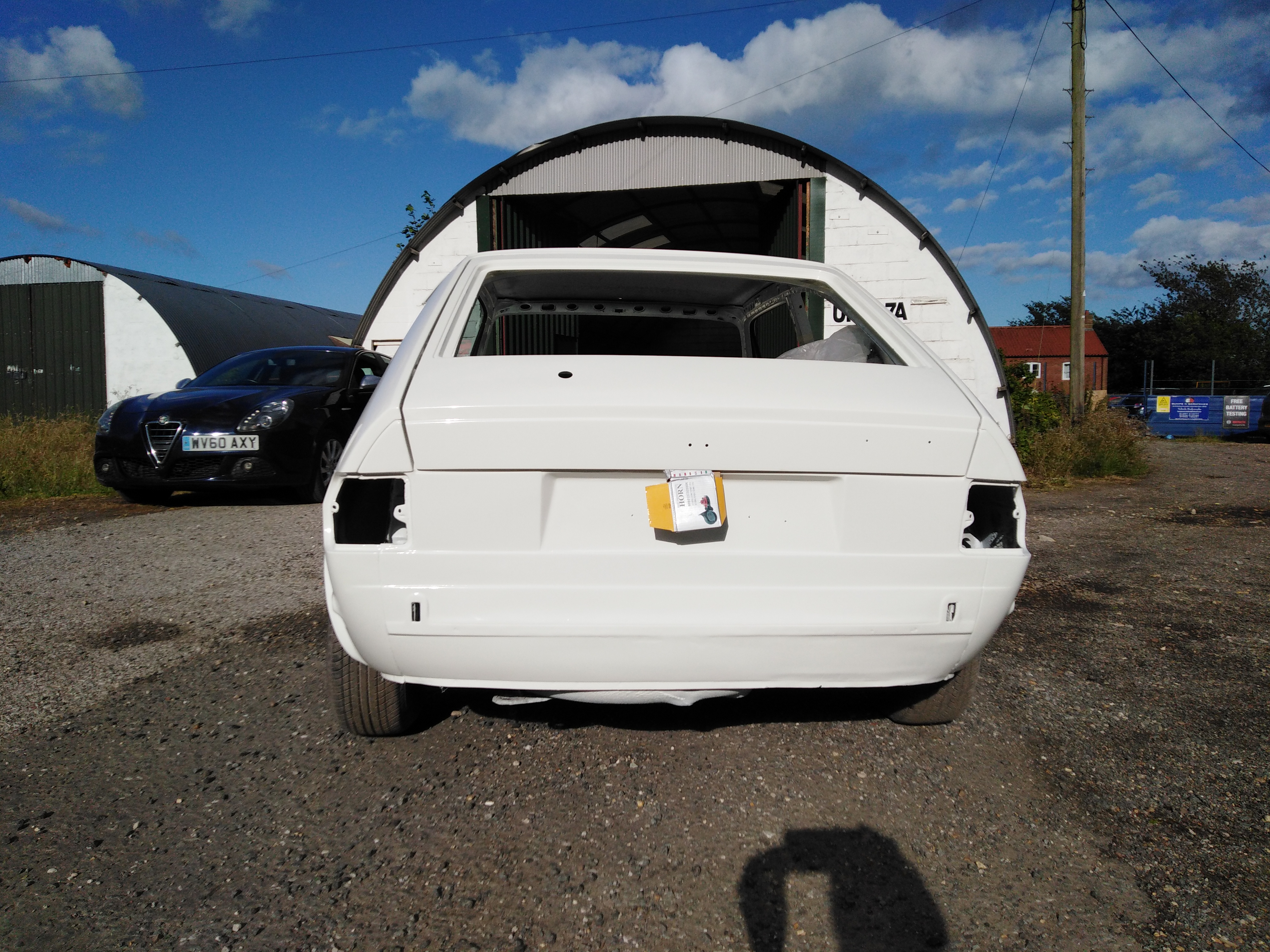

Task for today was to fit the rear hatch and doors, then build the doors back up with glass etc.
Happy to say the doors went on without problem, as awkward as it is to hold a door on as well as put the bolts in it can be done with a bit of planning. A tyre placed on the floor, smooth sheet of wood with a large towel on that made a perfect platform at the correct height. A stud in top and bottom fittings helped align it, plenty of masking tape on any vulnerable edges just in case and they went on seamlessly.
The passenger side we'd already decided needed a spacer top and bottom but could I find any.. Sure I have some somewhere :roll:
Making some out of mild steel is OK as long as you paint them or they'll soon rust, which isn't ideal! A handy sheet of aluminium made the perfect choice, just the right thickness, easy to cut and won't rust. With both the hinge face and door aperture painted oxidisation of the dissimilar metals won't be a concern either.
With the doors on then just a case of building it all back up, glass got a good clean before going back in which always helps, window runner I'd painted satin black already along with the weather strip.
I have also painted the A pillar gutter trim in the satin black but left my pop rivett gun at home so that will have to wait until next time.
Other than that, it's done. 8-)
Colour does look very nice in the sunshine, as a visiting Rob agreed.
Meant to get a snap parked next to the Imp but got distracted then forgot!
Waxoyl in the door bottoms just to finish off 8-)
