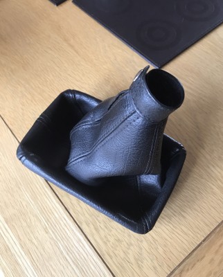

Are your stuck with a nasty ripped rubber “Unobtainium” Gear lever Gaiter on your S3 sud ? Then try this for size It’s from a Fiat 20VT Coupe. (But I guess any Fiat Coupe will do) Initially it was a very tight fit but with a little reprofiling of the corners on the suds steel frame It fits rather well and is certainly better than a ripped std rubber one.

Very nice, much better looking.

That looks nice. ;)

Thanks Keith. Certainly better than a split rubber one. I’ve got a decent std one but I’d rather keep it safe.

I feel certain i have a similar leather one that I kept to do that. Mainly in case i did not find an original one.
I will have to dig it out as that looks very good.
