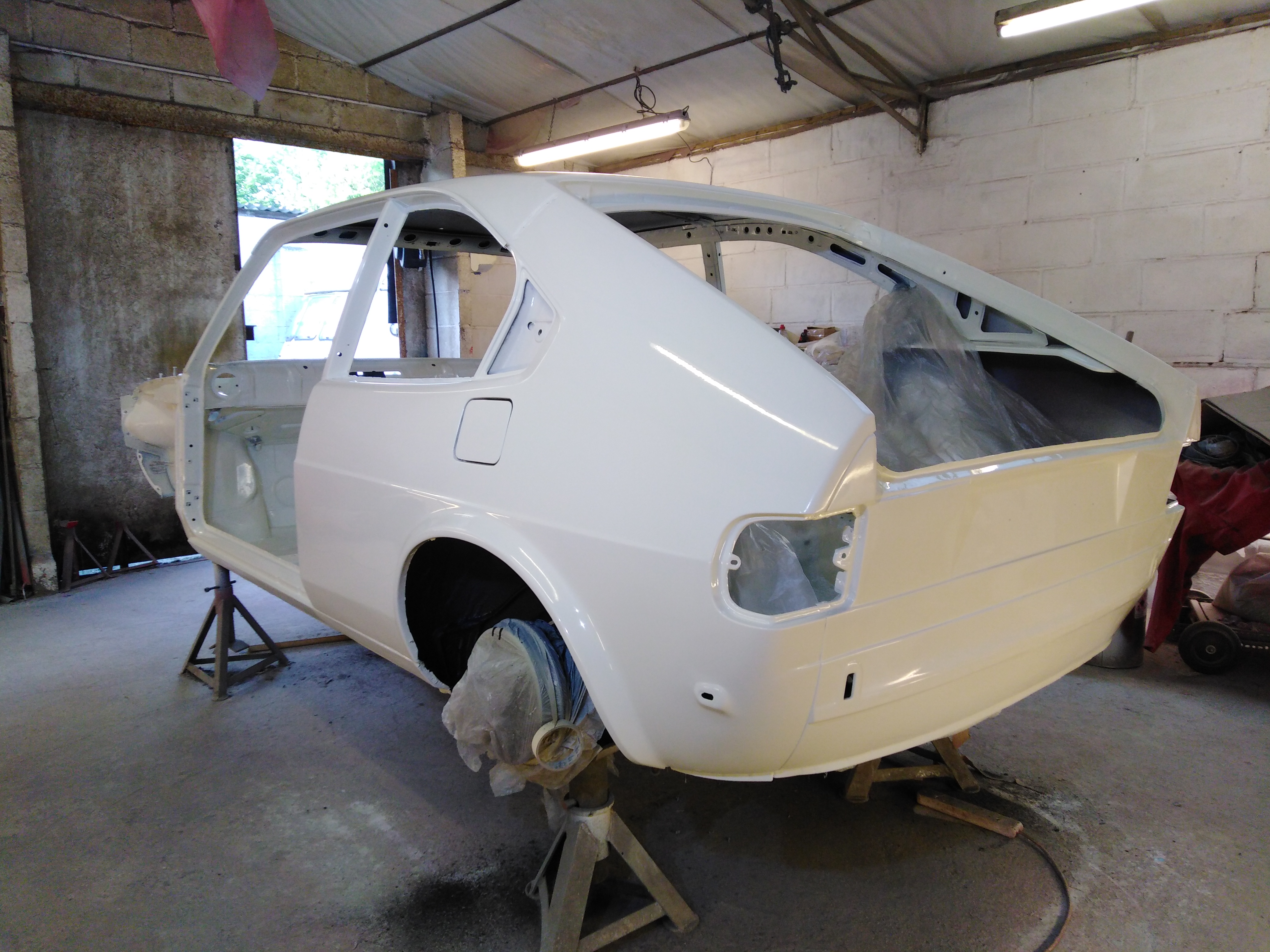

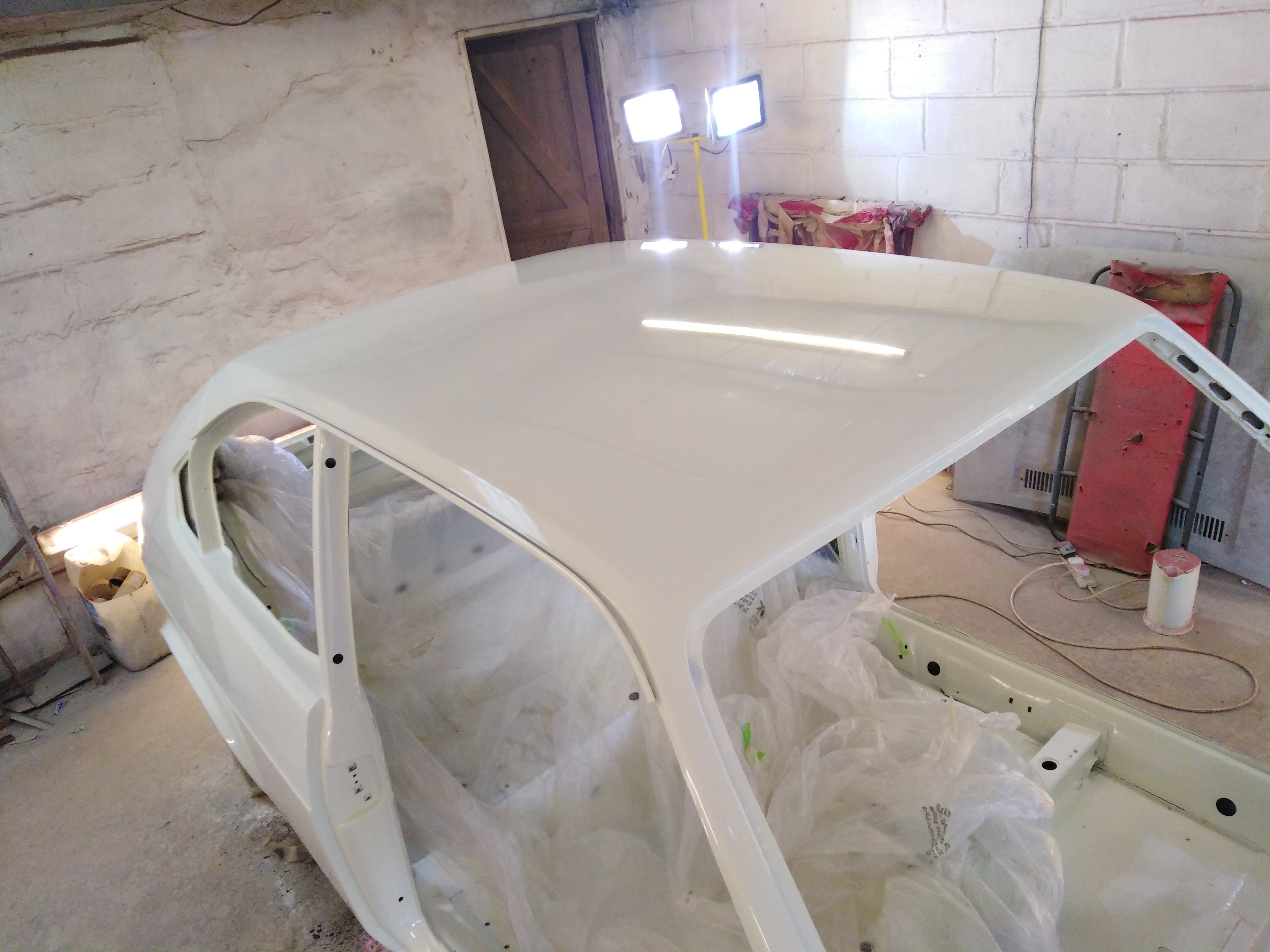

Shell got flatted, mopped and polished today. Hard work but necessary. Is kind of an odd thing to do, scuff up nice fresh paint but although the shine doesn't increase hugely the feel of the paint does, smooth as a babies bum

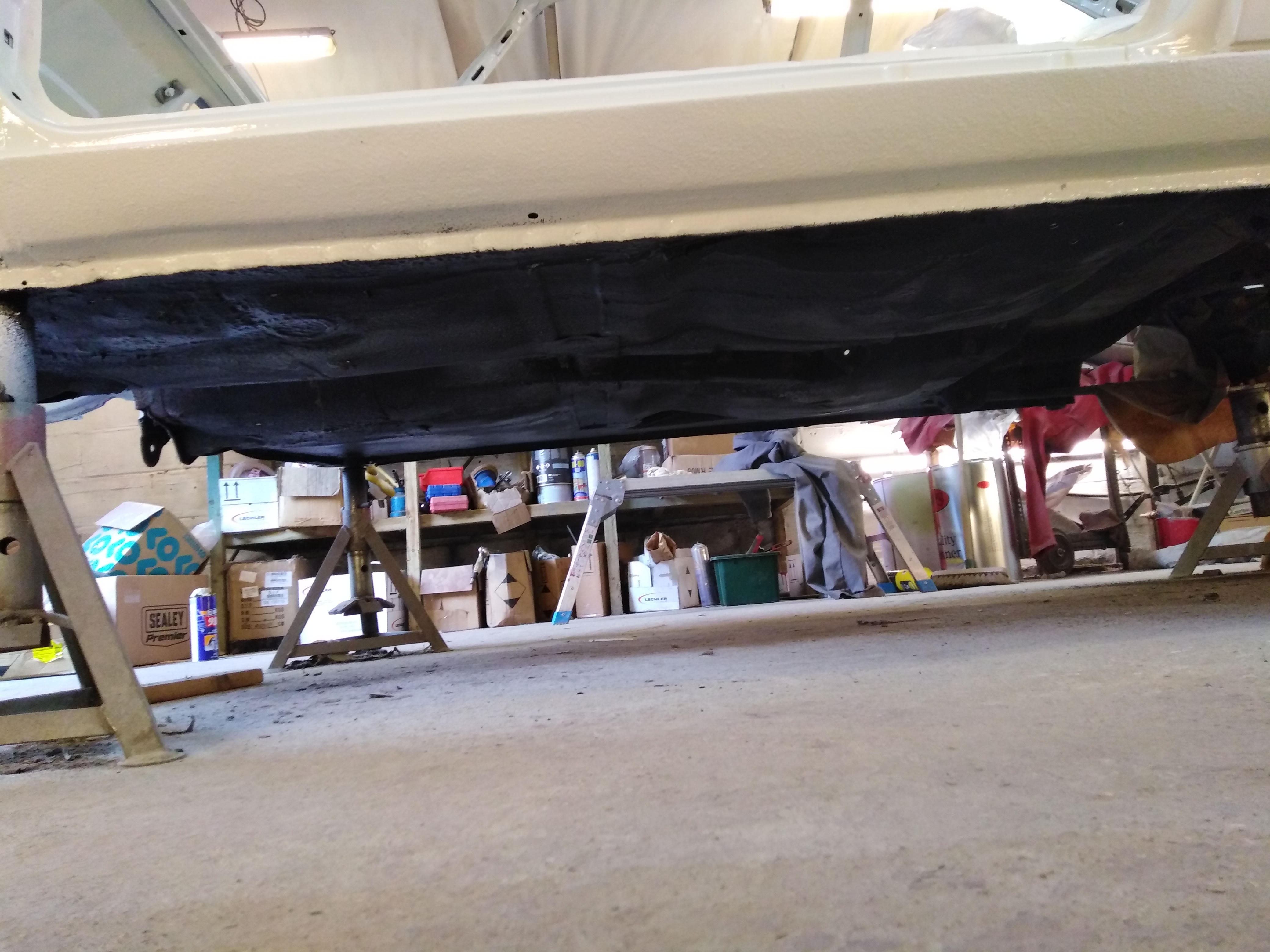

Also cleaned out the rear arches and given them a coating of the black protection, likewise the underfloor repairs. No point in doing them before now or they'd get over spray on them, easier to do now..... just be careful not to blast it on the fresh paint!

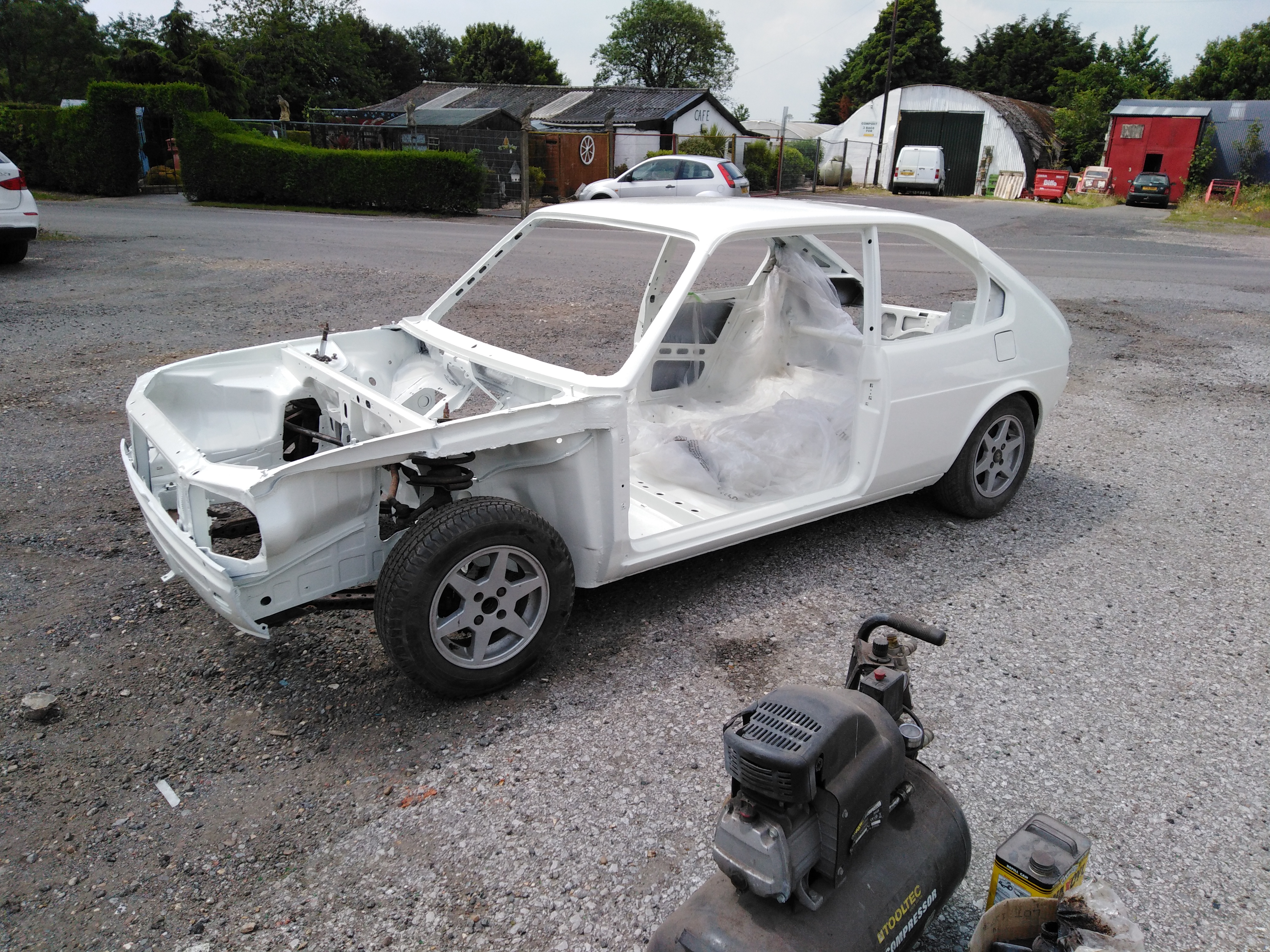

This morning I met up with Tims Dad who had brought over the hatch over, well to be more accurate I got there 15 mins after he did, never was good at time keeping!
Good news was the tailgate kindly donated by Lou was indeed as described, pretty much perfect. Has had a bash around the badge again, what's happening with suds getting rear ended?, but the filler is there for dents, not rust so no drama. Inside clean as a whistle. Bit of butchery gone on on the inside face where an attempt to knock out the dents was down I guess but that's easily sorted.
With that done and the inspection passed by Tim senior (not great at remembering names either...) it was time to fit the suspension and get the car back on the ground.
It's always amazing how you get used to a car being at a certain height for so long then when back on its wheels it appears to have sagged to the ground, made more pronounced by the race springs in this case..
Outside the colour seemed to change, looked more creamy in the unit but in the sunlight it seemed to take on another lustre, looked great if I say so myself!
Before storing it in the big unit whilst I tackle the other panels I for the little compressor out and blasted a litre or more of waxoyl into the sill cavities. I'd left the can in the blazing sunshine for a couple of hours to warm up so it was like water, great for spraying in via the schuttz gun as my preferred method, blasts it in a good distance whilst creating a great fog, you can see it steaming out further along as it's applied. Great to see puddles coming out of the drain holes so I know it's travelled along nicely. Whilst in the big unit too it'll be sat there getting warm so it'll trickle to all corners, really should be a good few years before they need looking at, as long as it's repeated every 2 or 3 years there's no reason why they won't last another 30 years.

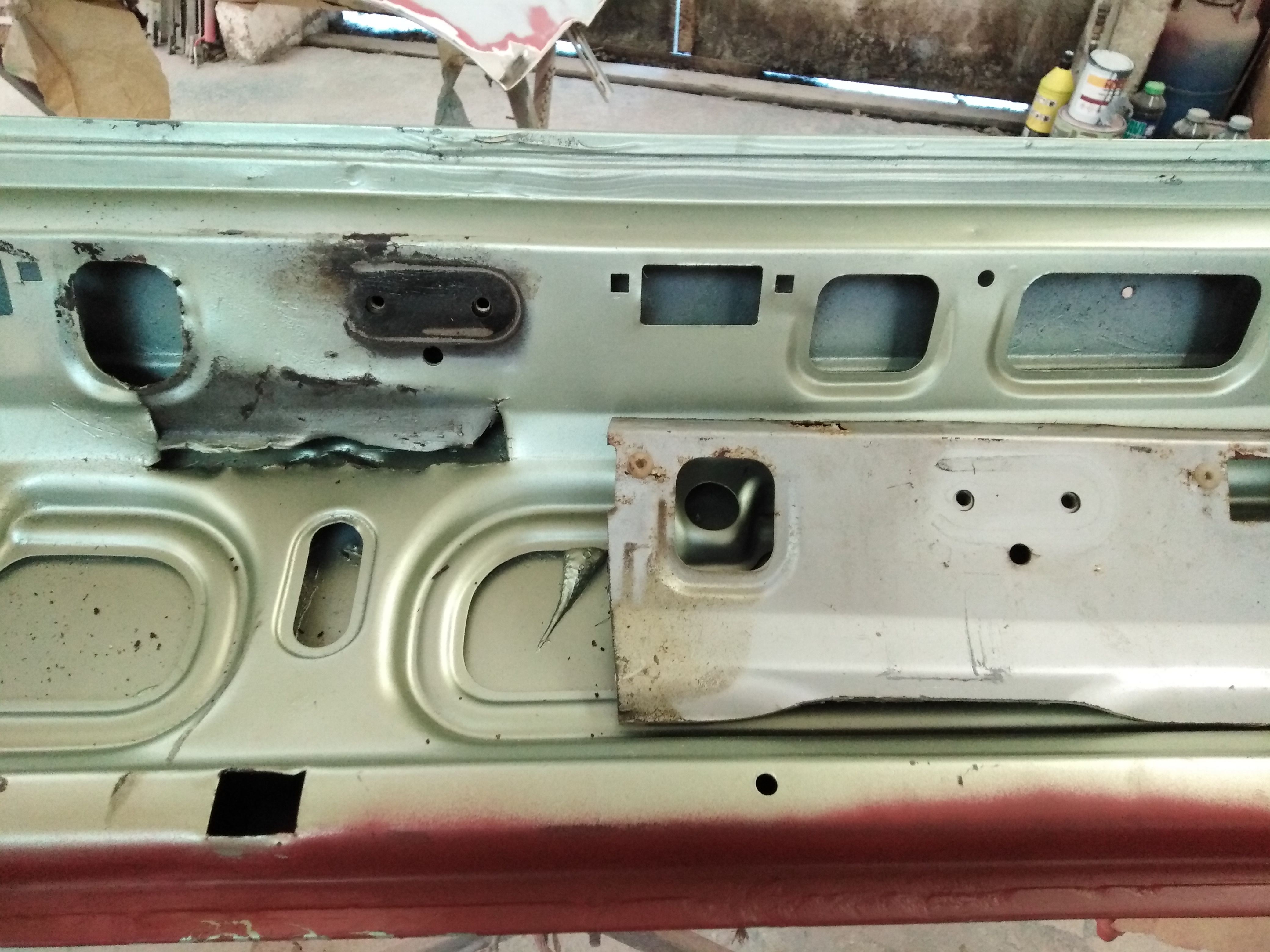

First job to assess the hatch, as I said earlier it appeared very good and aside from the aforementioned dent damage there was very little rust in sight, just a little along the bottom window edge on the inside. Just needed a clean up and treatment, not bad enough to start chopping up. With the rust treatment and being sat upside down so red oxide primer drizzled into the seam it should be fine for years to come.
Started to have a look at the bonnet later on tonight, was in primer but had some rusty sections bleeding through.
Front edge corners as usual, anywhere that can trap moisture in tight areas.
Bit of digging with the usual tools soon made a hole, it had been filled before but I decided to weld rather than fill.
									With space again it's time to assess how much more needs painting, as ever there's always more than you seem to think, but nothing we can't handle.

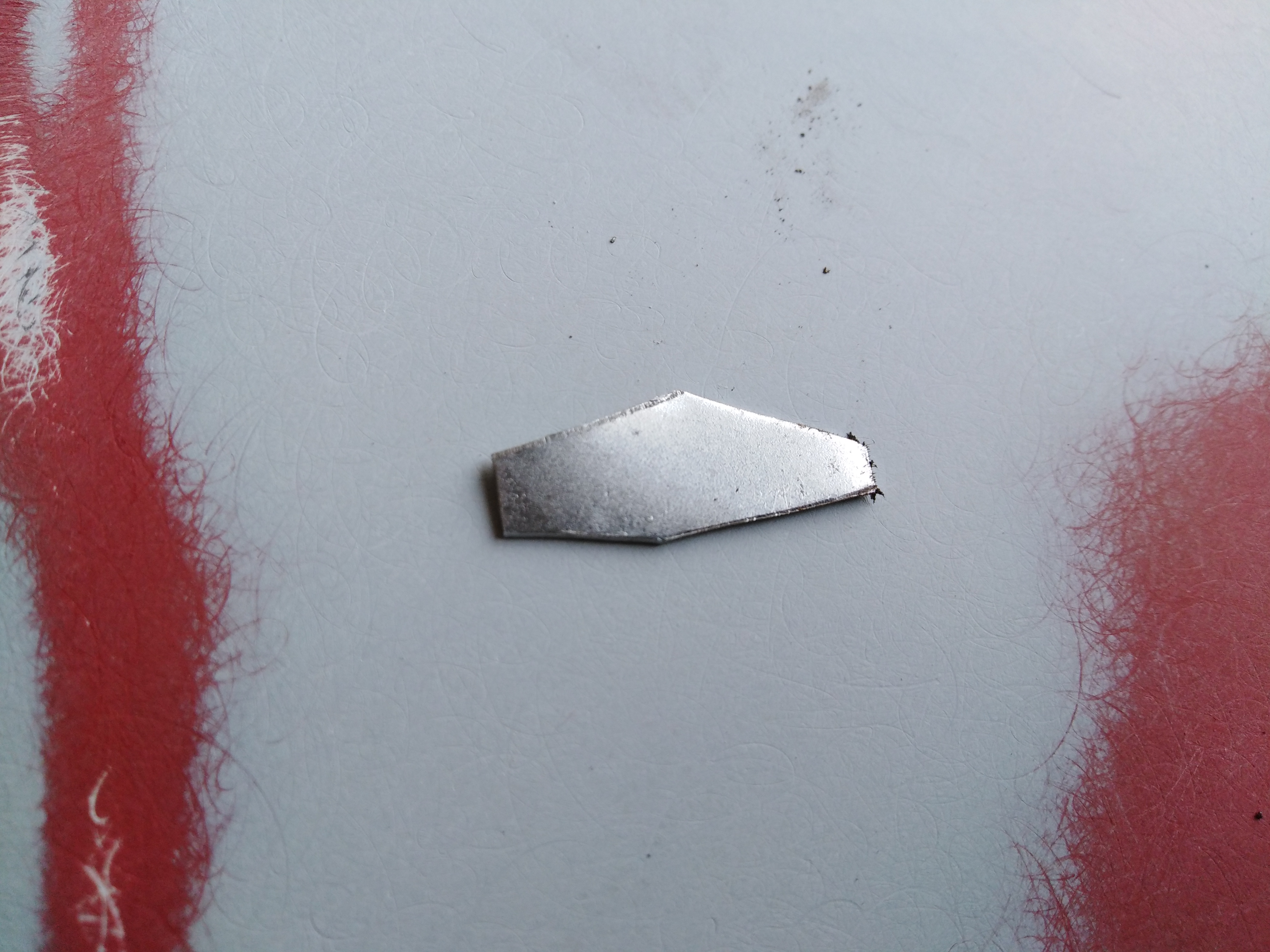

The coffin shaped hole was left after grit blasting and grinding.
This needed a coffin shaped patch to be made, but in this case just to sit in the hole rather than a flush fit so the weld could be made to fill the hole.
Then just steadily fill the hole with weld, looks messy and sooty as it was burning off filler and sealant from underneath as it was tacked in.
Yes, it does look a mess but you can't make an omelette without breaking an egg they say, well you can't weld a hole without making a mess.
But you can use a grinder and sander to make it disappear

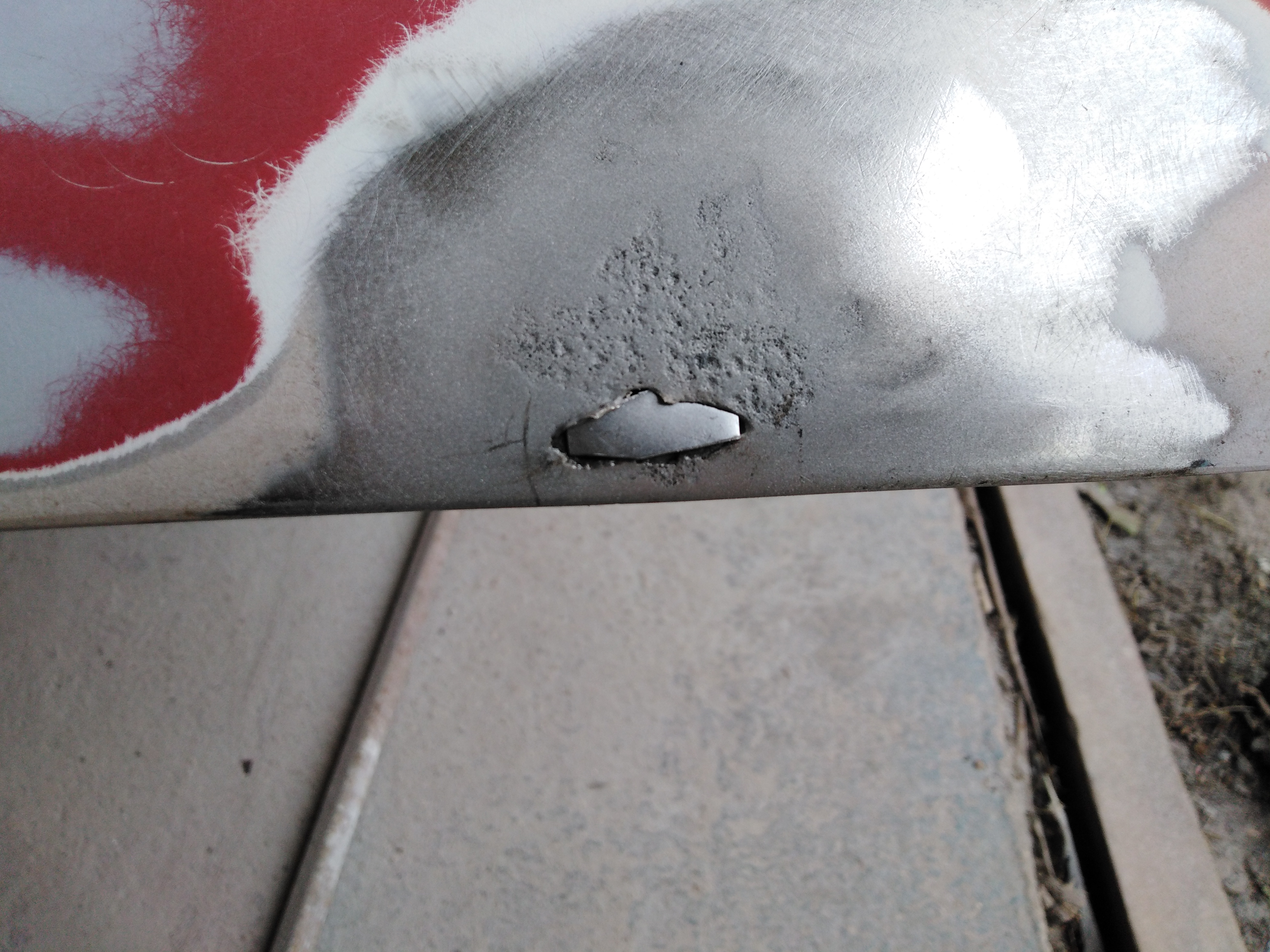

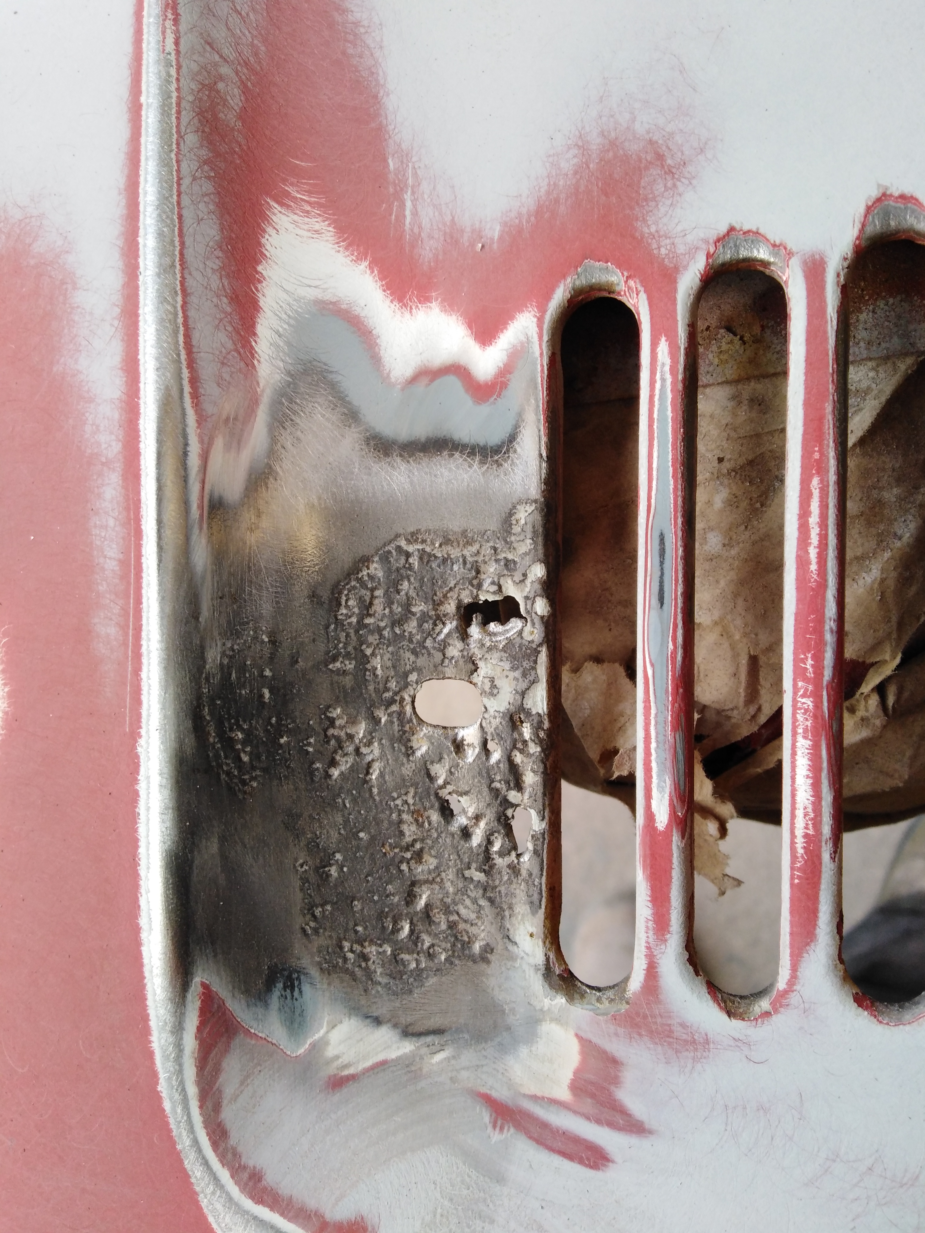

Another area of concern was around the vent near the scoop mount, very pitted and of course the take no prisoners knotted wheel took great delight in making some holes.
Very thin metal there so just plugging the holes with weld wouldn't be very successful, and being single skinned it needed to be a flush fit repair piece.
First job before you cut a big hole is to make a template then a repair patch, especially given the need for the mounting hole in the correct place and the edge of the vent needing to look correct.
Then a couple holes drilled in the corners and an air powered hacksaw to cut the bonnet..
With a patch made and held in place with the magnet it was take your time and weld it in with small plugs, again looks worse with the welds but all new metal. Note the oblong hole waiting to be drilled, easier to do that when welded to the bonnet than trying to hold a small patch down.
Of course it's important to drill said hole before grinding the welds down or you'll lose your markings!
As before a grinder or two with a sander soon make things look better
A good start to things, overall quite pleased with things so far....

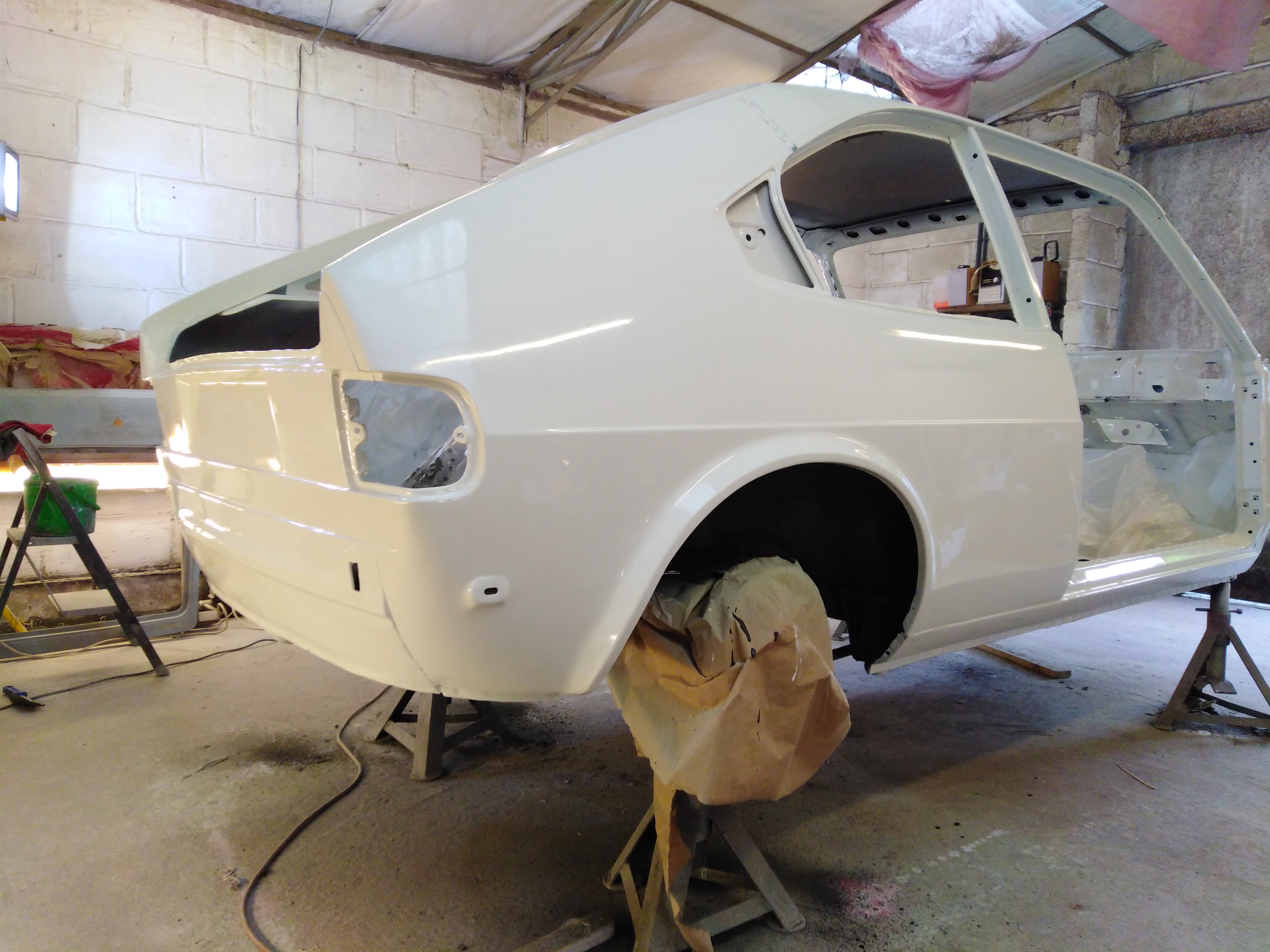

Last few bits primed this afternoon, Monday will be flat them and hopefully in white.
That'll just leave the cage unless I remember something else..
A handful of bits to be done in satin black but looking like the end is in sight..

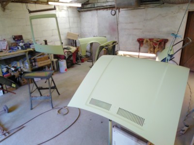

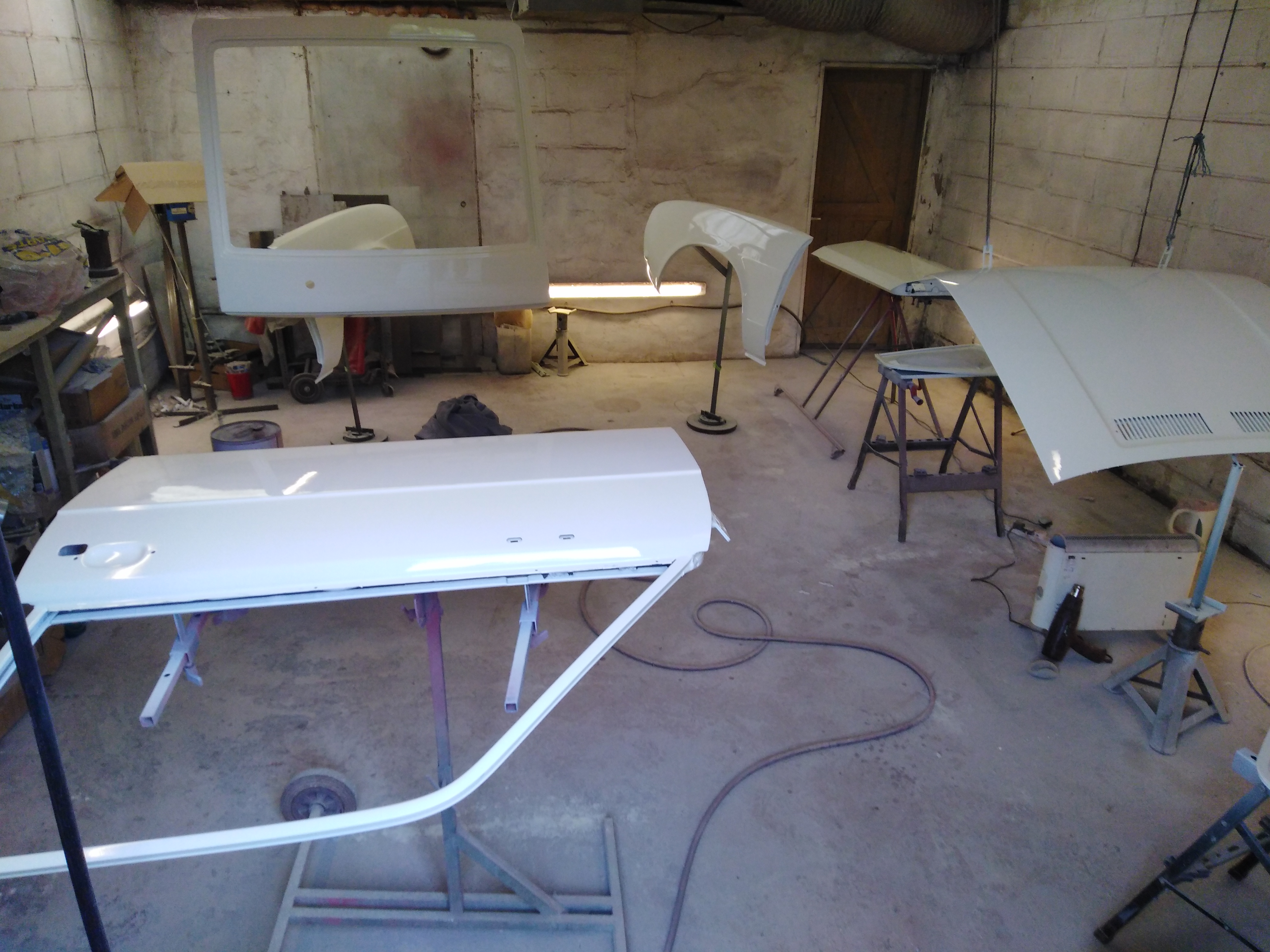

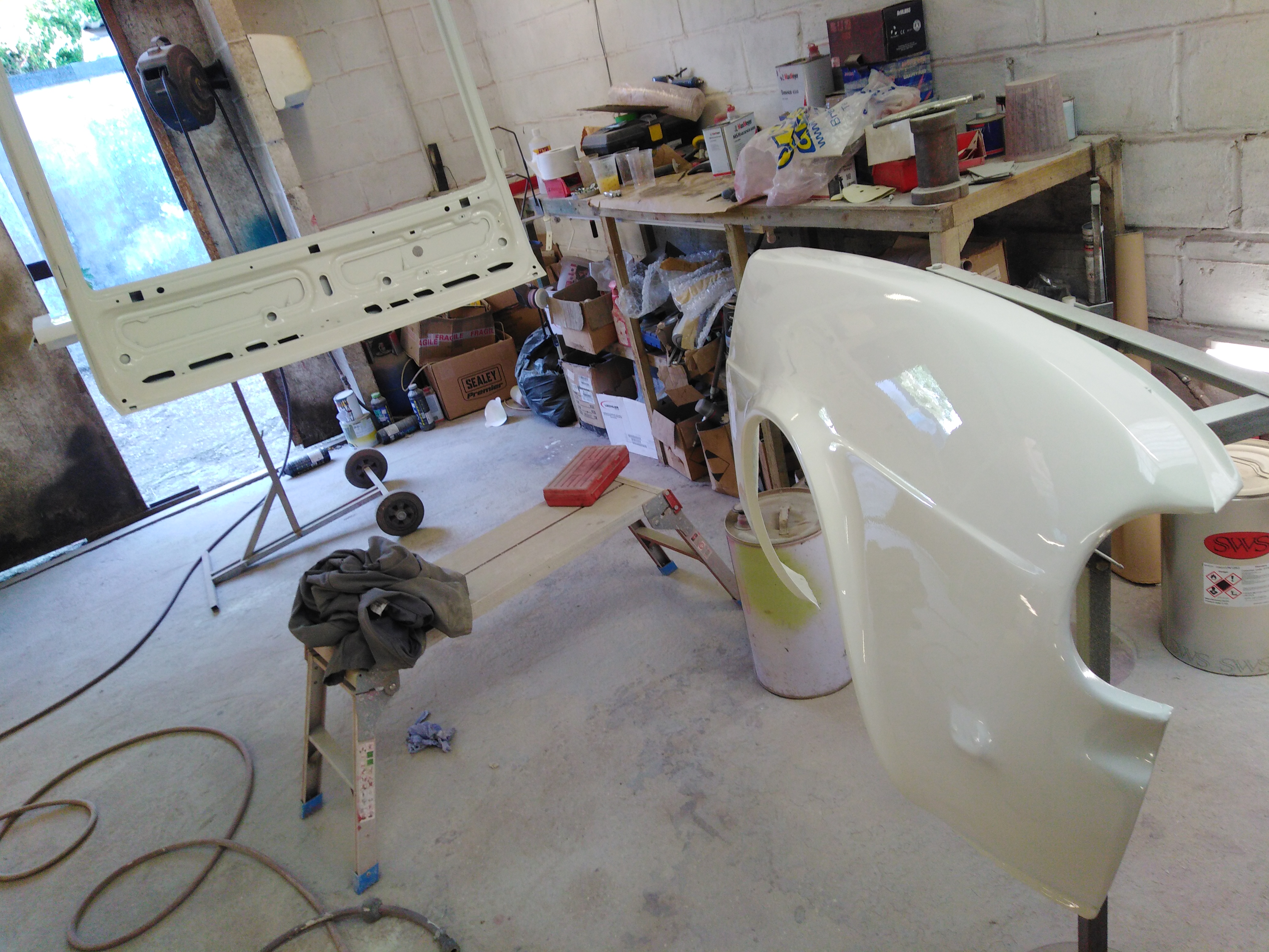

Nice warm day so perfect to get the panels done.
Flatted and cleaned the primer this morning then later on this afternoon the white went on.
Like walking around a maze to paint everything, making sure not only to make sure you didn't brush against a wet part but to make sure the airline behaved itself, not flicking up something or getting snagged.
The bonnet needed painting underneath as well as on top so a bit of thought needed to enable it to be done.
Answer was to string up the front edge via the hinges and use the bonnet catch pin to perch the back end on. A jack handle welded to a very sturdy lorry axle stand provided a stable pole to fit the pin into, which itself was extended by fitting an airline coupling on to it.
