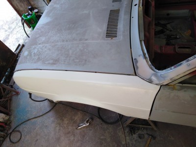

Tim came over yesterday to bring the front wings, new fibreglass ones.
On first trial fit they looked like they'd never fit. We weighed up the options then decided to at least have a go at making something of them.
15 mins or so of nervy grinding we made huge progress, remember new wings so chopping bits out could easily render then useless, but it gave me hope that I may be able to do something with them.
Today I still felt a bit nervous as all the mounting holes needed drilling in the new wings as well as trying to get an acceptable fit.
As we'd made a little progress with the passenger side I carried on with it. It's really just a case of carefully finding where the wing was too tight a fit and adjusting (cutting bits off...) until it sat well. Then the fun of getting the mounting holes drilled in the right places, I really didn't want to have holes in places where not needed!

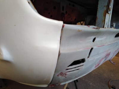

The fit is pretty decent all round apart from a section near the front panel, for how they were it was a relief to get the gaps nice and straight.

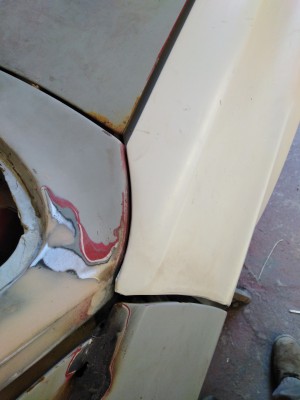

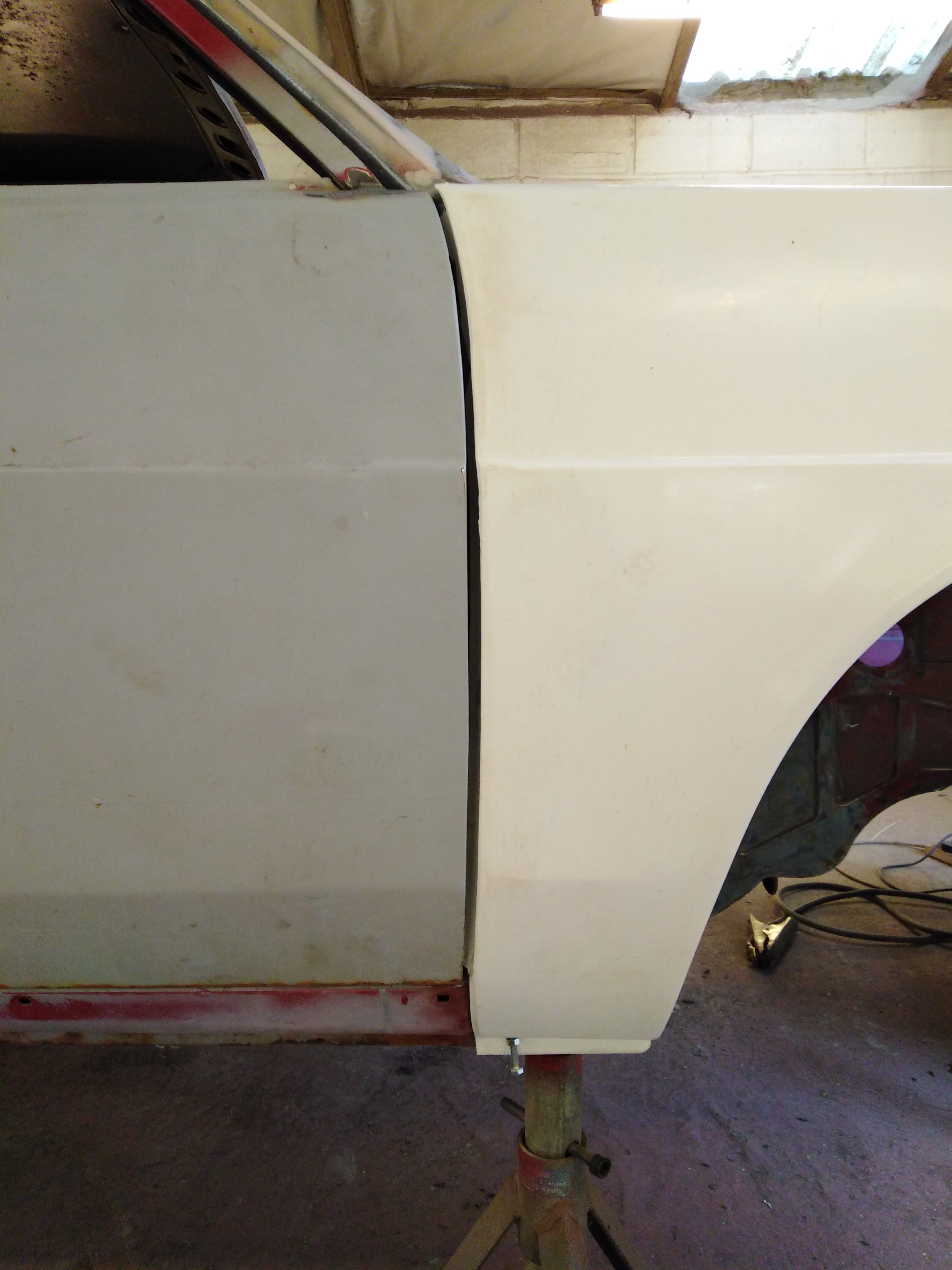

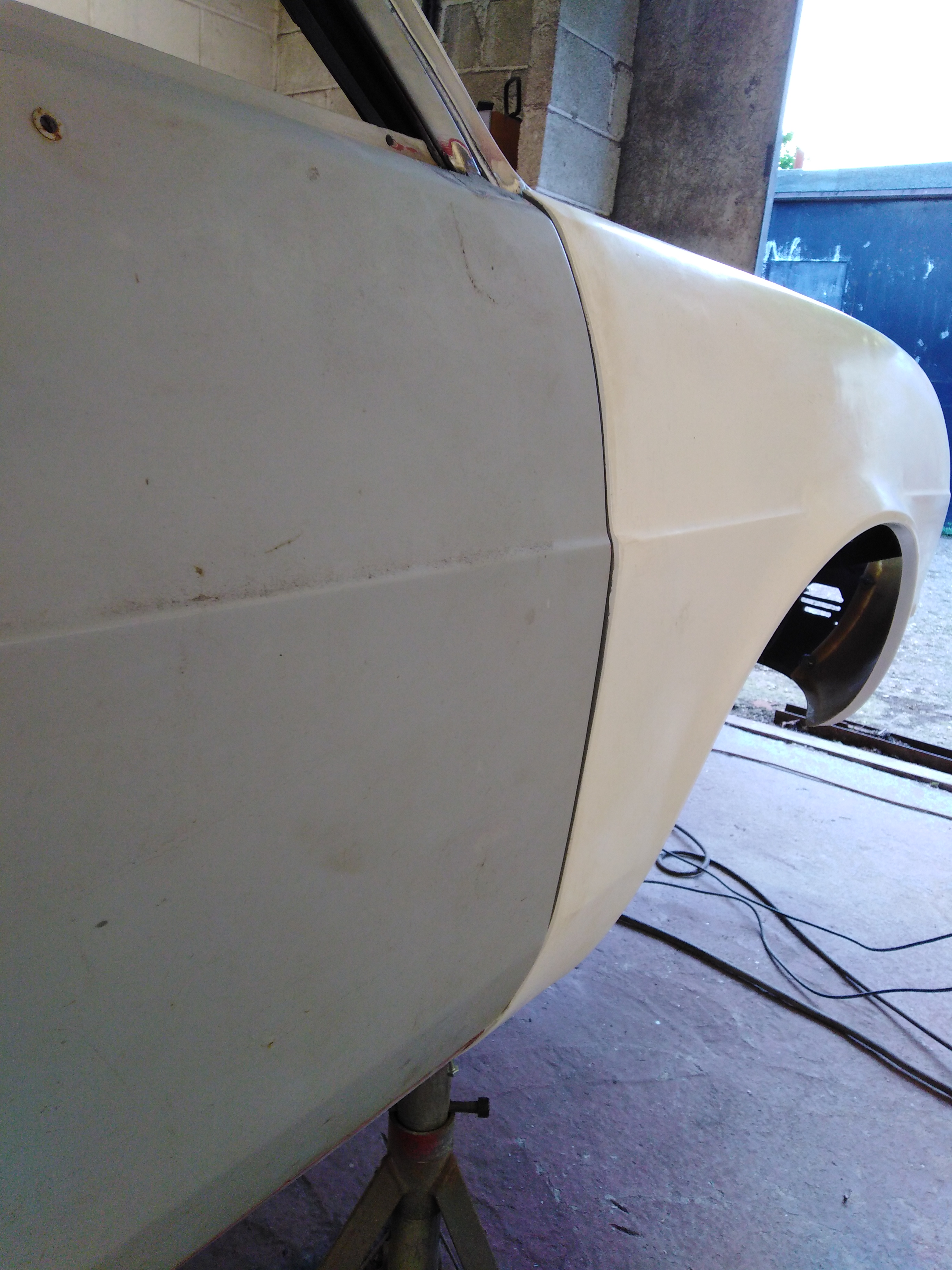

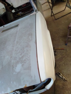

Re: Tims' Sud
Onto the drivers side and it seemed way worse, glad I did the passenger one first or it would have freaked me out!
Having done the other side first though I thought it would be able to be sorted.
The wing sat proud of the door by a big enough gap to get your finger in, that can't be good!
Soon learned though that they must allow extra all around when it comes out of the mould so you can trim it to suit.
Chuffed again with my efforts.

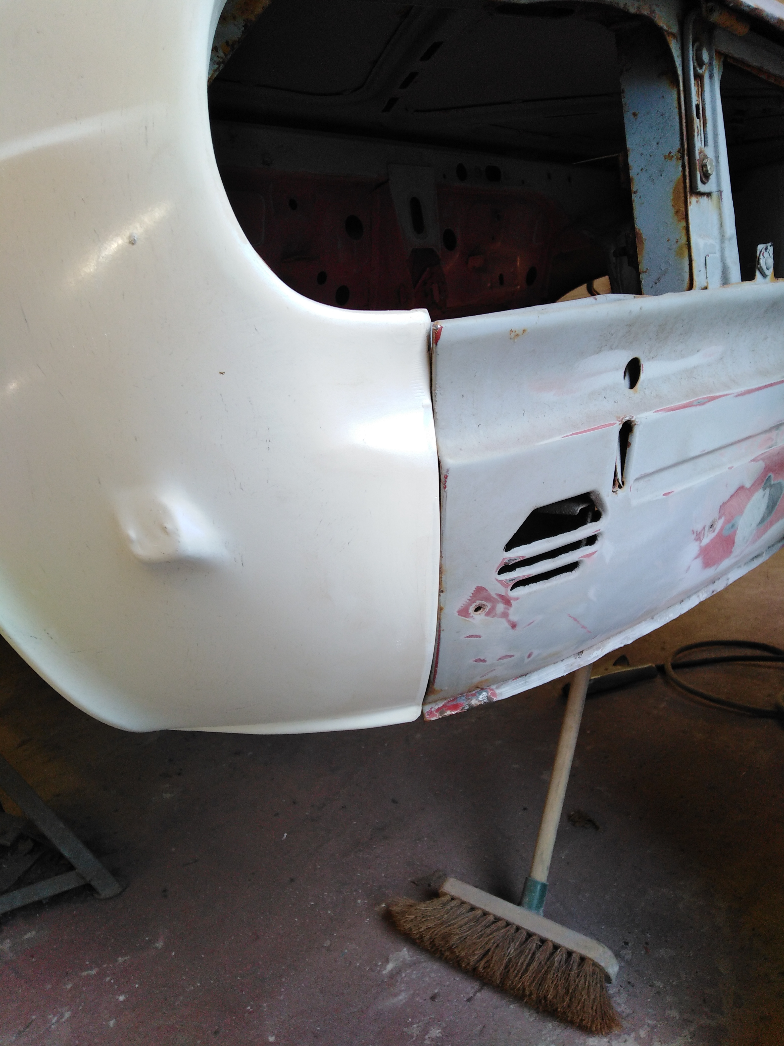

Only thing that bugged me was the fit at the front panel.
Shape wasn't really right.
Decided to have a go at reshaping the metal front panel to see if it would easily fold into shape better, it did. A slit needs to be set in and welded back up to allow the panel to shrink in to suit the wing better. I'll do that when I've refilled the welding gas bottle, all this welding gets through it. At least it will be fairly easy to make a little better.

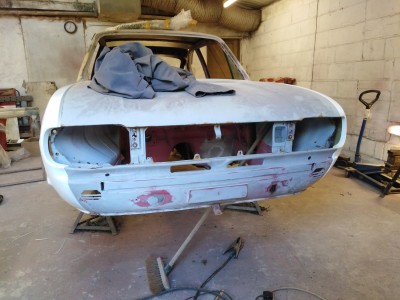

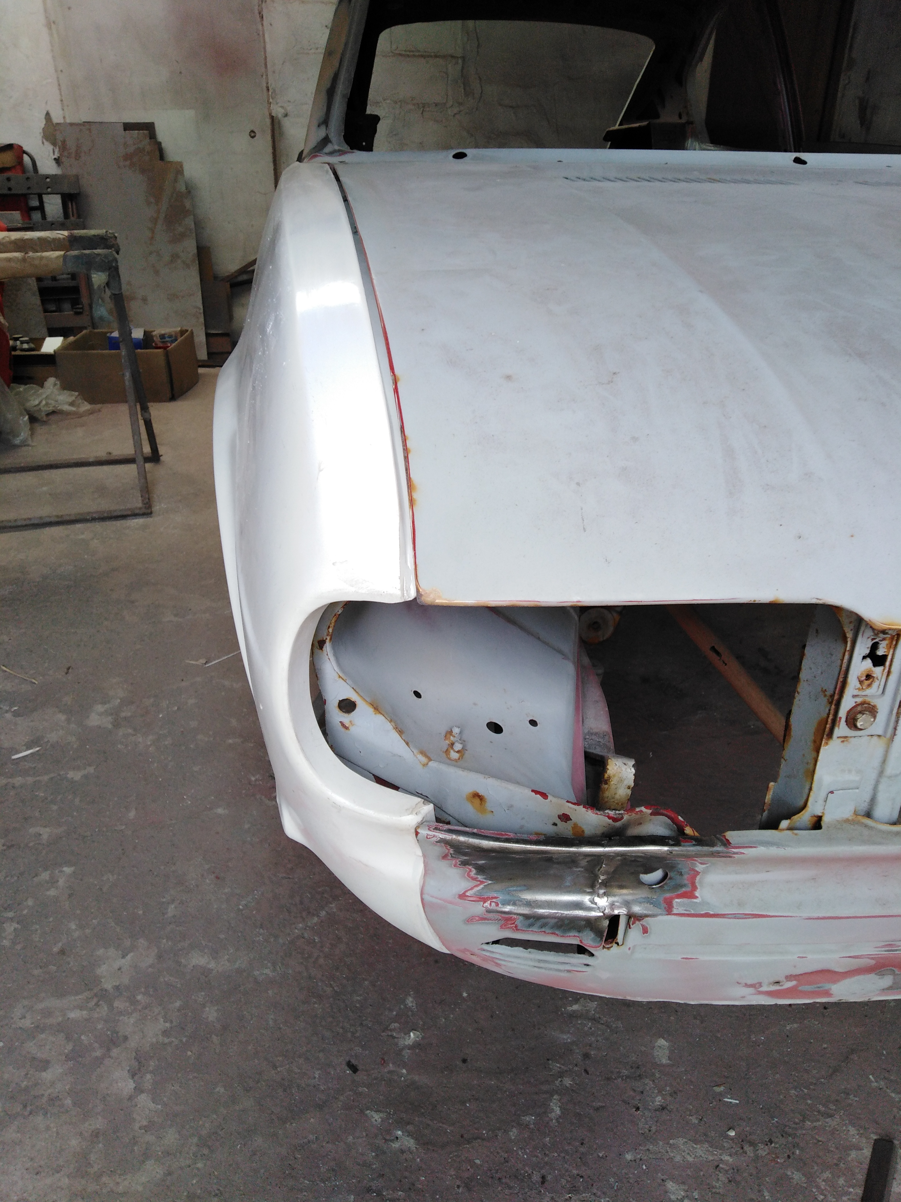

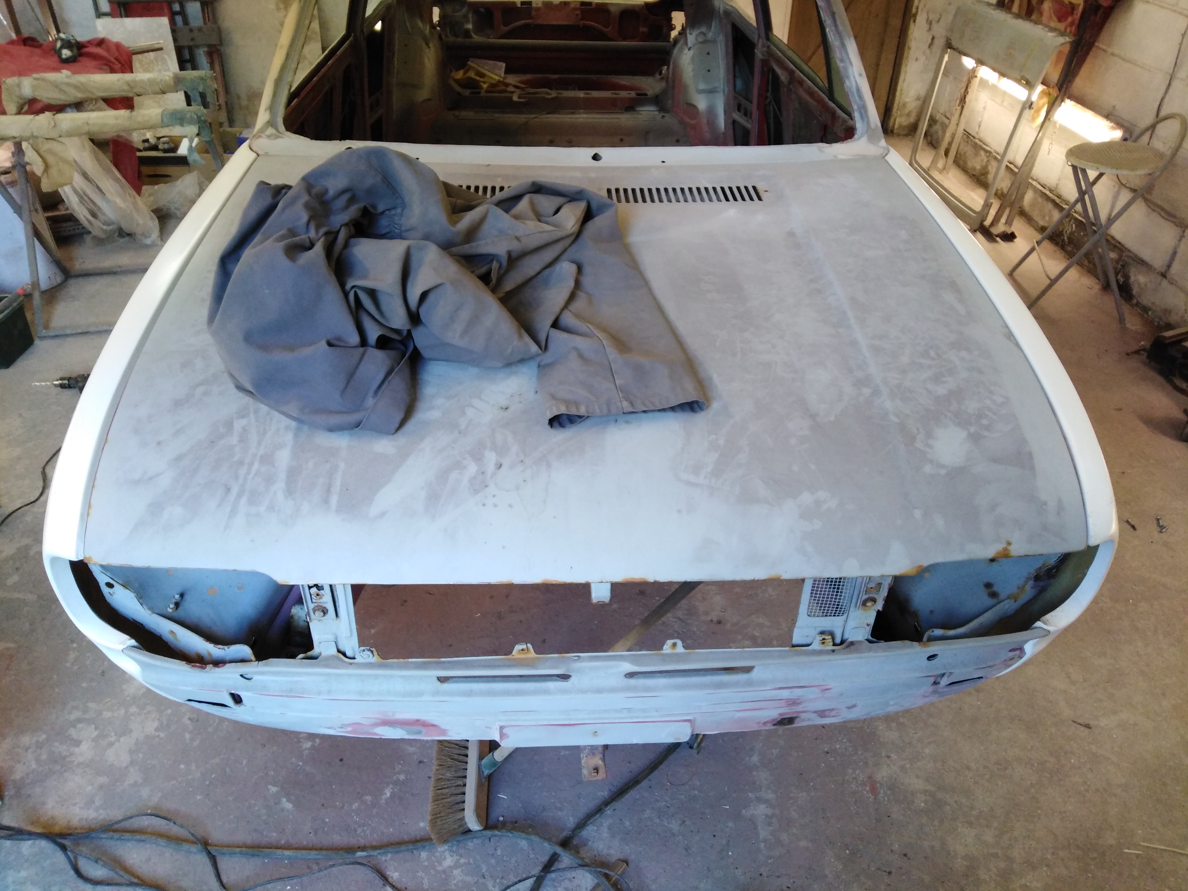

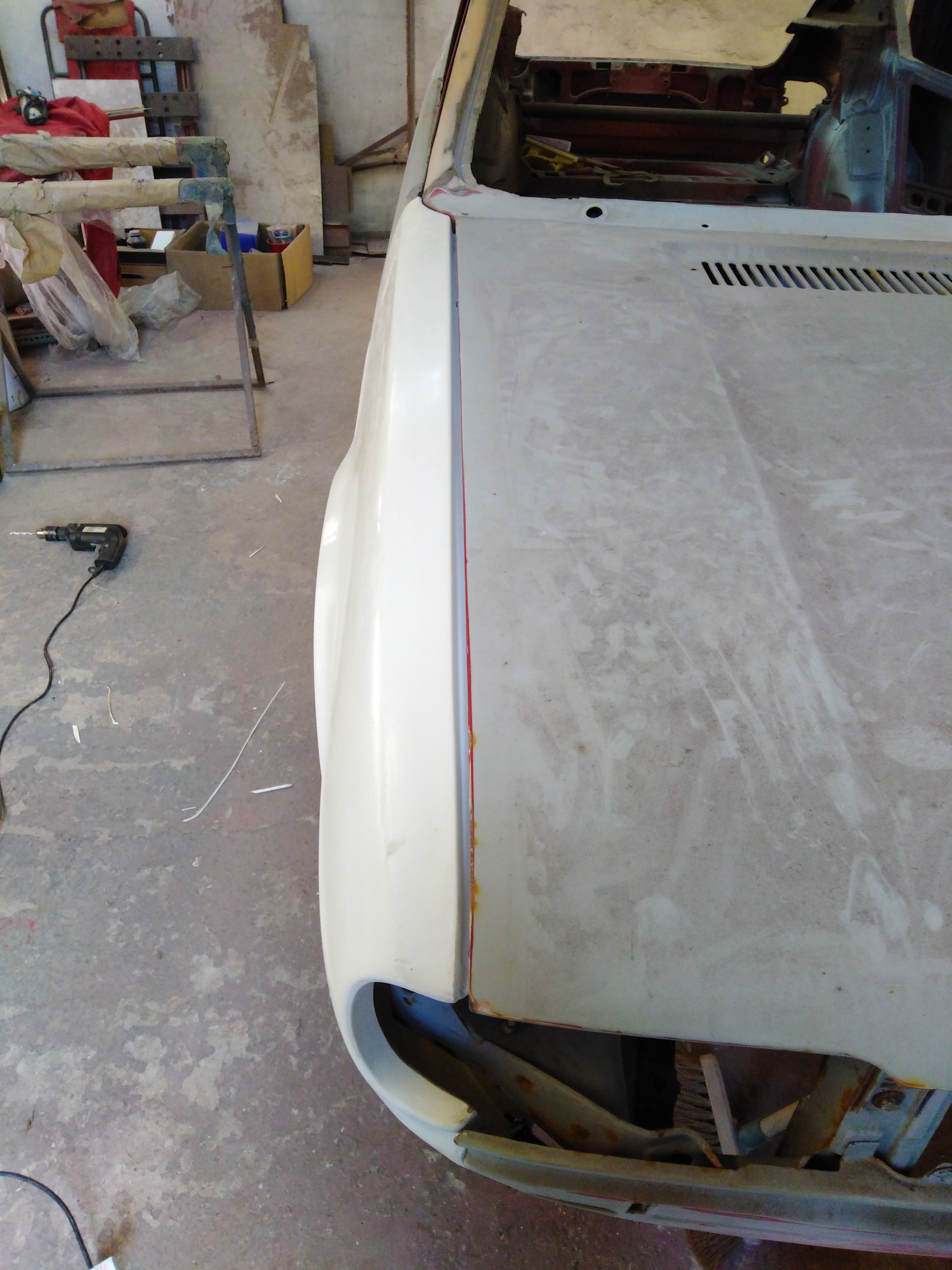

The drivers front wing needed all the captive fixings making along the wing mounting rail as yesterday it was just nuts and bolts, a new bottle for the welder picked up today made it possible.

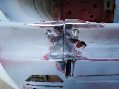

With the wing now fixed firmly and slightly better to the bonnet line the front panel alignment bugged me enough to have a go at it.

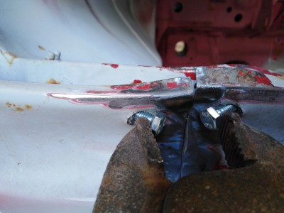

First job was to slit a slice out of the panel to allow it to be closed up..
The bolts were used with mole grips to pull the sections together..
With it pulled tighter it allowed the panel to be much more in line with the wing profile.
Much happier with the alignments now, not that it was bad yesterday but it's pretty good now for steel wings let alone glass ones.

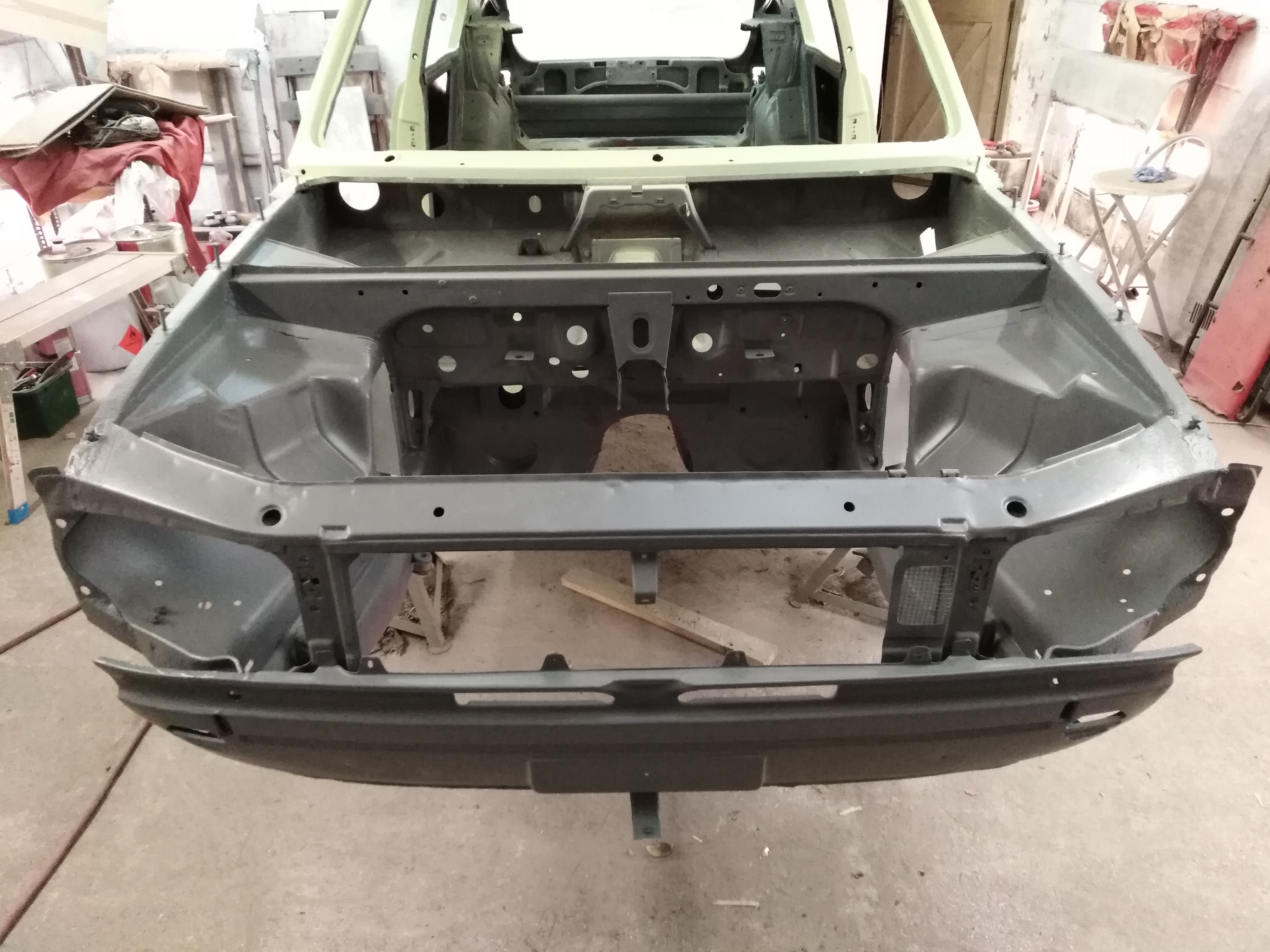

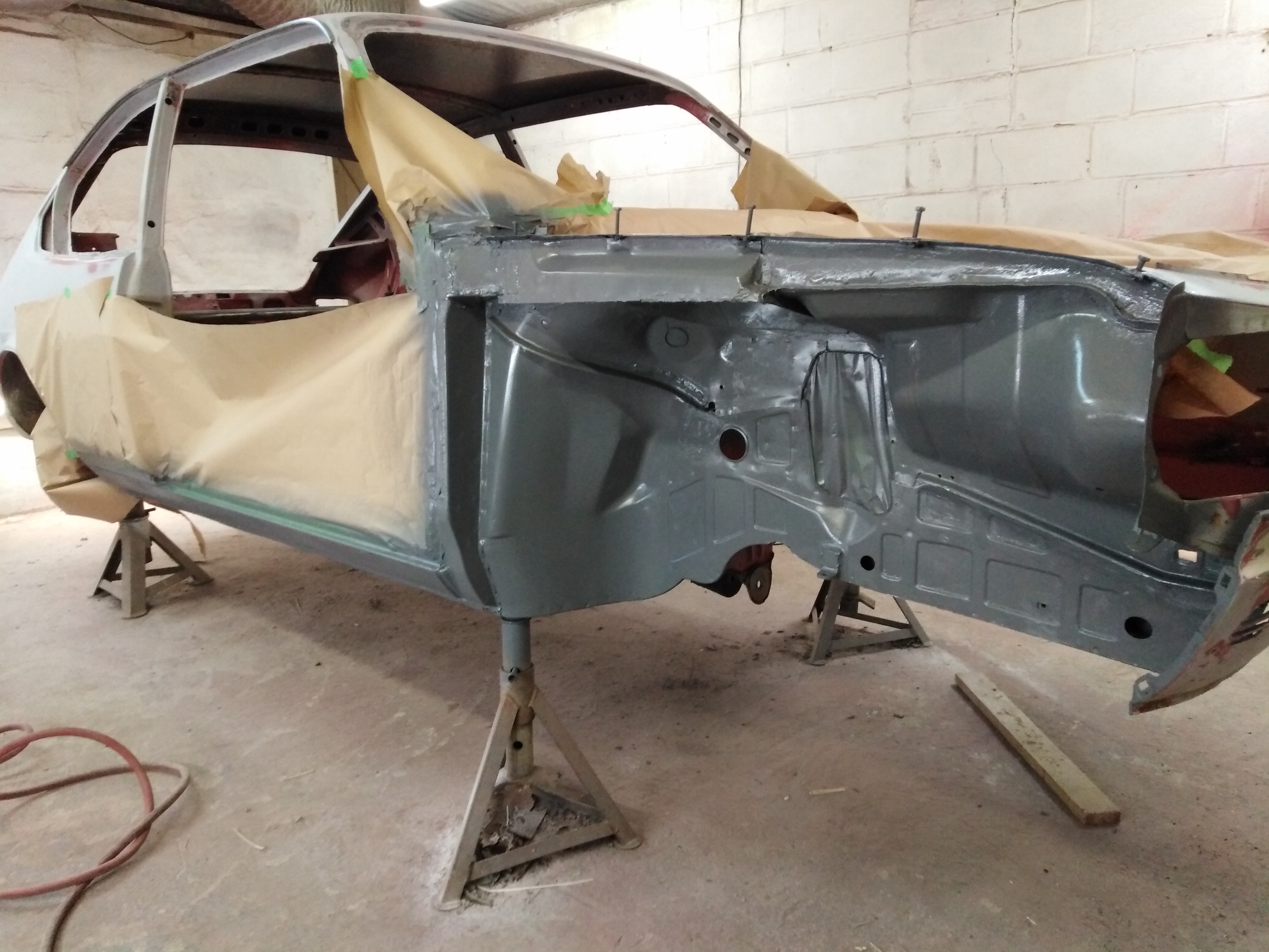

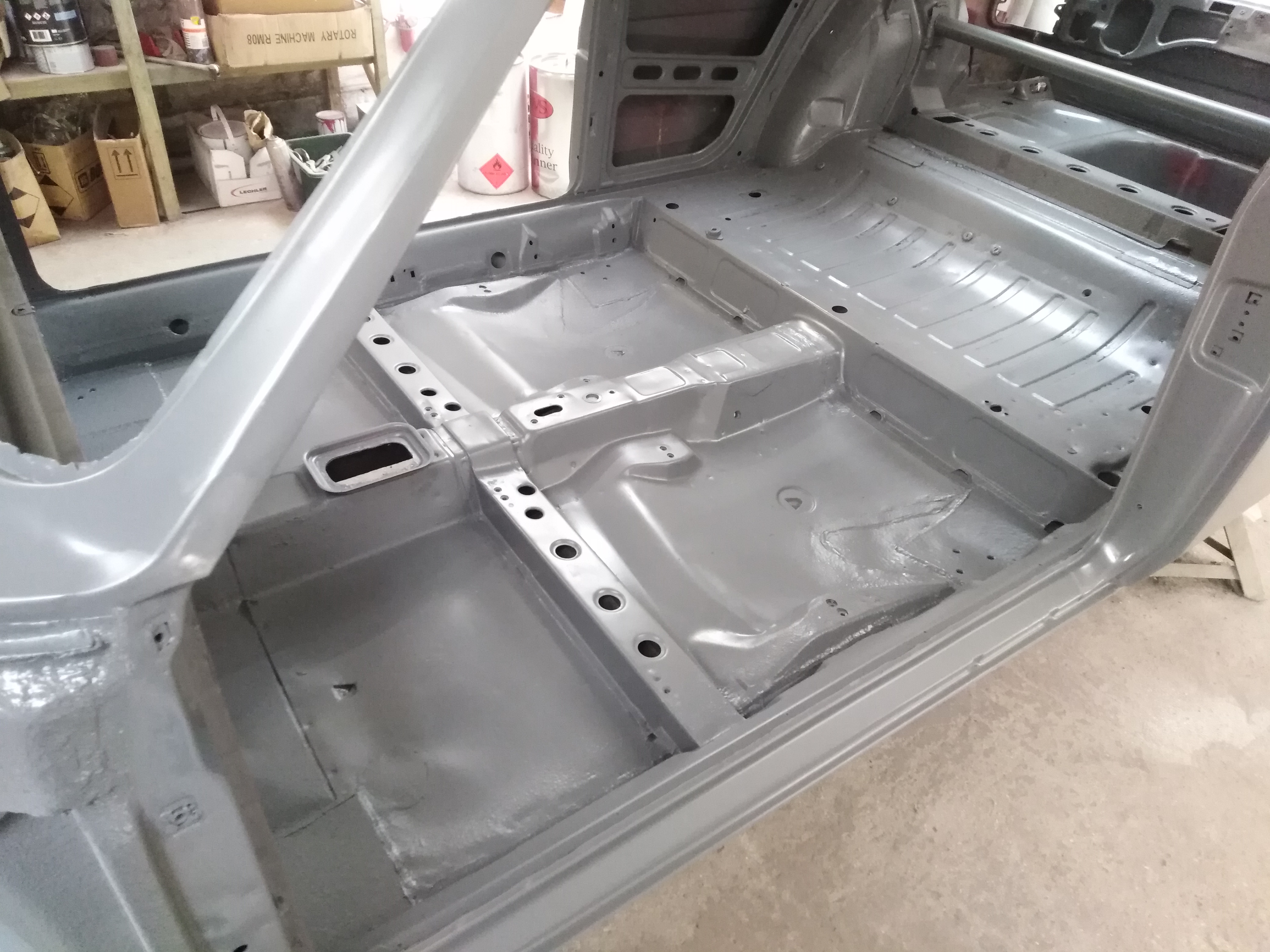

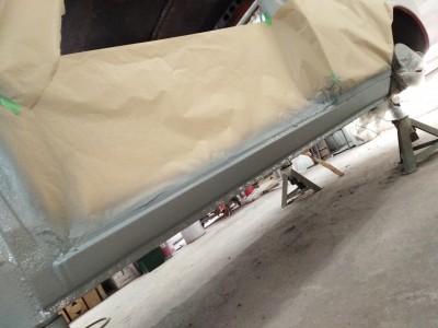

Big step today it seems, one of those stages that seems to be the job moving on at last..
The wing rails got spacers welded to follow the curvature of the fibreglass wings so it doesn't split them when bolted down, the in between sections got some fibreglass to build it up to fill the gap. All reversible should the need arise with different wings going on rather than cutting and welding.
Front inner wings and sills etch primed so I could put the stoneguard on so it gets chance to dry off before the main primer.
The etch primer alone makes things seem much better alone..
With that done the stoneguard went on, outer sills and inner front wings plus the areas where the roll cage will bolt down got a coat for a bit of added protection.
The sills have had the square holes that are for the sill covers filled in. I must confess to Tim that although he said to weld them up I just couldn't, it's rare to have a sud with all the holes in such good condition so if anyone in the future wanted to fit ti skirts it'd be harder. So I knocked them in my a few mm and fibreglassed over the holes, gives the smooth look but the option is still there should it be needed further down the line.
I'll leave the car tomorrow so the stoneguard can dry out all the solvent. Friday if all well I'll get down there to prime the shell..

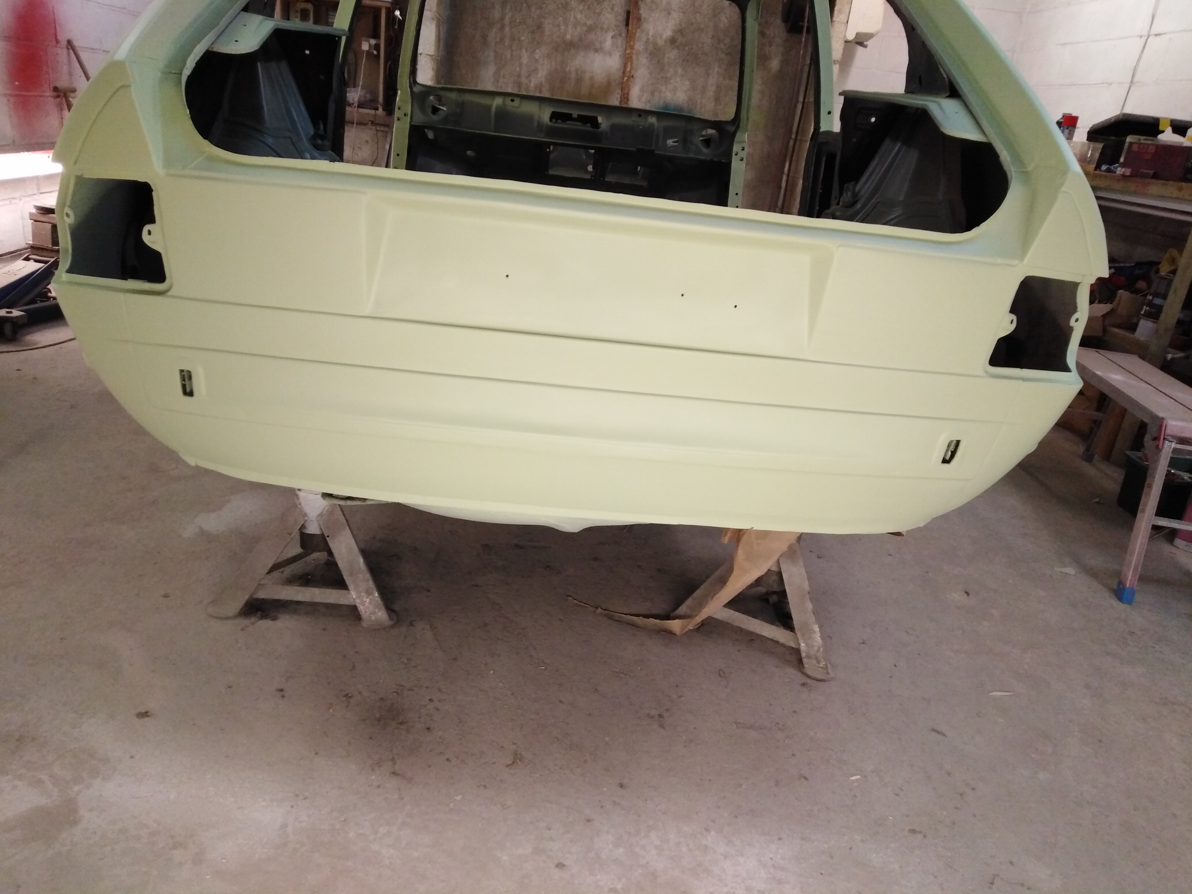

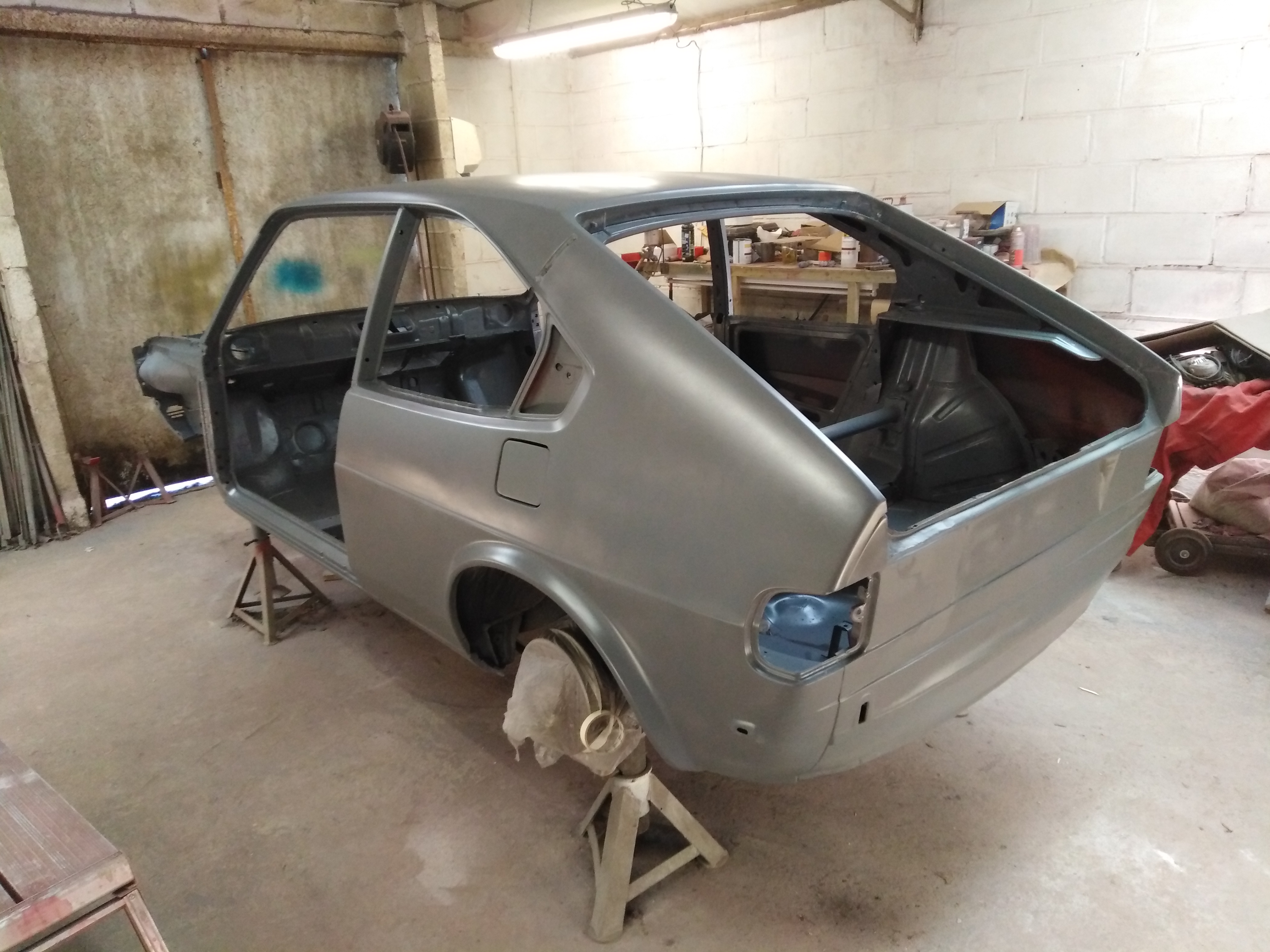

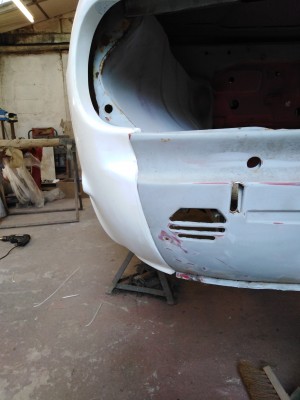

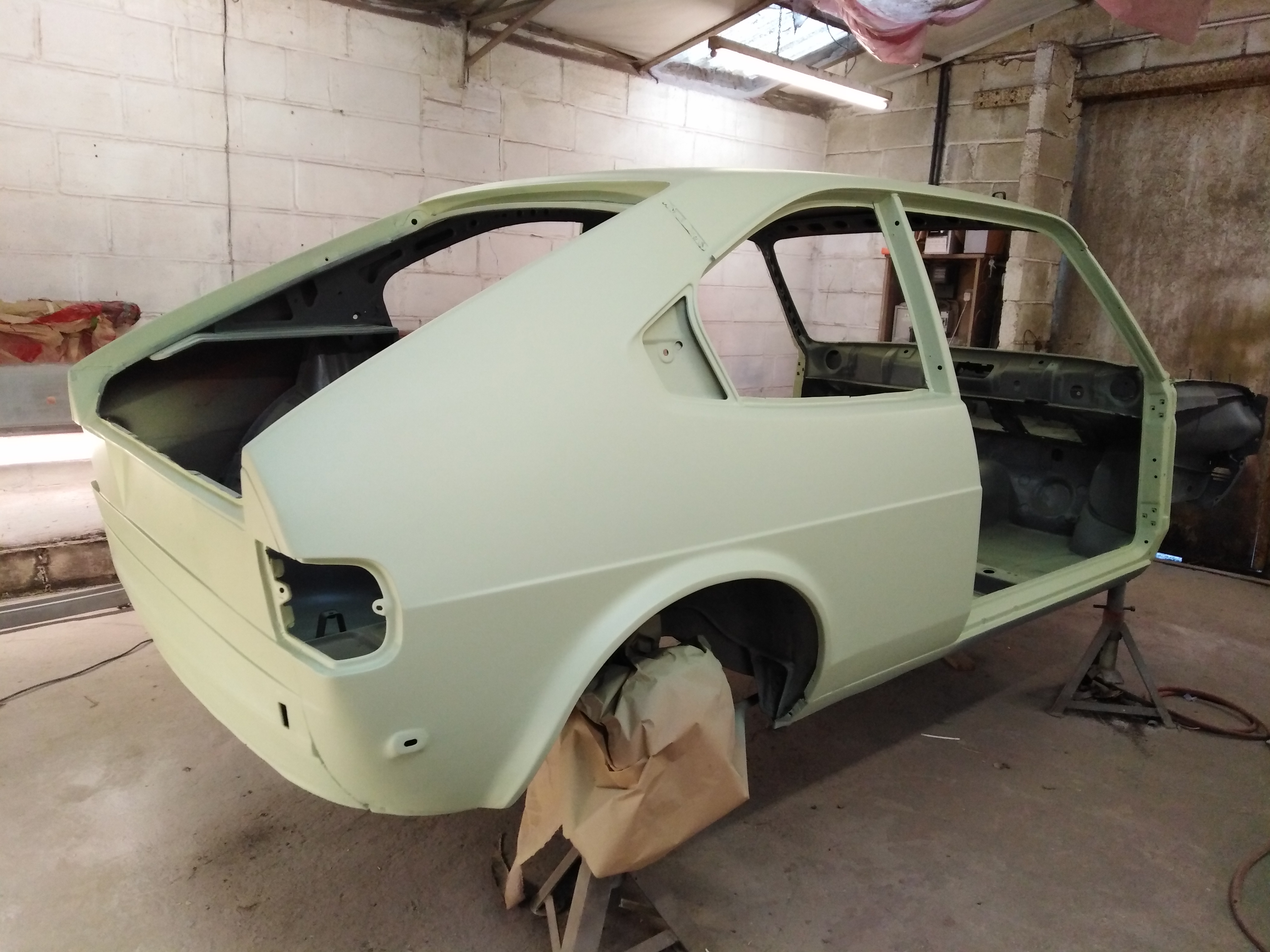

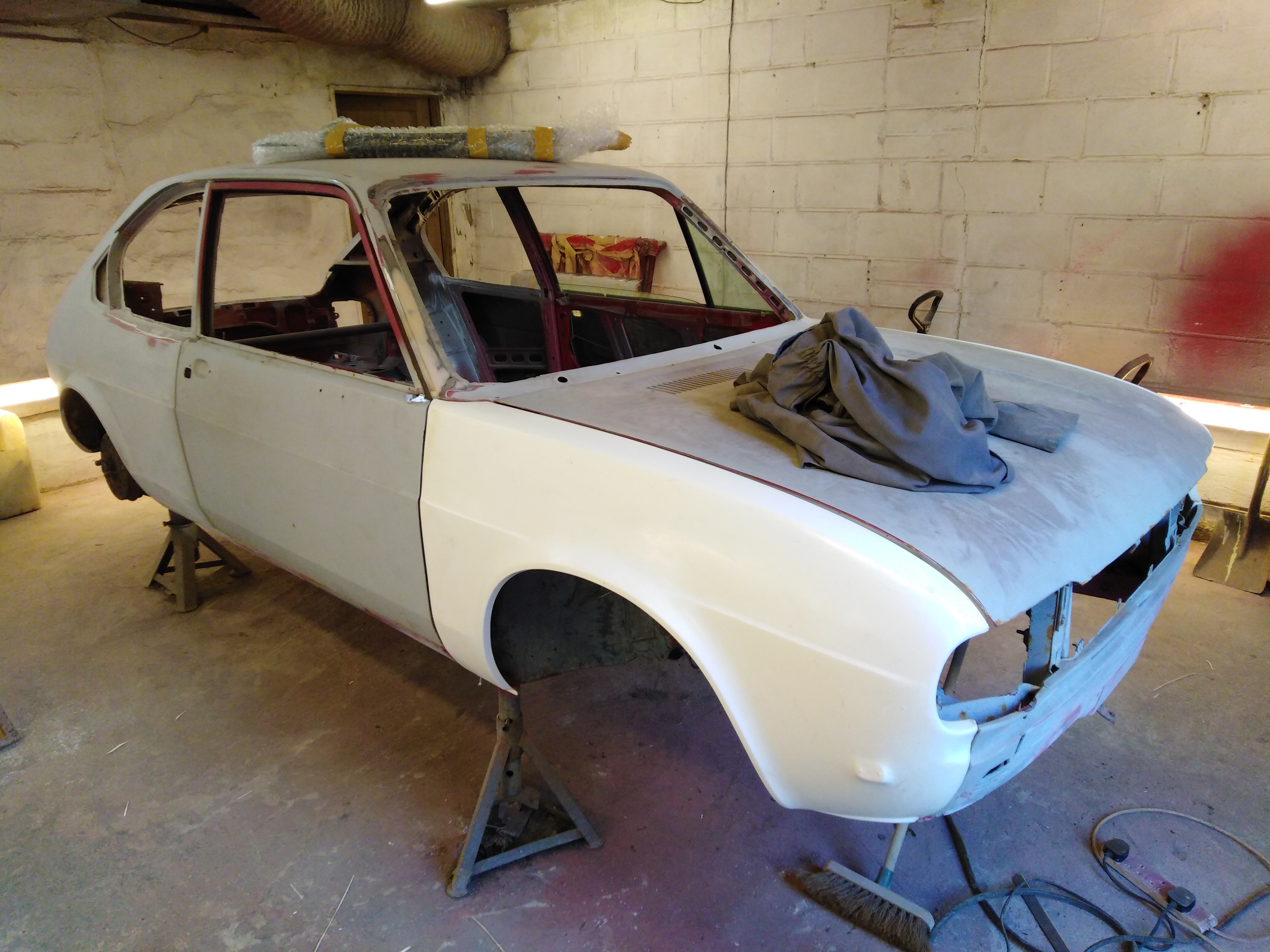

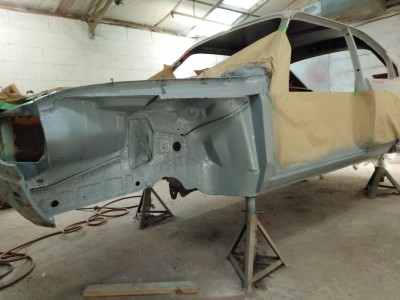

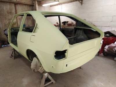

Bit more sorting out this morning then this afternoon I finally got around to getting some etch primer on the car, about time I hear you all say!
Cars always look better when in one colour instead of the patchwork of repairs, the grey etch primer goes over everything bare metal and all so I know once that's stuck then the next layers won't be liable to flake off.
The outer panels got a couple of good layers of the filler primer that I favour, more coats on areas that have been repaired. The thickness that this primer goes on allows plenty of material to be flatted off to rid any flat spots or scratches, it's really like liquid body filler!

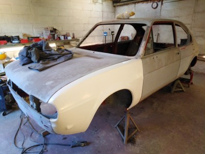

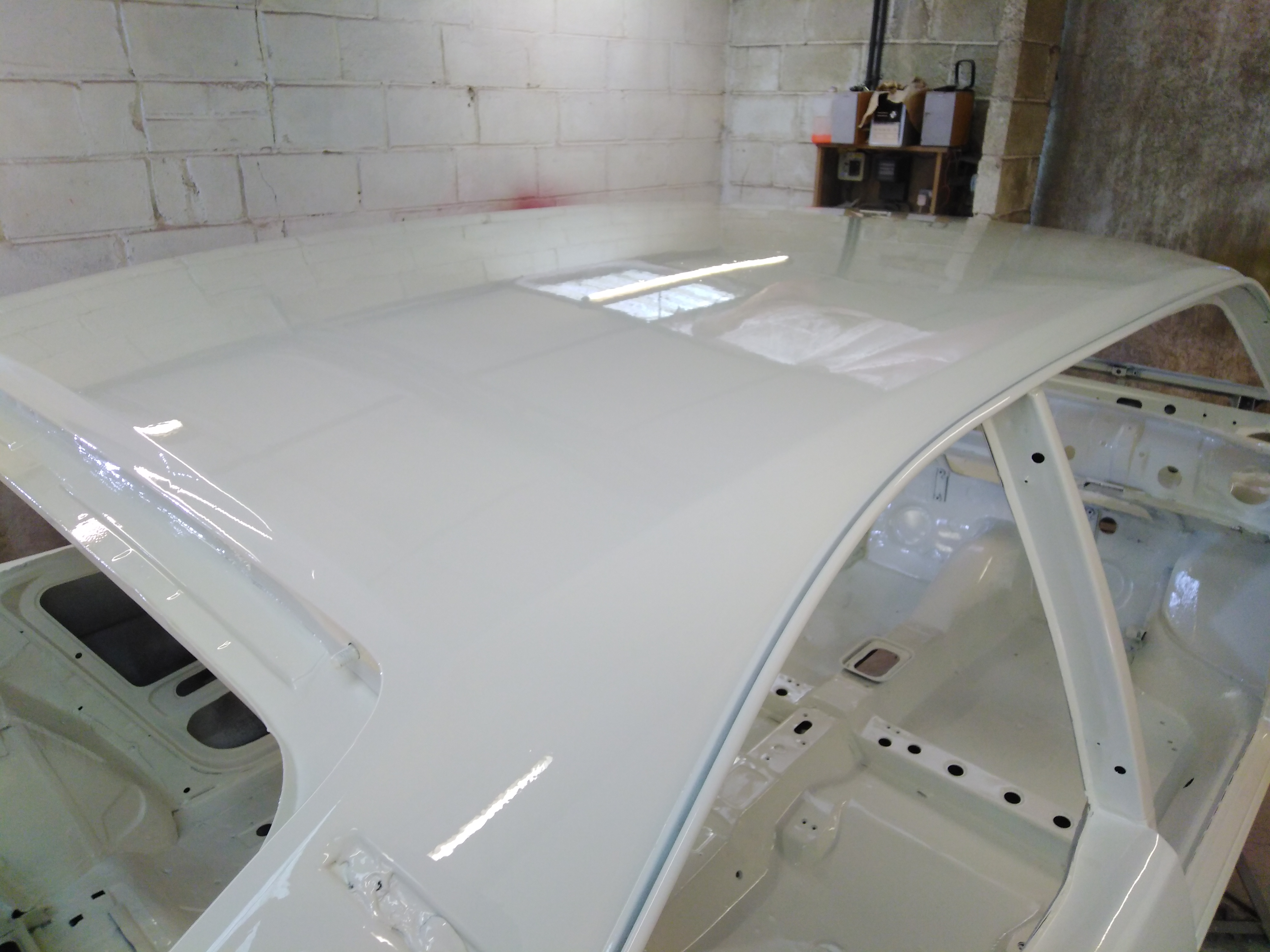

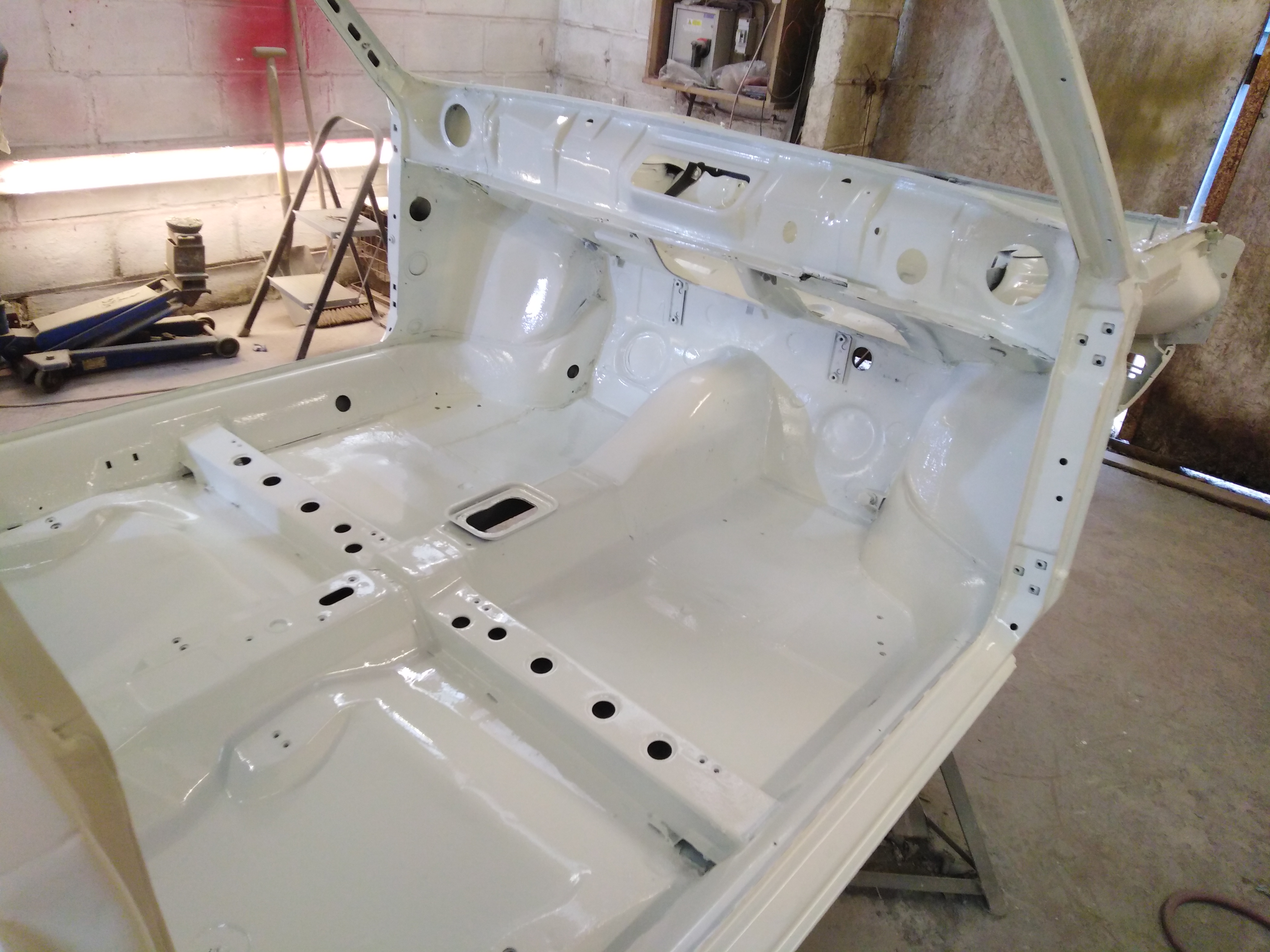

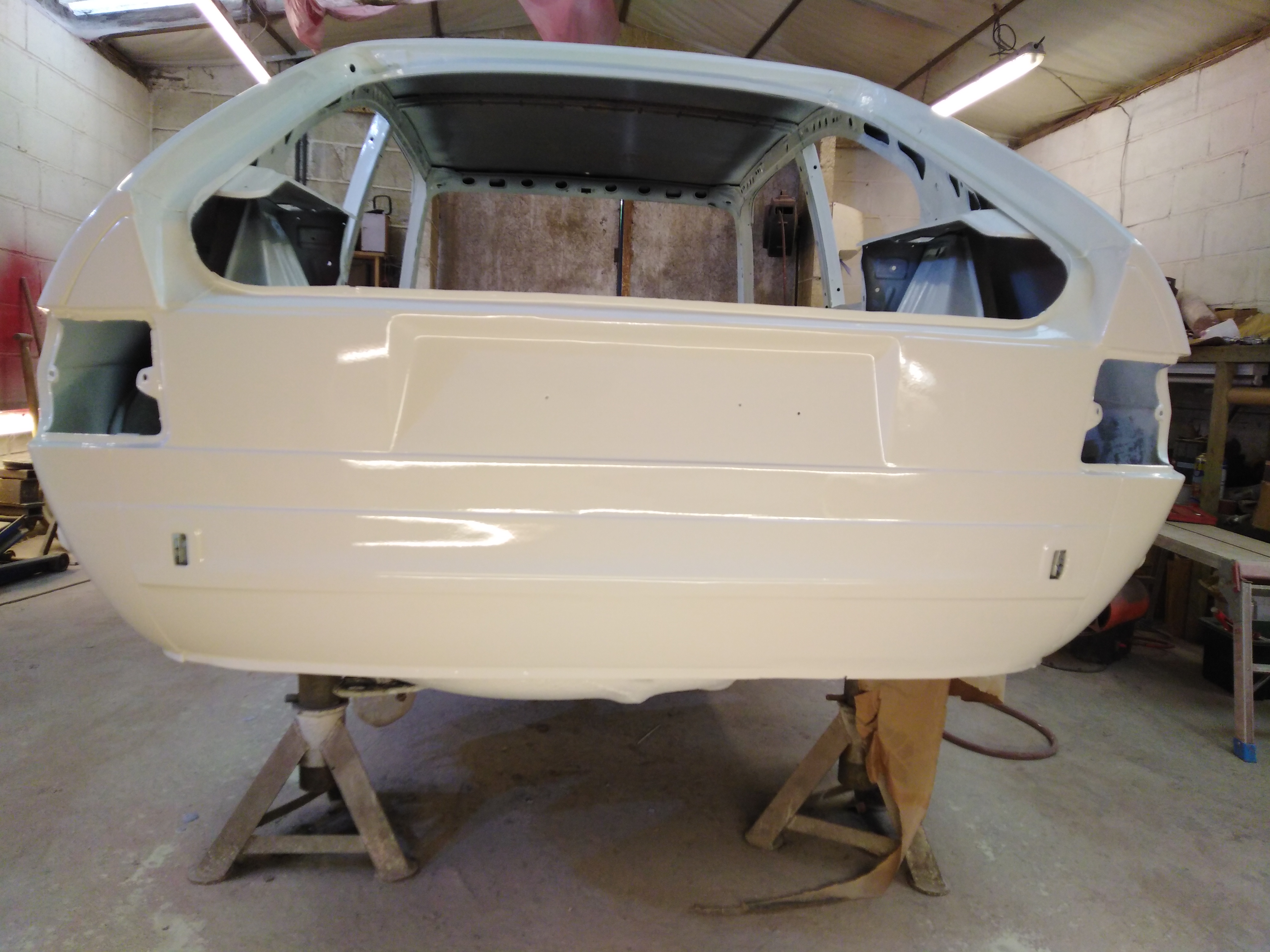

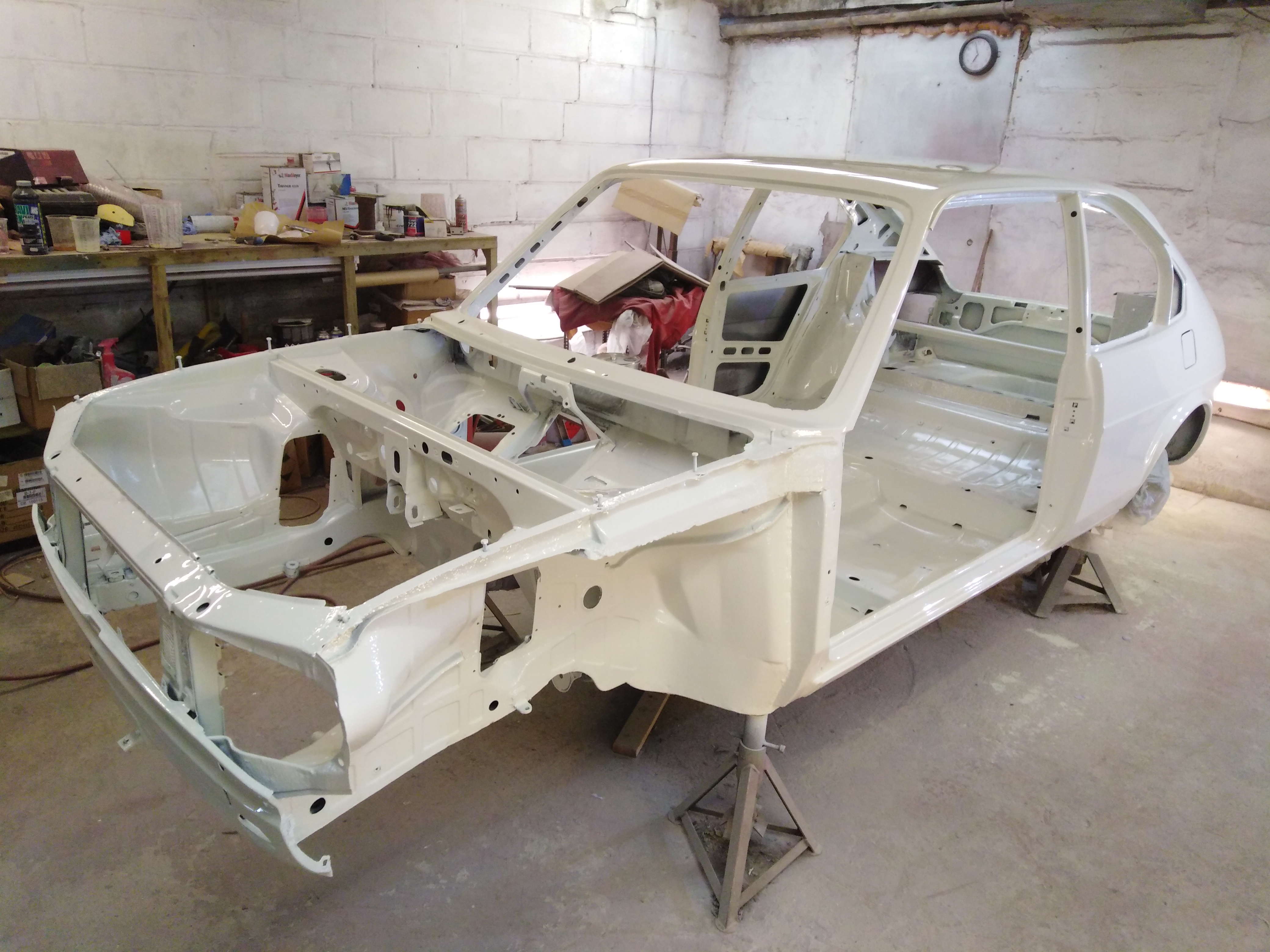

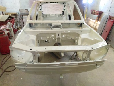

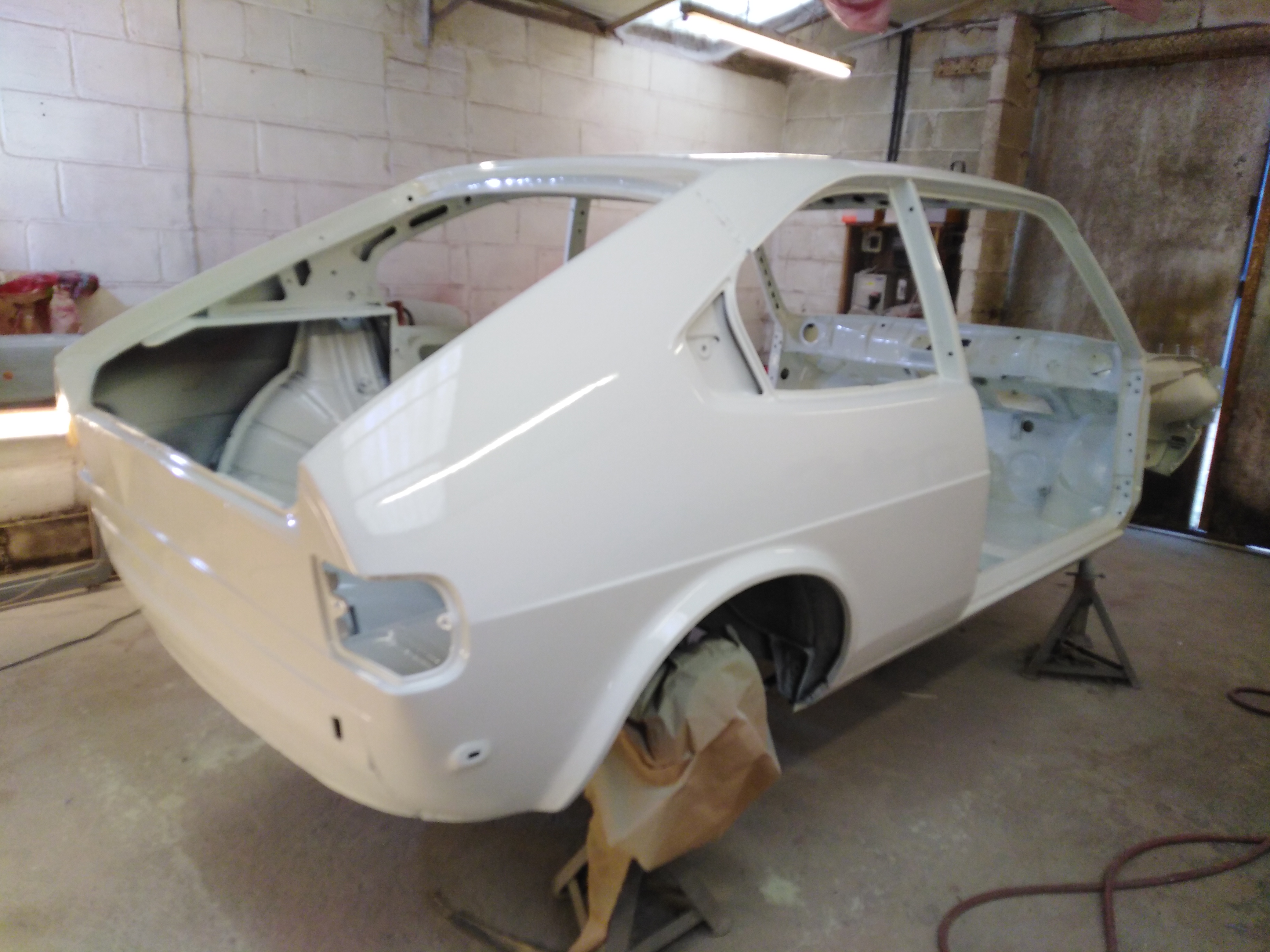

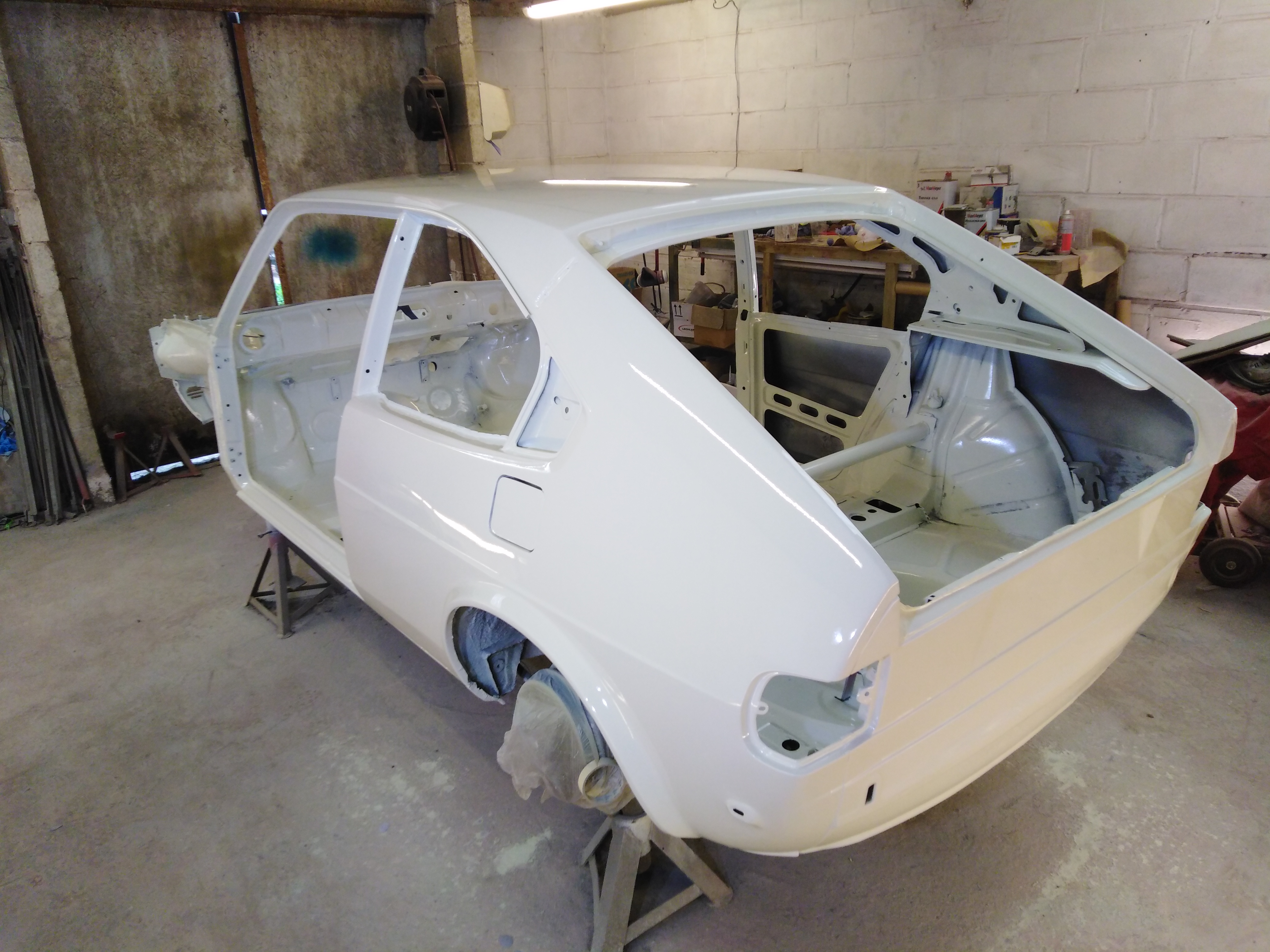

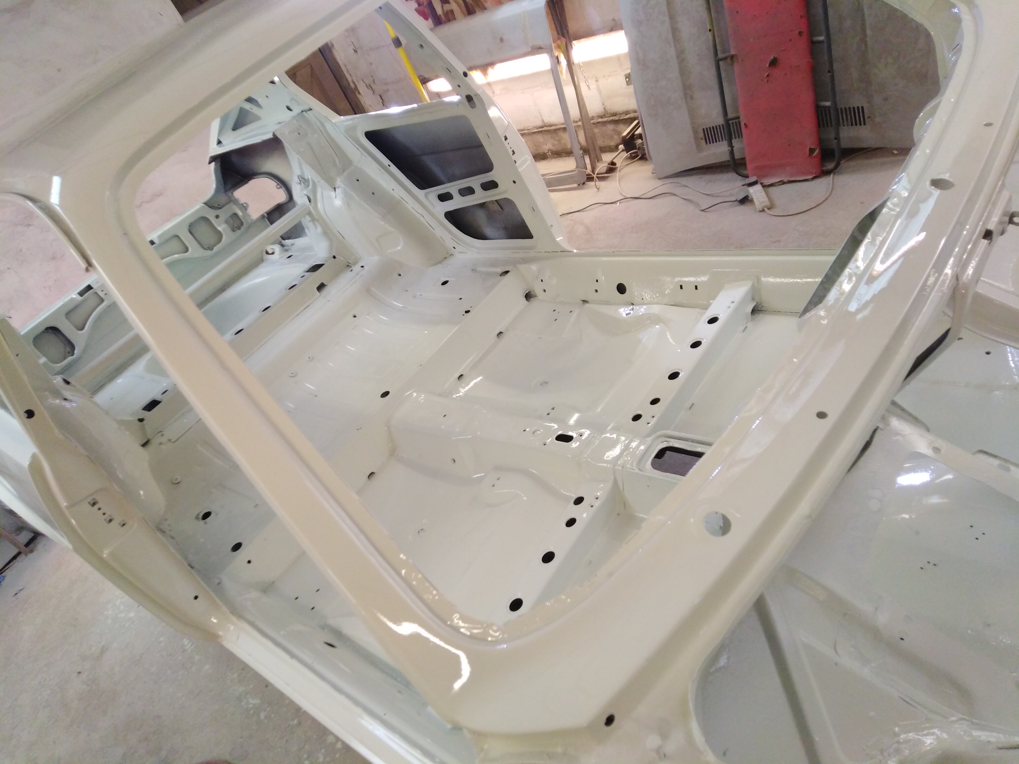

I know it's Sunday and not Tuesday,  but with the weather so favourable with no wind I decided to go up and paint it this afternoon. Playing golf tomorrow so it'll get a day to harden off before flat and polish Tuesday.
Came out OK, lack of skill got a run or two on the drivers rear 1/4 but I blame the under bench light failing on me so was kinda painting blind, more so than usual with my failing eyesight

Good effort. That has come a long way. Impressed.
