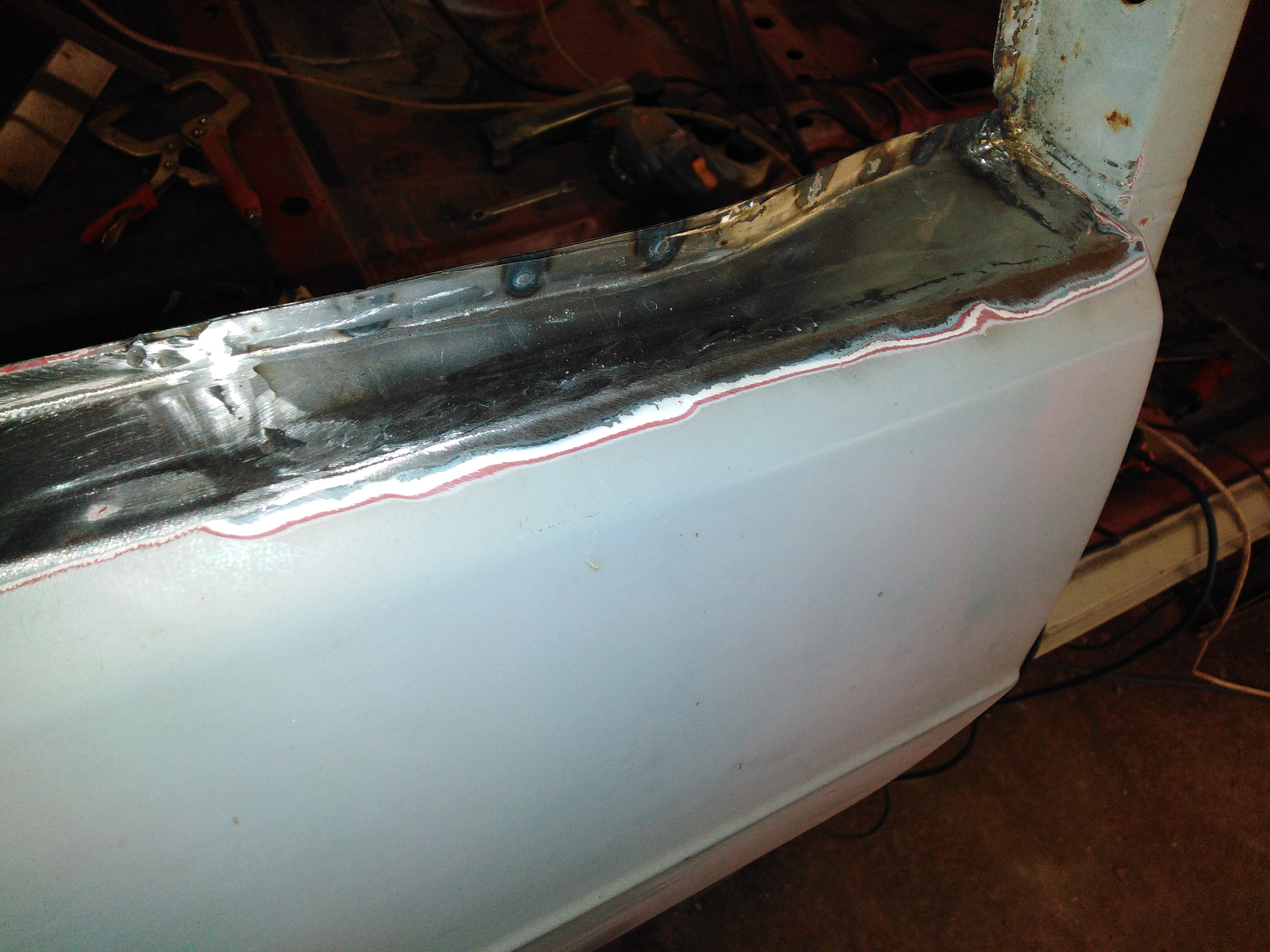

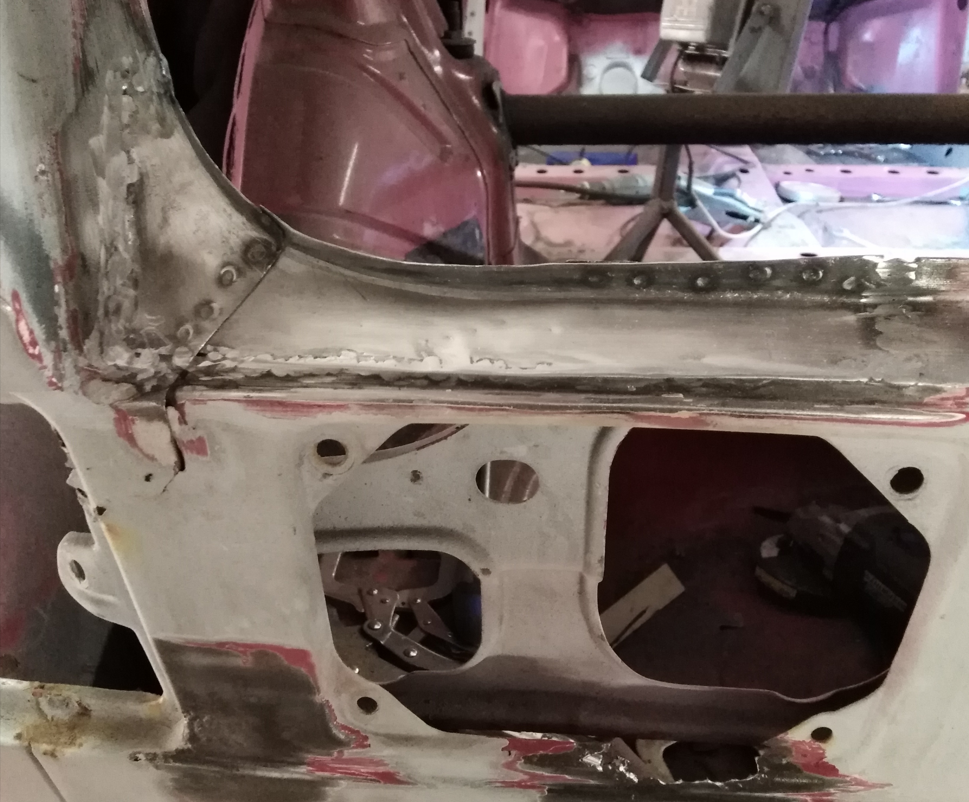

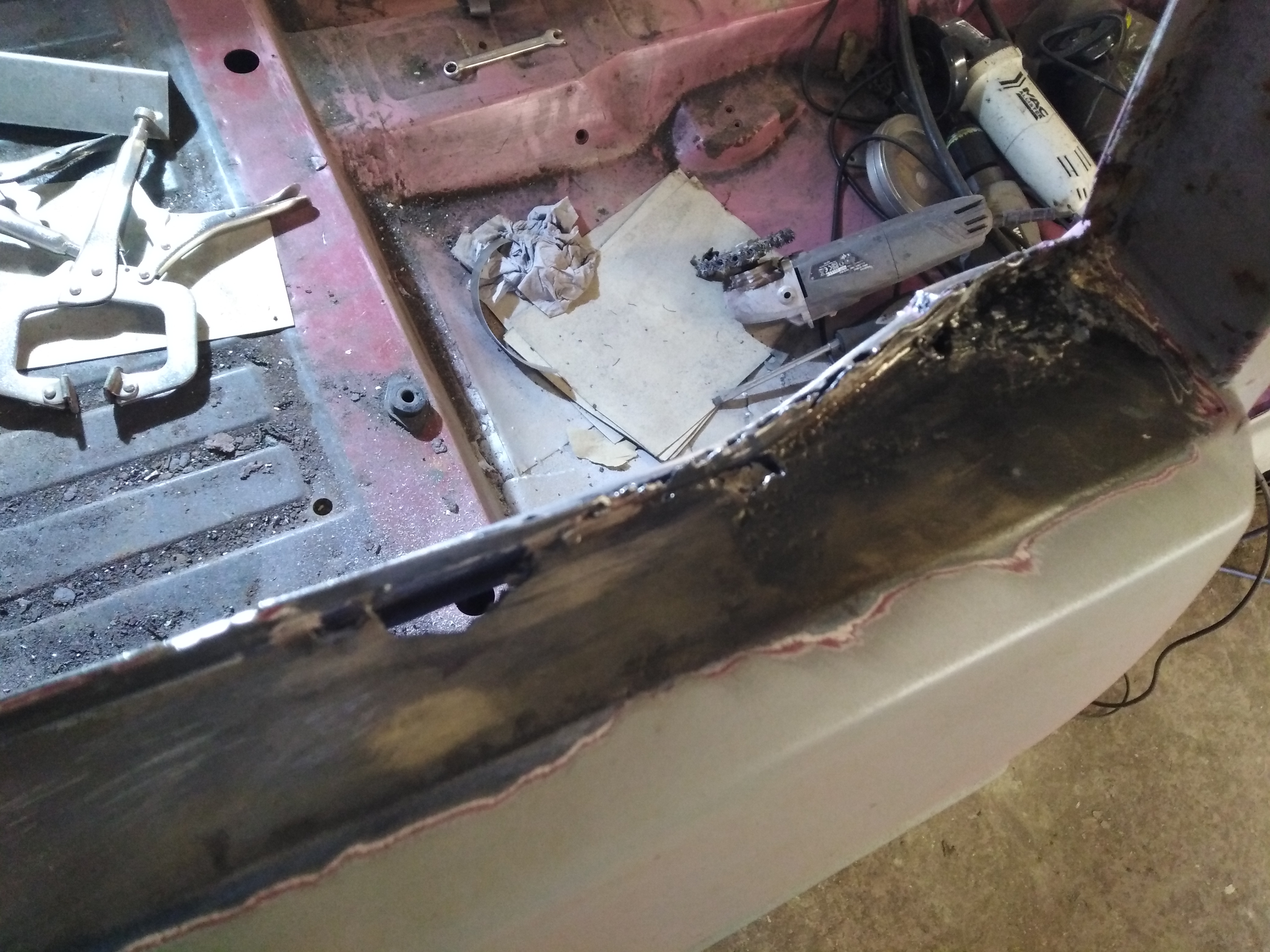

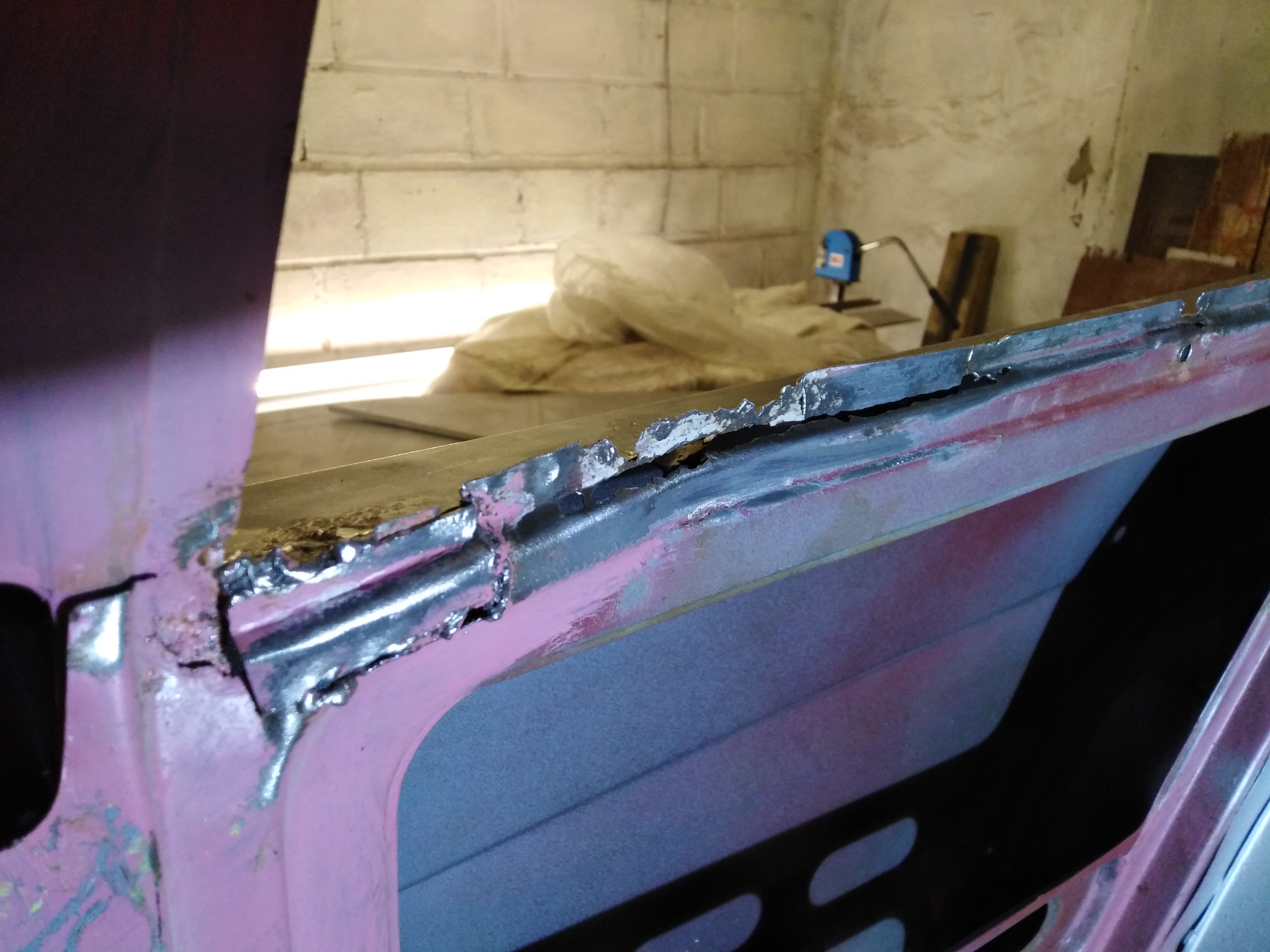

Had some jobs to do at home today, wasn't going to travel up to the unit as was getting on a bit, but as I won't be going up for another couple of weeks I thought I ought to go.
The drivers side rear quarter top that looked better, wasn't really any better surprise surprise, but the inner section was better at least!
Again, body filler over rust holes on the outer panel, dodgy looking repair on the inside.
Re: Tims' Sud

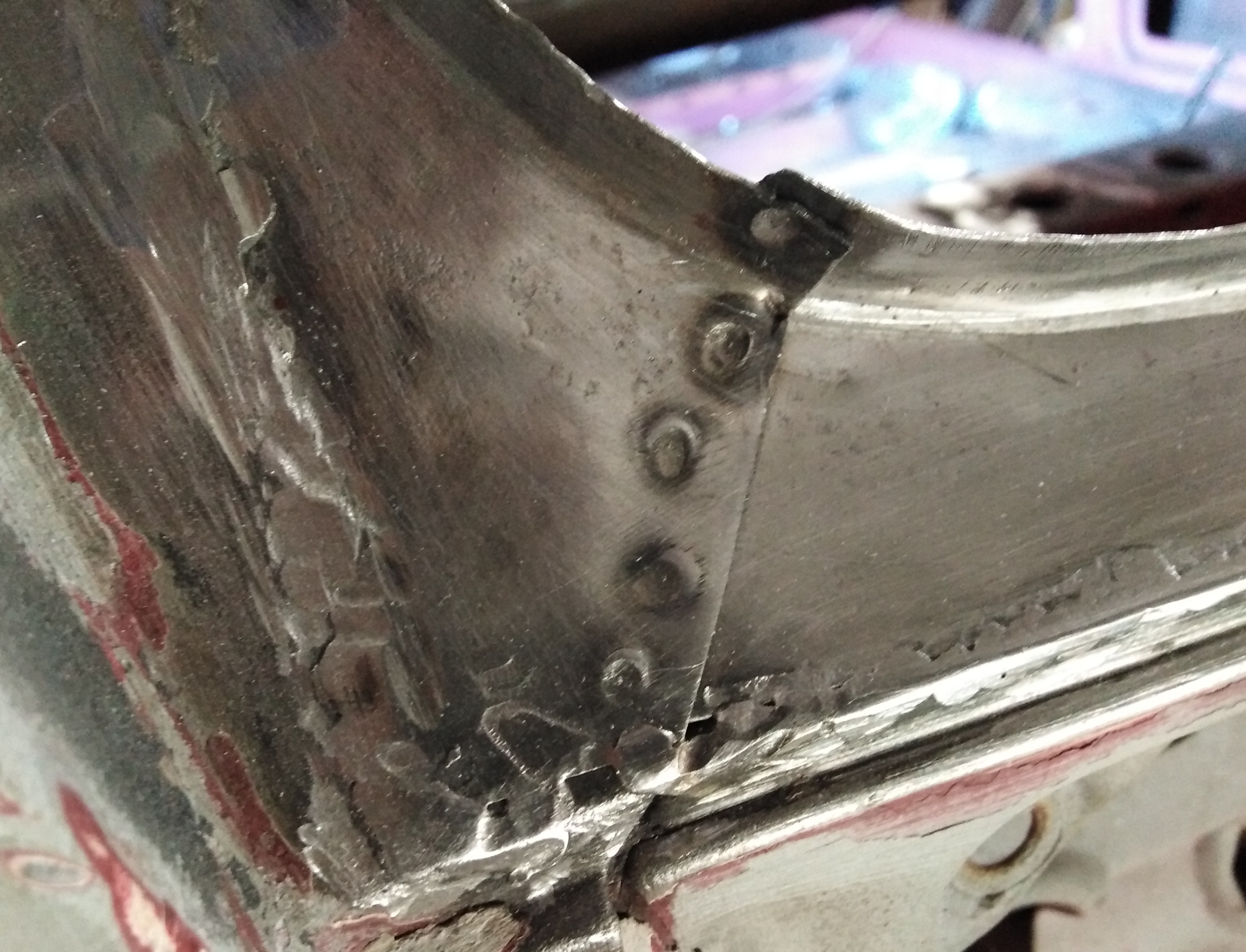

Same process as the other side, cut a big hole, make a repair piece, weld it in..
Inside piece not so bad, just really the flange and a hole near the B post, which I have welded up, just the camera flash on the shiny metal …
Short and sweet, like my visit to the unit.

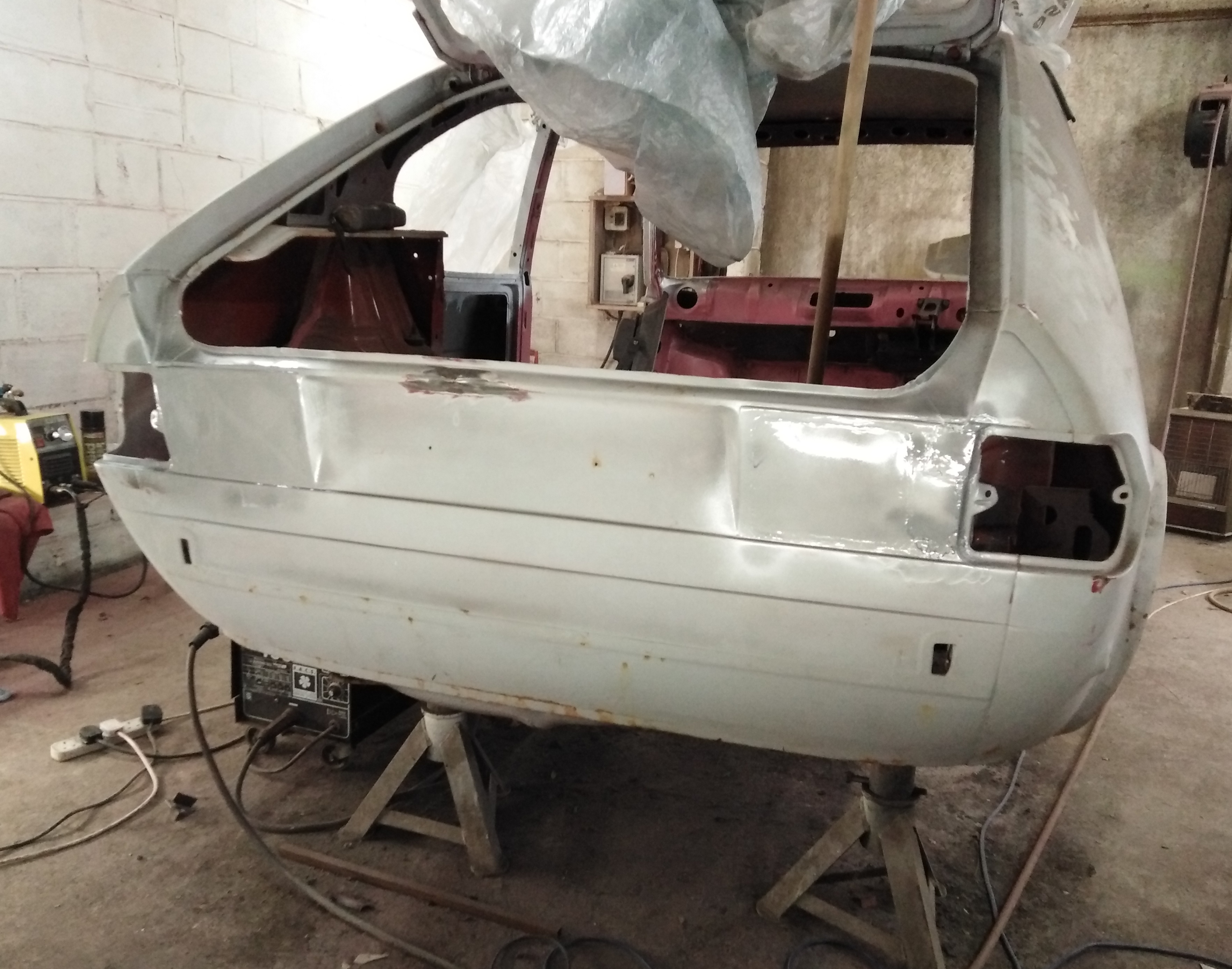

Of course, forgot that the issues over the forum update (still ongoing unfortunately...) had lost a couple of weeks posts....
Re: Tims' Sud

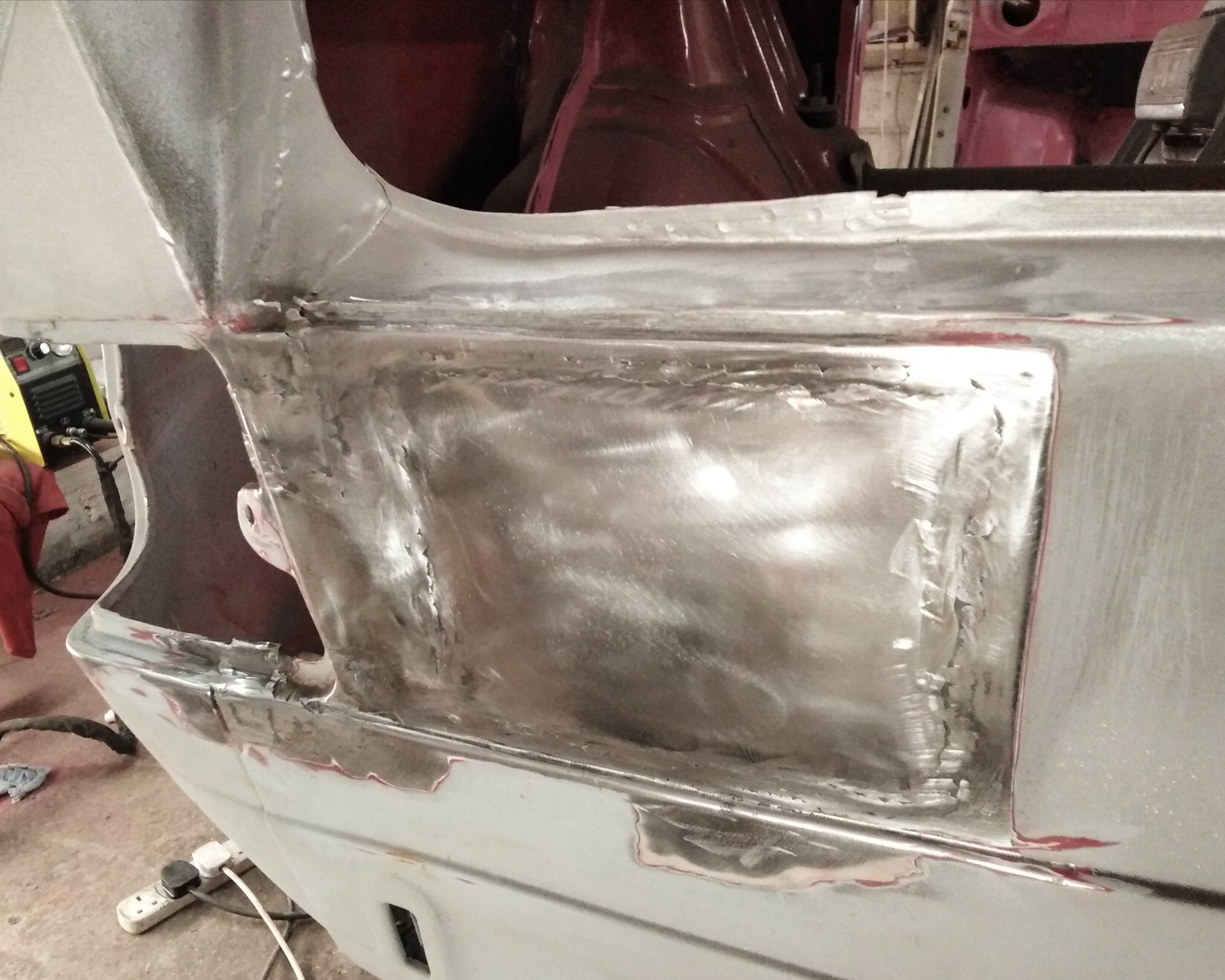

An abbreviated version of events..
Started off repairing the gullet above the rear panel.
Re: Tims' Sud
The rear panel Tim wanted the rear inner lights filling in so started off making an infil section..
Then tacked in...
Smoothed in fush..
Both sides done.

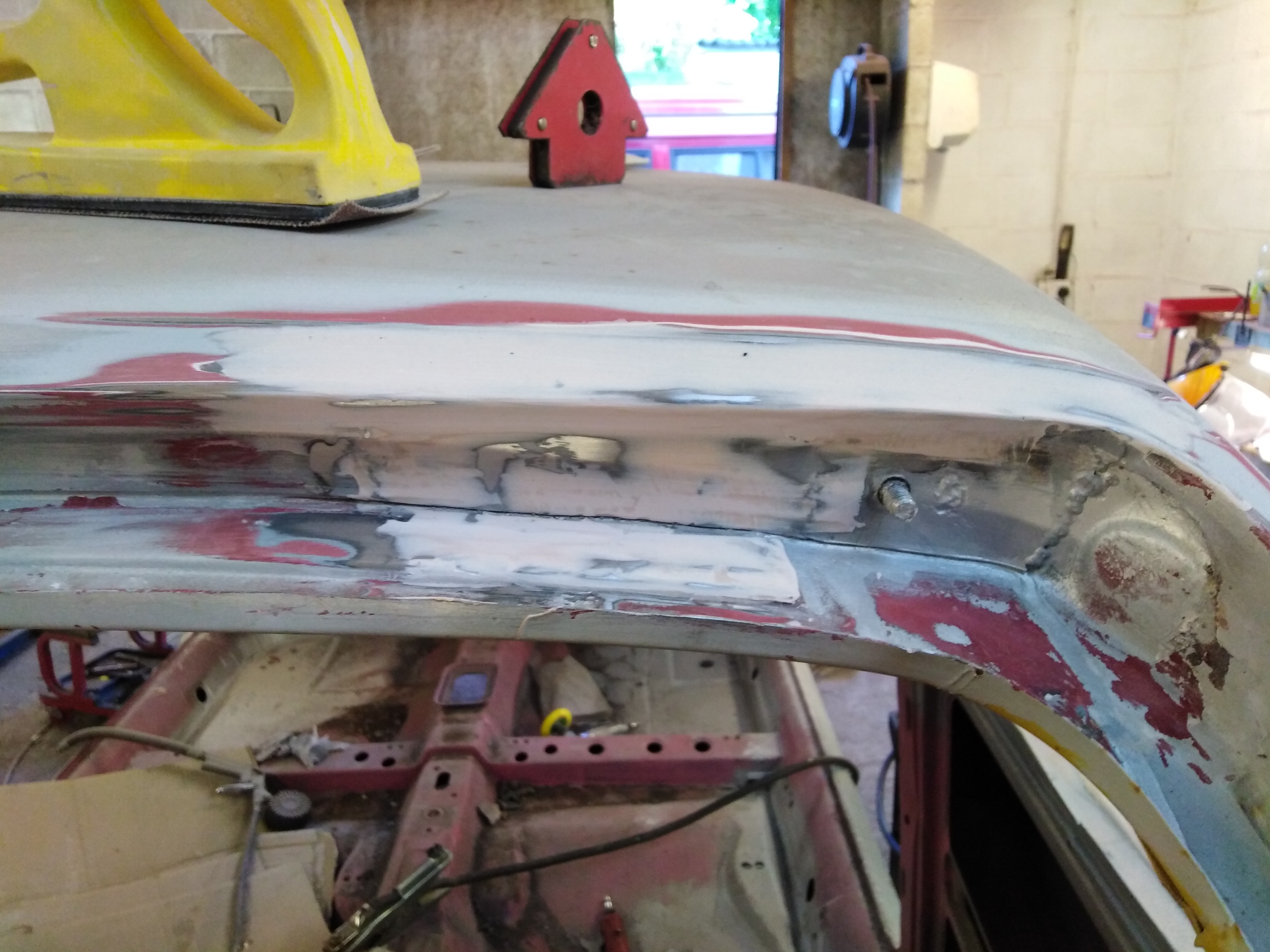

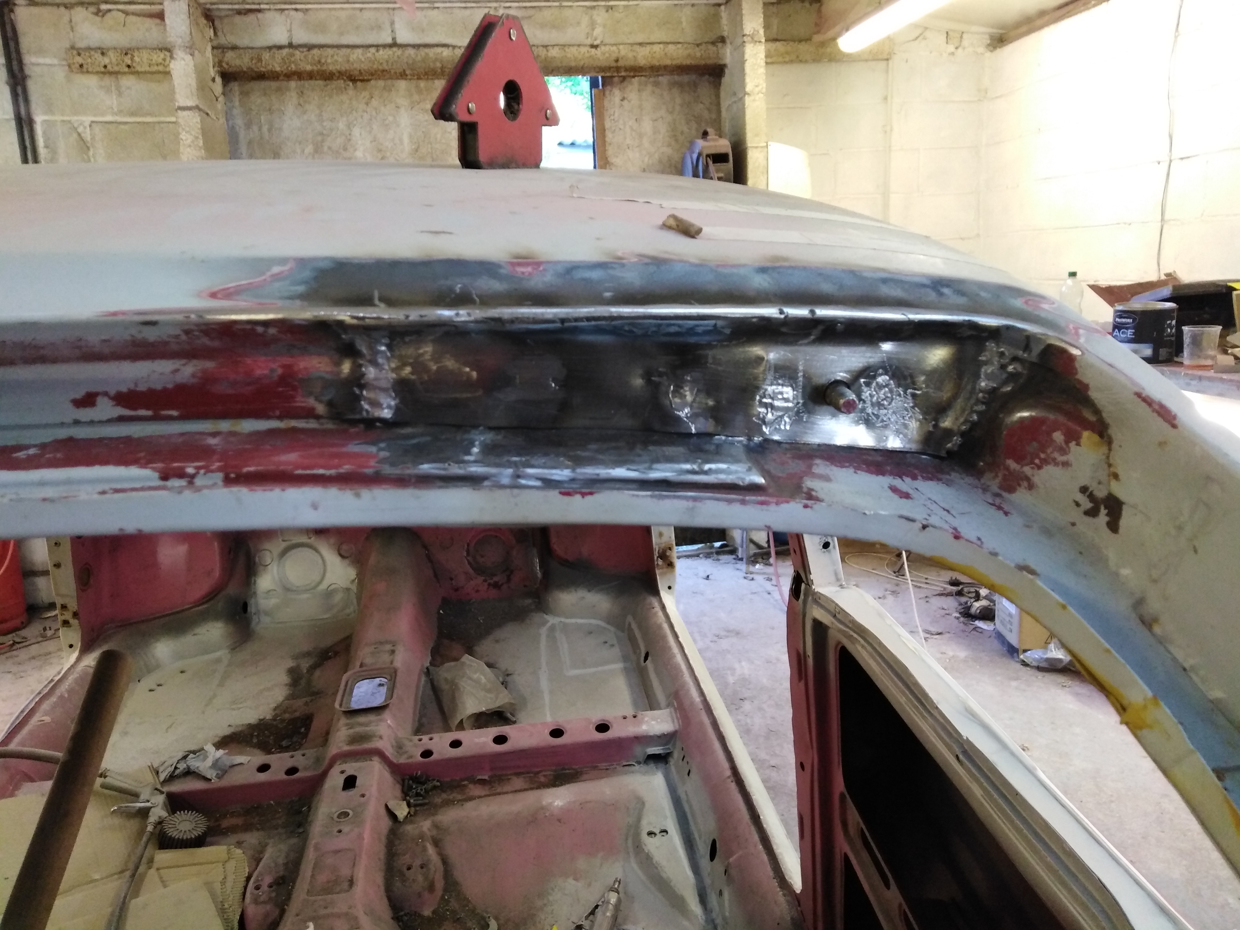

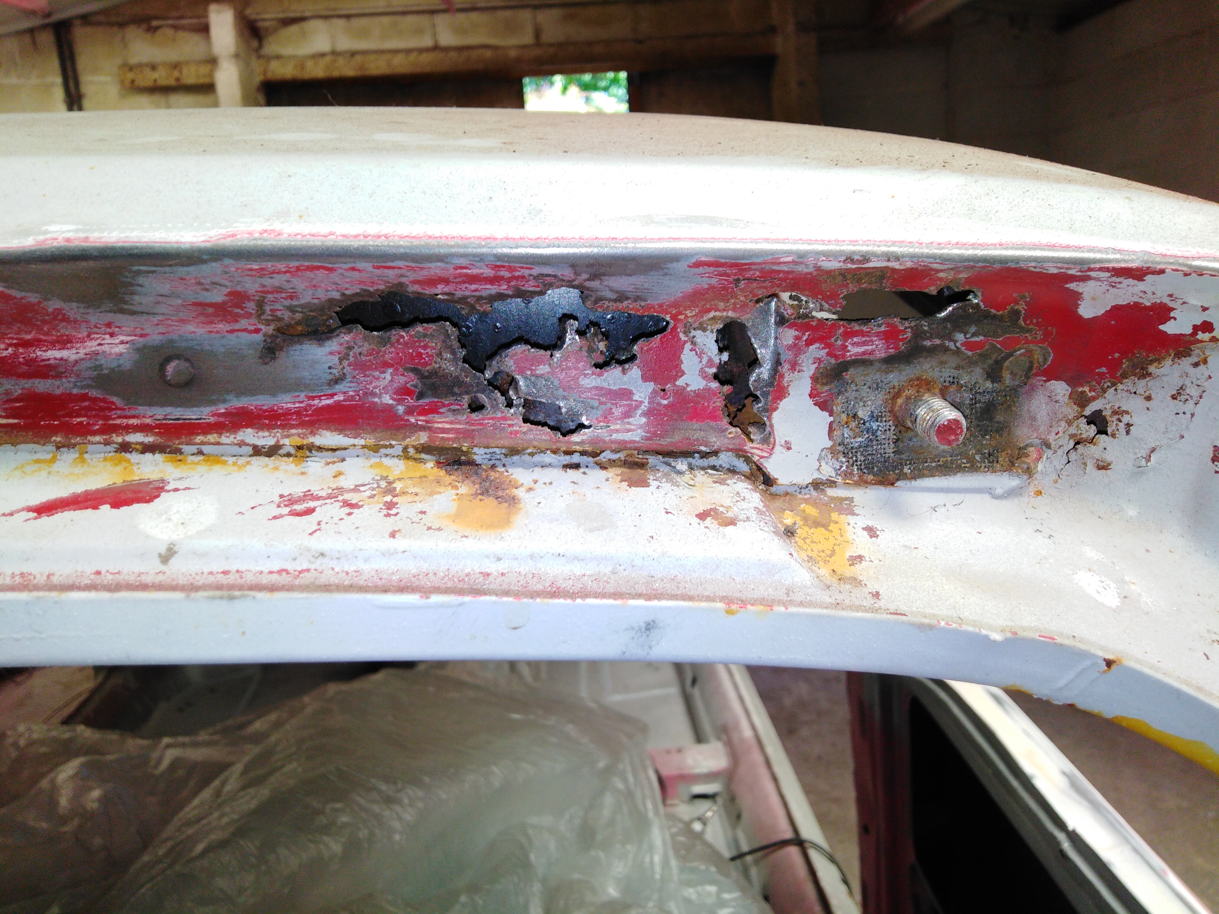

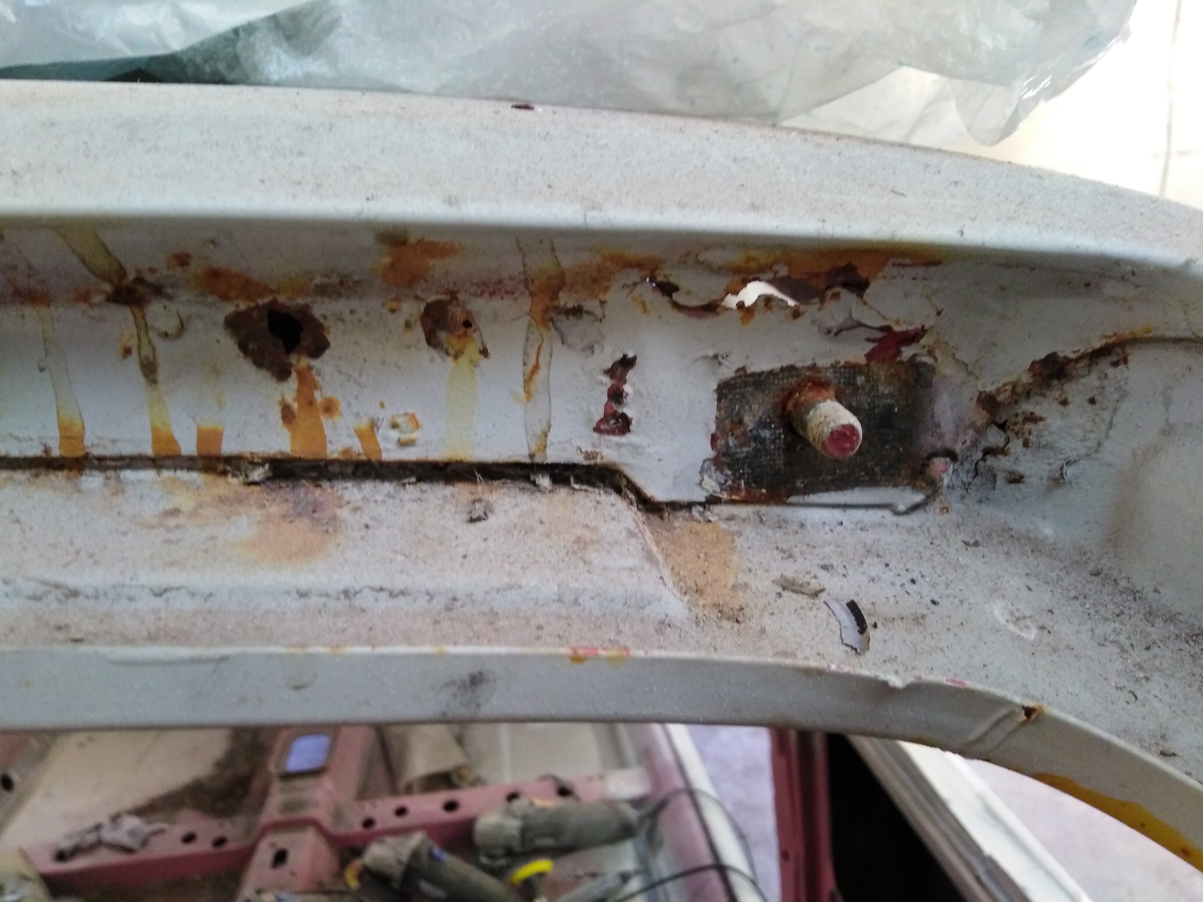

The tailgate Tim already mentioned was a lot worse than we thought. What we did know, but I'd forgotten about, was the rusty hole near the hatch hinge. That was a nice reminder when talking the hatch off..
Didn't take the knotted wheel long to find the weak points.
Rot cut out, from the roof section that comes down and the gutter section that goes up behind it.
Treated with Jenolite into the sections that hide behind, although all rot is now removed.

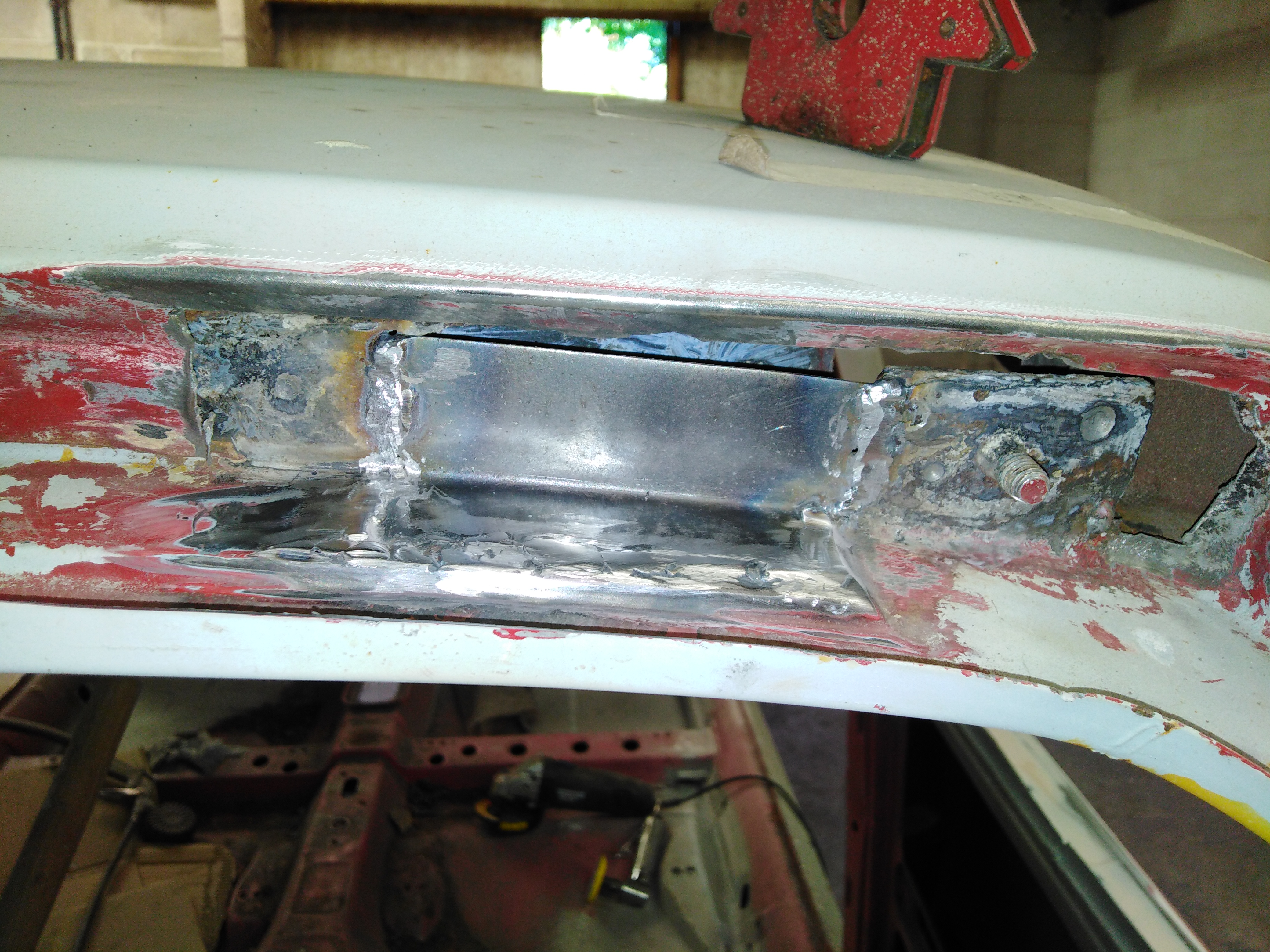

Re: Tims' Sud

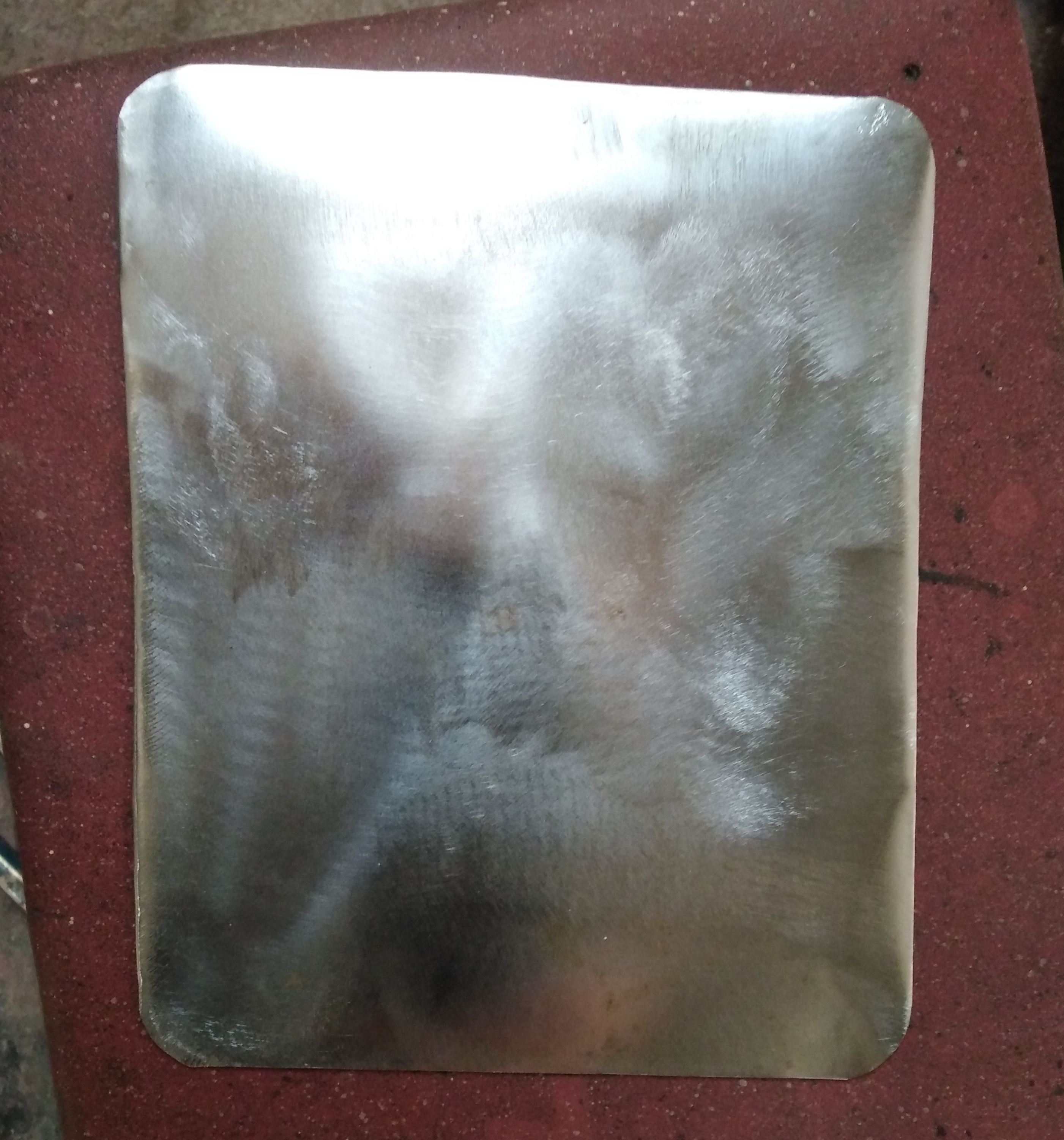

First job to repair the gutter section, makes the flat area for the roof repair to be fastened to and braces against the hatch mount for strength.
Repair piece for the roof made up and let in.
All straightened out now with a skim of filler.

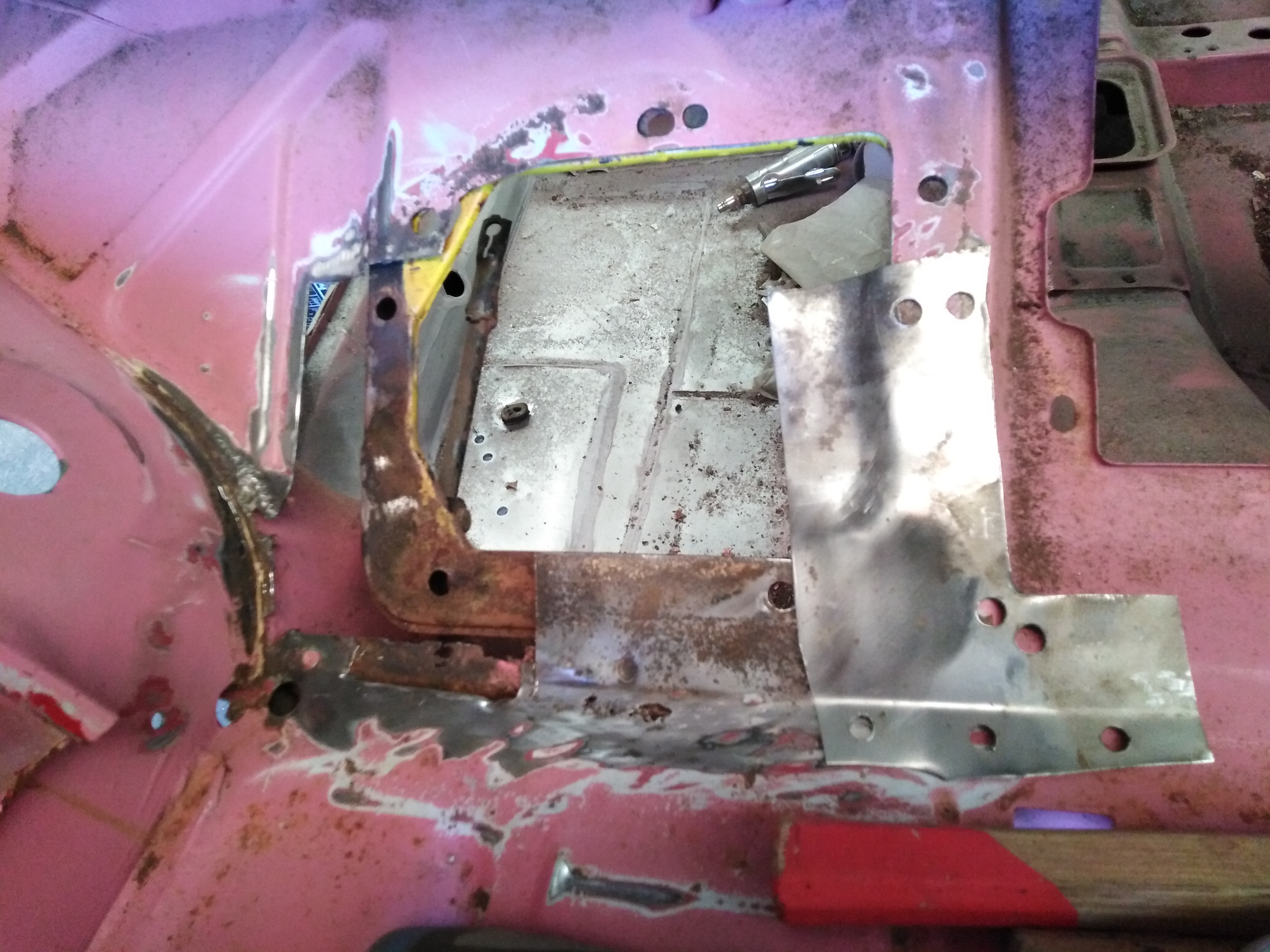

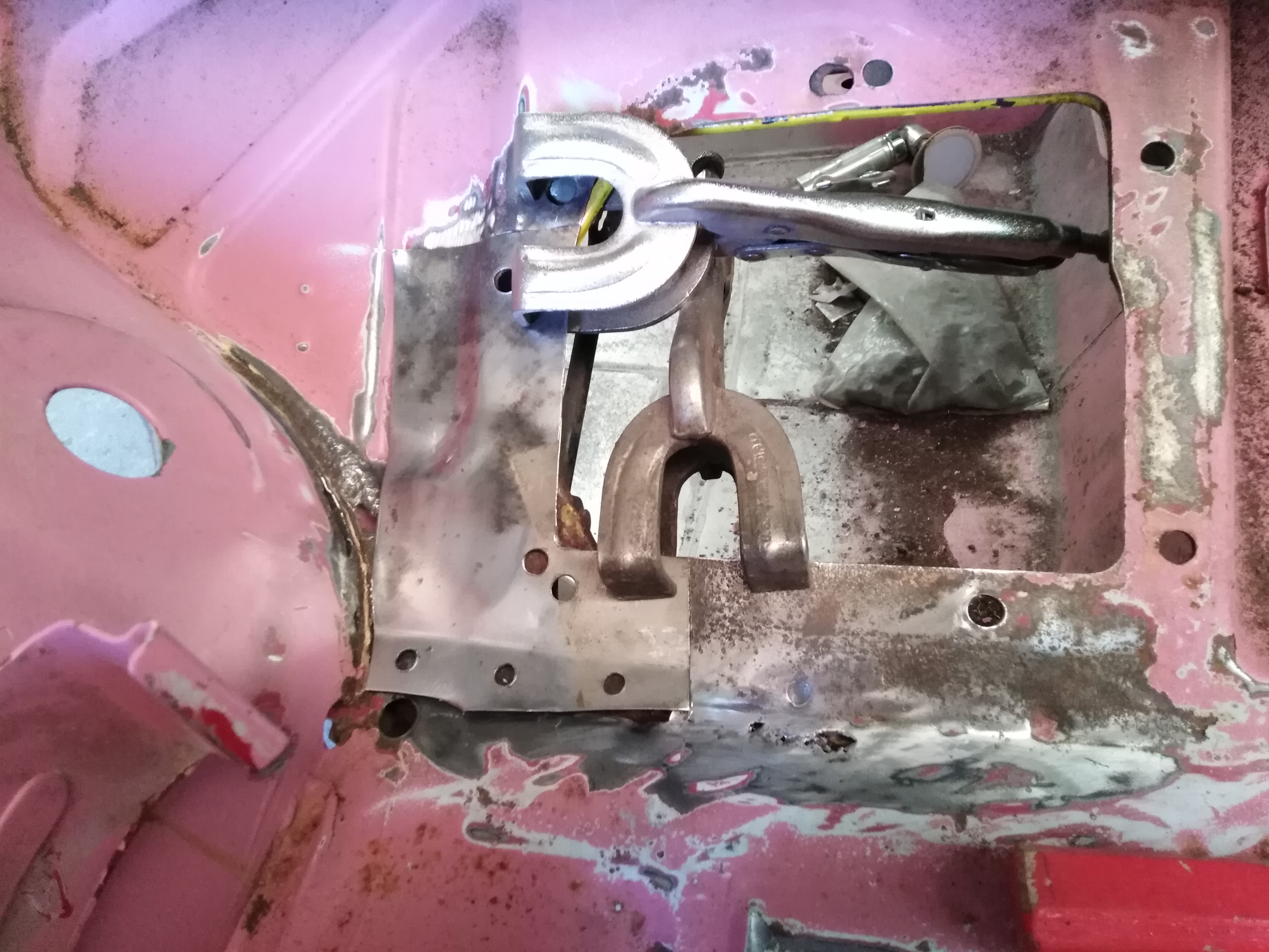

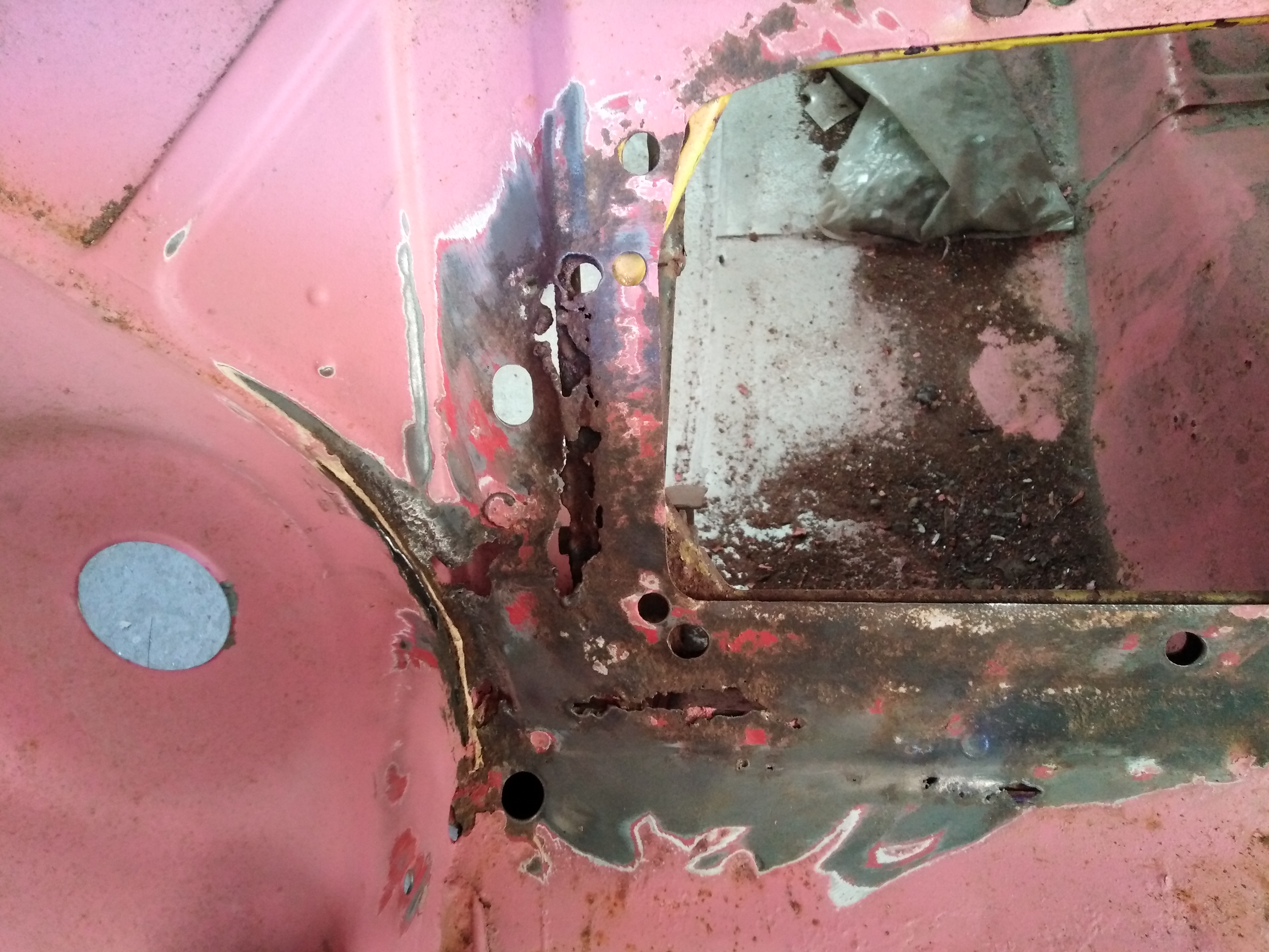

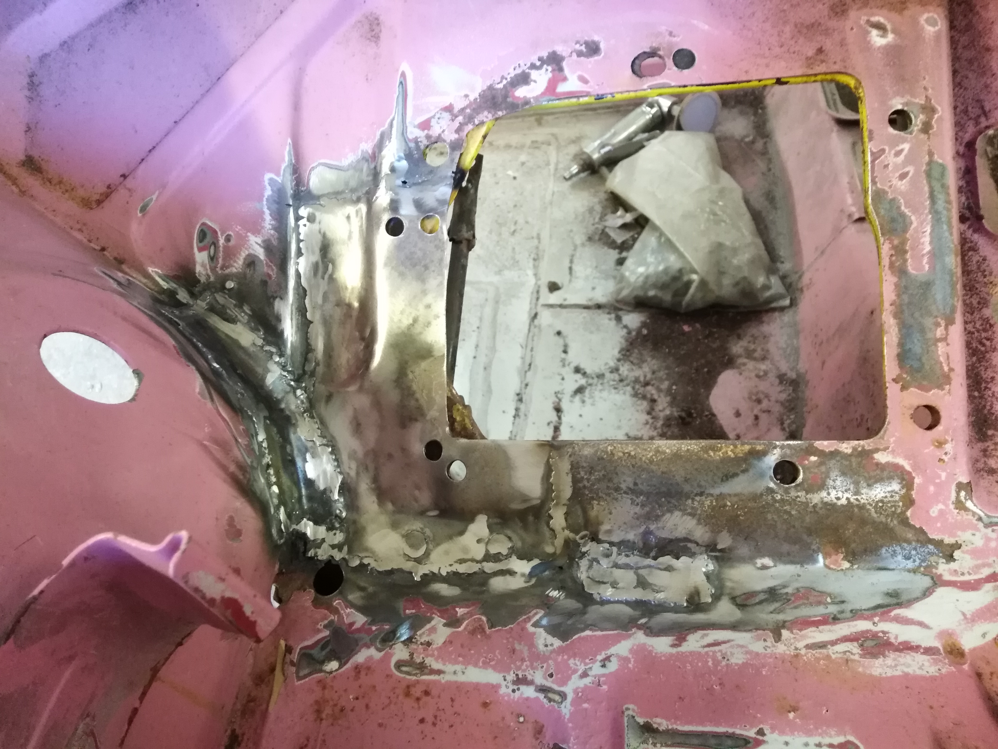

Today I lifted the bonnet to remember another area I'd overlooked, I did know the opening around the pedal box mount needed repairing but again, the memory failed me..
Rot out, patch made ready for fitting..
Re: Tims' Sud
I used the mounting plate to clamp the repair section flush, you'll notice extra holes that don't line up... not a mistake, the mounting frame is l think a sprint or 33 one. Came across this before, they have different holes to the Sud, so both types can now be fitted like the old had been modified to suit..
All back to solid again, a bit on the inner arch flange repaired for good measure too..
