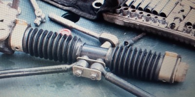

Pedrokat
Posts: 46
Joined: Sat Jan 30, 2016 8:39 am
Re: Steering rack gaiters
Post by Pedrokat »
this is my spare rack re gaitered with the first line ones .
It's now in use in my sprint.

Pedrokat
Posts: 46
Post by Pedrokat »
Looking at the picture they both go on from the white cap end, with the studs removed.
