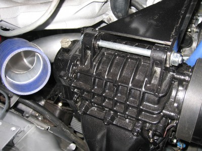

Yes, and this is what hides under the plenum.
25psi on street fuel.

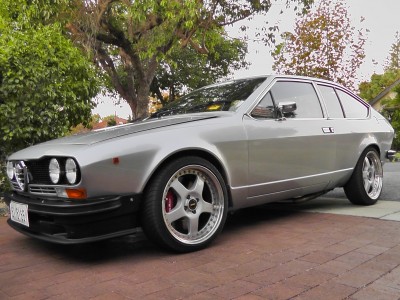

Exterior.

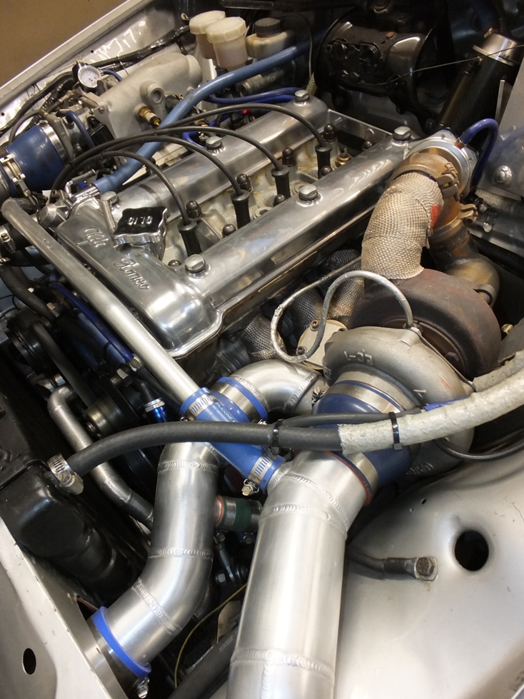

great to see the twincharge on here.
This car is my inspiration to keep plugging away at my little projects.
Did'nt know you had put the polished cam cover on, looks good.

Yes, the car puts out about 400hp at the crank, at a guess. I have had it on the dyno in the early days, and it made 190KW@the wheels on 26psi. Since then I have added a bypass valve which I actuate at 3500rpm and a much much better inter cooler setup. This improved top end considerably as the sc14 supercharger is a twin lobe basic charger with a paltry efficiency rating, where as the GT35/40 turbo running 1.06 rear is 76percent efficient at the 26psi I run on this engine.
That's on a stock head and stock liners, so lots of scope for improvement.
I also have water meth injection, but I am yet to turn it on.
I am now building version 2 with a target of 700hp, one day I would like to take it to Bonneville..that is the dream. This engine is based on a twinspark...with anything but stock head. It's a lofty target, but as they say, aim high, and if you just miss the target, the result is still impressive. 8-)
