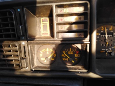

Went up to the unit tonight to do the oil & filter change for the Gulf 20W50.
Seems like it's another step improvement!
OK this is with a fairly cool engine but I've never seen 8b pressure before.... 8-)
Obviously once a bit of heat got into things it dropped to a more reasonable level, 5b+ at around 70mph, good thing is that even when bumbling around in top at 40mph it's still showing around 3bar+ pressure, even after the new pump it was dropping slightly below 3bar at those speeds so the 20W50 does indeed seem to be another step on.
I'll maybe try some Valvolene 10W60 but very happy with the results from the Gulf oil.
