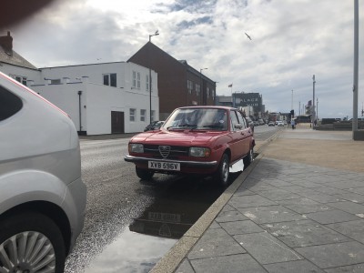

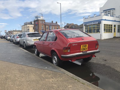

Good result Col, you know we now need a photo of the car. :D

Hi Keith it’s a lovely original car just coming up to 20,000 on the clock

That's great news - that's another little cracker of a car you've got there 8-)

Where do you keep finding these gems ?
Lovely find and such low mileage.
Magic.!!

Is that a red car in Redcar?

Great looking car!

It certainly is Dave
