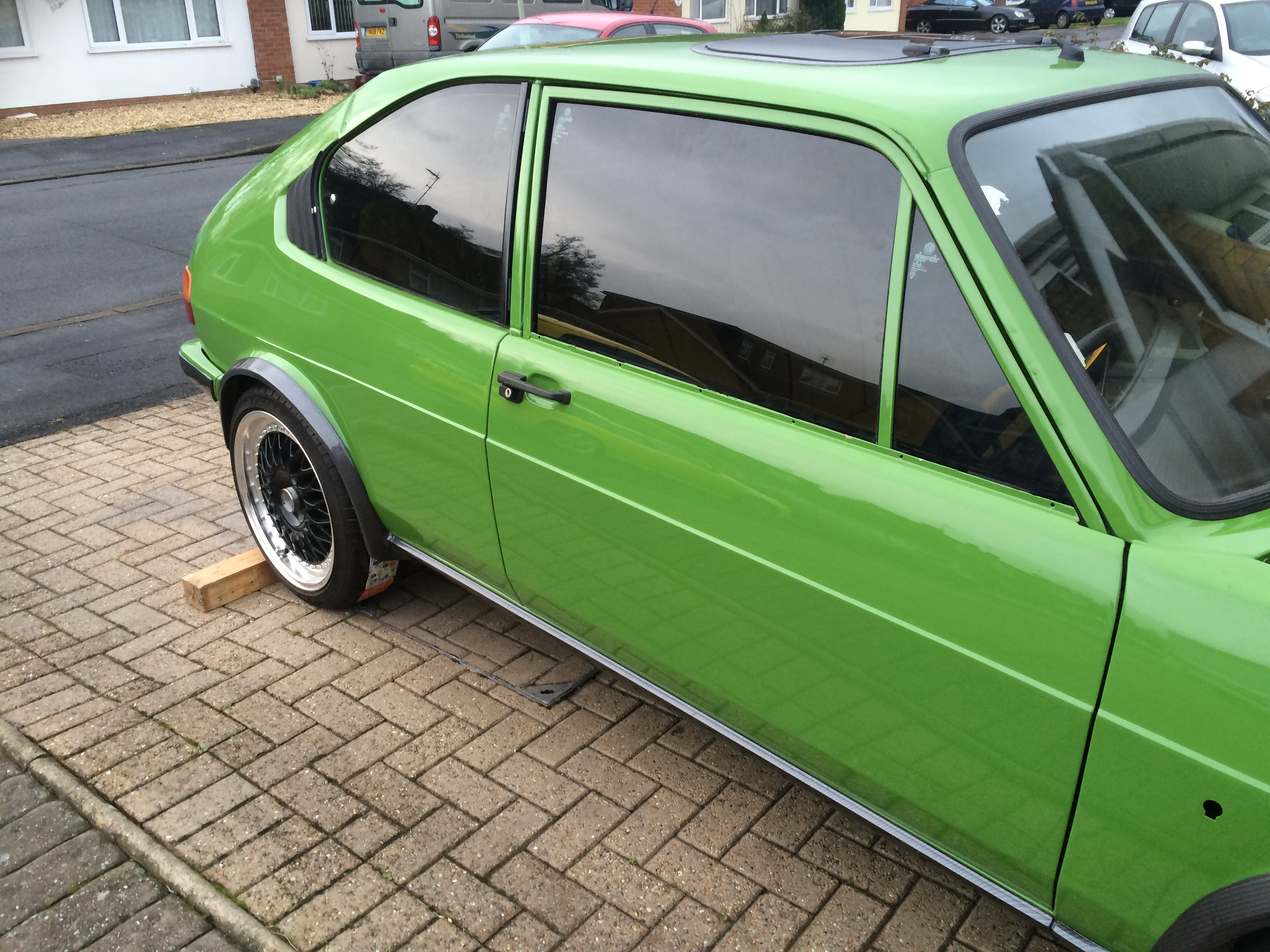

Thanks H i thought they looked a big wheel, iv never seen a 17 on a sud before am not suprised you had to extend the arches. I asked as am looking at changing the wheels on mine for something with a higher offset than Ronal A1's iv got on now and am wondering whether to go for 13's 14's or 15's
Love the colour of your sud by the way, look forward to seeing it at MITCAR next year??

Will be nice to get her on the road though, with no more hassles of relying on spray painters and vinyl wrap "specialists" - will have to take some pics of the carbon dipping I had done to replace the crappy vinyl, So much better and cheaper too (if you don't get some idiots doing the vinyl wrap first and go straight to the dippers).
Good luck with the wheels, don't forget Image - they have some nice (but expensive) wheels and can do any offset you want.

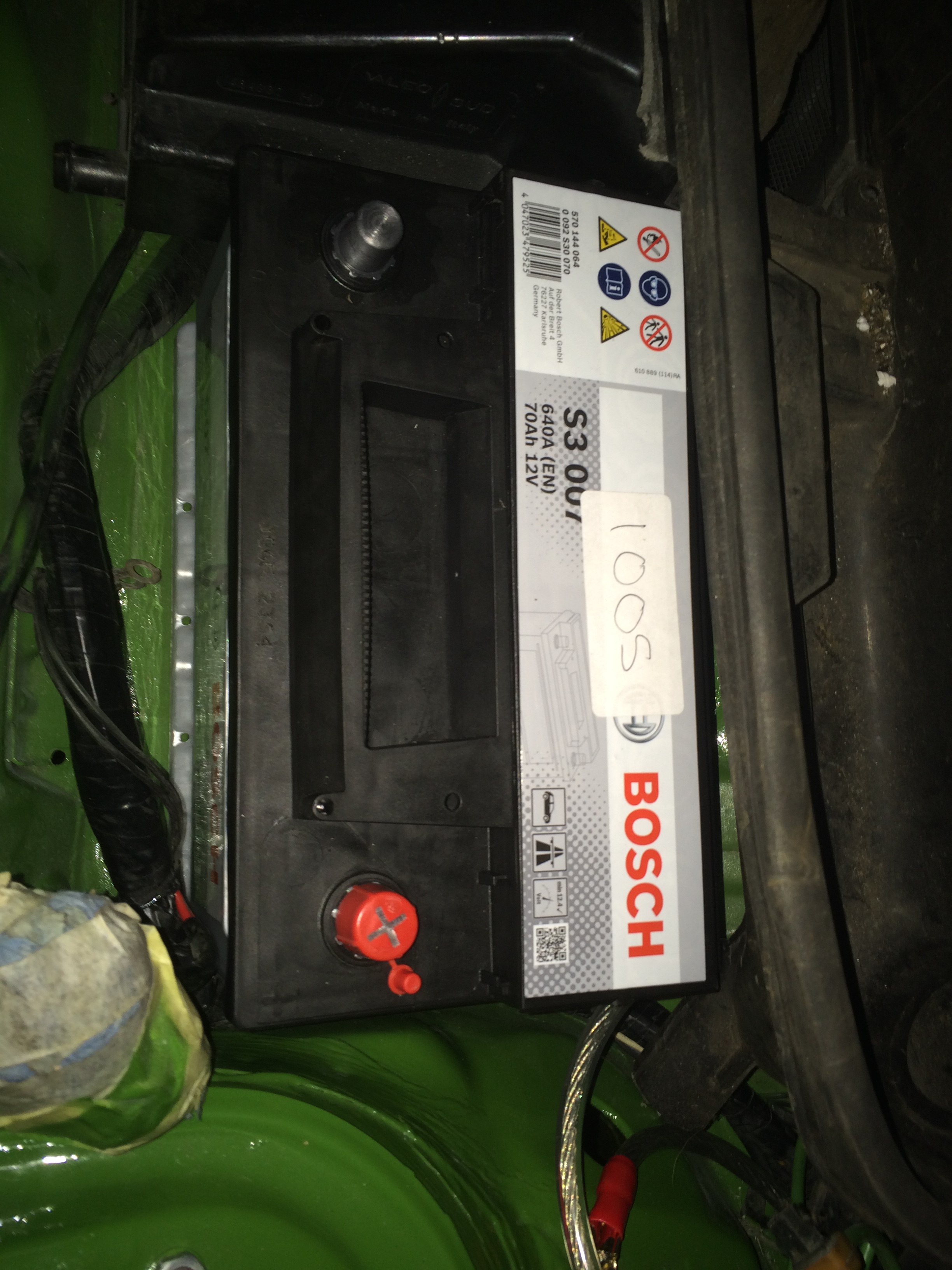

QUESTION IS how big a battery can you fit in a sud ?? - me thinking I need one from a diesel to get the amps required ??
I also want to fit a strut brace so this would affect the height ??

H,
If it helps, I have a 62Ah 600 battery on my JTD (1.9). It measures 10" x 7" and 7 3/4 " tall.
My Sud's one measures 8" x 7" and 8" tall.
A quick measure looks as if it would just squeeze into my Sud and would be similar height.

Kegsti66 wrote:H,
Keith
Hi Kieth, that sounds really great as the wife has a 147 JTD, wonder if she'll notice.
I haven't got the battery box or the "air / heater collector" ( that great big plastic bit) in but I'm sure there was some room length ways from memory, are the pos and negs the right way around ??
Thanks

Hi Kieth, I measured the wife's and hers is 11 inches long, so that got me worried.
I've been on the internet and found a 80 amp but is 190mm tall not 175mm so maybe going for a 70 amp 278mm x 175mm x 175mm from Eurocars which is down the road from me which means I can hopefully take it back if its too long.
The "standard" Sud ones are only 45 amp max so the new one should cope :D
Thanks for your help.
H

Went for the 278 x 175 x 175 one in the end - only 70 amps but it does fit and should be low enough for what I believe might be a Shew yellow or red powder coated strut brace :D
Just a thought could i get it carbon'd dipped ? can't see why not as long as it doesn't get submerged :? Does look a bit crap being grey!

Manage to bring my I Phone lead home so I can add the pic
