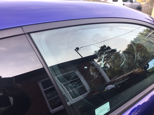

Mito passed its first MOT, no problems today and to celebrate, on the way back it decided to snap the window regulator cable - so parts ordered and I'll be tinkering with that next weekend!

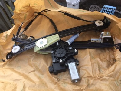

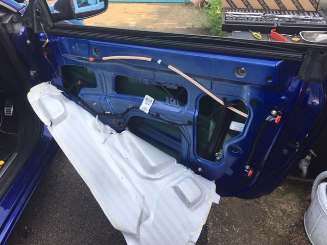

New genuine parts regulator arrived last week. After my earlier recce, it was straight forward to strip the door card, and following some helpful YouTube guides, it was easy to remove the old regulator - yes the cable had snapped. Reassembly was easy, much easier than changing the regulator on the Freelander! A bit of fettling to get the glass position right, then buttoned it all up and all is now smooth as new again. It's a fun car, and apart from this and the strut top bearings, has been a good reliable car - certainly much less hassle than the GT.
