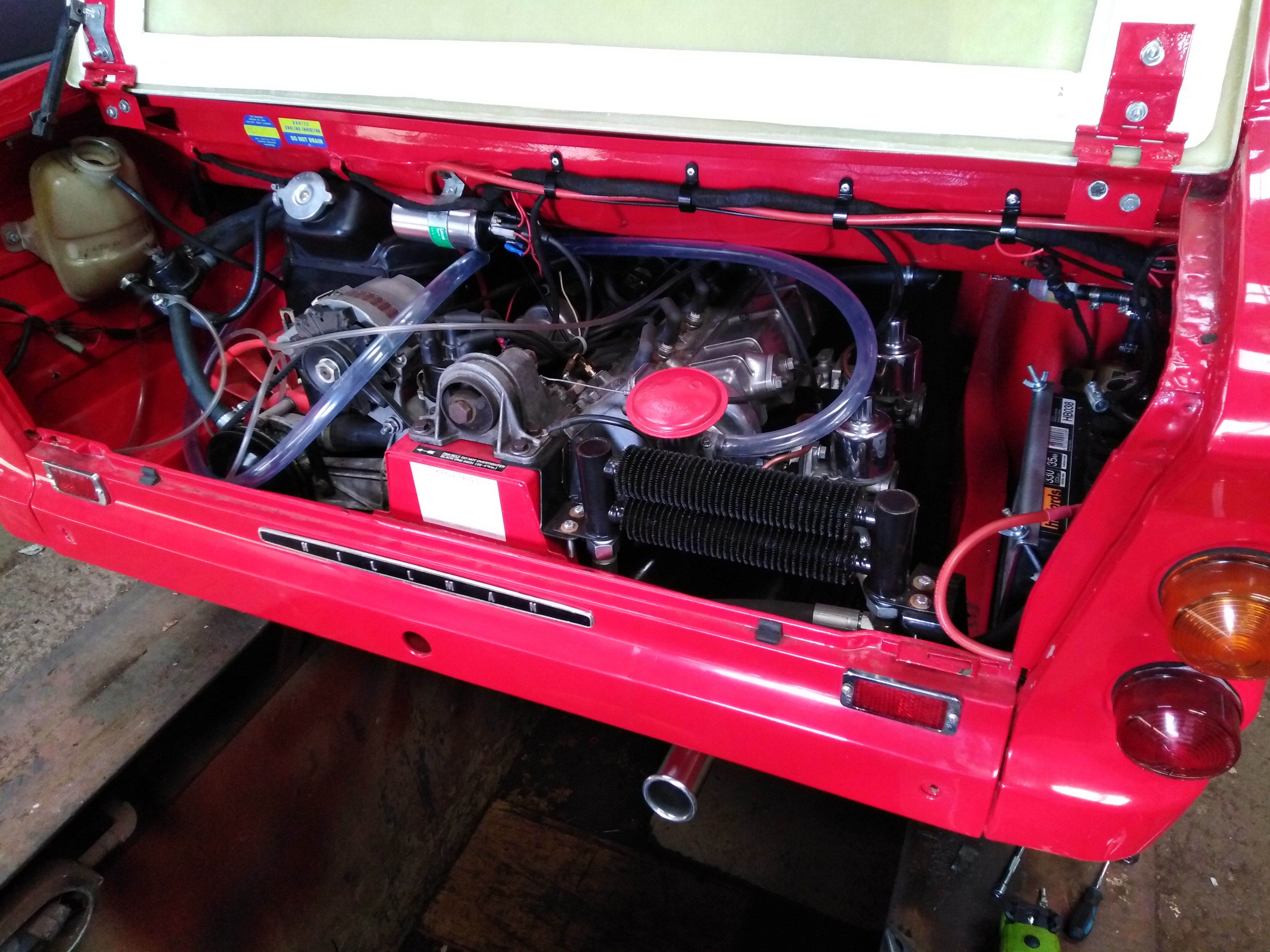

Rob has been busy over the winter on his Imp, engine and gearbox have been out for some modifications mostly to the gearbox ventilation system to prevent pressurisation.
Whilst he was at it he's fitted a stainless tubular exhaust system and twin SU carbs.
He's also finally come up with a way to fit the 13x7 wheels to the front too this afternoon with some coilover suspension legs on the front, he can't use full lock as it scrapes but he's happy!
I've of course now got 2 more wheels to paint...

Rob has been pressing on with the Imp, he's adapted an inlet manifold that was for Stromberg carbs to use twin SU's.
He's made up all the linkages and heat shields as he went along, made a decent job of it. Still got the K&N filters to go on.
He's now got the stainless tubular exhaust on with a nice rolled tip.
Oil cooler on now so with the polished bits and wiring tidied up over the Winter it's looking a lot better in the engine bay.
Re: Kev's workshop projects
Pass on my credit Kev, that is looking lovely.
Nice pipework and oil cooler looks fab. Nice touch with the manifold and polished SU's. 8-)
Is that also another boot lid? :?
Yes, he's been on at me all Winter to cut some louvres in the boot lid mate, not something I've attempted before so wasn't that keen.
So he ordered a fibre glass one with all the cooling slots in it!
Just needs a bit of fettling for latches etc then of course painting... :roll:
