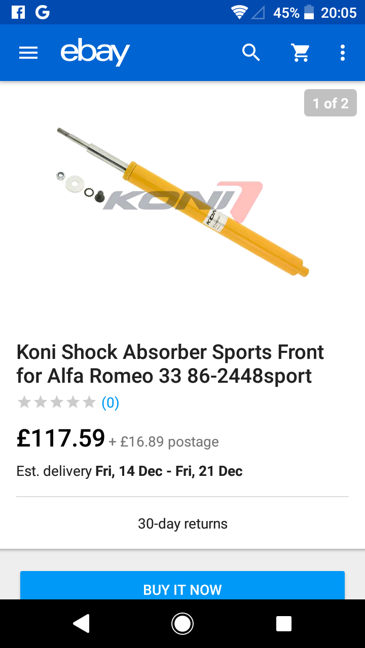

These on ebay
Sprint88qv
Posts: 238
Re: Shocks for a 88 sprint
Post by Sprint88qv »
Thanks Alfastrut, that certainly looks like them (I’ll check the numbers when I get back, but of course they may have released a newer version). If you have found them on eBay, that’s a star find as they were difficult to find some years back.
Brussels, if you’re not brave enough to chop up your own struts (I wasn’t :-) ), just get an old pair from JustSuds and chop them up. You basically cut to top lip off, remove all the inners and drill a hole in the bottom for the bolt to retain the insert inside the strut.
Post by justsuds »
The konis are for series 3 33, 1990 - 1994, but will fit if you use series 3 top mounts, the diameter of the top end of the damper rod is smaller than your Sprint, - and series 2 33 ones - and will be a very poor fit into the rubber mount. However, series 3 top mounts are the same 4 bolt pattern and should work fine. If you need Boge bodies and top mounts I have some ! Koni part no.s for your Sprint are 86- 2417 for Boge units, or 86-2303 for Spica - these also fit Suds with Spica legs.
Cheers, John.
