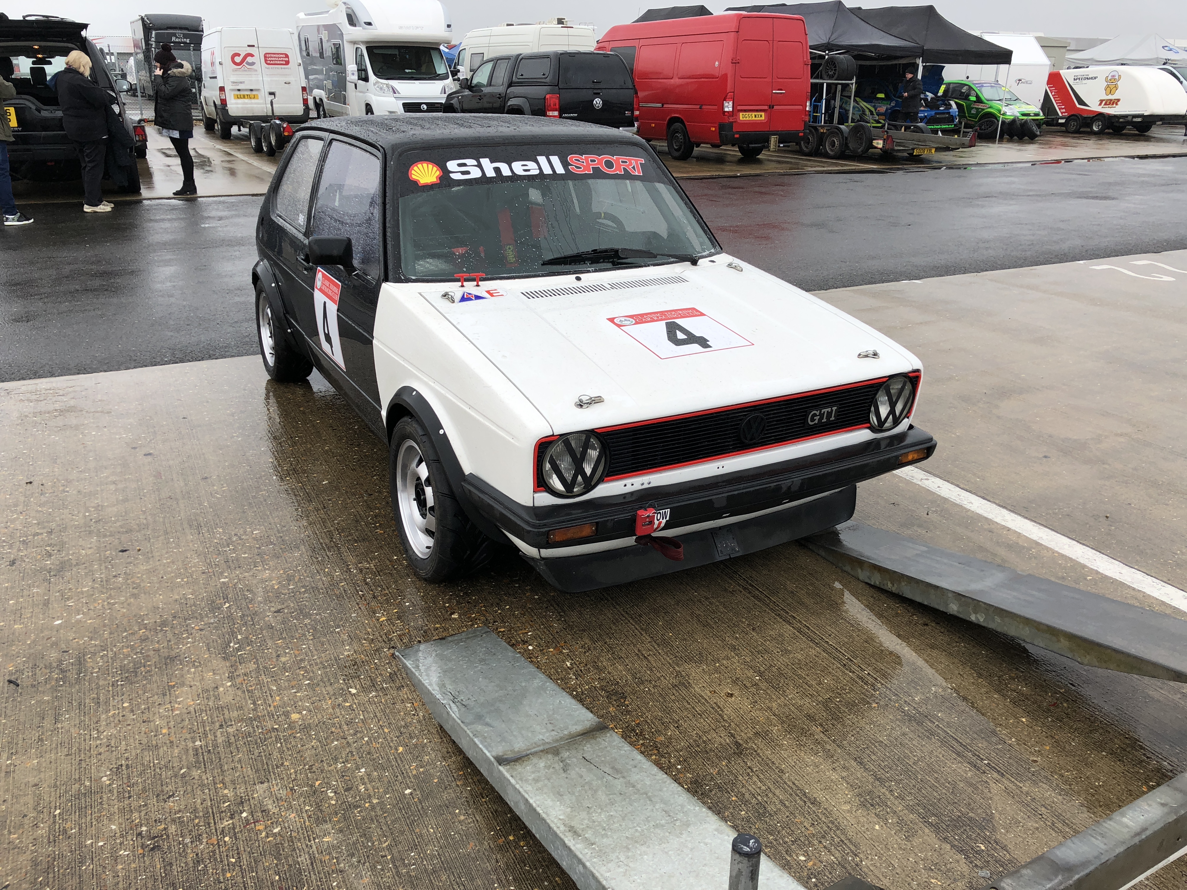

Hi guys,
It’s a bit wet here! The car passed scrutineering

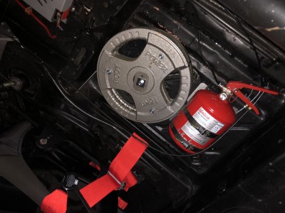

And is ready to go.Qualifying in just over an hour will be the first real test for the car. The scrutineer liked my ballast: Met up with Richard Ibrahim who has his Sprint back. Great he is with the CTCRC.

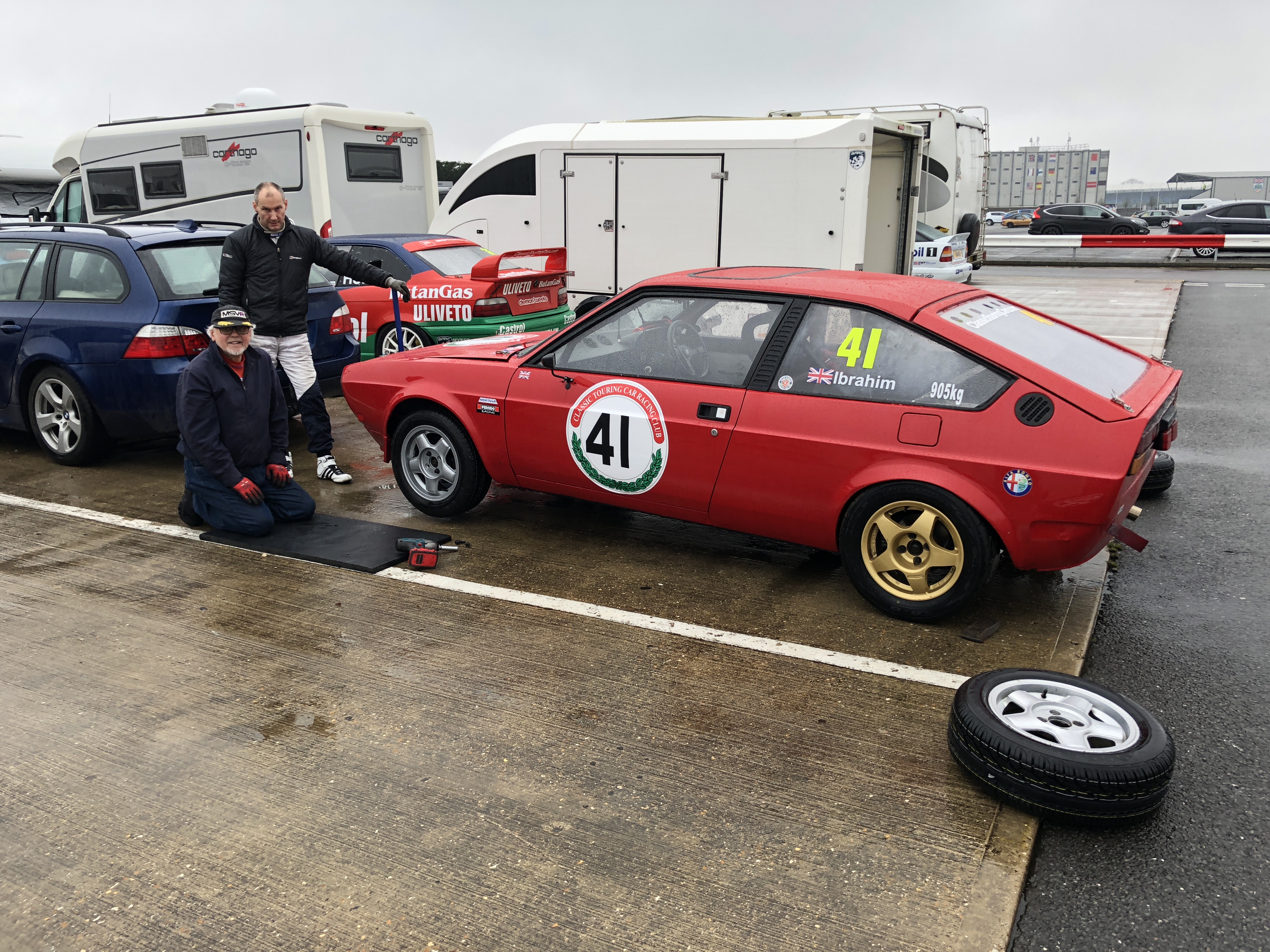

Richard has fitted his wet weather tyres!

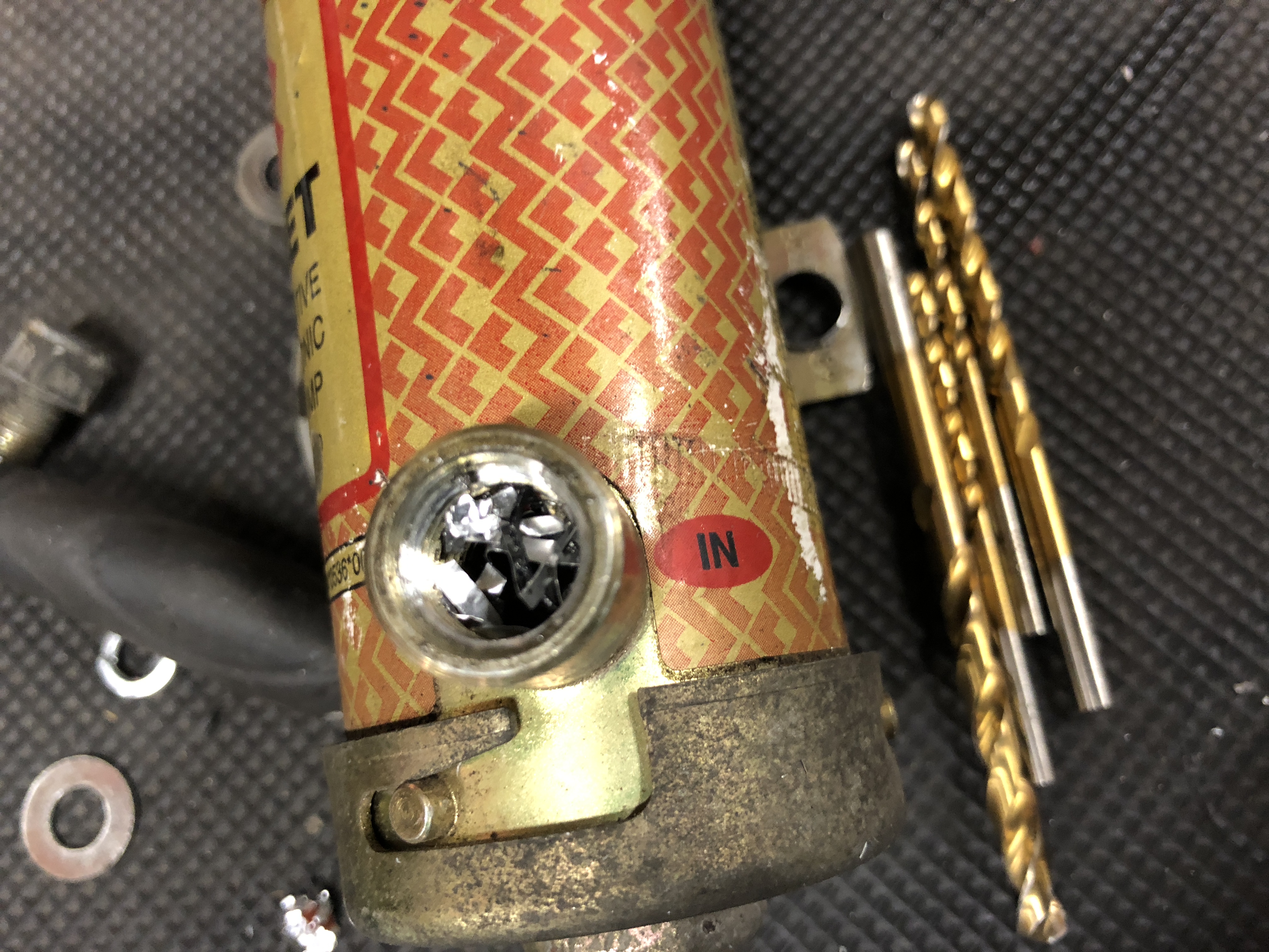

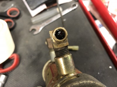

- Posts: 976
Re: CTCRC pre 83 Silverstone 24/25 March 2018
Hi Guys,

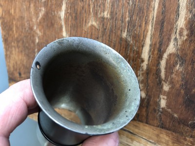

Got a chance to check the Golf over this morning to rectify issues from the last race.
On emptying the tank, the pump delivery flow seemed low.

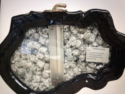

After removing the pump to replace it you could see the issue: And after unscrewing the Union: They are bits of shiny aluminium from the breakdown of the pour in anti-slosh tank baffles. New pump fitted and new foam filled tank ordered.
What a weird design Simon. She will fly now when you fit the new tank.
Good that you have found and sorted the problem.
Hi Keith,
Its really nice to find something that is almost certainly the cause. I sorted the fuel system end to end on the Trofeo and it was the distributor starting to break down at higher revs.
The ignition system on the Golf was sorted end to end - new coil, distributor, leads and plugs so that should be fine. So for the fuel system it will be new foam filled tank, new tank to pump delivery line, new pump, existing braided line through the car (aluminium bits didn't get past the pump filter screen), fitment of a filter king filter and pressure regulator set to 3.5psi, twin 45 DCOE carb overhaul and check of float level (12mm), new 60mm inlet trumpets as the existing are corroded, new carb to manifold rubber o ring gaskets and stud rubber washers (stops float chamber frothing due to vibration), fit a heat shield between exhaust manifold and bottom of the carbs.
Thats it for now.
Thats it for now.

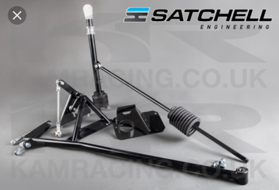

- Posts: 976
Hi Keith,
I am missing Croft which was this weekend but will be going to Mallory Park on Monday 28th May as the next race for me.
Oh I also need to fit the JMR remote gear change so I can find first and second! Brgds
It's a wonder that pump moved enough fuel to keep things running as well as it did Simon!
Remote linkage looks like it'll rid you of the Golf's Achilles heel with all those linkage weaknesses.
Are you out at Cadwell for the Wolds Trophy next month?
