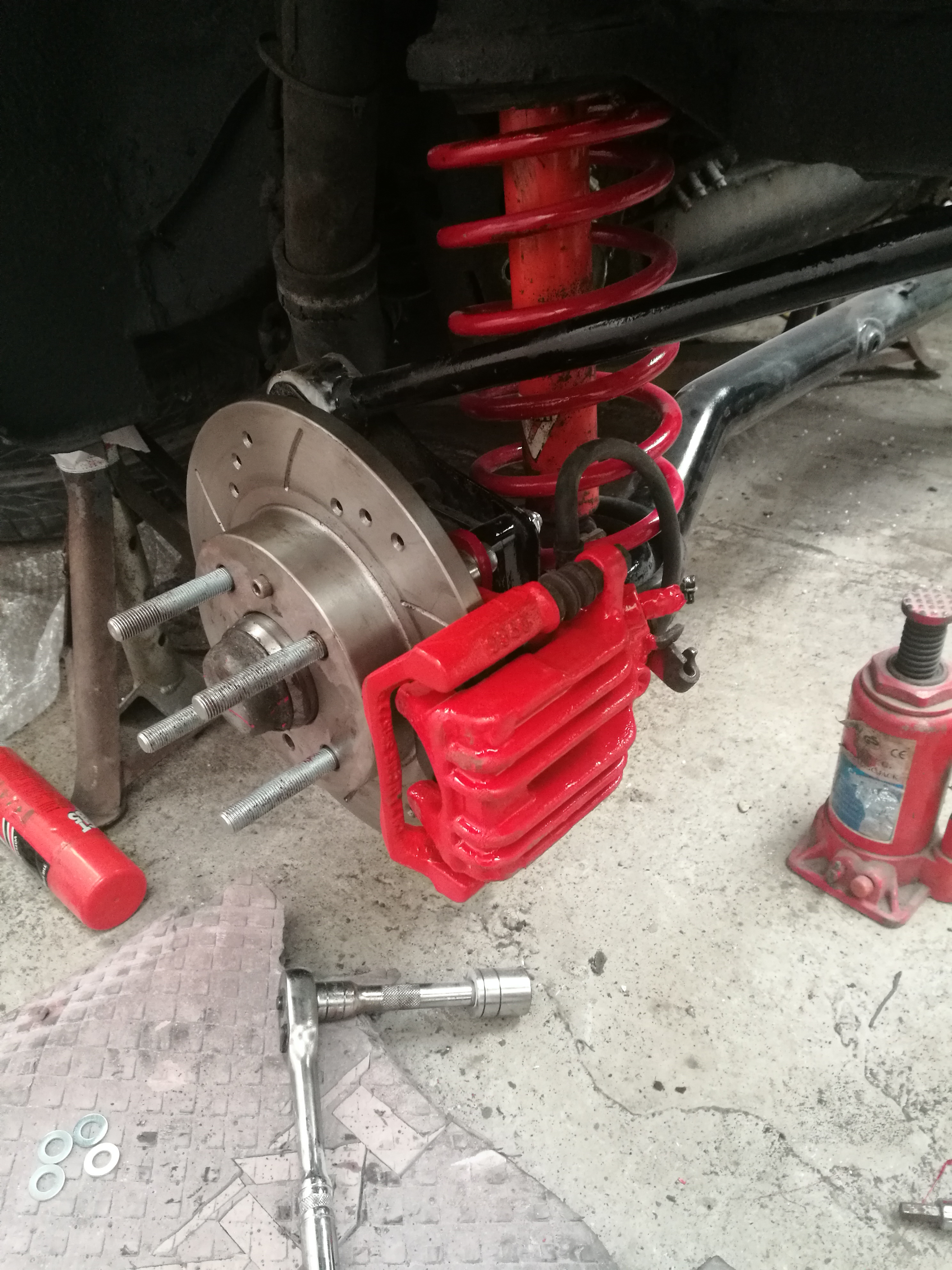

Been doing some bits to the 33 . The rear brake upgrade is done bar hand brake cables . Plus the liquid rubber polyurethane is done too Now on to fitting the Carlos Fandango wheels

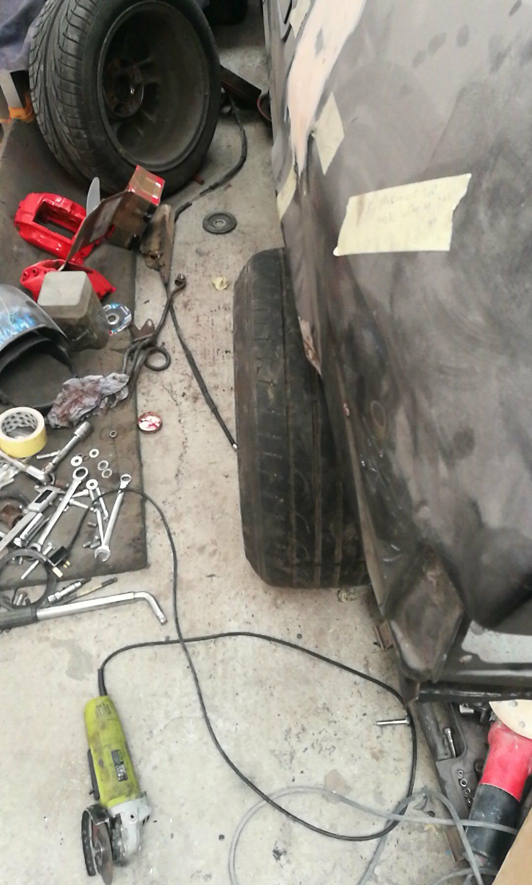

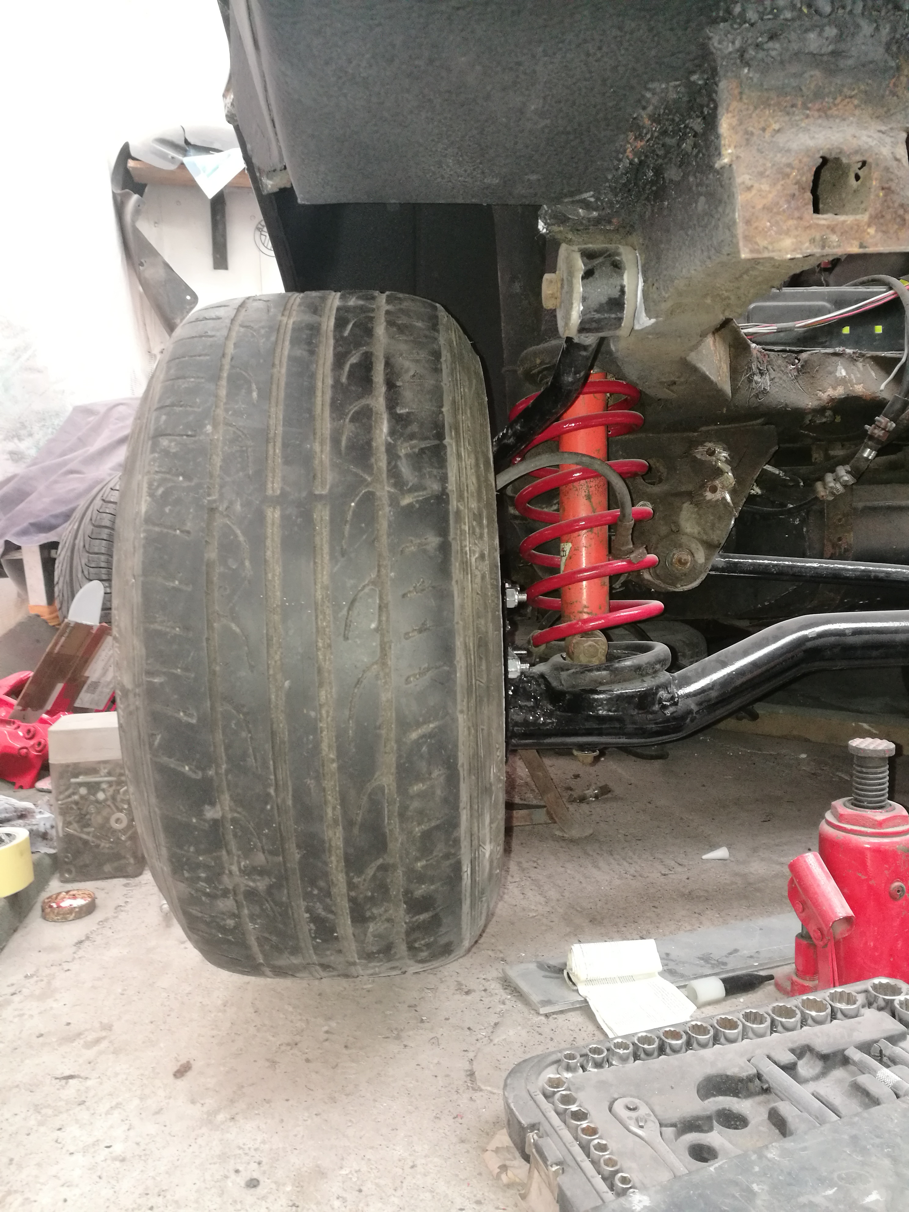

this has been a bit of a challenge . I've spaced out 36mm from behind the stub axle. But it's still not enough. Needs to be around 42mm as it's touching the front trailing arm. Fitted some wheel spacers to see what it will look like when it clears .
I'm not sure its wide enough tho ??

what are the discs and calipers from ?
Re: Alfa 33 s2 16v Resurrection
The disks are fiat coupe rears and gtv rear calipers. I bought the brackets off Alex poulter . The rear drums are machined down . Plus I got my mate to skim the surface 3 mm too

Very neat installation on the discs mate, think your wheels are a tad wide though
Nice wide arch flares going on?

Cheers kev
Yeah integrale style arches

Chop and reroute the arm that is interfering,
Anything to fit big wide wheels! Lol!

As already said, nice brake mod, looks very smart.

Was a bit of pain to do . But glad it's done now . Now to get the wheels right . Before I can move on to the front suspension over hall .

I dont know what you're messing about at jb?
My s3 has had 17x9j and currently sitting on 18x8j,
Your little 16s are easy peasy little squeezy!
