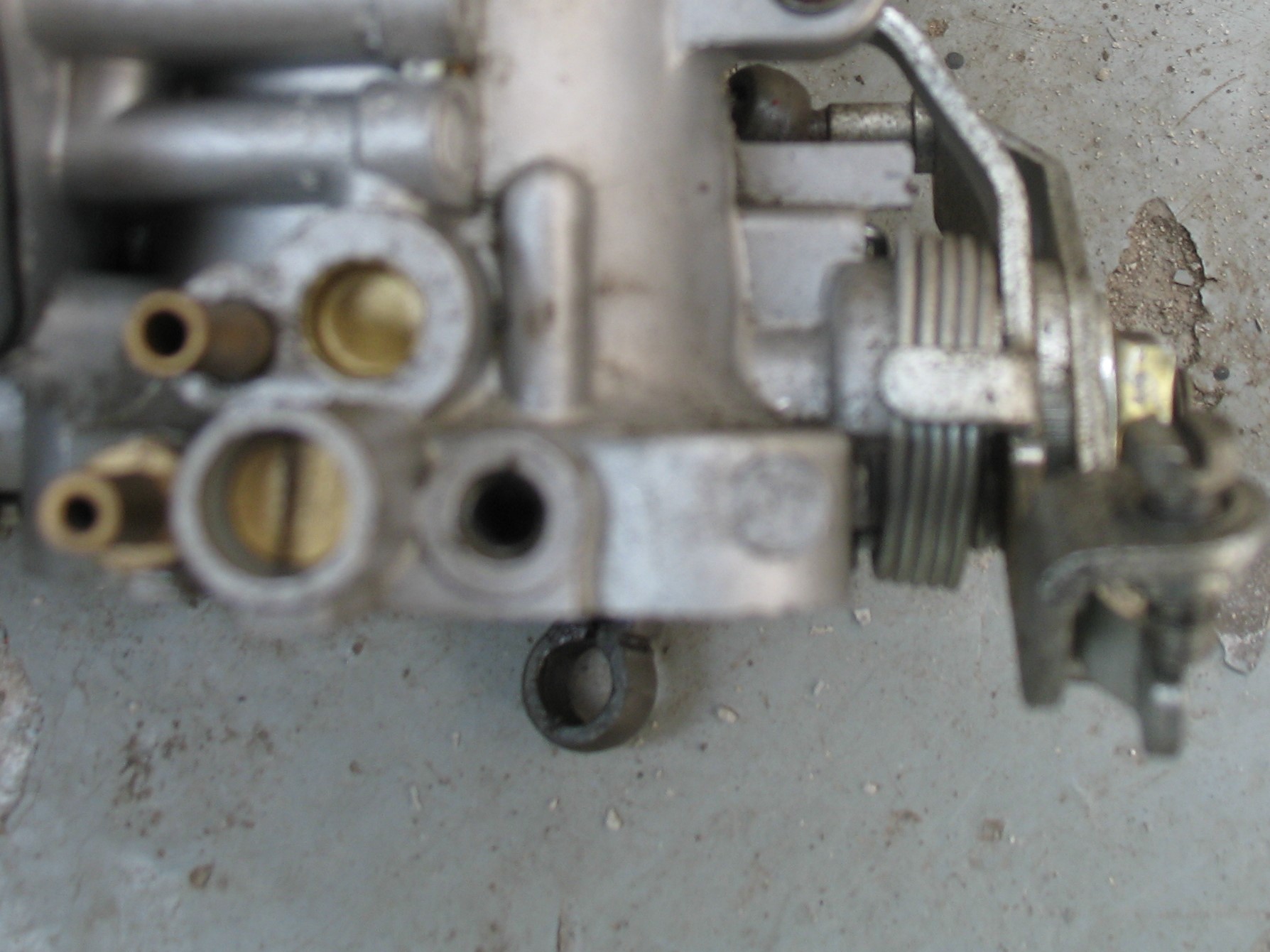

Found a idle screw is solid in the carb, so taken it off again and it will not budge despite heat and freeing oil.
Suspect the guy who serviced the carbs found it like that and left it alone. Why anyone would screw a tiny screw in so hard is beyond me ! Just hope it will come out and the carb is not damaged. :roll:
Spent the day adjusting things that are not quit right and will cause problems in the future, so a good day. :D
The screw at the bottom of the dark hole is the problem, but the engineering firm I have been bothering the last few days has offered to make a steel sleeve to fit in there and then drill it out.
They don't expect to damage the seat and then I am just hoping who ever screwed in in so crazy tight has not done so already. :?
Got to wait a week, but just glad they can do it.
