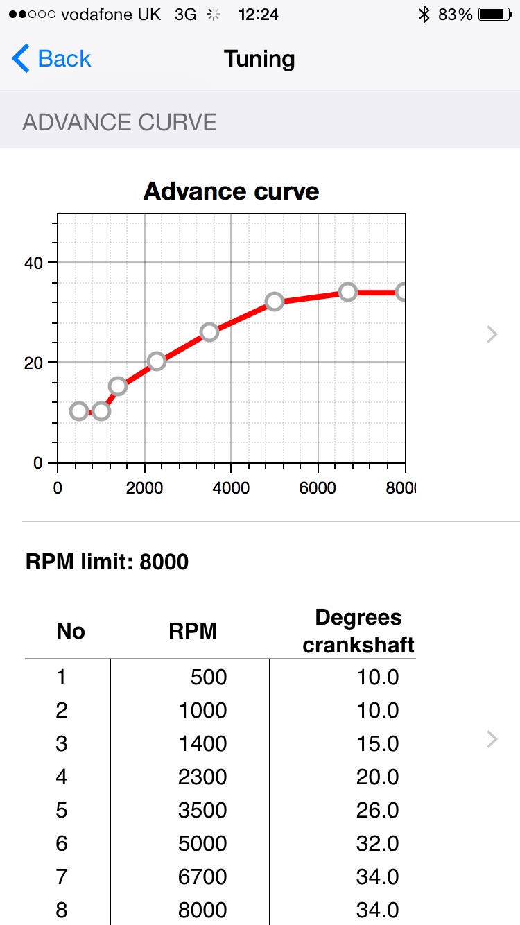

It is absolutely brilliant. I picked the Bluetooth model that syncs to your iphone. The tuner loved it as he could change the ignition timing while sat in the driving seat on his iphone.
This is the model you need to buy for a sud:
This is how my ignition is set up:

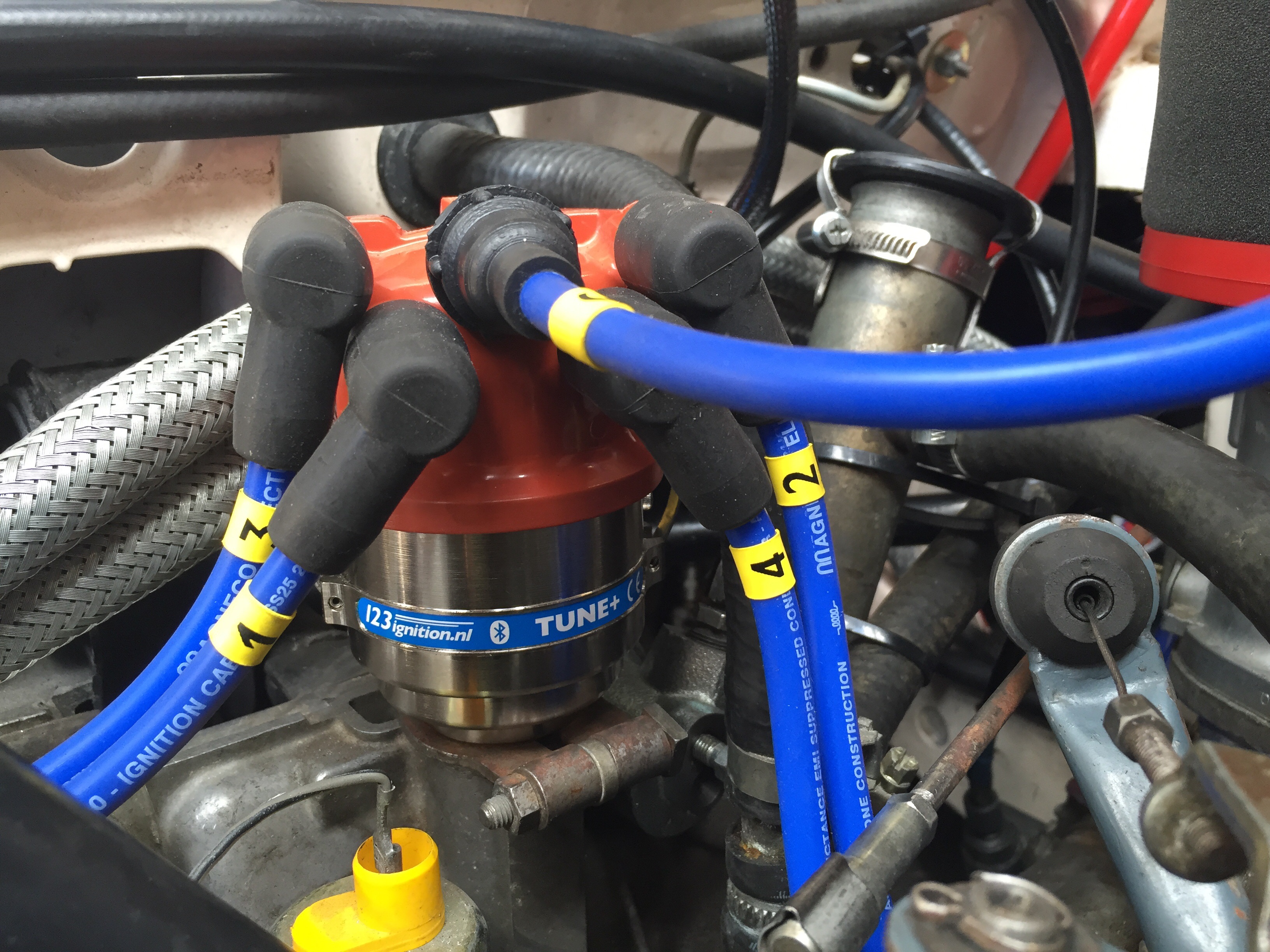

I got rid of the Marelli Ignition Completely.
123 ign and a Bosch Blue High Energy coil. Pics as follows:

I forgot to say that 123 ign will supply the Bosch Blue Coil and the Ignition leads are Magnecor and the plugs are Bosch as follows:

Thanks for all the info, from your photos do it looks like you wire the distributor straight to the coil, so there is no ignition module.
Is that correct?

That is correct. The distributor is wired directly to the coil. There is no module next to the coil anymore.
Of course in a racing car I had no need for the capacitor to suppress radio interference and I have no vacuum tube from the manifold to the distributor. The distributor does have a vacuum advance pipe if you want to use it. The instructions for setup are good.

I forgot to say that I bought some braided expandable flex sleeve with heat shrink at either end to make a neat little harness.
I picked this up from Toms super neat wiring and wanted to maintain the standard.

Just fitted the 123 Tune using your curve, best thing Ive bought for my car.
The engine starts better, idles better, just taken it for a quick spin round the block and the accelaration is much smoother !!!
Fantastic bit of kit, great recommendation

Really pleased it has worked out so well for you.
