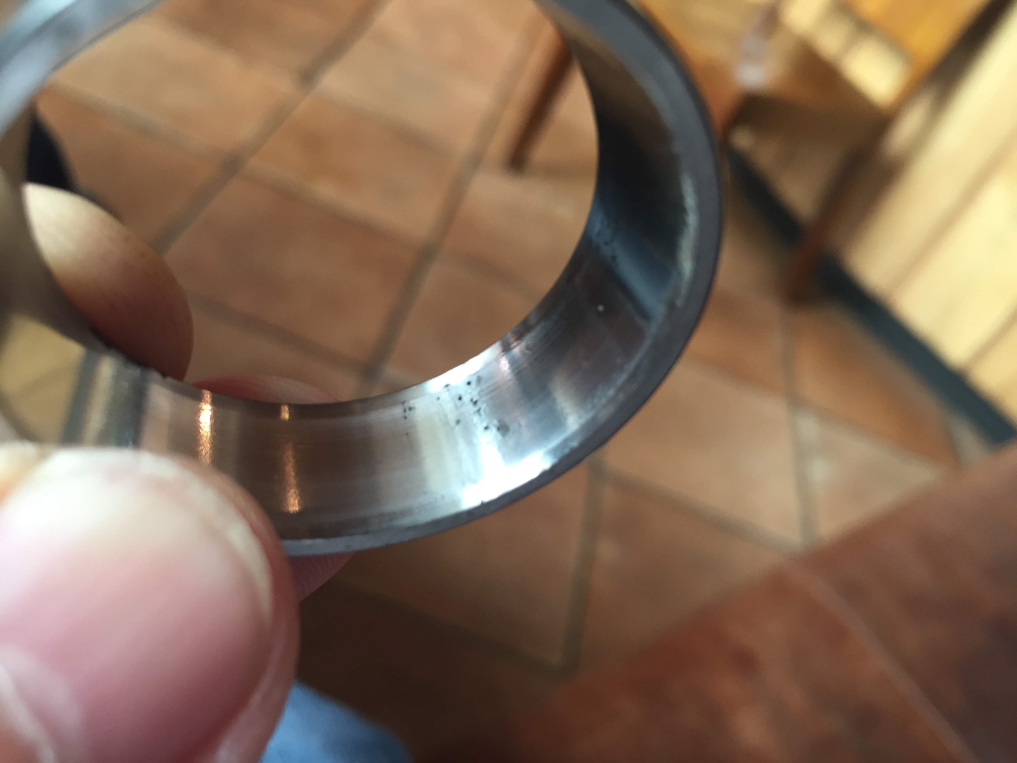

I pushed the Trofeo out to address the rear bearings and you could hear a slight tick.
Pleased to say it was as smooth as silk when I pushed it back in. All rear bearings replaced but the nearside outer rear bearing outer race was the problem as follows:

Hi Guys,
Tom has kindly replaced the bearing in my front offside hub.
The noise was thought to be the driveshaft rubbing or rubber nuts being picked up by the tyres.
The wheel turned smoothly.
The clue was the seeping grease.
Look what Tom found:
Posts: 2891
Re: CTCRC Pre 83 2017
Ouch !!
That looks like it has had some stick . :o
the way the pitting is spaced it looks like classic wear where the ball bearings are sitting in the same place and corrode away where they touch, glad it's sorted ;)
Posts: 976
Post by Marlow Sud »
I think you are right Kev. Just in those four places. Nowhere else.
You would only need microscopic corrosion for the inner race surface to start picking up.
Then as Keith says, the car soaks up a lot of abuse in the corners and you end up with craters. Now I know what that horrible noise was around Rockingham and the reason I didn't take it to Cadwell.
The new bearing is packed with a lovely high temp racing grease. I think I will get the nearside front replaced and then all four wheel bearings are new.
