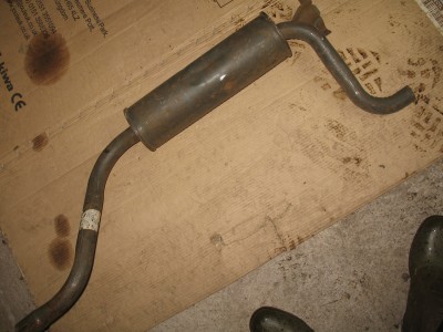

  Hi. Just moved the car and found it .
Its a Quinton Hazel one from a good few years ago. never used and solid. Only thing wrong is the very end has been shortened. I was just going to
add a bit of tube possible even a chrome one !
    Then I realised it was the wrong one for my car
Havea photo of the other side if you want it but looks just the same bar a less dented from sitting around how ever many years.

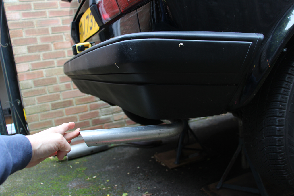

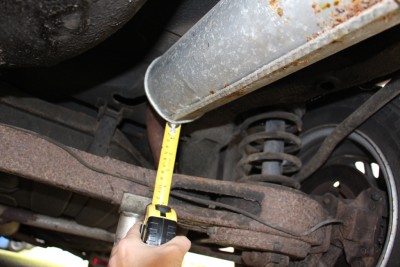

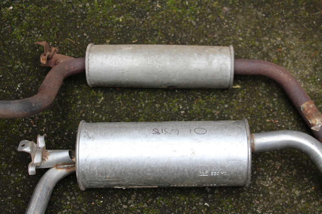

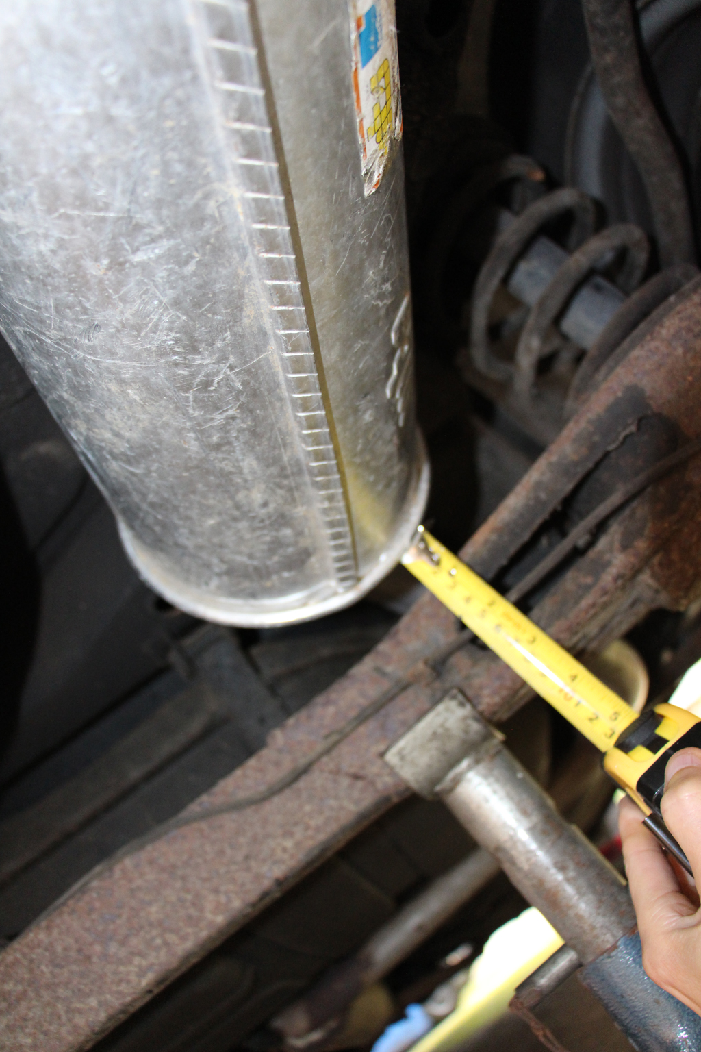

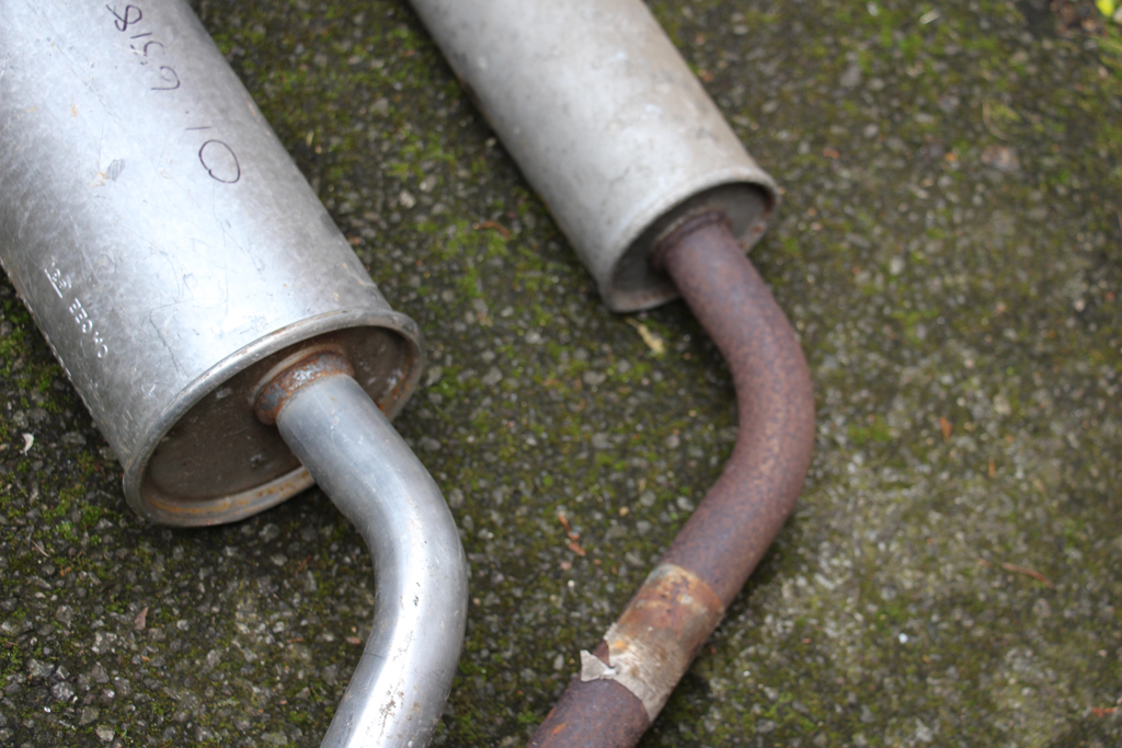

I ordered one from Peter at http://www.alfasud-parts.co.uk. It arrived today. I suspended it to check fit, and I was mighty pissed off to find its massive can was only 2cm from the rear suspension beam, compared with 8cm for the original. So it would clash over bumps and would probably be dangerous over big ones. The tail pipe was also much longer. So I looked up the part number stamped on it: MTS 65180, which is for a 33 1.7IE sportwagon according to the MTS catalogue http://www.mtsspa.com/catalogue.aspx. Unbelievable. So it's going back for a full refund. And I have to cancel my Saturday MoT
1.7 can is longer, meaning it overlaps the beam axle
1.7 can hangs much lower
1.7 can has insufficient clearance
1.5 can - how it should be
Long tailpipe for estate 33 (not a big deal to shorten)

I ended up buying this one: http://www.ebay.co.uk/itm/332146612412 - It's OK, but I had to bend the tailpipe down a bit to stop it fouling the bumper.
