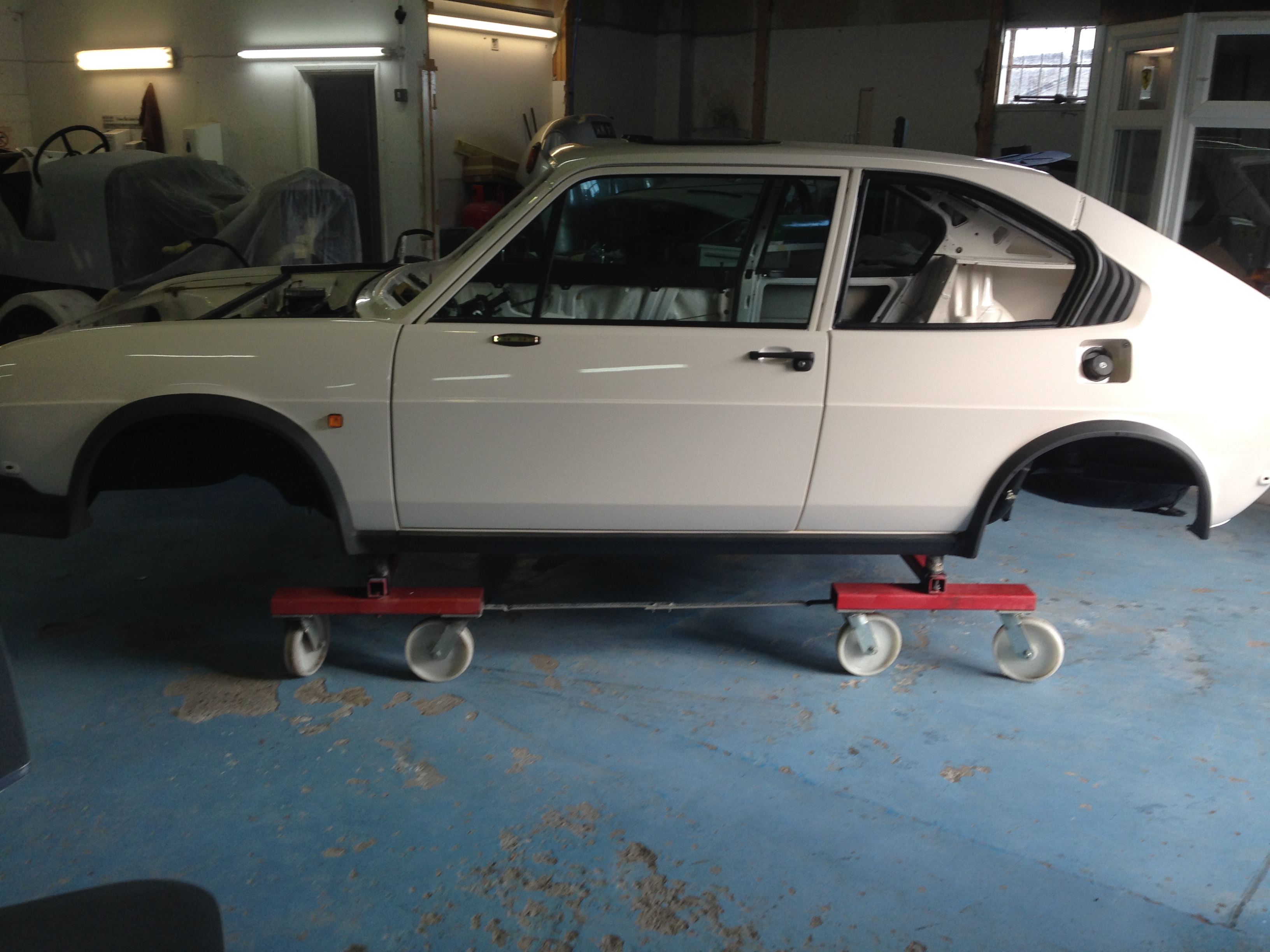

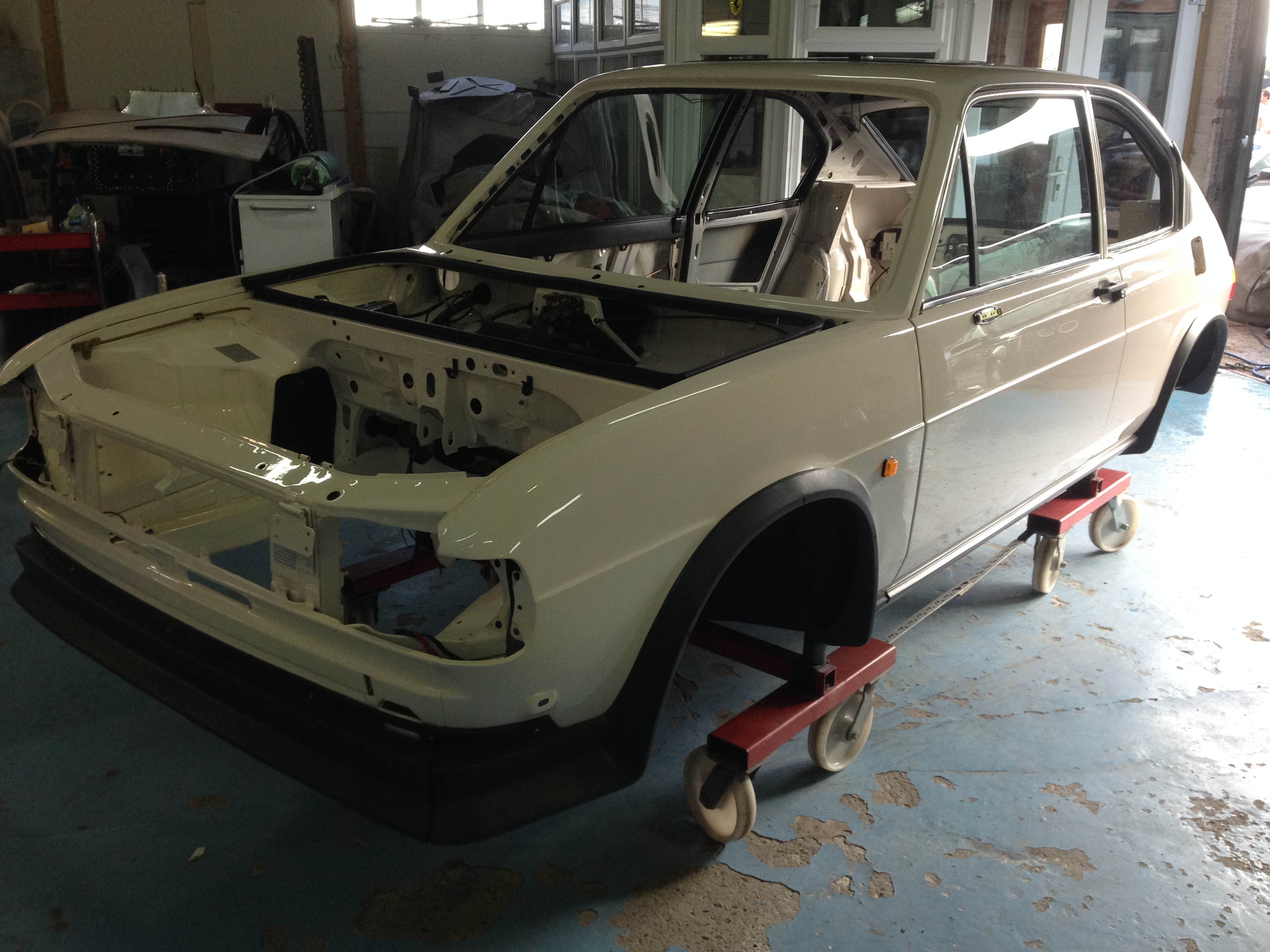

Thanks for all the comments - I am very happy with the paint job, just waiting for the bonnet and tailgate to be painted + all the black trims for the gutters , window bars, door scraper seal, sunroof frame etc.

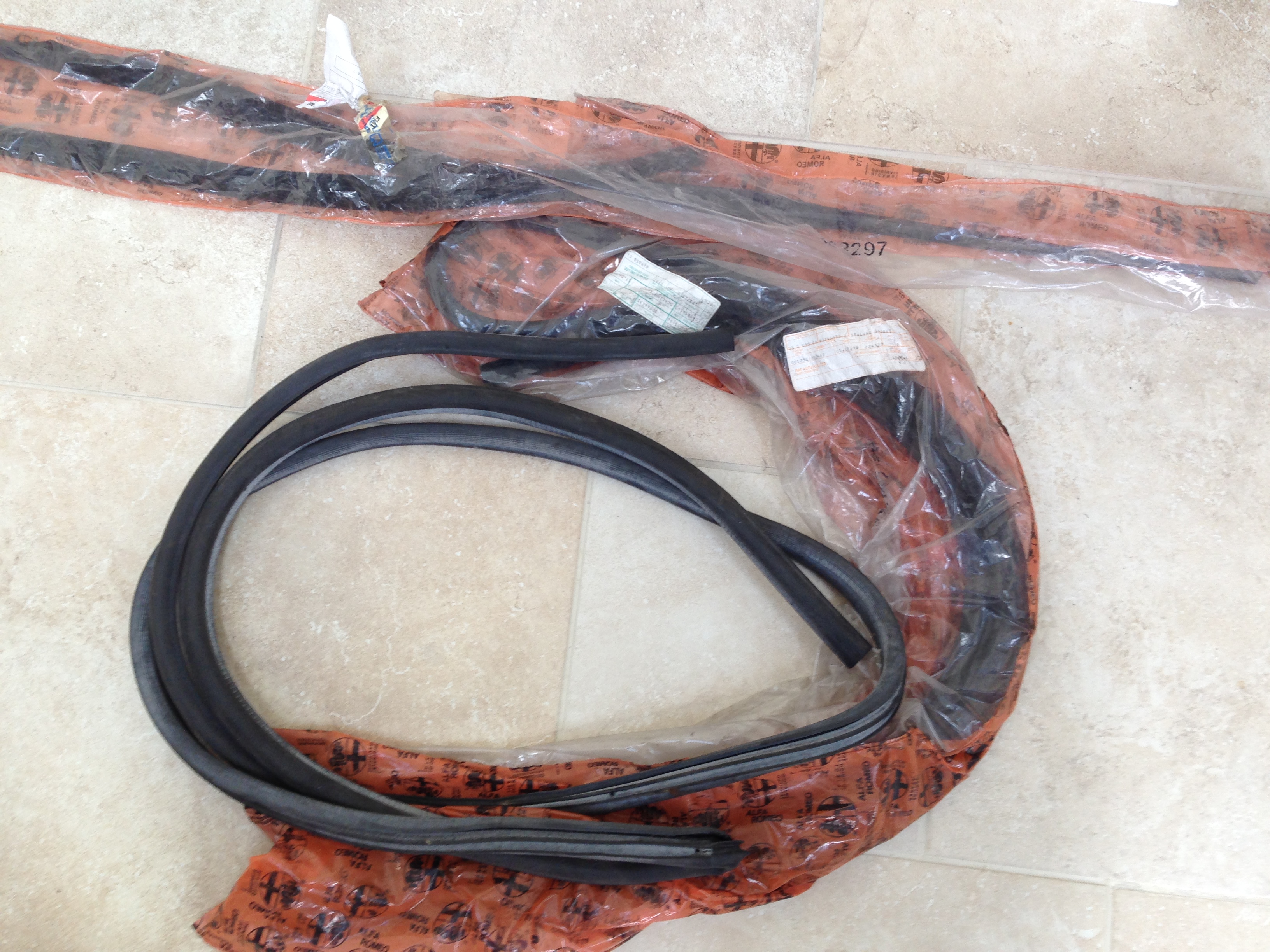

New door seal rubbers and a new set of rear lamps
I did manage to spend a bit of time today starting to inject the anti corrosion wax into the box sections and into all the body seams before then fitting the rubbers seals and the lamp units.
The doors are on now so tomorrow I will wax the insides of the doors and fit the locks back on and then move on to inject sills and the rear panel lower edge - the wax does make a mess but I know it will be worth the time spent now to help keep the corrosion at bay

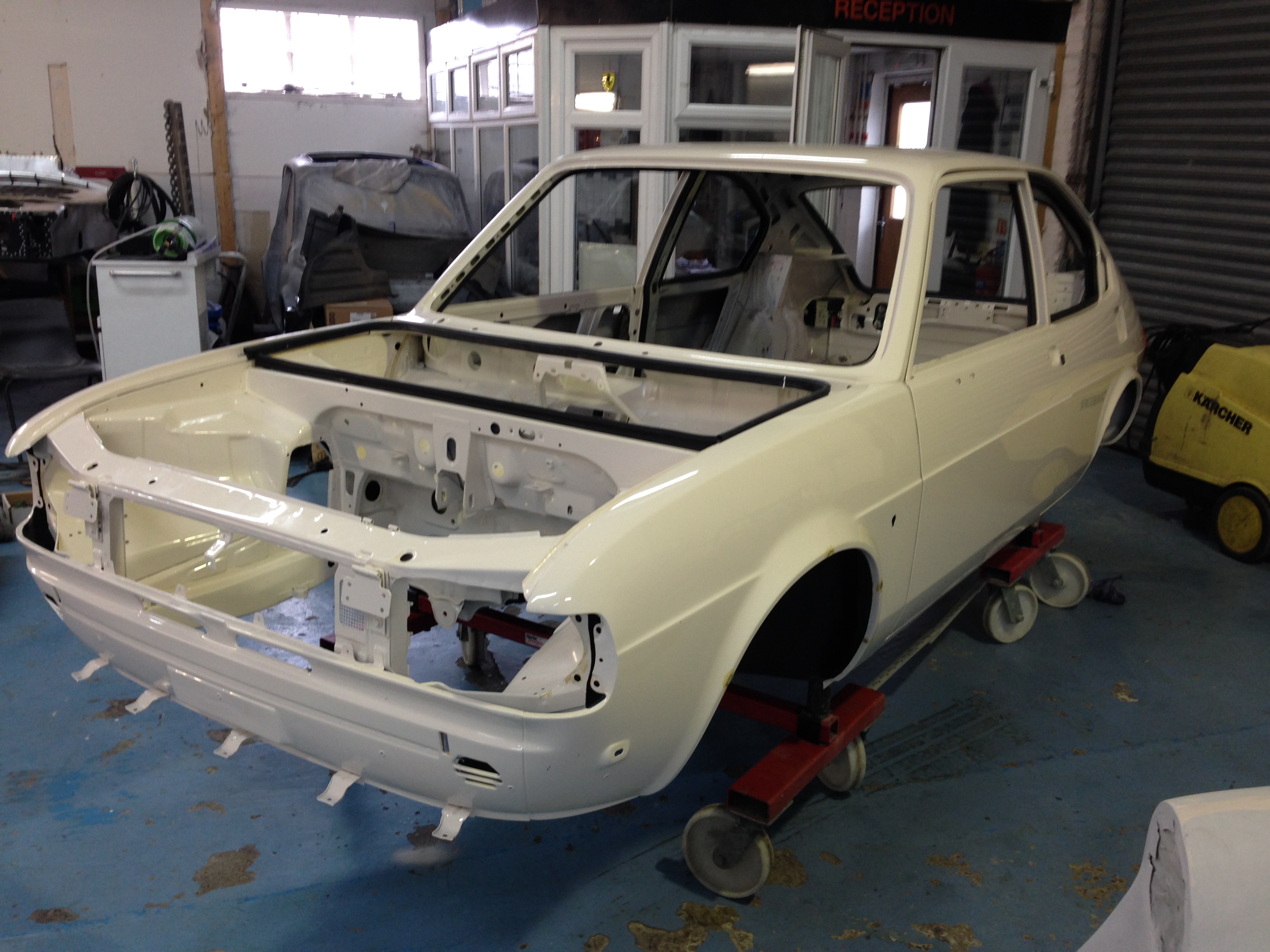

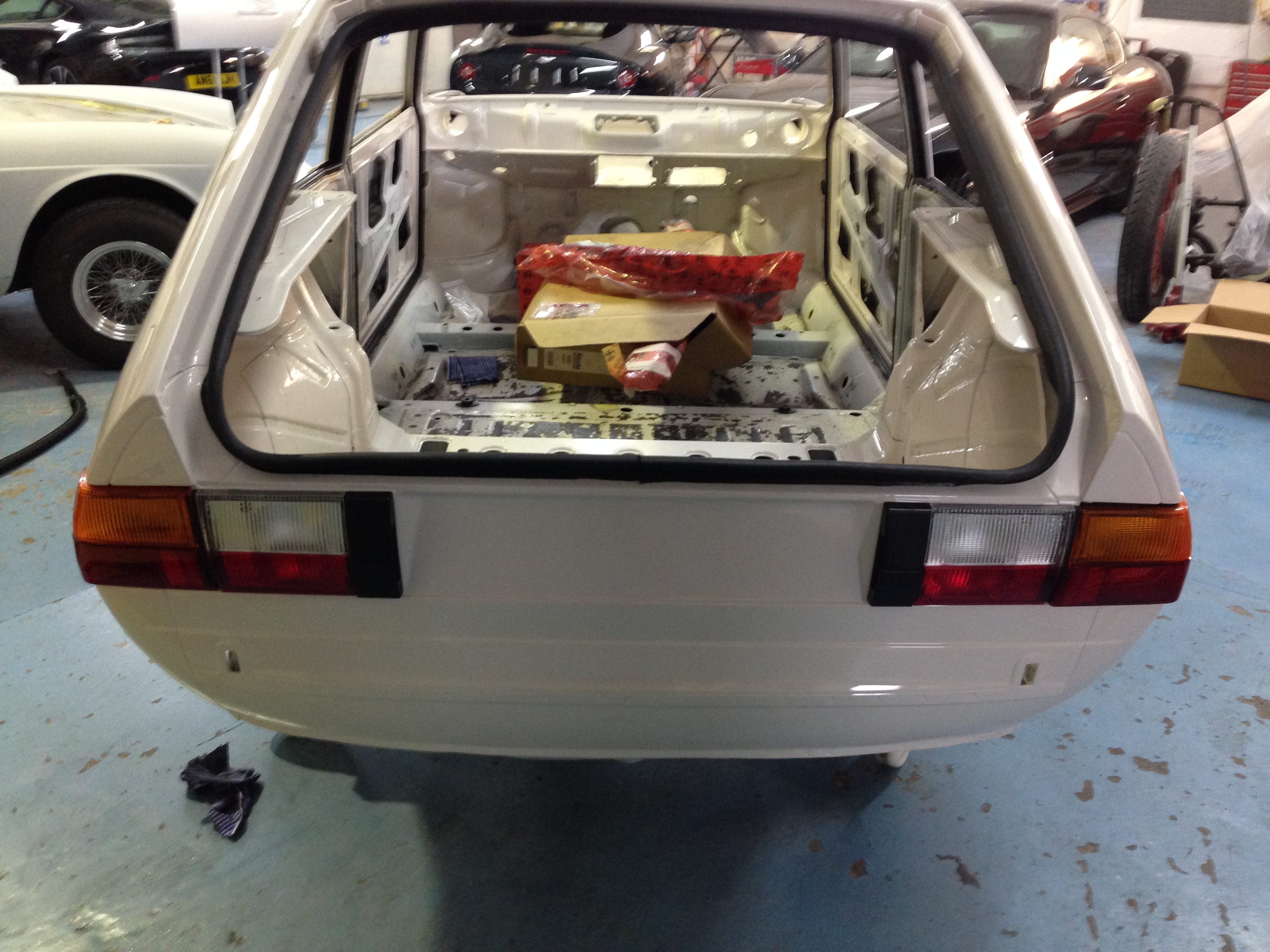

A couple of pictures of the shell with the masking paper off and a few bits going on
3 litres of wax have now been injected into the various sections + 2 500 ml aerosol cans so that should help keep the corrosion at bay !
Next job is to re-underseal in the rear arches where some white paint has got in and then on with the rebuild - my plan is to get all the glass in and the outer trims on before it leaves the bodyshop - I might also start to put some of the mechanical bits on and the wiring loom if they do not mind

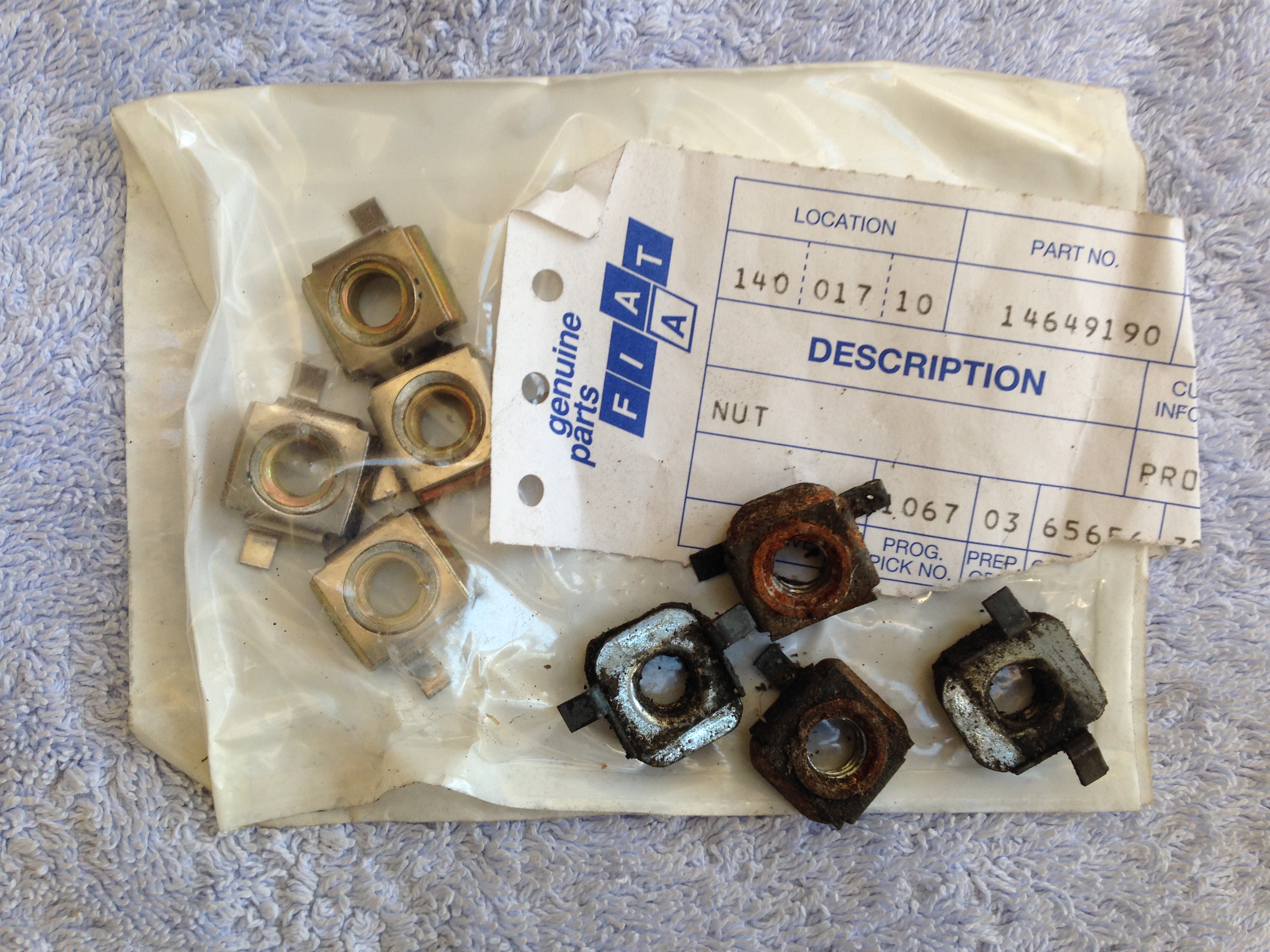

New front bumper mounting captive nuts as per the originals as one had a bit broken off the side

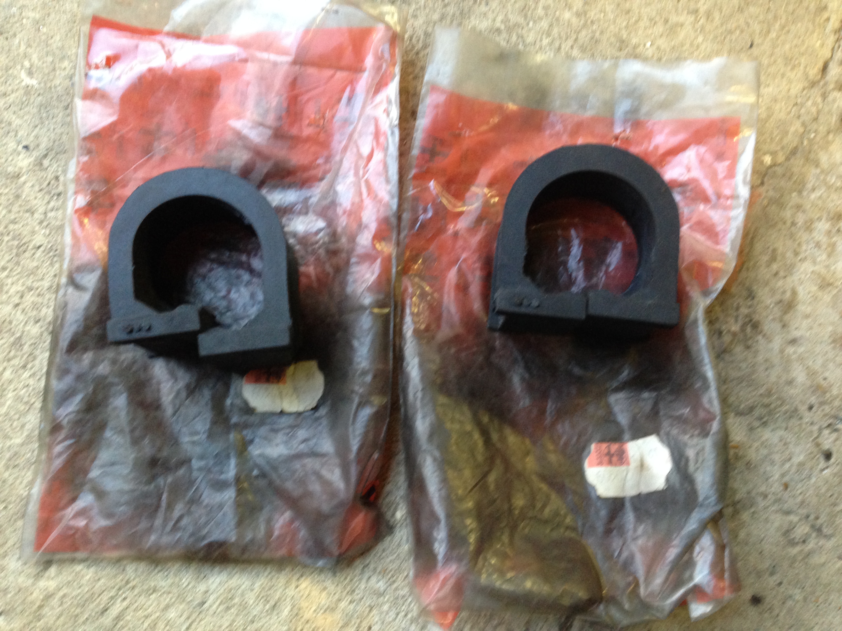

A few more nice new bits have gone on, the plastic water drain pipe from the fuel filler + a brake compensator valve and the rubber ring that goes around the compesnator bar

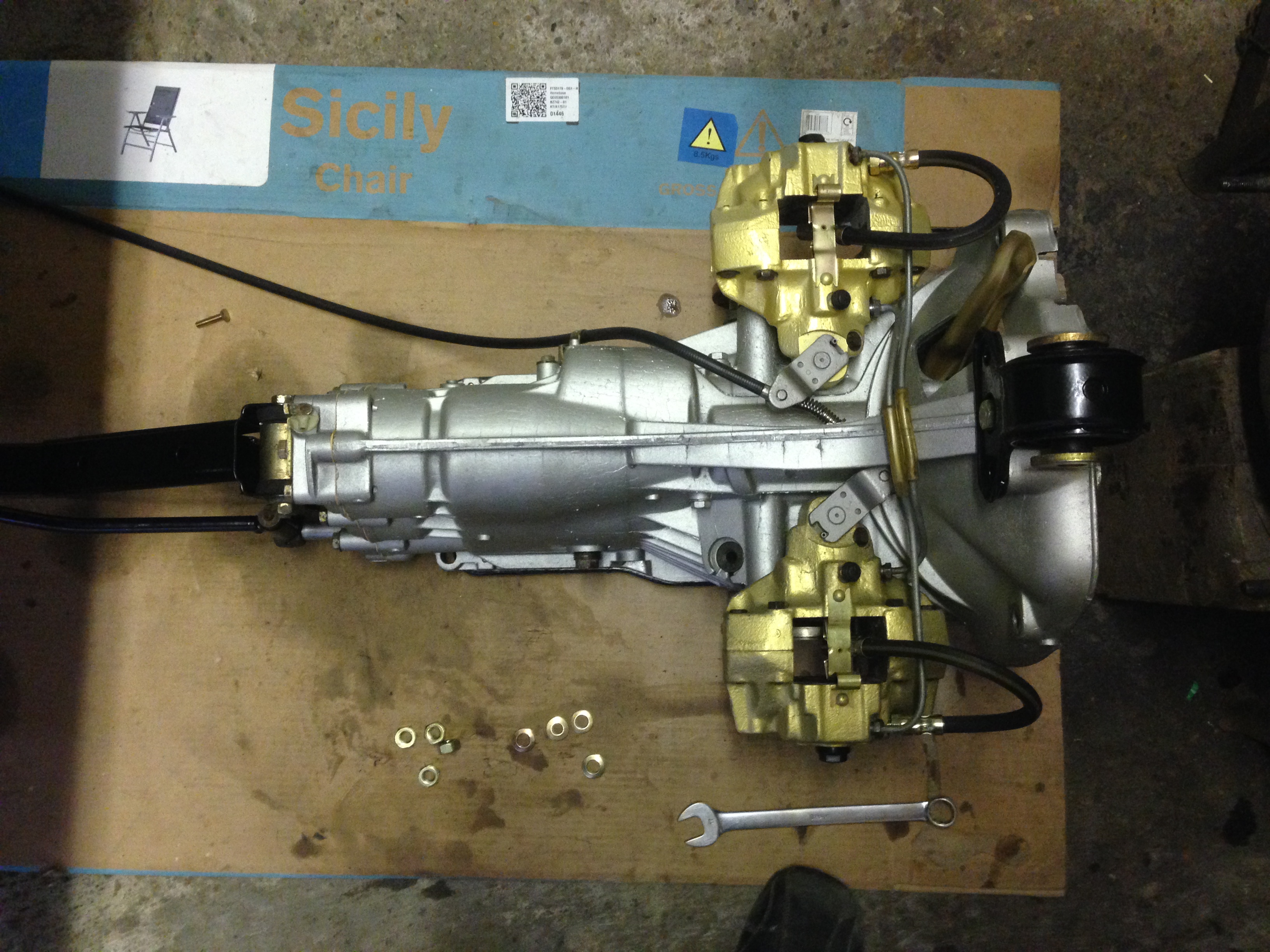

Gearbox ready to be fitted

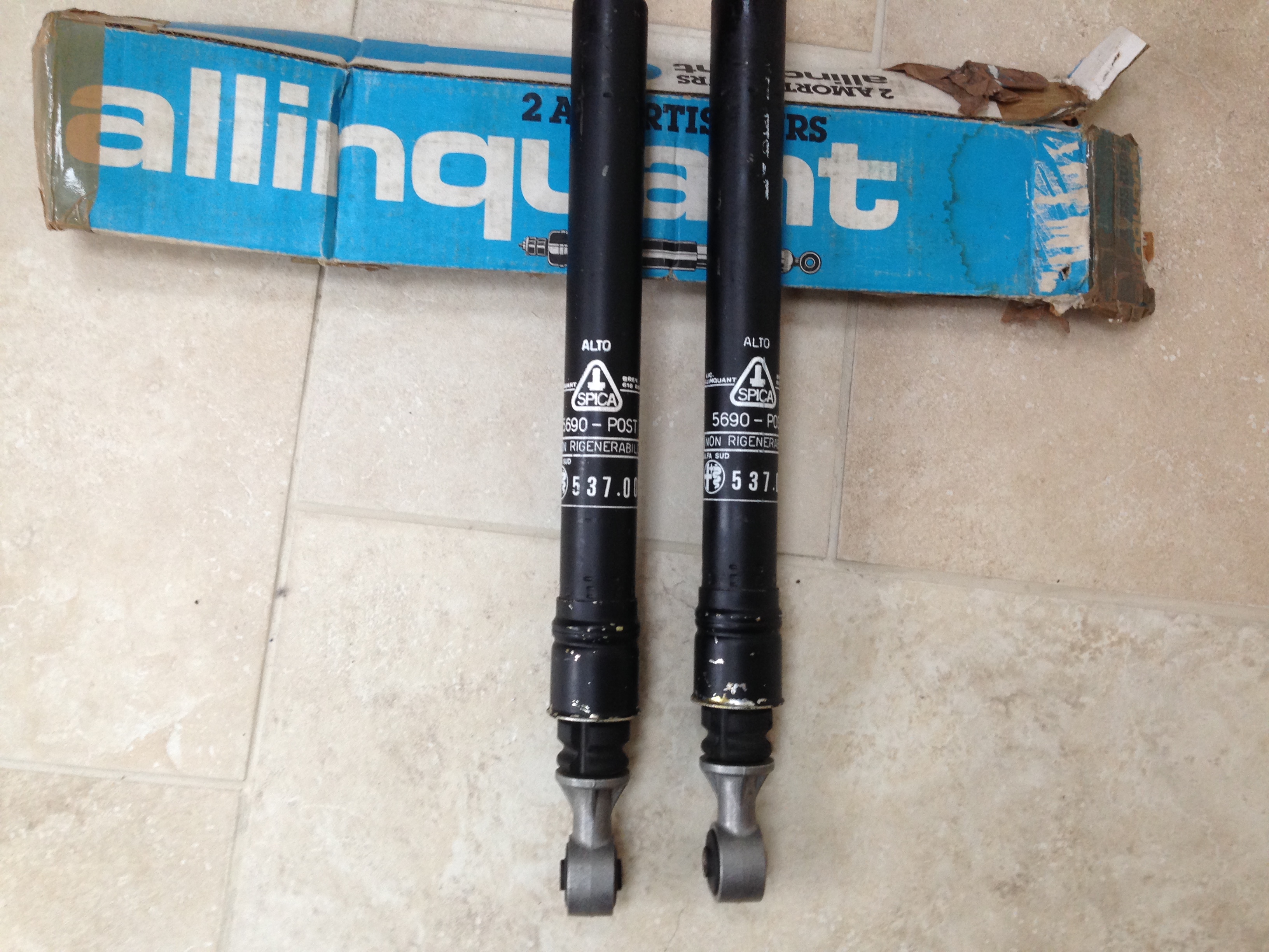

New rear dampers - more updates soon !!

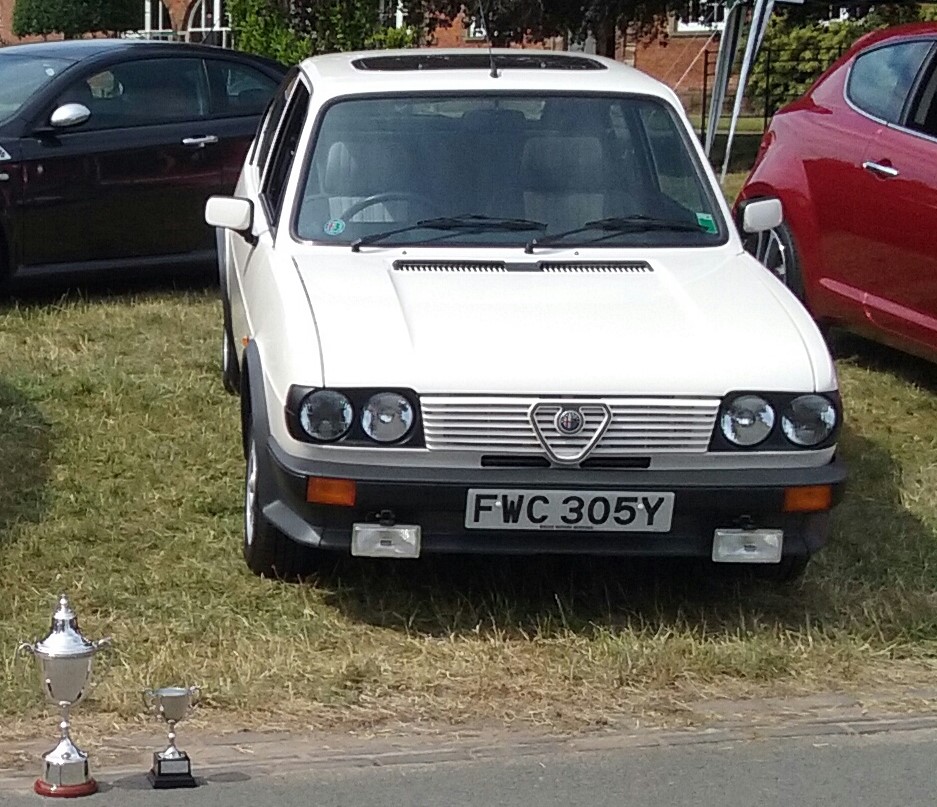

Very happy with how it turned out
2018 was a good year with the car being the overall winner of the concours at National Alfa Day and then also being on the club stand at the NEC classic car show in November
Safely tucked away in an air chamber for the winter and looking forward to the spring
