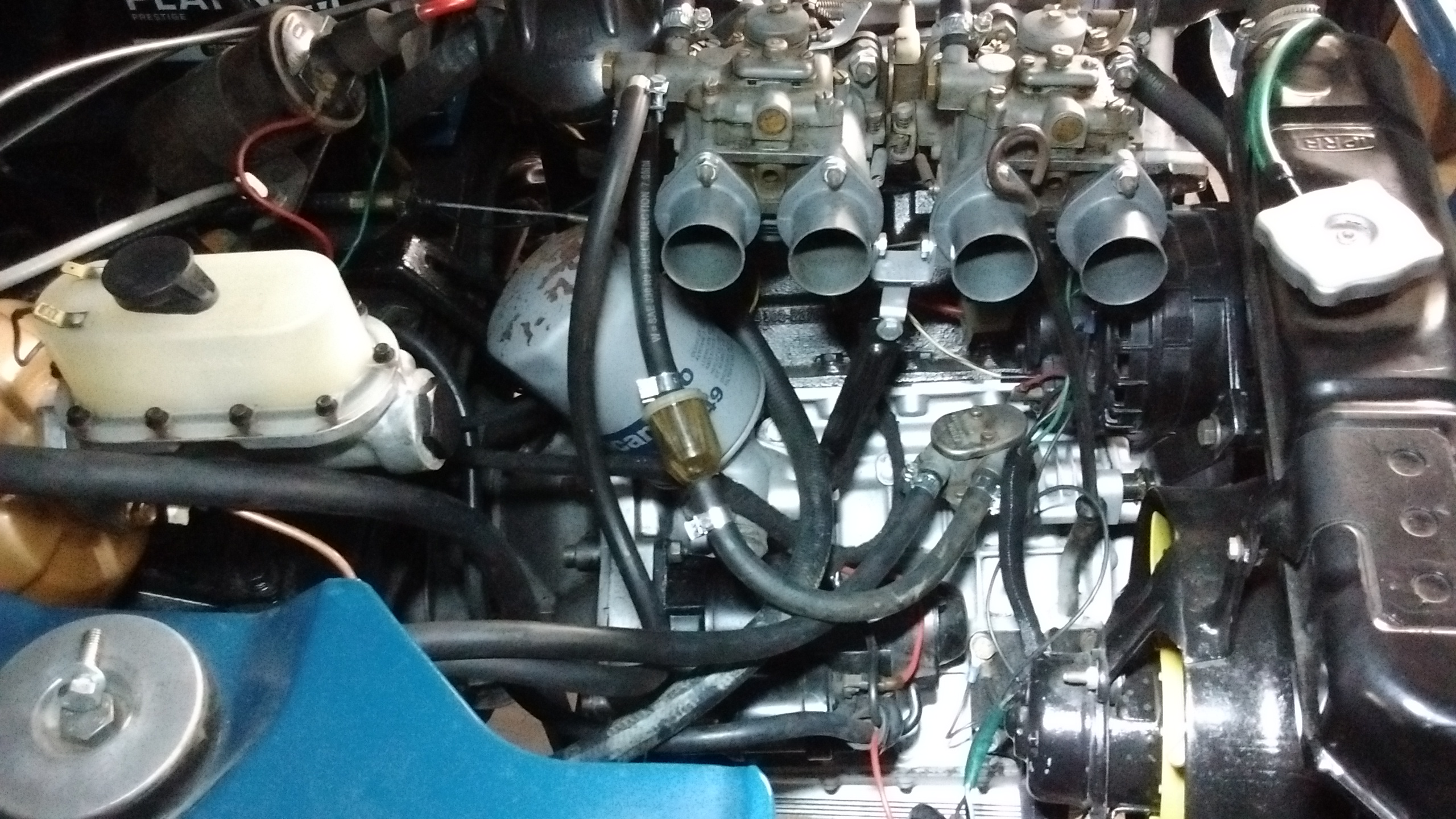

little bracket fitted in place.....
it holds up the back end of the carbs..
we have decided that trumpets without the large airbox (gauze guards will be added) is the way forward, just for that throaty sound
that means that the rear of the carbs hasn't any support putting stress on the rubber mounts.
I made up the little bracket so it would link up with the original one rather than get rid of that so that in the future the airbox can go back on if needed
also the fuel lines are now where they should be and all clipped up. meant removing the servo/master cylinder again to get the fuel lines in the right place but at least now it's all sorted. I had put off cutting them to length until the airbox dilemma was finalized
as one of the choke mechanisms has a little play in the fitting it didn't quite return to the fully off position, the solid link bar is supposed to shut it off but with the play it left it on a little. so I copied the spring holder and made another so each choke has its' own return spring, works a treat
one side caliper had needed a sheared bleed nipple sorting out which I got back from the engineers this afternoon, so that went on along with the flexi hoses mounted into place
just need to make up a few more brake pipes once a slight issue over some fittings is resolved then it really is almost ready for an MoT...once the wheels are back from shrew and I fit the new tyres on of course..

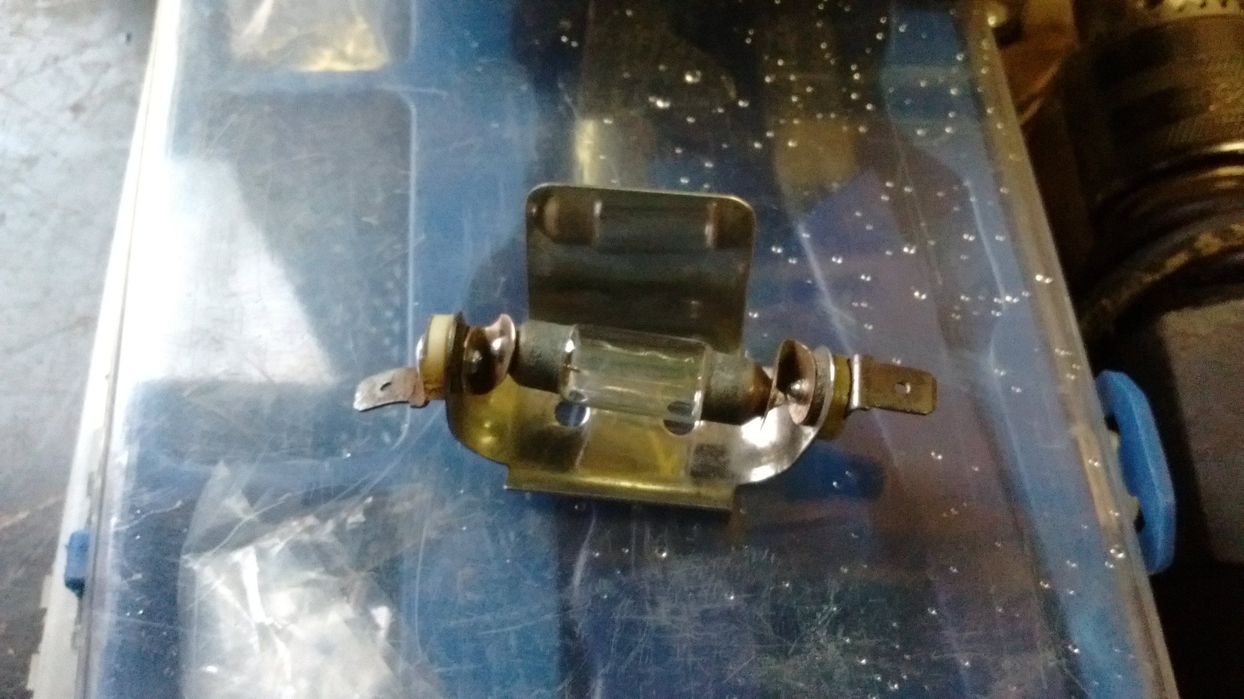

had a look around the car and under the bonnet is almost done, but one item has been bugging me for a while. the bonnet light hasn't worked at all despite having power to it.
the terminals at each end had massive resistance, in fact they were both reading open circuit!
looking at it it seemed to be a simple matter of riveted together items
one side stripped, cleaned and all fastened together showing good continuity
both sides done and now works a treat

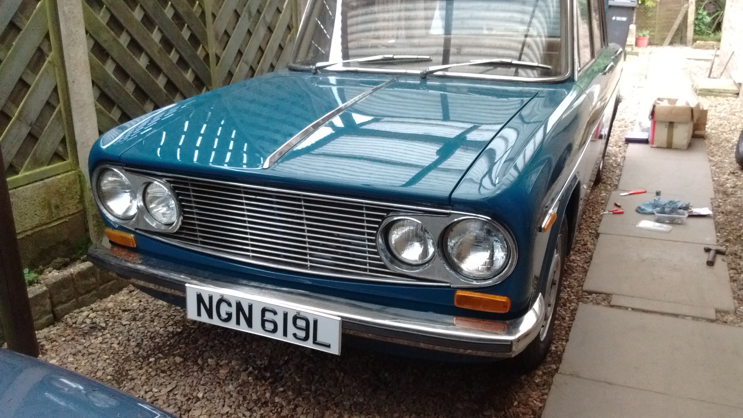

With that in mind it's time to finish off the last few jobs.
The grille we'd been missing the top portion of, only became apparent when it was trial fitted! A meet yesterday Evening with Richs' Sister got the parts transferred down to me.
The rail was originally spot welded into place but with it being in stainless steel I didn't fancy trying to weld it, most likely would end up in a mess. As the fixings are hidden I took the decision to drill and pop rivet it together. Also needed a couple of captive mounting bolts making up and fitting in. Turned out well really.
Made up a top radiator mount and fitted that as it sits behind the grille, another of those little jobs that gets put off as not being important...until it is the last minute1
With that done the grille could go on. Transforms the front end I think, especially with the new number plate made up over the weekend by Rich.
The headlight bezels are only resting in place for effect, they will be fixed in place once the test is done so I can get the headlights aligned on the beam setter.
Washer bottle next to fit and plumb in. Washer pump that clearly ran due to the noise it made has actually turned out to be making a lot of noise and not much suck so I'll pick up a universal one tomorrow and fit it.

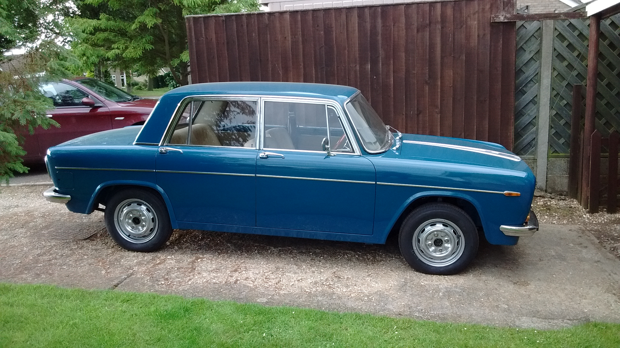

Finishing touches going on now.
Sill edge strips on with yet another door seal...
Headlight surrounds on, still got the Lancia shield to go in the grille but hoping it'll go on without taking the grille out again...
A few other little bits and pieces, tidying out the boot and fitting the trim back in place etc then as Richard has now got it all taxed etc it was only rude not to take it out for a little spin.
This location will be known to Mark as when his Sprint came to mine for a carb rebuild which led to an engine rebuild I took some pictures outside this little derelict shed
Ran lovely mostly, a little misfire which I think I've traced. Also solved along the way a potential power loss in the bob weights being fouled by the new rotor arm, a little recess ground into it to clear the distributor shaft regained the movement needed.
The car is wonderfully silent down the road, all those seals really do cut out the wind noise, down to a whisper....apart from the carb noise of course! Can see the time coming when the air-box goes back on to regain its' stately stature
No overheating or anything daft, no oil or fluid leaks, all looking good.
