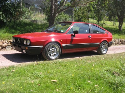

Here is a pic of my Sprint as it is so far, finally found a set if Simmons for it to match my GTV. Some of you may recognise it.
Looking forward to some great advice and info. Site looks great.

Nice sprint chap
welcome to the mad house

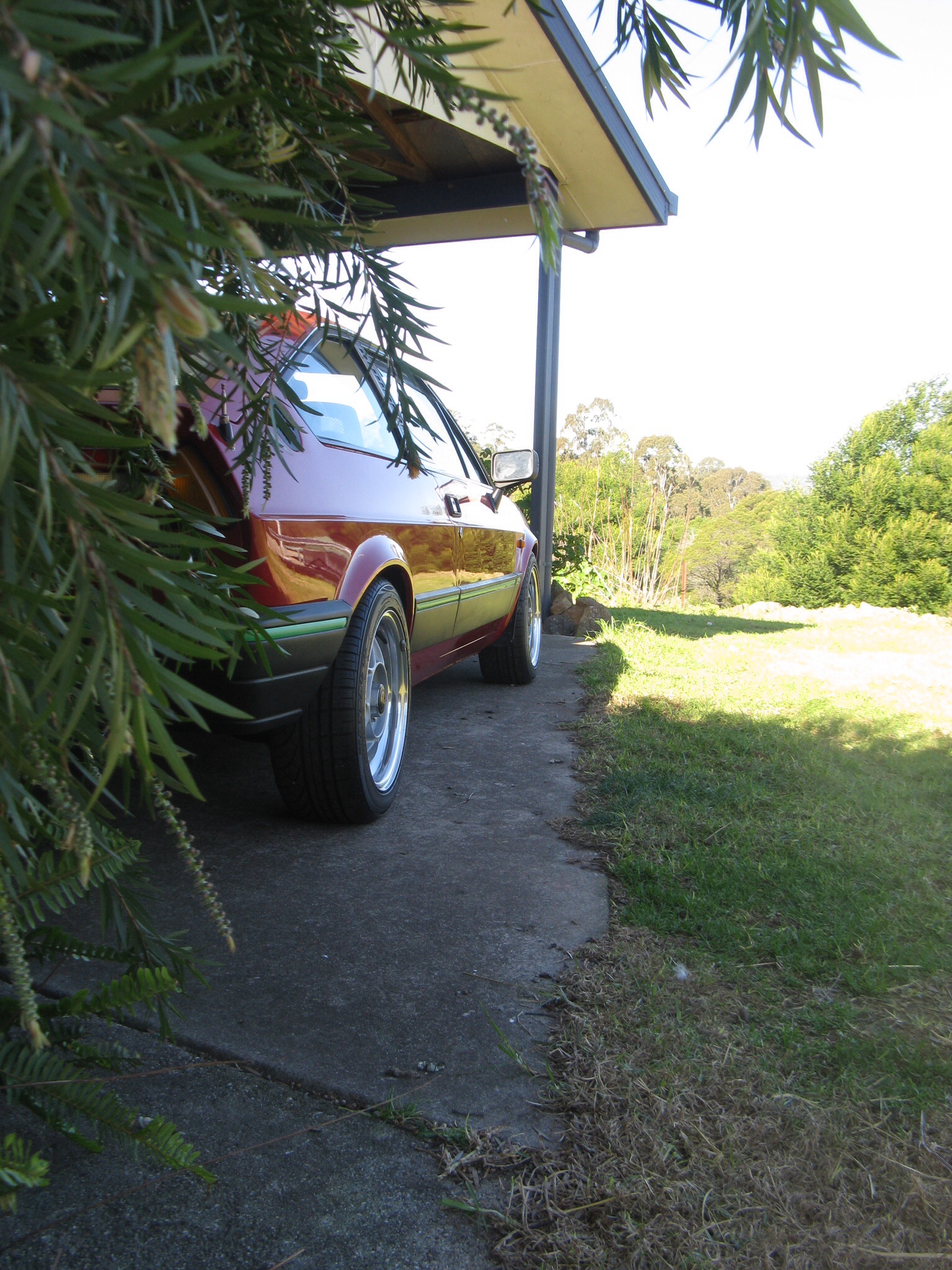

Trying to get my hands on the green trim strips
Found some t-mould for old arcade machines but have not ordered yet

Got some green t- mould on the way.
Will put up some pics when I get it on.

Put my t- mould on finally

I was well worth the effort getting that stuff. It's amazing how simple detailing can improve a car.
