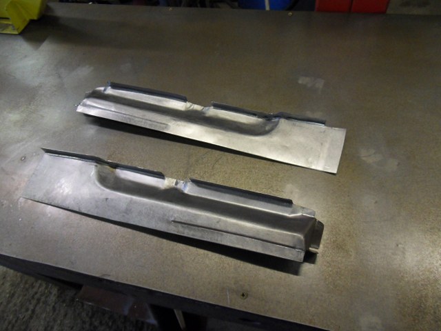

Reconstructing the N/S A pillar:
The fabricator made a repair panel that is an exact copy of the factory panel pressing in this area. He joined it on the vertical corner with the door shut so as to make an invisible repair. I am amazed at the skills of the fabricator. He really is an artist when it comes to working with sheet metal
Here are some pictures of work progressing:
Re: My Sud Super restoration project
That hand made piece is incredible, top work.

Utterly speechless with admiration. A full rotisserie rebuild with amazing fabrication skills, this is going to be superb!
Actually, for someone who claims to be speechless I have written quite a lot. But this rebuild is worth a few accolades, well done

This looks like it will be a fantastic car when all finished - you are lucky if all the original interior is all in mint condition as well.
Lovely to see that proper craftsmanship still exists with your fabricator - I would love to know how some of those shapes are made from a flat bit of metal !
With that expanding foam stuff I think you may find that the main front chassis rail box sections, the rear chassis box sections and maybe the bulkhead under the battery tray down to the mountings for the front suspension wishbones (where the steering rack fixes to) may be full of it as well.
Good luck with the project and look forward to seeing it all done
