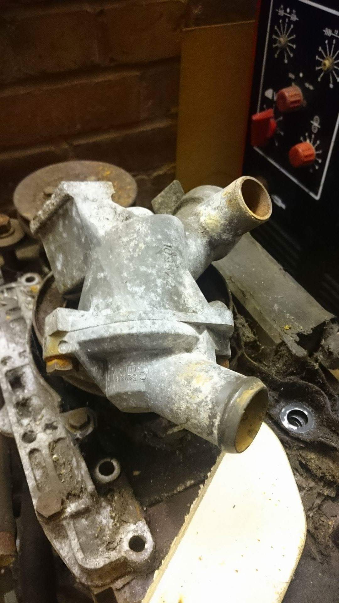

Now searching for a thermostat housing or its core plug after a small leak was found during the test run.

Is that the housing with replaceable thermostat Colin?
Alfamet
Posts: 441
Re: It begins...
Post by Alfamet »
Looks like this Tony....

Another view of it.

Thermostat housing now sorted. Thanks for helping me out Tony! :D

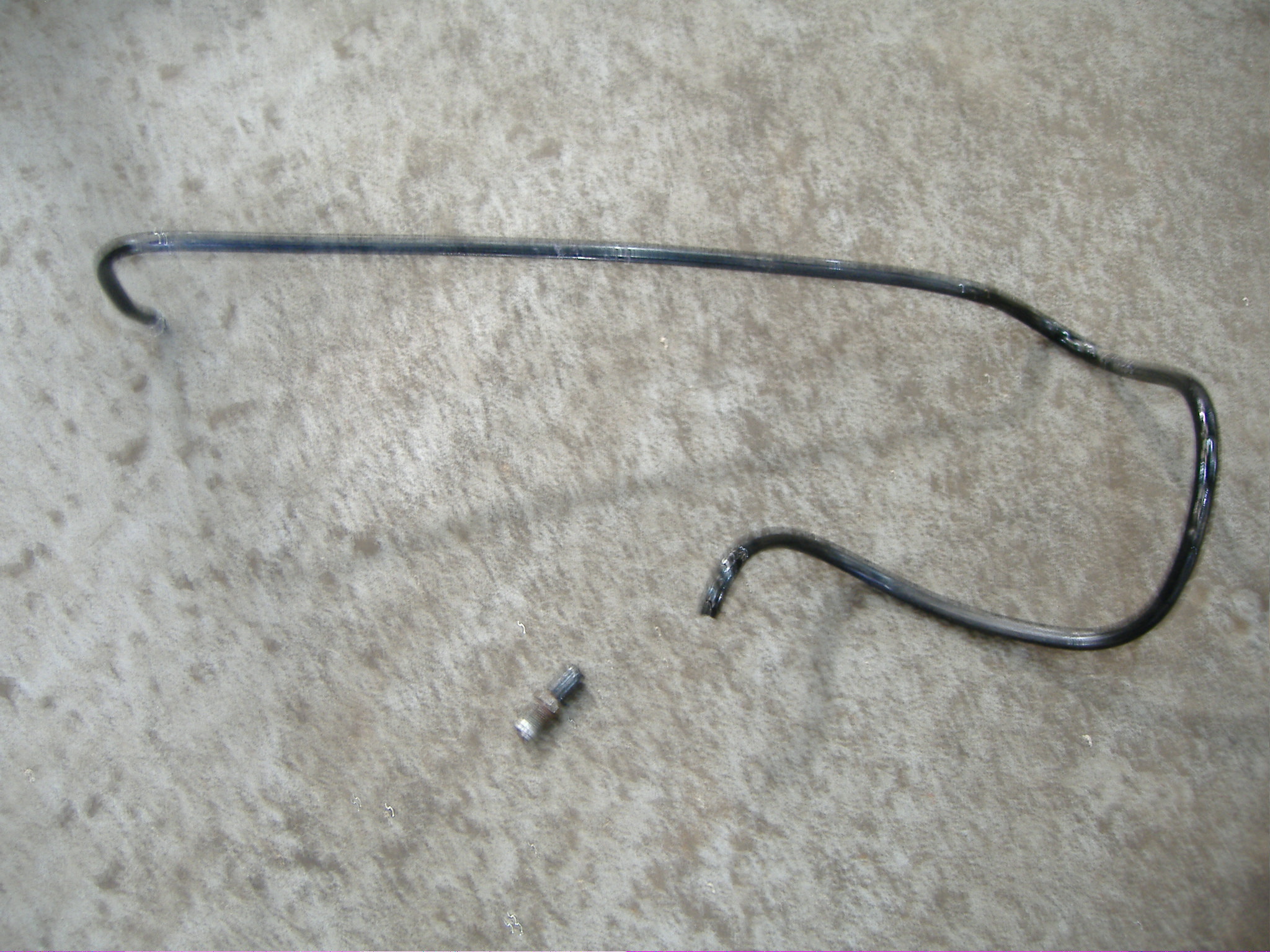

The offending clutch pipe

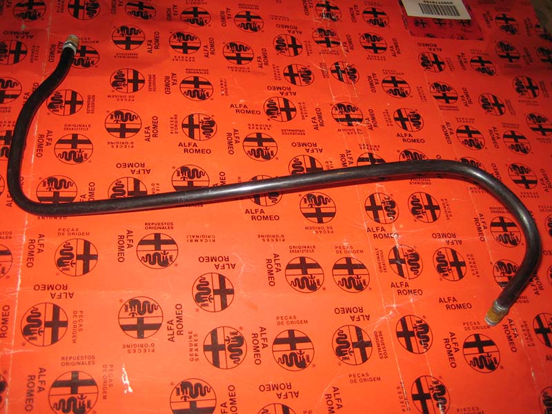

And the new replacement on its way to CP Garage Services

Is that clutch pipe the right one Colin ? It looks a simpler shape than your original, - perhaps a 33 one ? they come through the bulkhead in a different place, hence the slightly different shape.

justsuds wrote:Is that clutch pipe the right one Colin ? It looks a simpler shape than your original, - perhaps a 33 one ? they come through the bulkhead in a different place, hence the slightly different shape.
John.
I'll know next week John!

Finding a usable replacement clutch union pipe proved to be difficult so, to save time, Euan at CP Garage had one made up in stainless steel braided pipe by his local Pirtek branch. A further delay here was caused by the fact that the pipe made and marketed by Goodridge as being suitable for the Alfasud and Sprint turned out to be way too short (see photo) so be wary of this if you decide on the Goodridge item.
