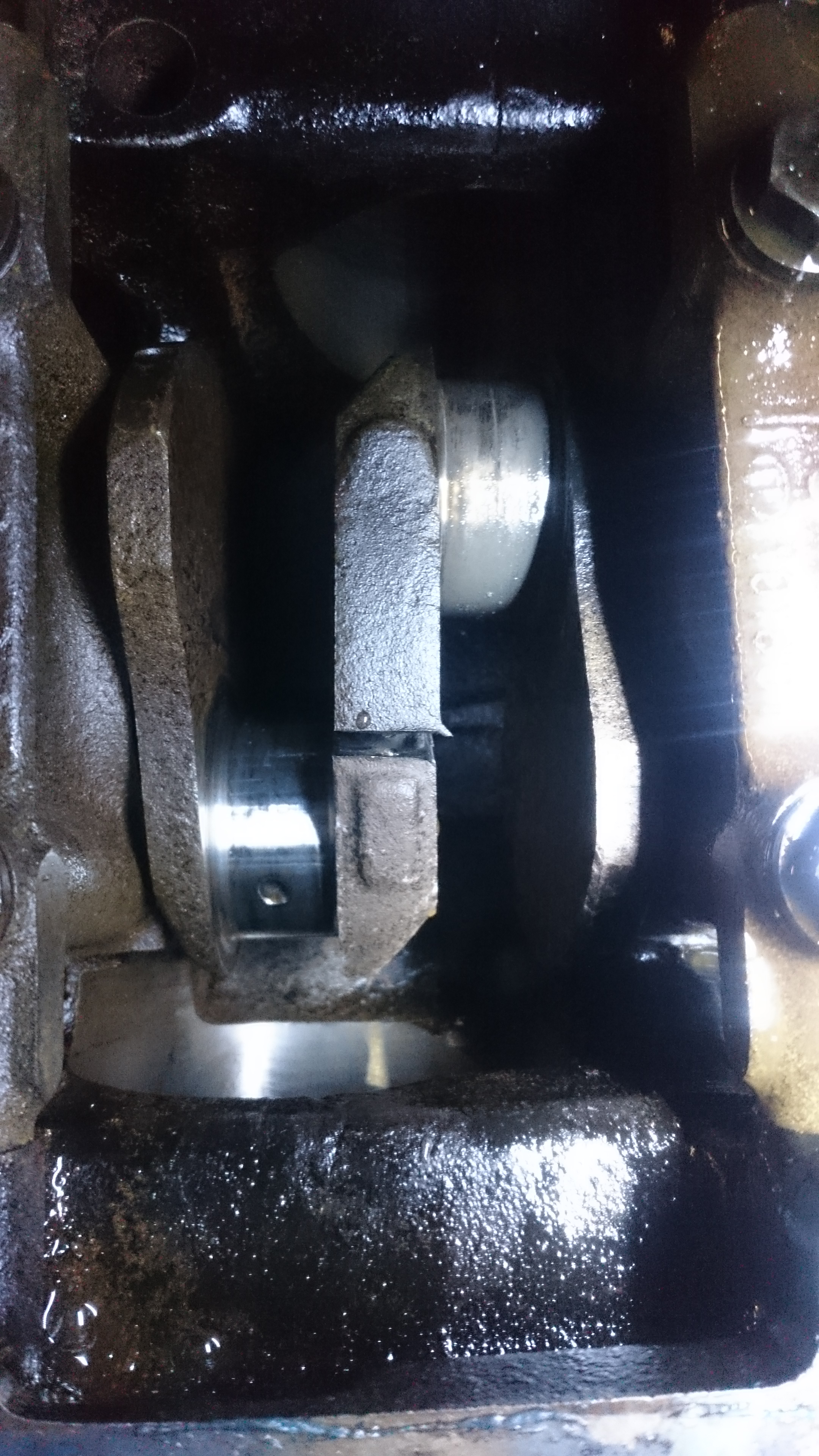

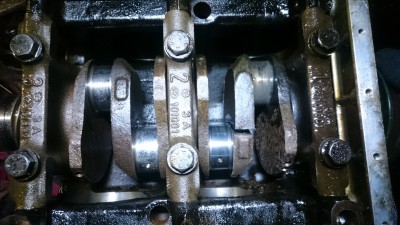

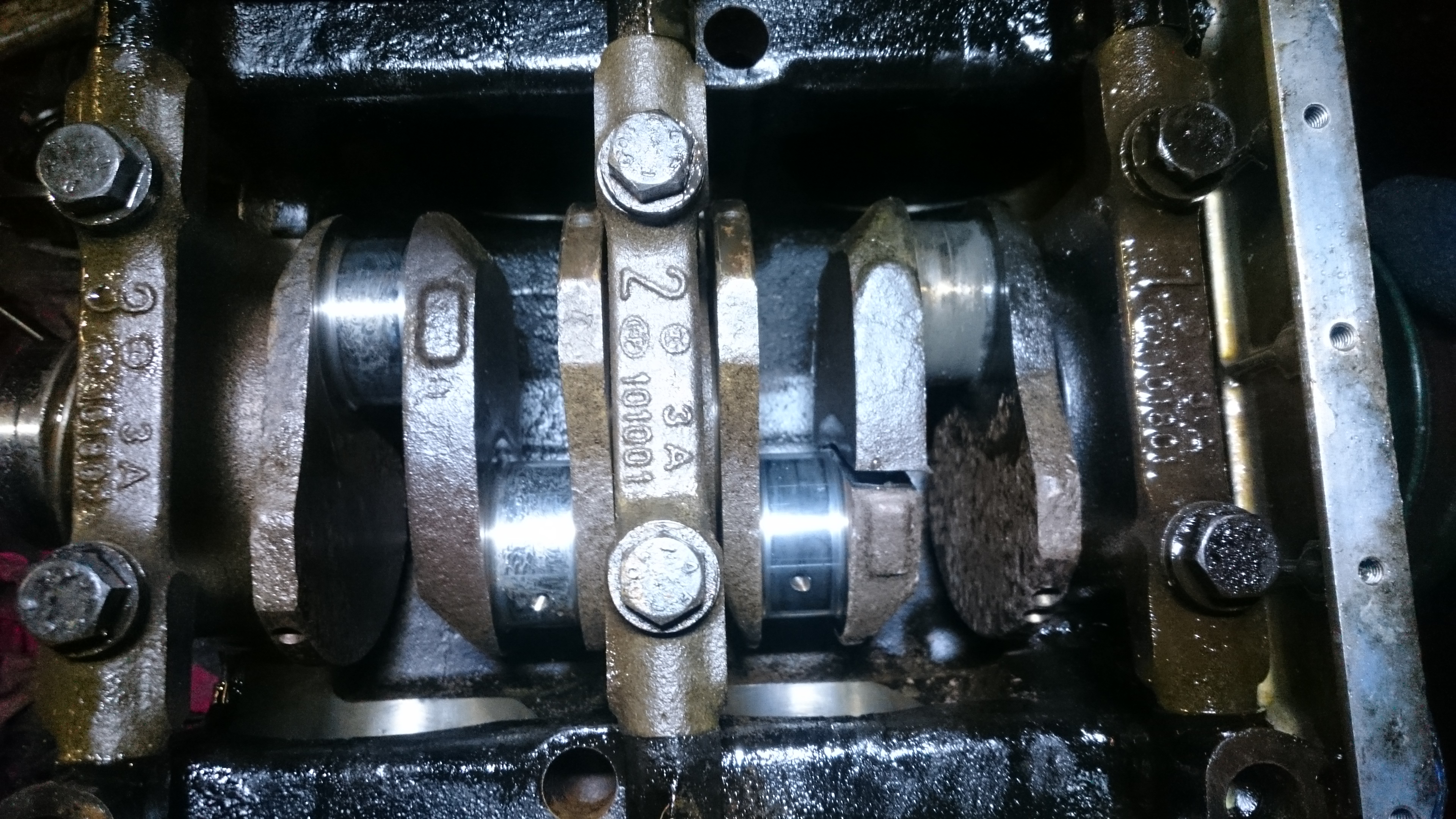

Ever seen a crank break right across the web before?
I hadn't until unearthing this bust motor and investigating the crank pulley wobbling about in the breeze!
Weird thing is that nothing else appears damaged, at all, so i suspect it broke upon starting up or turning over rather than when running at any engine speed.

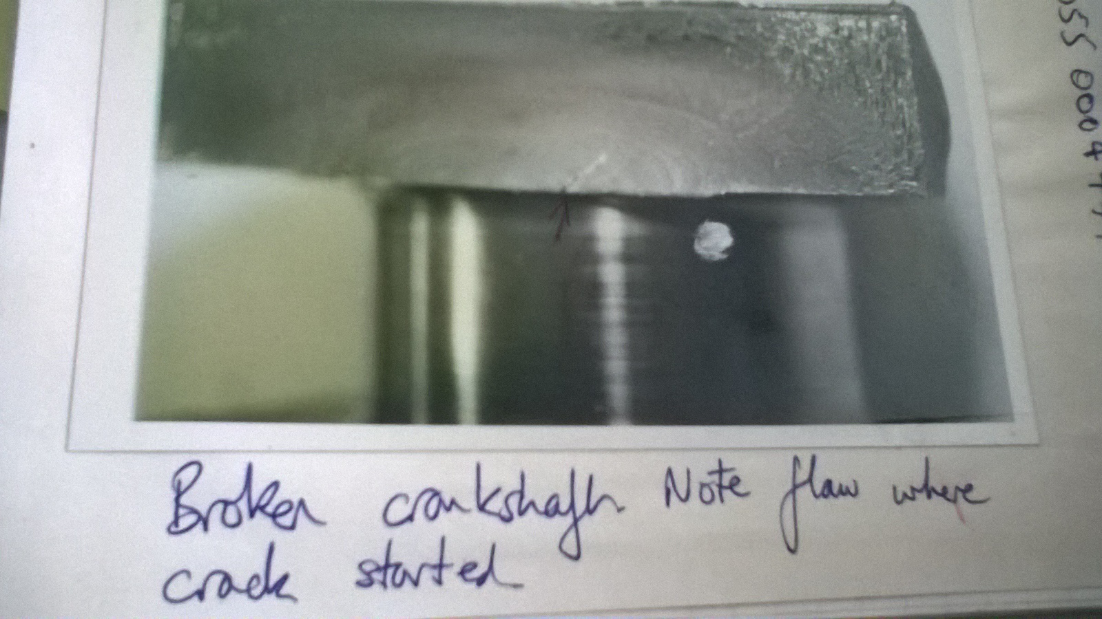

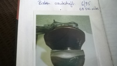

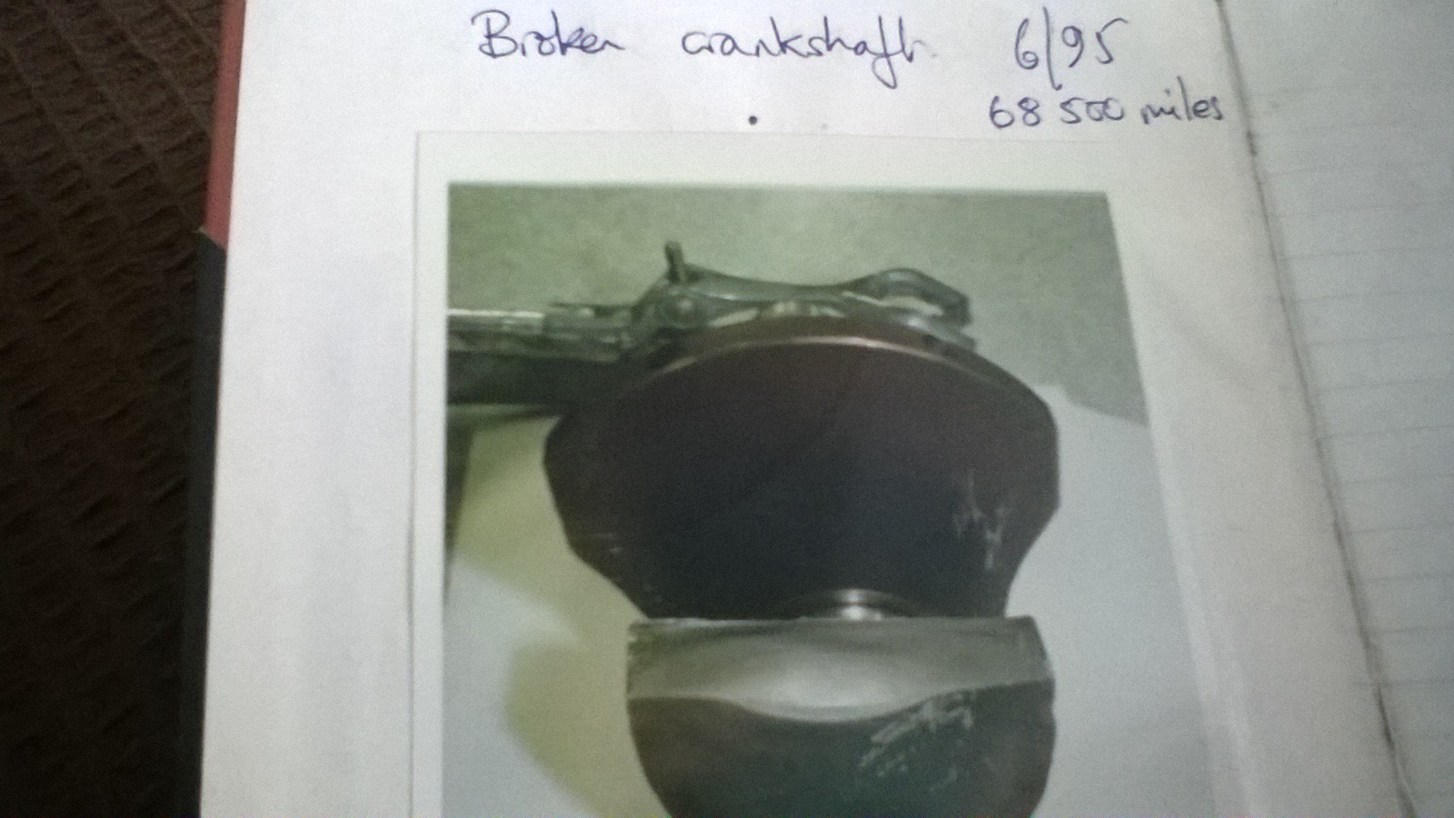

My alfa 33 broke the crack like that then in was about four years old with 69k on it and alfa rebuilt it. I've got a pic somewhere

Funny you should mention that Chris as I showed the above picture to my Dad who used to sell new Alfas in the 80's. He said he's replaced perhaps 4 cranks that have cracked, the last one being a Sprint 1.5 Greencloverleaf that was about 4 years old. He said it's always 'journal' number 2. The car will still run but it knocks.Strange, perhaps a casting fault?alfachris wrote:My alfa 33 broke the crack like that then in was about four years old with 69k on it and alfa rebuilt it. I've got a pic somewhere

Re: A Break like No Other!
Wow!
Thats an identical break that is.
Did you find a reason or was it simply fatigue failure?

Found the photos of the broken crank at 68500 miles in June 95
