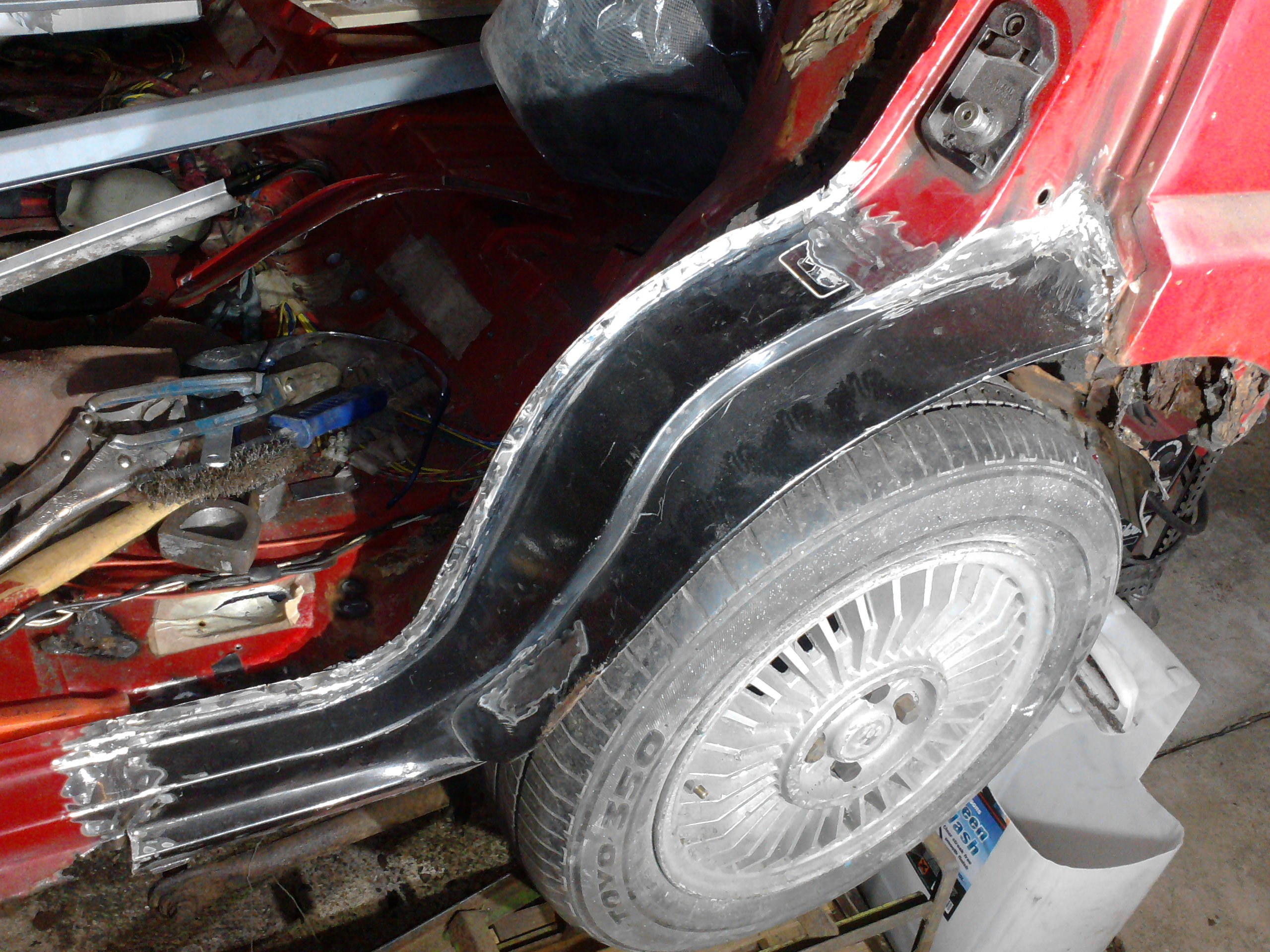

Christmas is over, there's only so much time you can dedicate to TV at this time of year, so went down to the car to have a few hours on the n/s rear arch that needed changing.
I'd got a decent used complete arch section to use so cut the original one out right back to the door seal flange and to the inner arch flange on the inside, which turns out is better than i'd thought and will be useable to some extent.
whilst the sill was open I repaired the central sill portion there above where i'd done the chassis repairs
after a bit of jiggling and chopping out in found a decent position keeping alignment decent all round.
the seal flange was spot welded in place, rest got the good old mig
the inner part lined up just nice against the original flange so that simply got seam welded
i'd already sanded it back to bare metal befiore fitting so the remaining pitted metal got a dose of rust inhibitor, soild metal still but won't hurt to have a little extra protection
once all welds were ground back it got a coat of zinc primer just to protect it whilst the work is ongoing.
pretty much ready now for the outer sill to go on and close that side in.

bottom lip was spot welded all along it's edge with a few token tack welds behind where there was a little overlap behind.
rear section around the jacking point and suspension mount, once tidied and sealed it'll look better
a protective coating of etch primer will keep things ok until it's bodywork time
just got the front end to seal in but a bit more work around the wheel arch area too, then the back end needs capping in before going up into the strut tower....a bit of a start to the welding but loads more to do
with upcoming projects though i'll not get too much time on it, not as much as i'd hope to get but once spring comes i'll be able to do a few hours after work with it being close to home.....unless circumstances change....

had a few hours this evening so made up a few little patches to repair the remaining rear door step where it'd disappeared
front end at the bottom of the A post wasn't it bad order at all but whilst there I replaced the bottom to make sure it has a chance to last
