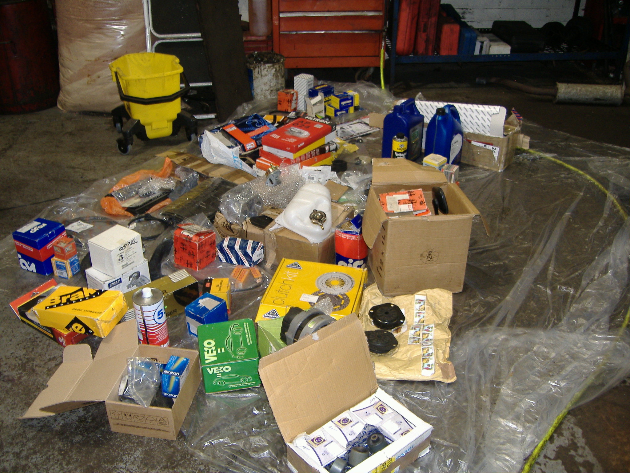

The miles I've done in her have allowed me to give her a thorough shake down and I now have a good idea of what's likely to be needed to bring her back to A1 condition.

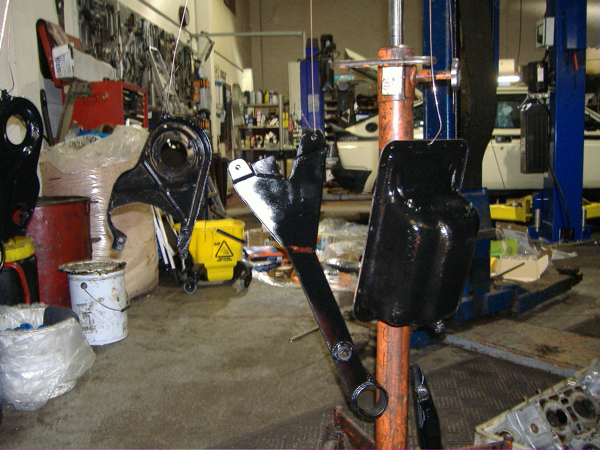

Progress.
Strip-down and cleaning, degreasing and repainting of parts commences:

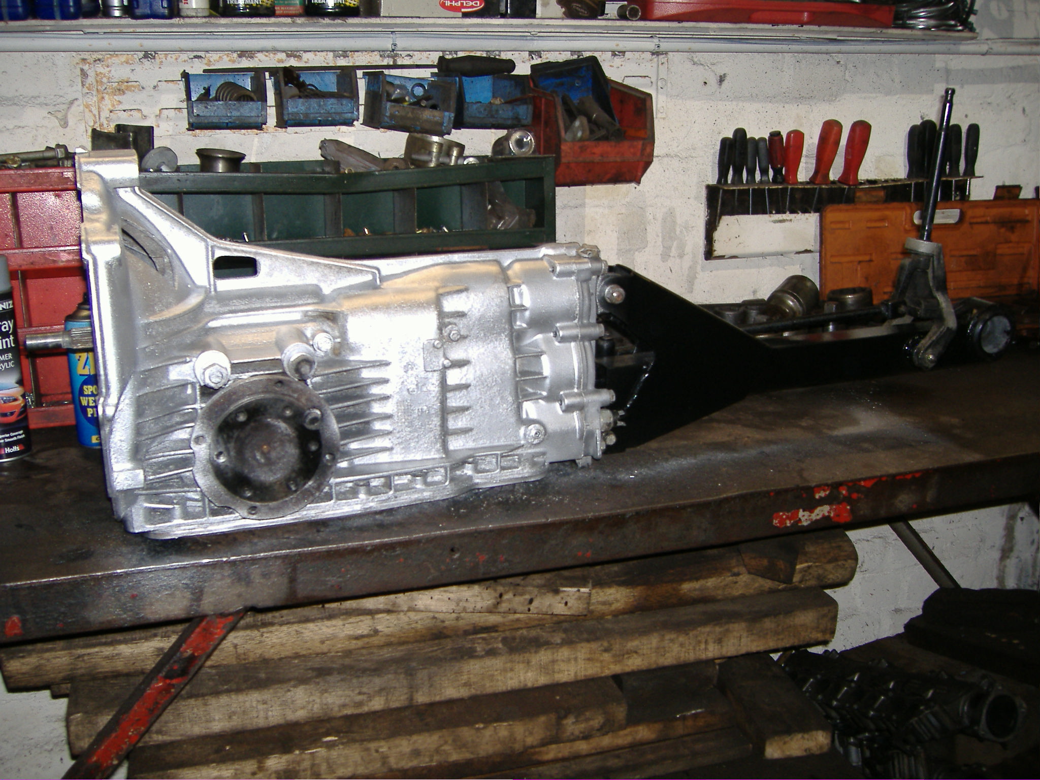

Cleaned, degreased and repainted gearbox and diff' unit on the bench.
All core plugs replaced with new.

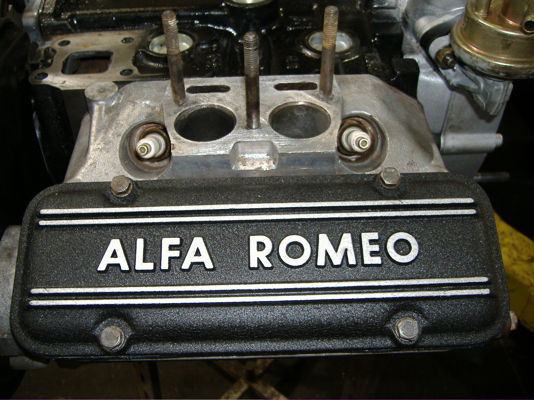

Heads refitted with custom black crackle finish rocker covers.
Further updates soon as work progresses.
Re: It begins...
Looking good
Re: It begins...
loving the swift progress mate, guess that comes with getting the pros' on the job
crackle finish looks ace
