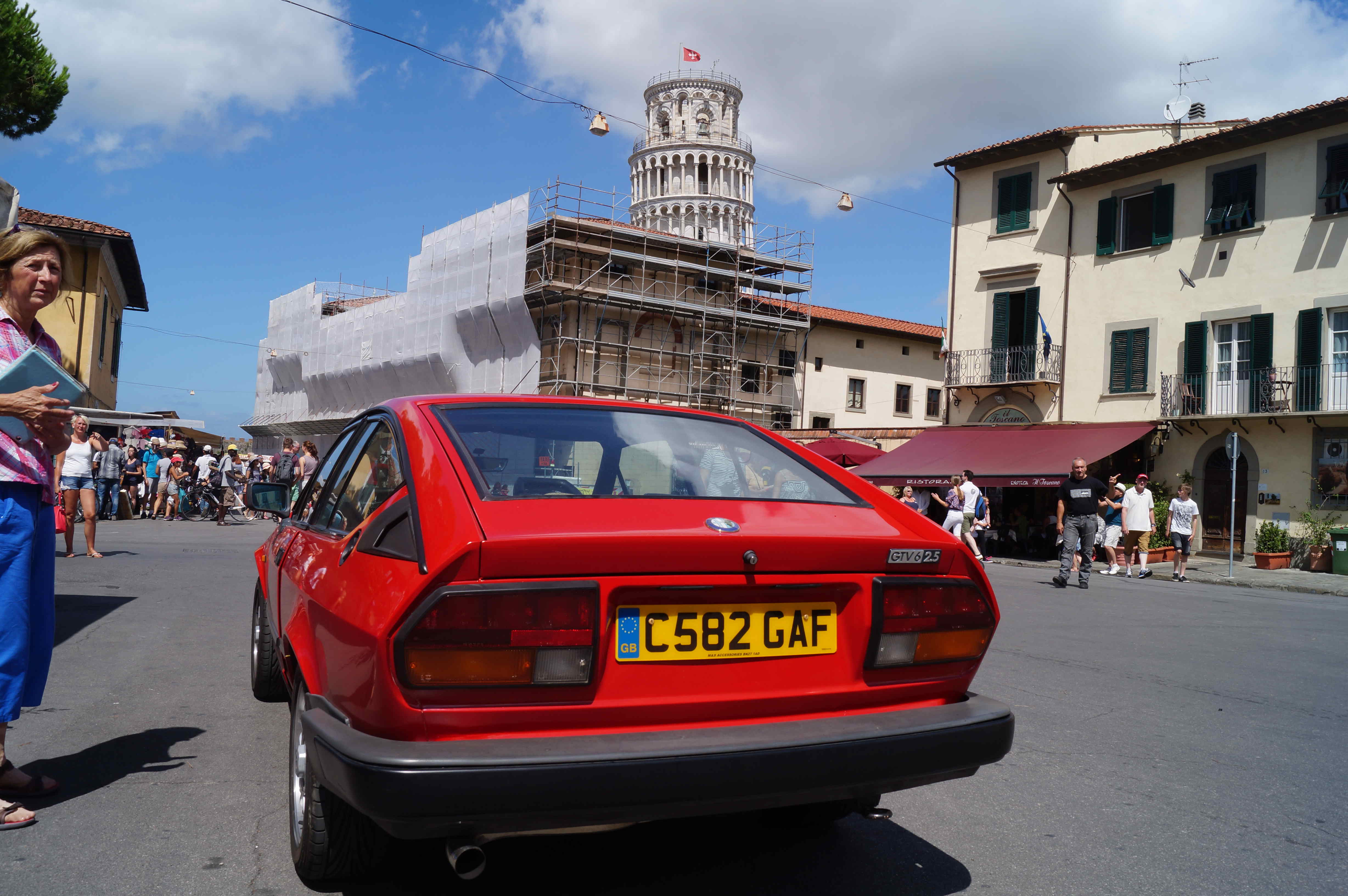

I have just completed 2,500 miles through Belgium, France and Italy. I'm pretty pleased that the car gave me no problems other than a bad connection on an indicator bulb. That got sorted using my wife's emery board!
Now, to the point. As soon as the car arrived in France it seemed better, louder, smoother. It took me a couple of days to work out why. I had avoided using SP95 E10 as advised by the internet (10% added biofuel) and used SP98 instead. The car really responded well to the higher octane. So my idiot question is....does it make that sort of difference with every car? Also, will the diesel super grades work as well on our oil burners?
