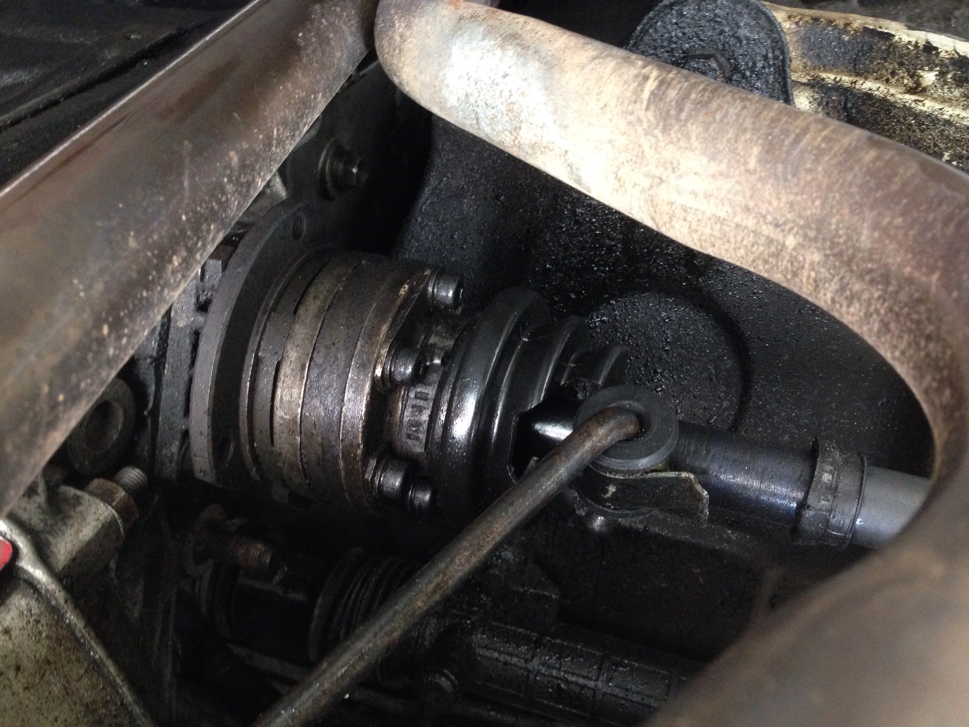

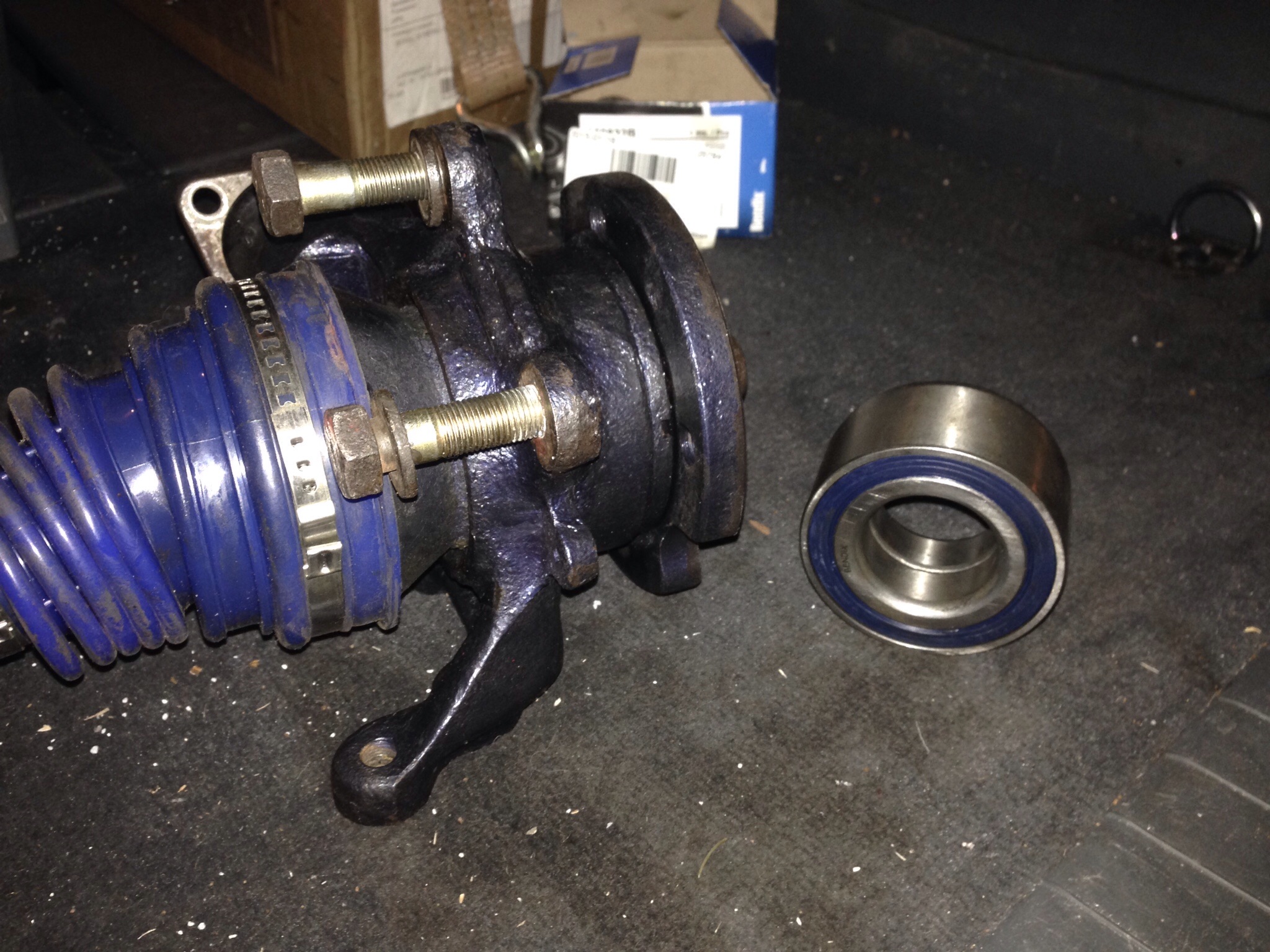

Slow progress due to new house and moving, but made a trip to the car yesterday and mountet the engine. But, as usual a new challange when checking the left hub and wheelbearing. This is not moving easy enough round, and a new bearing was ordered.
Off course, this is not like the one one the car, so I'm stuck on solution. The new bearing (and the one in the manual) is one complete unit, but the one on the car is a split type with a "sheld" on inner/outer side and two loose rings of bearing inside. It seams that the rubber seal on the outer "sheld" is rubbing against the inner hub, when I remove this it runs smooth.
Anyone got an idea? Do I have a hub from a Sud, or is there differens in the 33- series?
Re: From Road car to Race car - Alfa 33
definetly not a sud front hub, they didn't mount the calipers out there.
could it be a sprint one? now sure what differences there are but seem to remember the 16V shafts are different to the 8V's so could well be a different bearing/flange
Simonsud
Posts: 331
Post by Simonsud »
Are you sure it's the wrong bearing from what you are explaining it sounds like the one in the hub is a one piece bearing but when you pull the hub flange out the outer stays in the hub and needs pressing out and the bearing outer pieces are one stuck on the flange and the other falls out . This is normal with press in bearings hope this helps or I might be wrong if you have tapered bearing but you have said you have ball bearings

Bearing sortet out (the new was right, the old total waste), Avon tires on the car, engine in, new exhaust manifold in place, but engine still have the same lack of power as last race...

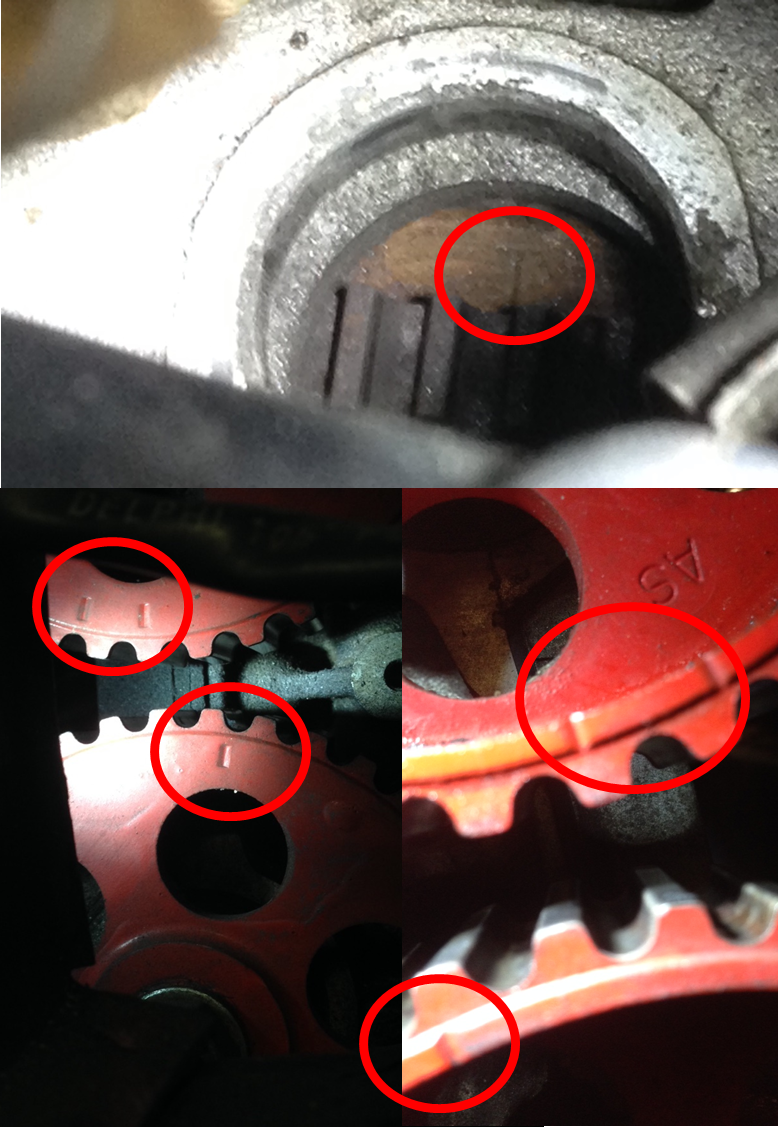

A short update for this season so far:
- Avon tires sucks....!! Way to soft, so back to Toyo. Attached you can see how my left front tires looks after 2 races and 1 qualification. Good thing I checked the wheel nuts before race three - to bad it was only 5min left to start, but found a friend with a spare tires, so after some panic work I did the race with one 14" and one 15" front wheel :-)
- Engine still only 80% after 4 races. All sensors checked/changed, but should have checked the most obvious fist - timing belt/mark...... Strange that both sides have jumped one/two teeth, but at least the engine now both sounds and run normal again - so really looking forward to next race!!

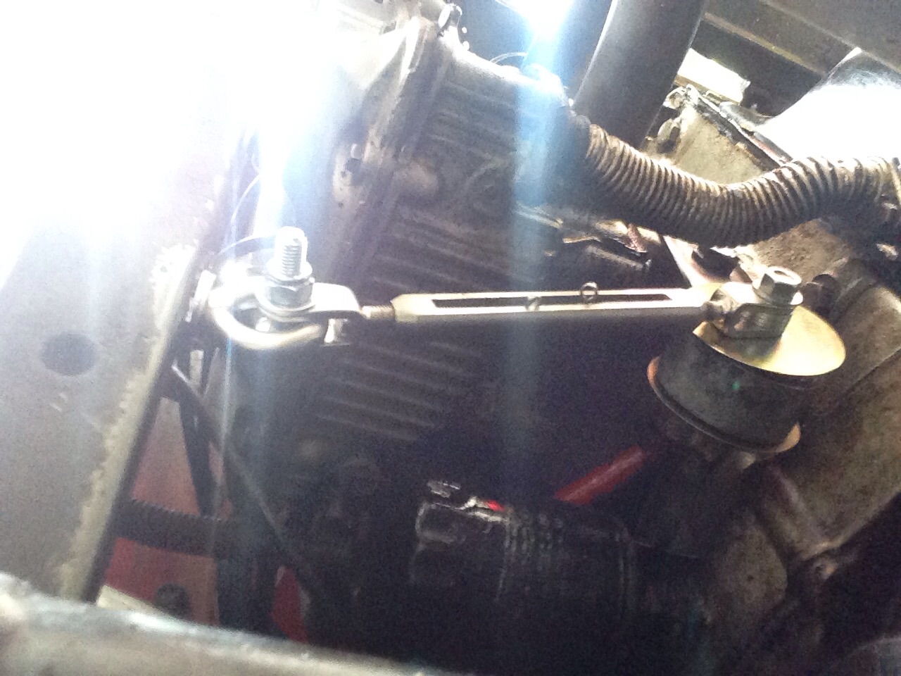

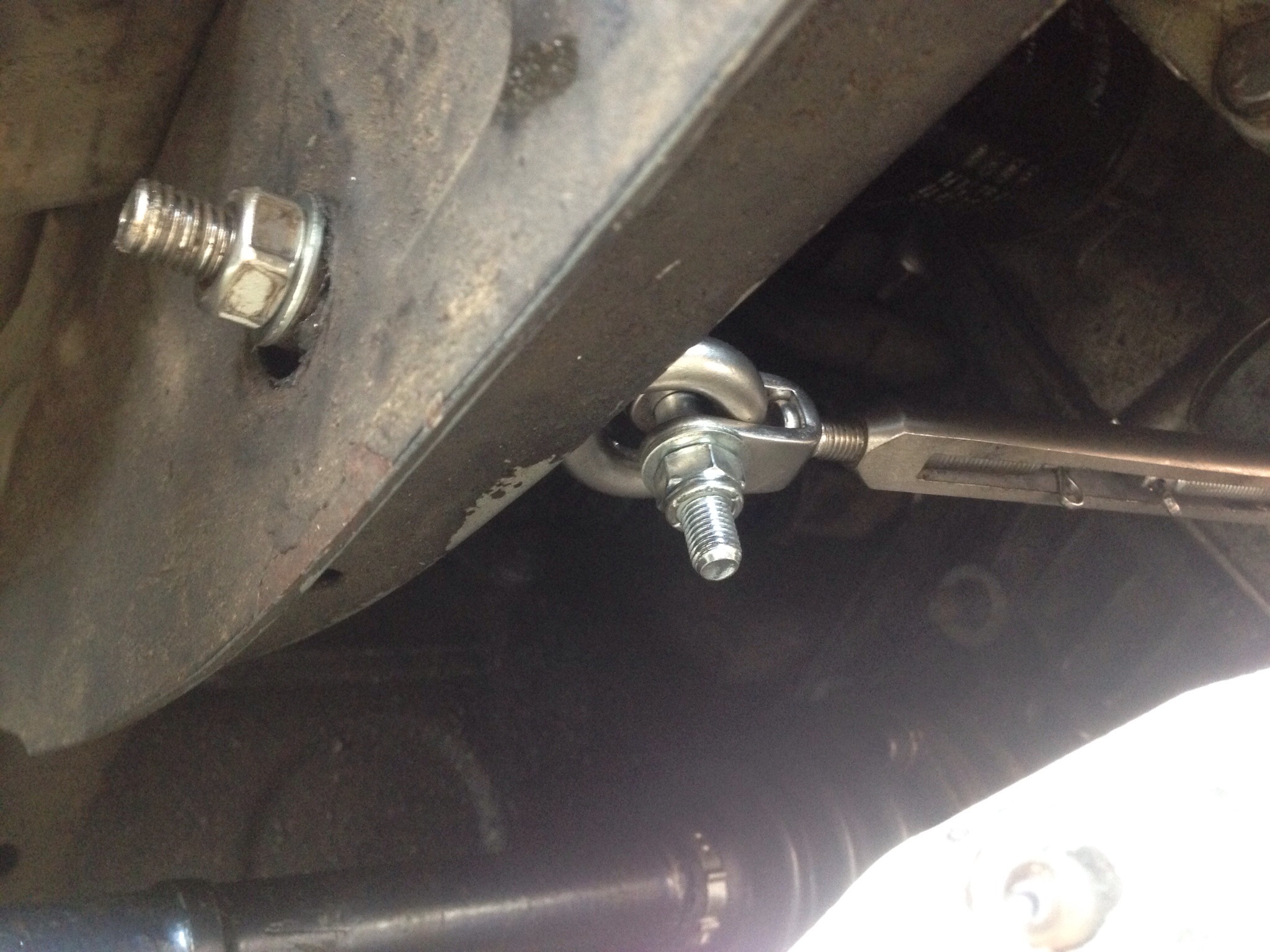

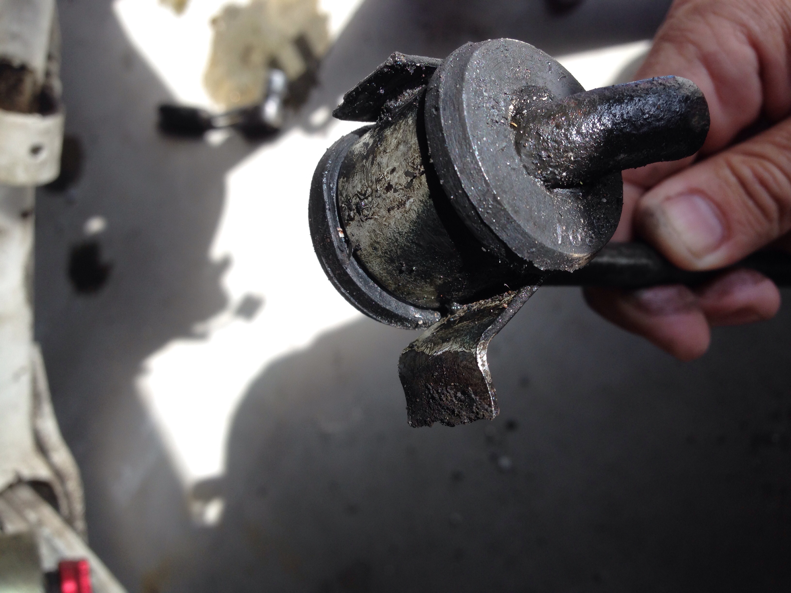

Had a look under the car today, as it made some noise from the left side last race, and there i was:
The side engine mount had come off and swinged into the inner cross of the axel.
But think I have made a workable solution with a new adjutable "arm" from a wire tension (of a sail boat), a standard engine mount (cut out the rubber from the engine bracket, and pushed in the round engine mount). The an eye-bolt in the chassi.
Crossing fingers...
Post by Brovold »
Now it looks like this:
