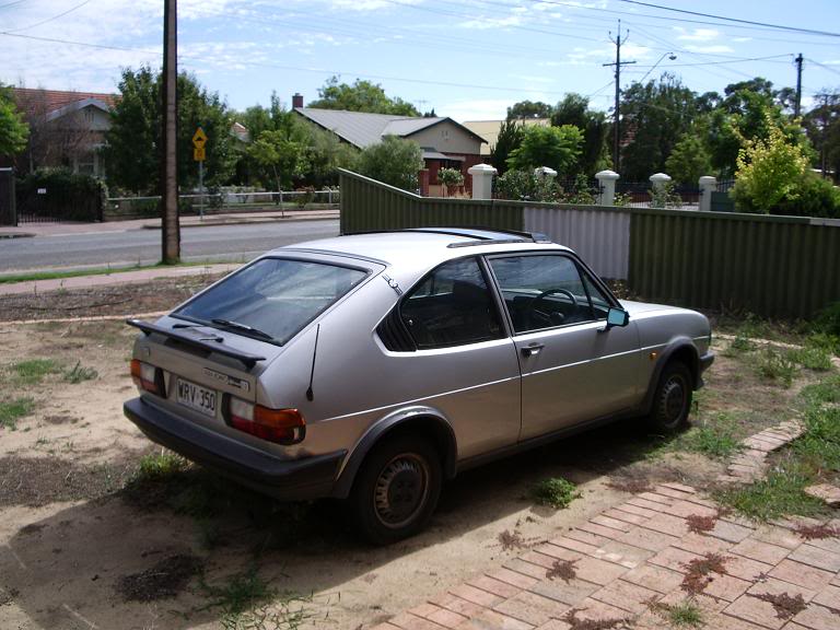

I originally started out sprinting my 33 16v but then later decided it was a tad too clean for racing. This brought on the search for an Alfa Sud as they were a bit lighter and have always been a family favourite.
The Sud came from a close mate and had been sitting in their front yard for two years, snapped it up for $150 =))))
The original state was not too bad, couple of dings, broken lights and of course the std single carb motor, but nothing some TLC could not fix.

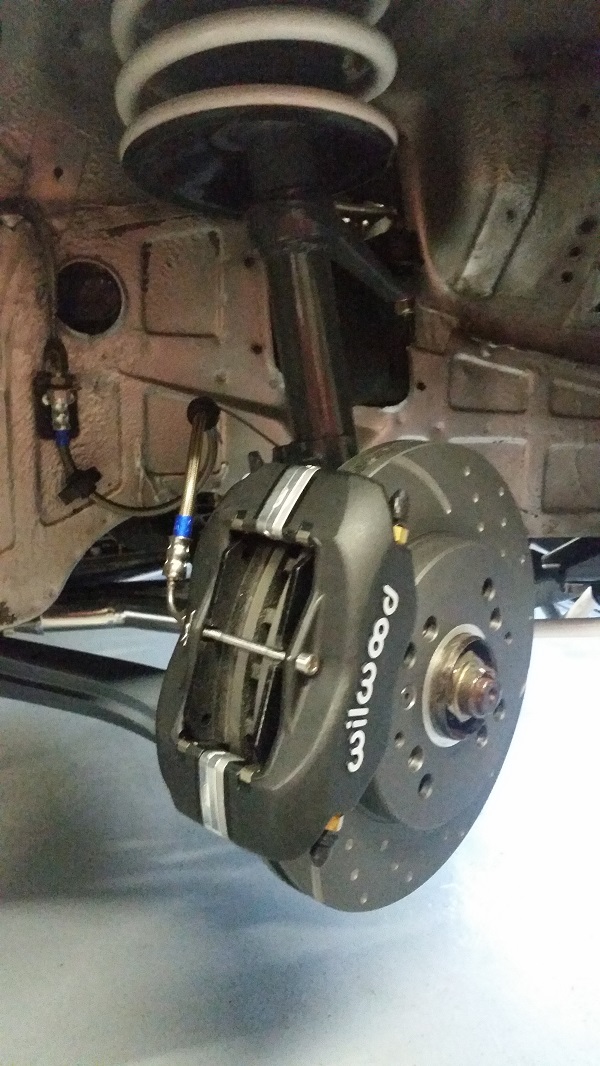

- Outboard brake setup - Wilwood 4 piston calipers, bias valve, braided lines, PMU pads

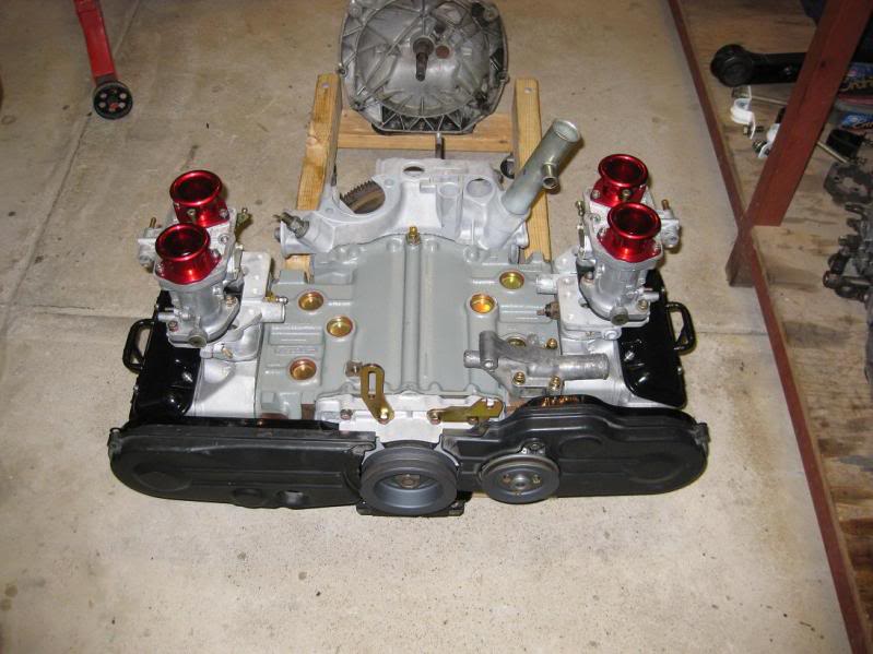

- 1.7 twin carb solid lifter ver (match ported, C&B Cams, Lighter internals, 16v oil pump, Crane ignition, tuned length extractors, custom valves & cuts)

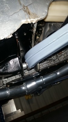

Car looks really good

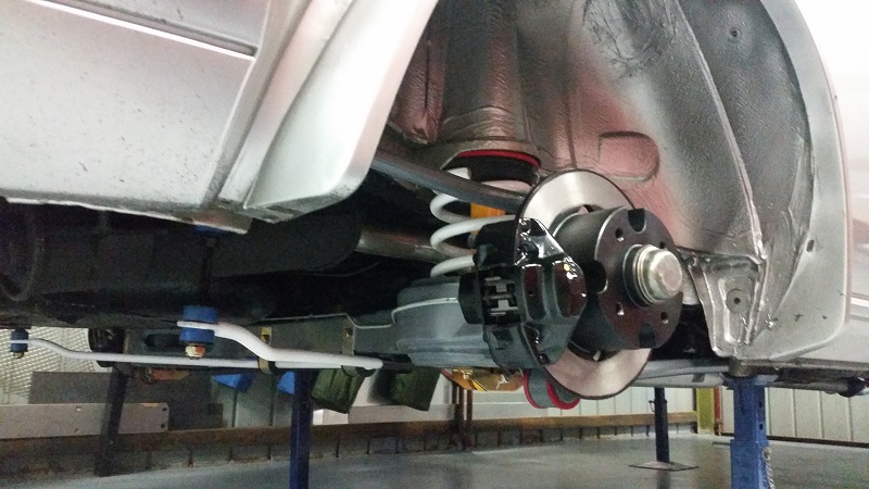

Be interested to know more about your rear anti-roll bar.

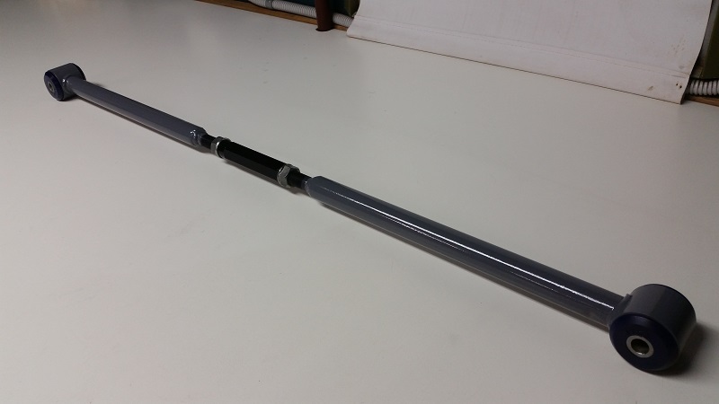

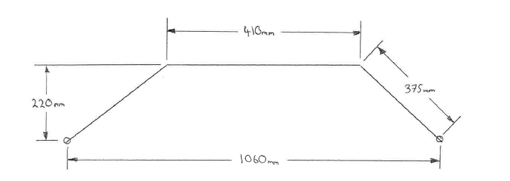

The bar is a K-Mac kit but they seem to only be custom order now. I manufactured the brackets myself to mount to the rear axle and the rest was included in the kit. The brackets for the ends are thick L bracket steel which go through the rear suspension bolts.rsfruitbat wrote:Car looks really good
Here is a sketch of a bar we had made for my 33 16v
- Posts: 799
Re: Sud Ti Race Car
Any idea of a contact address and a price?
Did you find it made a big difference?

I got my stabilizer from Car Torque here is South Australia (08 8362 7667) and they sent my plans direct to Kmacrsfruitbat wrote:Any idea of a contact address and a price?
http://www.k-mac.com.au/
They should be able to help you out.
As for the difference, yes the car is considerably more stable through cornering. Some people have some very wired ways of running stabilzers in the suds....I just tend to have a small light one in the rear and a medium up front and its great.
Also have a medium on my 16v too
