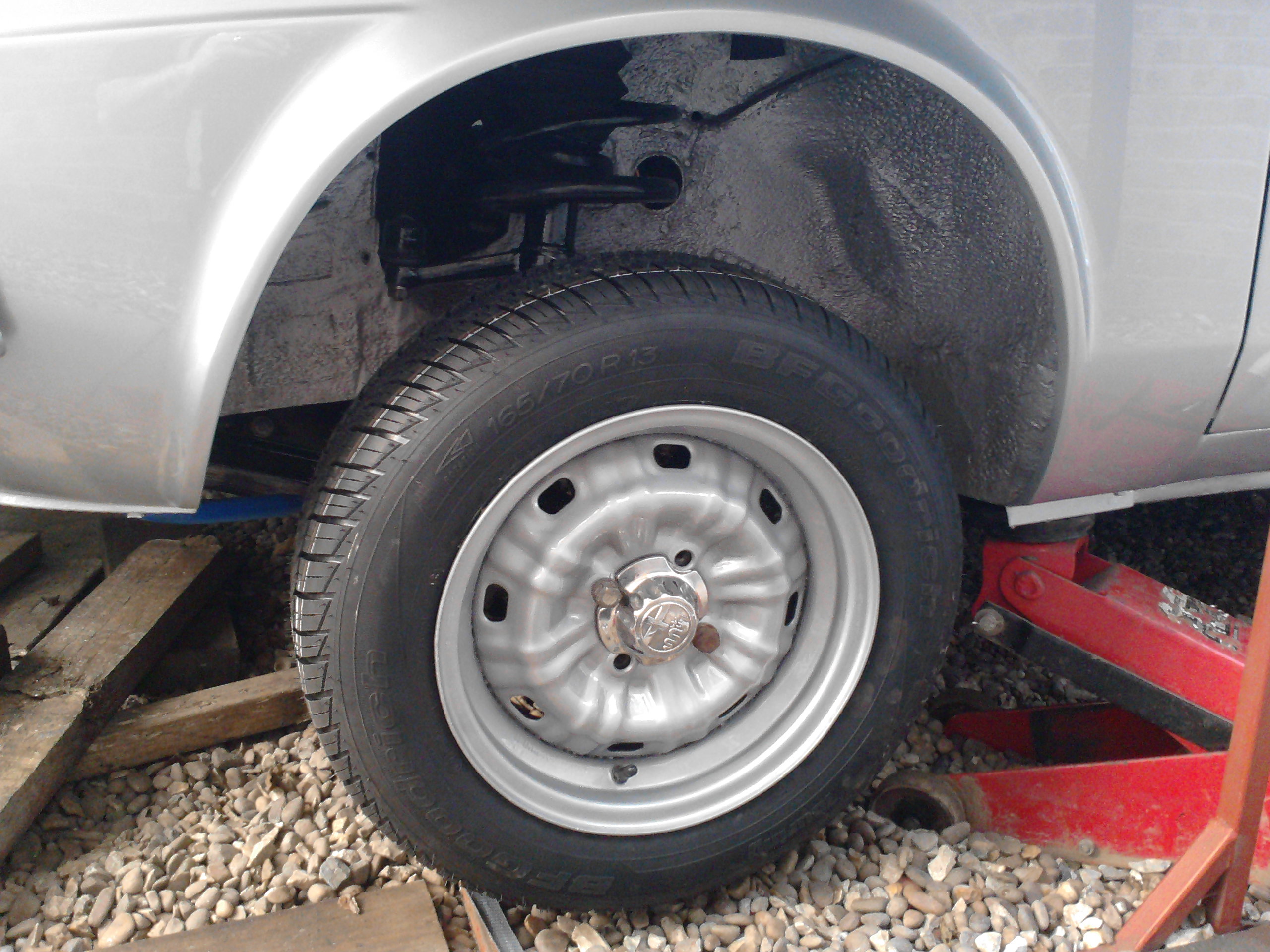

another small but significant step today, got my wallet out and bought a set of tyres so i can finally get the steelies fitted.
went for BF Goodrich in the end, was gonna fit Michelin but they were almost twice the price and BFG's aren't a bad substitute.
fitted the n/s wheels to see what the bolt situation is, suspected i'd need to at least buy more of the shorter ones as i'd used them on other stuff but decided now to just buy a complete new full set of bolts.
found my centre caps and polished them up, just had to decide which design to use as i have a set of the different style that have a badge affixed rather than just pressed into the stainless. well, i say a set but one is missing a badge..
as it turned out though i prefer the pressed ones so cleaned up the 4 i had which had quite a bit of grime and paint on them..........once done of course i found 3 more that just needed cleaning

Great to see it coming along again Kev,
and i think the stainless pressed centres for the wheels are bang on, they look brilliant!

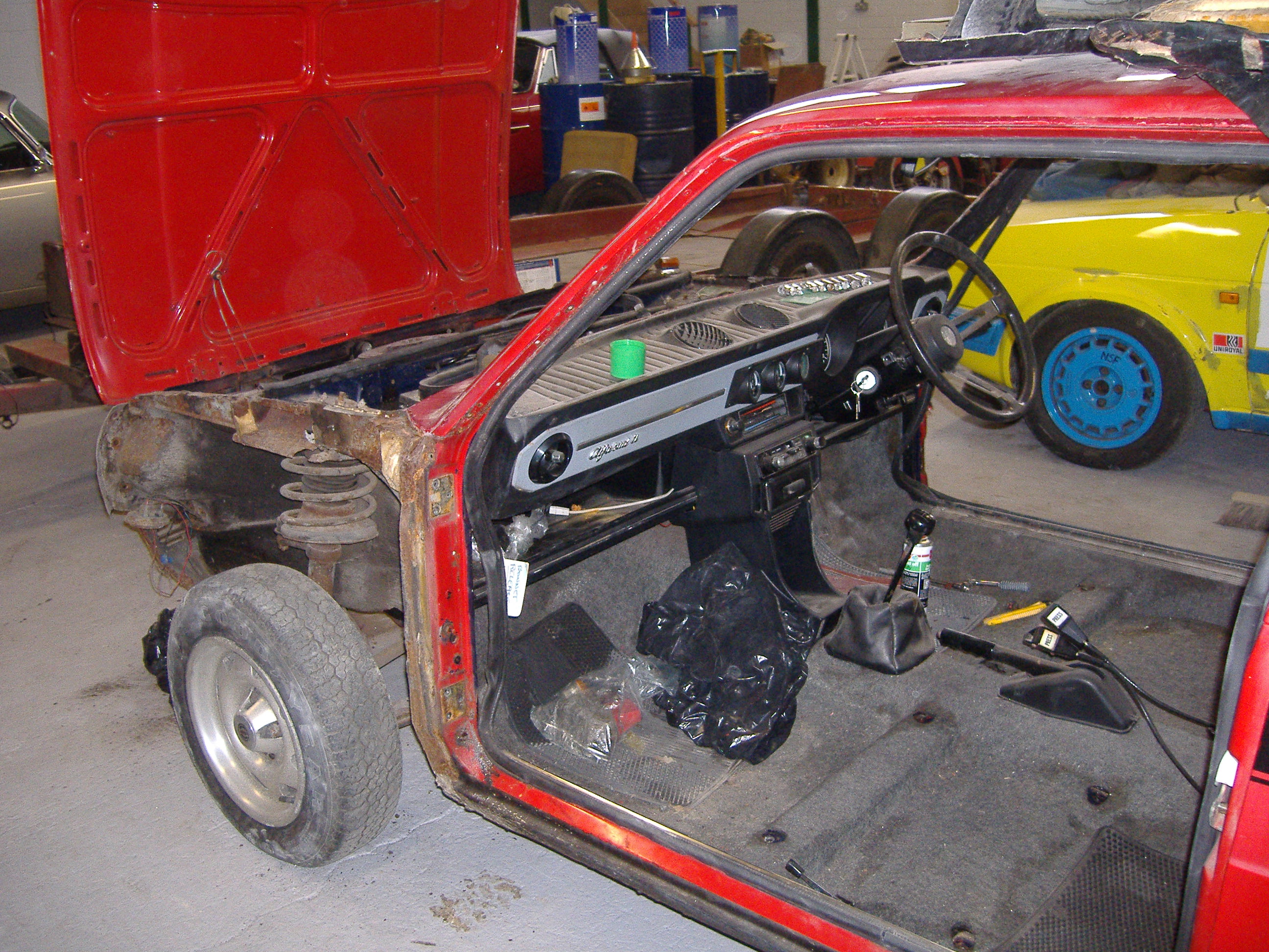

Kev, I think yours should be like mine, so it is a hard plastic moulding as opposed to a rubber gaiter. It just clips in place .
Here it is when stripping the car. Let me know if you need a better photo and I will take a new one.
